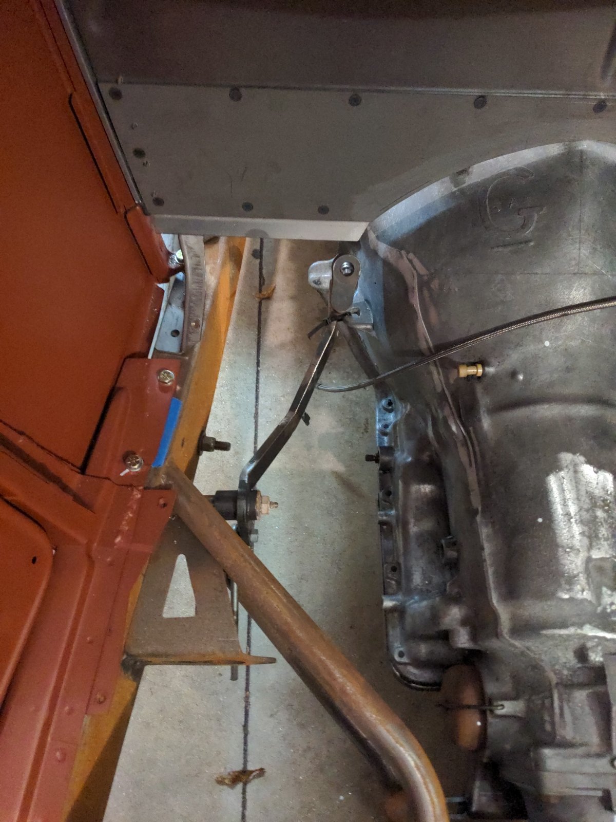

  5. SDS
    Joined: Apr 28, 2011
    Posts: 1,073
    SDS
    Well, the one that was in there will But the brake pedal too far to the right -I called Kiwi connection yesterday and I'm ordering a new one

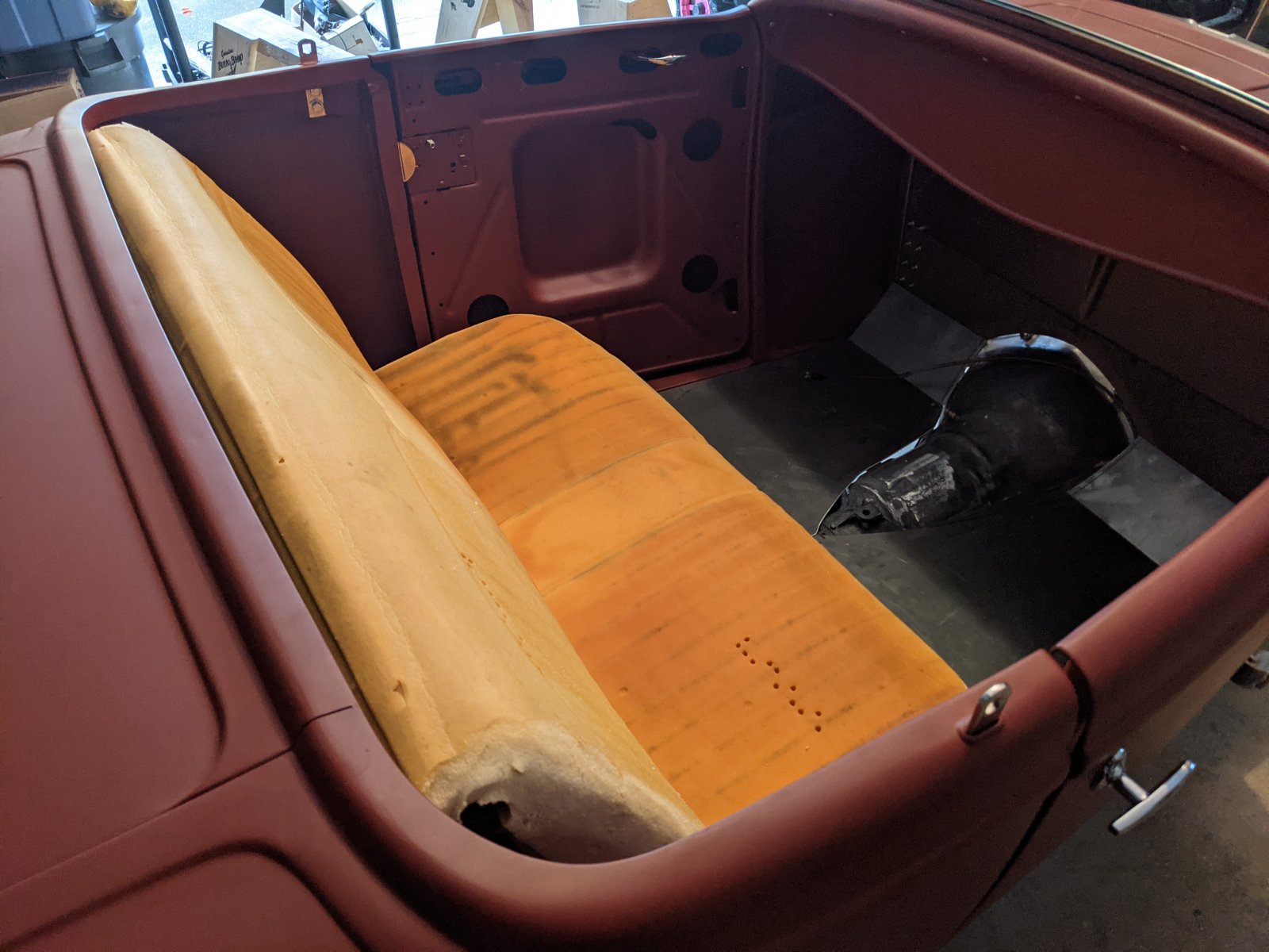

    The $65 junkyard seat looks pretty good in the roadster. A little electric carving knife and flap disc on a 4-in grinder shaped the foam right up. This was my first time sitting in it - I think I'm going to shorten the feet on the tracks by about an inch. The windshield isn't laid back yet and when I sit in it I'm pretty much looking right at the top cross- PXL_20211026_160150642.jpg PXL_20211026_160157168.jpg PXL_20211026_160207902.jpg member of the windshield

    That brake pedal arm is left over from the first time that I built a car on this ch***is... As you can see it is way jogged over to the right, because I have big feet... I'm going to try to make it less dramatically jogged over for this go around

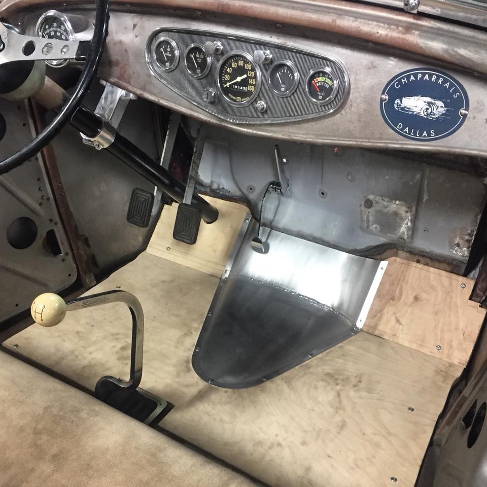

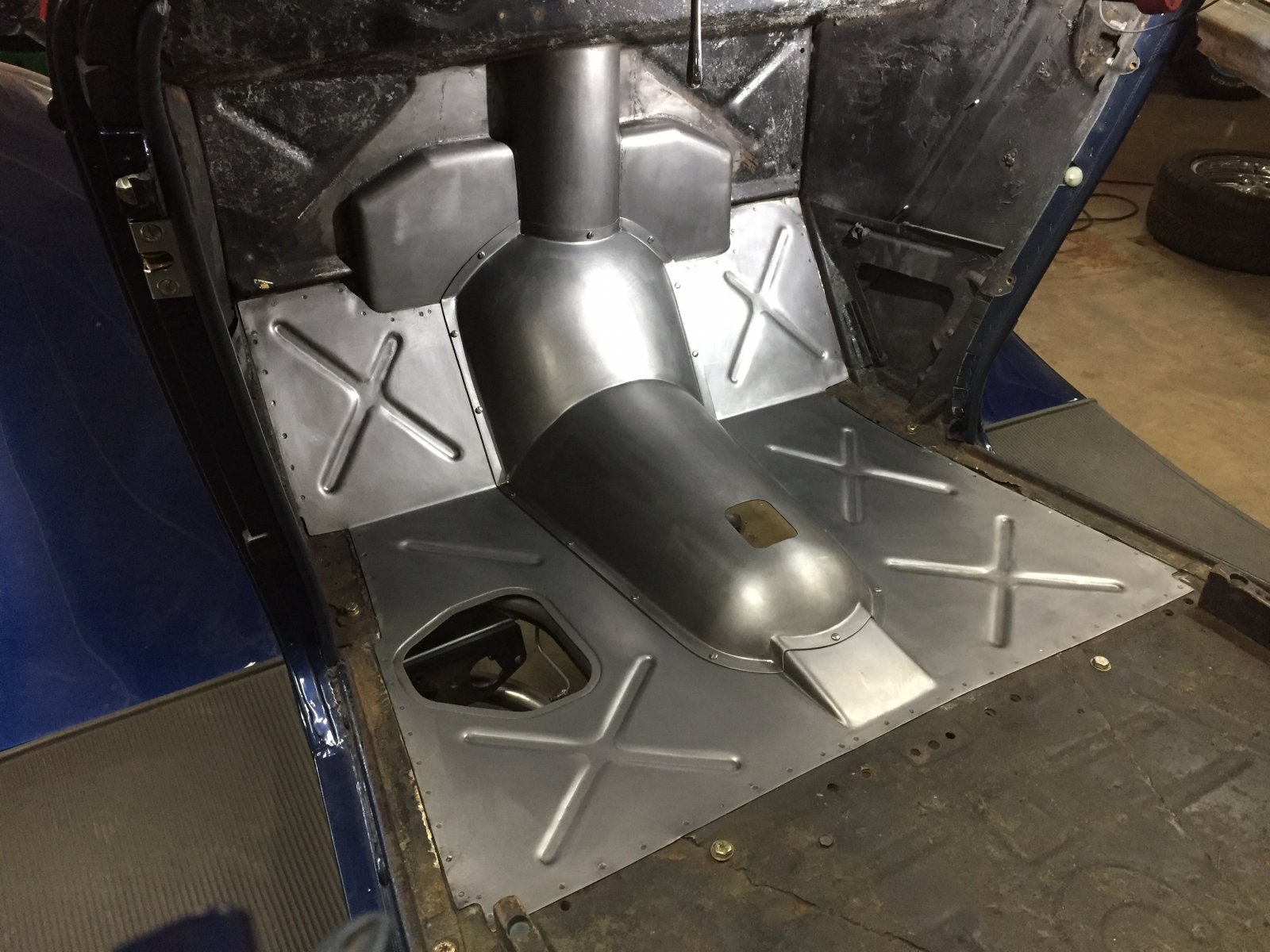

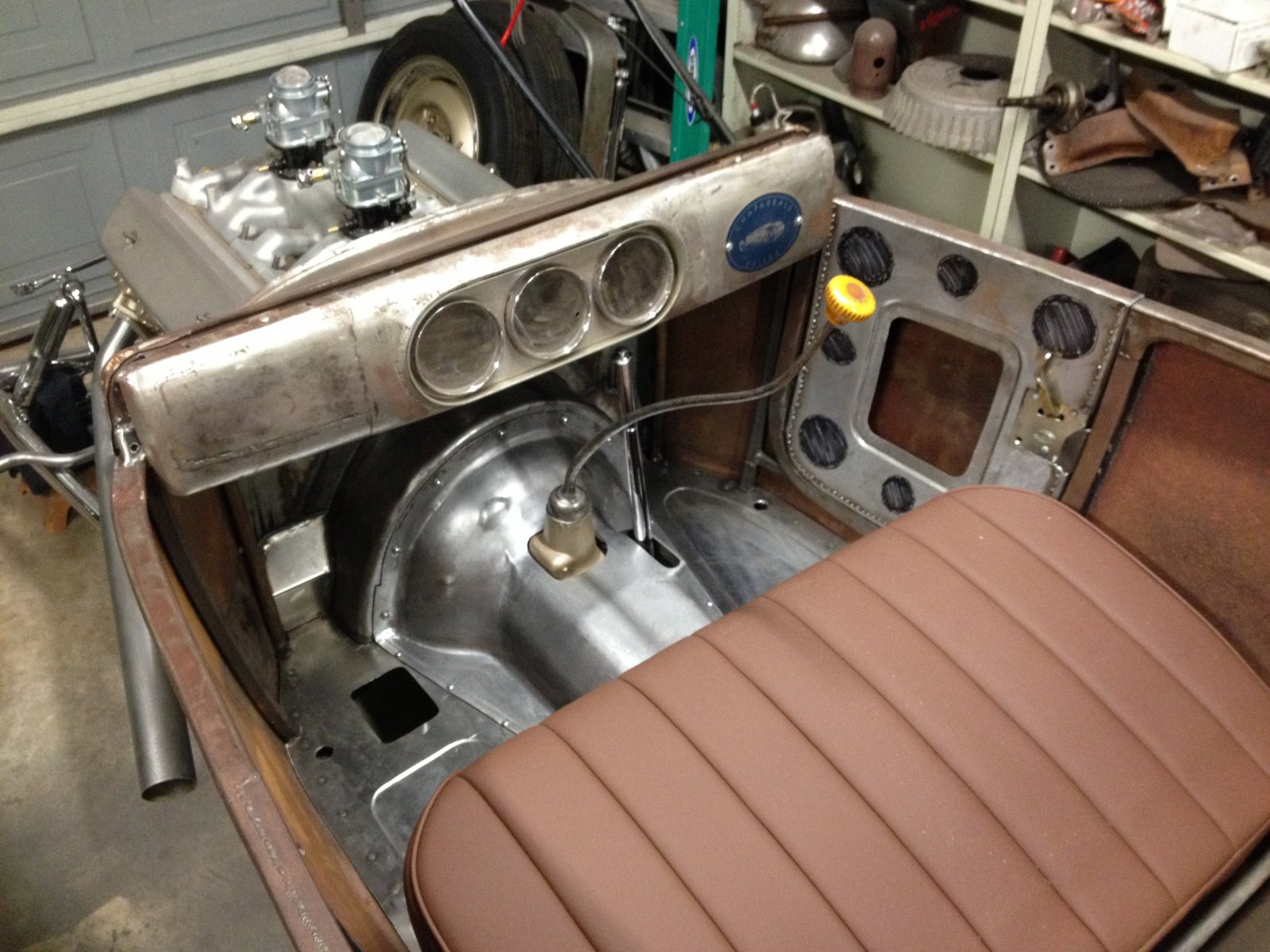

    Didn't seem that bad before to me, but it's better now without much h***le. On one hand it's an auto, so only two pedals to worry about. But the auto is a bigger trans case which cuts into the cabin. Either way, there is a lot more room there than on a lot of cars I've built or seen.
    Here's my old '32 with a Pontiac 350 and a 4-speed.
    And here's a '34 with a T5...doesn't show the pedals or shifter sticking through, but probably about the same size tunnel you will have. Plenty comfortable.
    Here is a '24 T I build....the gas pedal was on TOP of the transmission tunnel. I wouldn't want to do it again, but it wasn't hard to drive once you got used to it and you gotta do what you gotta do. It's a hot rod, not a Ford Taurus!
