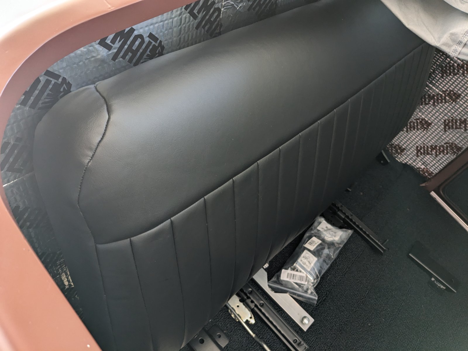

    Stuff with batting and jute pieces,then lay out in the 95 degree sun really helped

    I didn't realize (until a buddy verbalized it yesterday) that edge welting on seams actually serves to keep the seam straight without the wobbles/puckers I have. My original idea was to do a top-s***ch, but the tightness of my curve made that prohibitive. I'll probably try to use a hair dryer and more batting to smooth it out more this winter.
    As a learning experience and advice to all who decide to do their own vinyl upholstery, make sure to design your seat foam shape as to NOT have tight curves and/or intersections of 2 thick seams.
    I designed body armor and soldier-borne gear for 5 years, that's where I learned to use a walking foot sewing machine - that top scorner was the most difficult thing I've ever sewn. I owe that to bad design/lack of seat making experience.

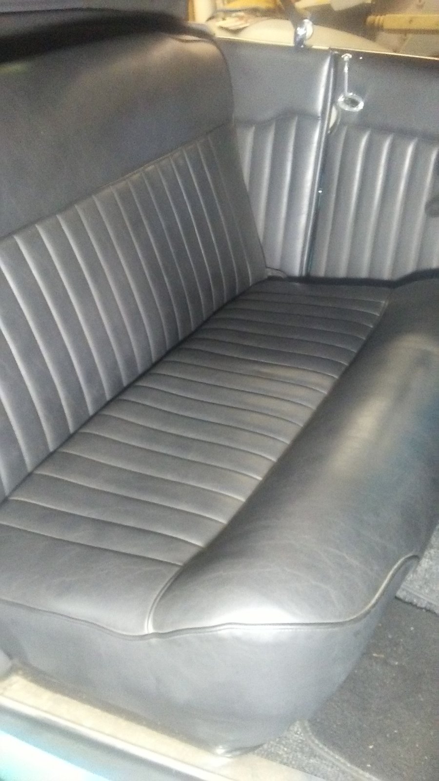

    Here’s an example of seam edge welting that was done on my old roadster.
    Hard to see the top corner, but if you squint, maybe. Still has some pucker on the bottom cushion.
    Here’s a better pic from the new owner

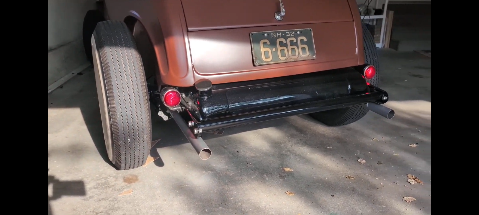

    And, the OPS can really be *****y, and I don't mean *****in'. LOL Oh, the body does sit about an inch above the gas tank, Your Brookville is a perfect repop of the Henry bods ! This should start some **** ! LOL again.

    I drive a Brookville highboy roadster and in all the builds I've seen on HAMB, NO ONE ever closed the gap between the fuel tank and body. It's a natural "bodily function" !

    Well, I did because is bugged the shot out of me and am glad I fixed it - looks so much better.

    I’ve seen it done several times here and elsewhere. And done it myself, in a build here on the hamb. It’s a known issue and very common to correct.

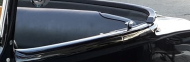

    I just got two new side mirrors from Vintique (The ones I had on there provided limited visibility)... Chopped one on the left and a standard length for the right.
    I know that ultimately it doesn't matter, but does the bullet-shaped portion go above the stick or hang below the stick? Guys who have these will know what I'm talking about.

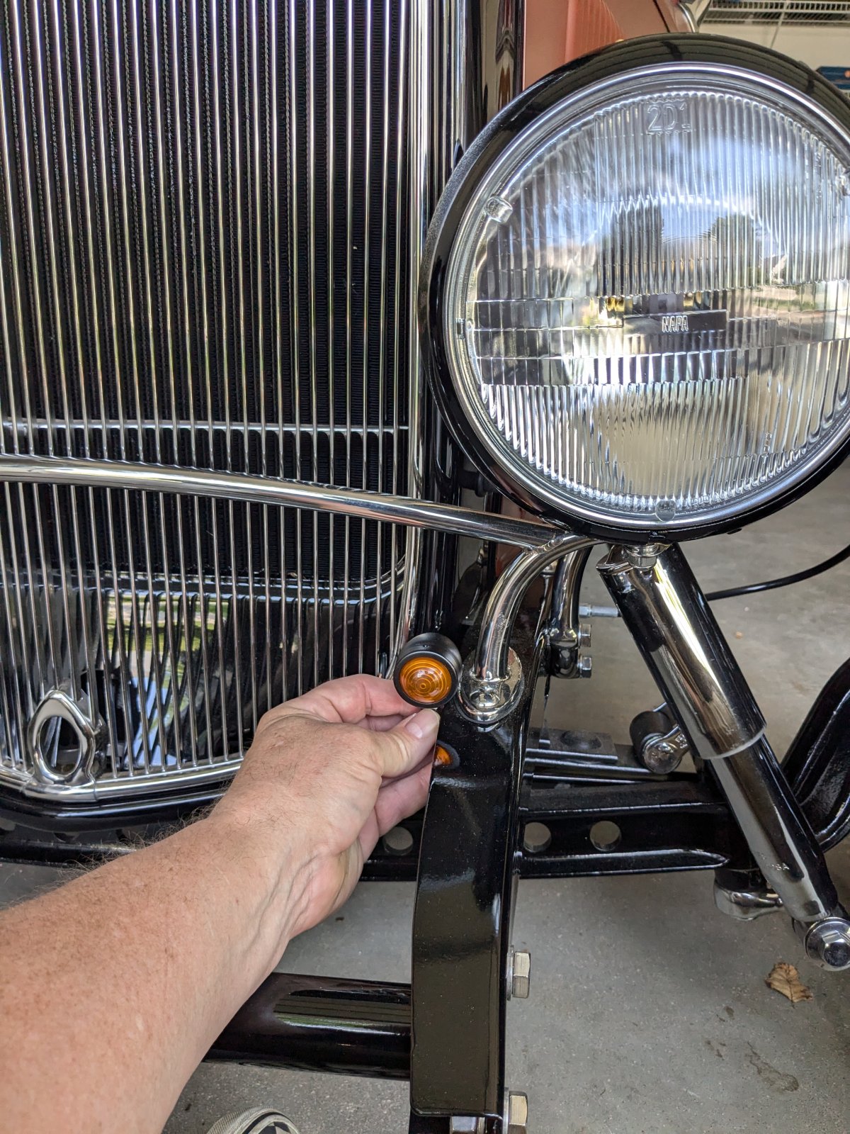

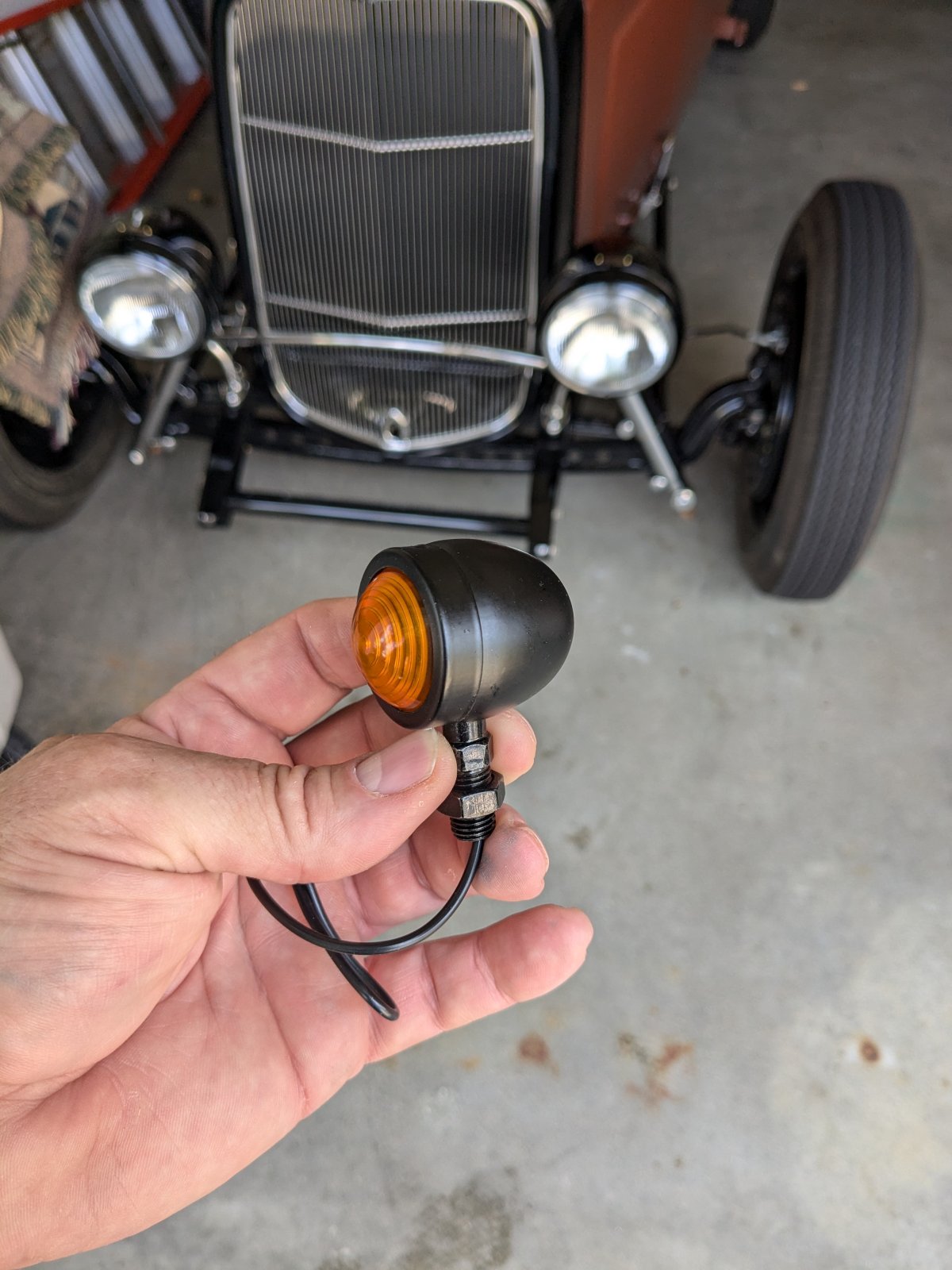

    I also have a few options for front turn signals (which I unfortunately have to have to get a VIN number in New Hampshire).
    The first is somewhat old school looking and fits in with the theme, but it's larger...
    The second is a little too modern for my taste, but is much smaller...
    My idea was that if I did the first option, I'd put it somewhere con****uous, if I did the second option, I try to hide it a little bit.
    Thoughts?

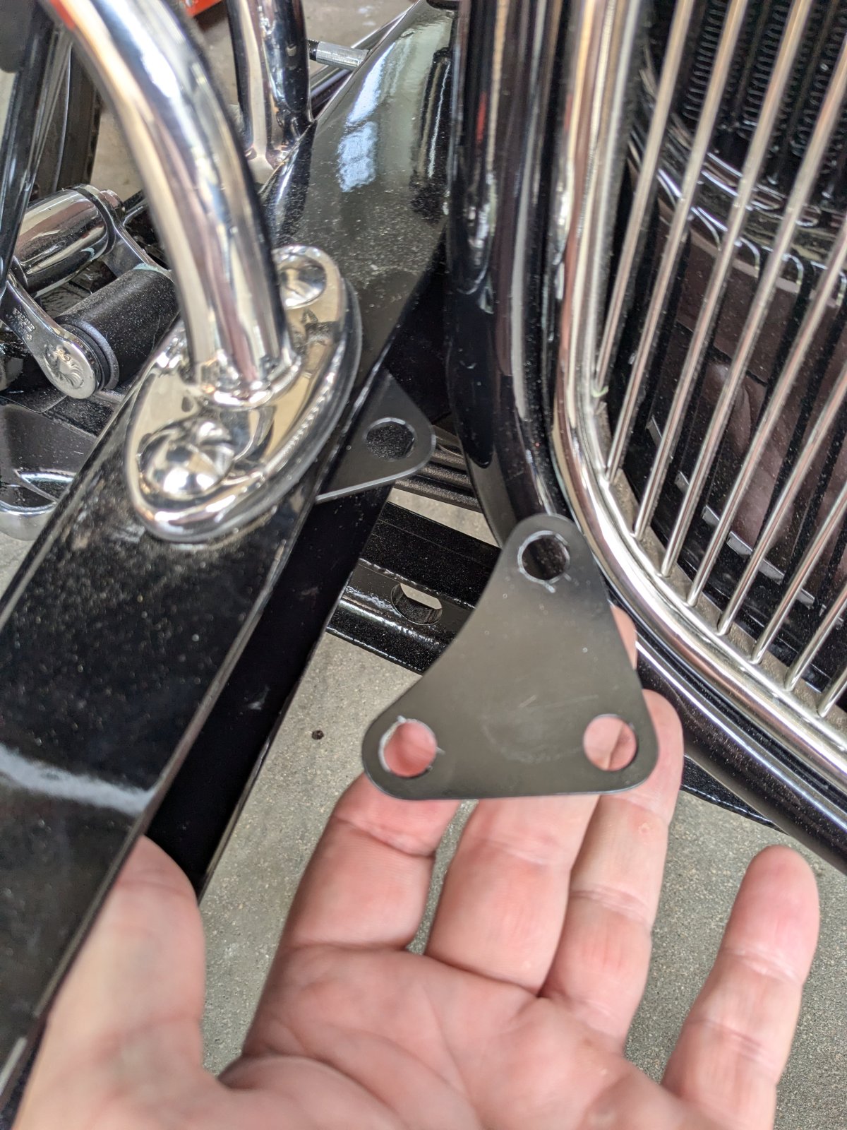

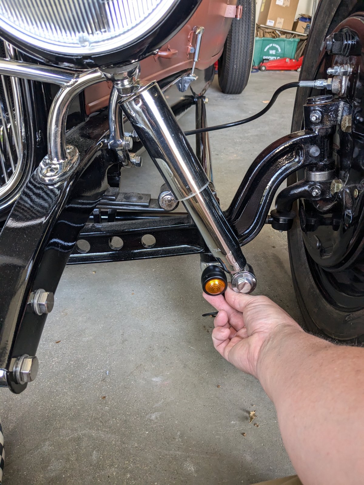

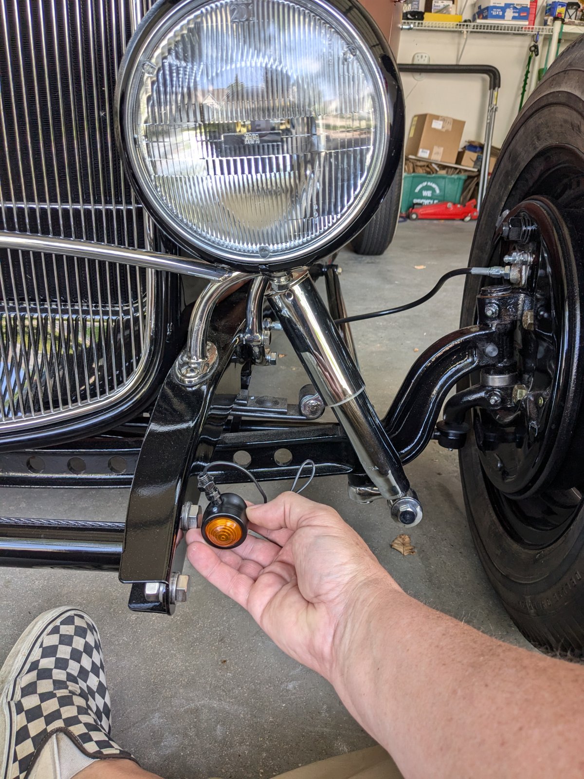

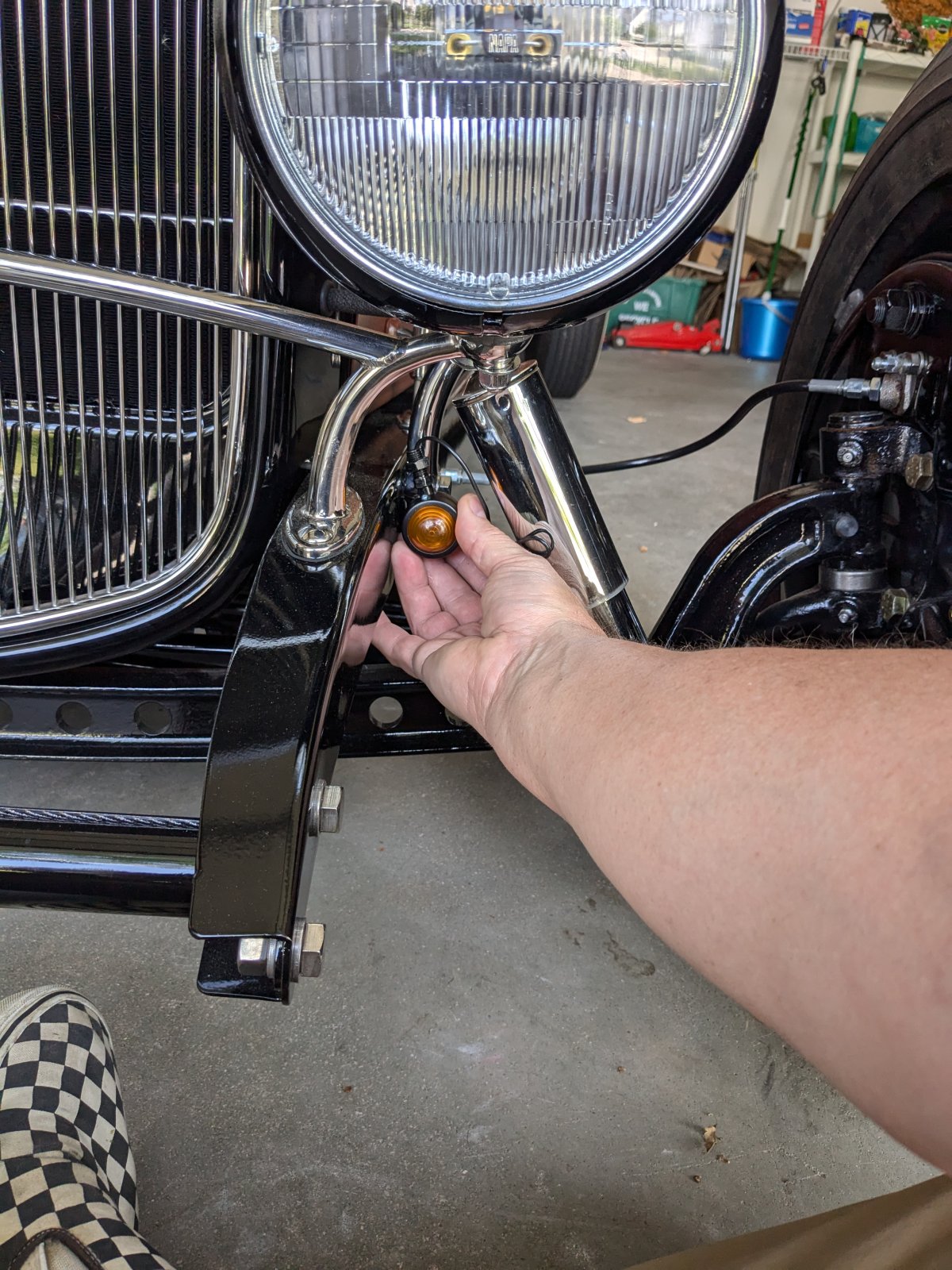

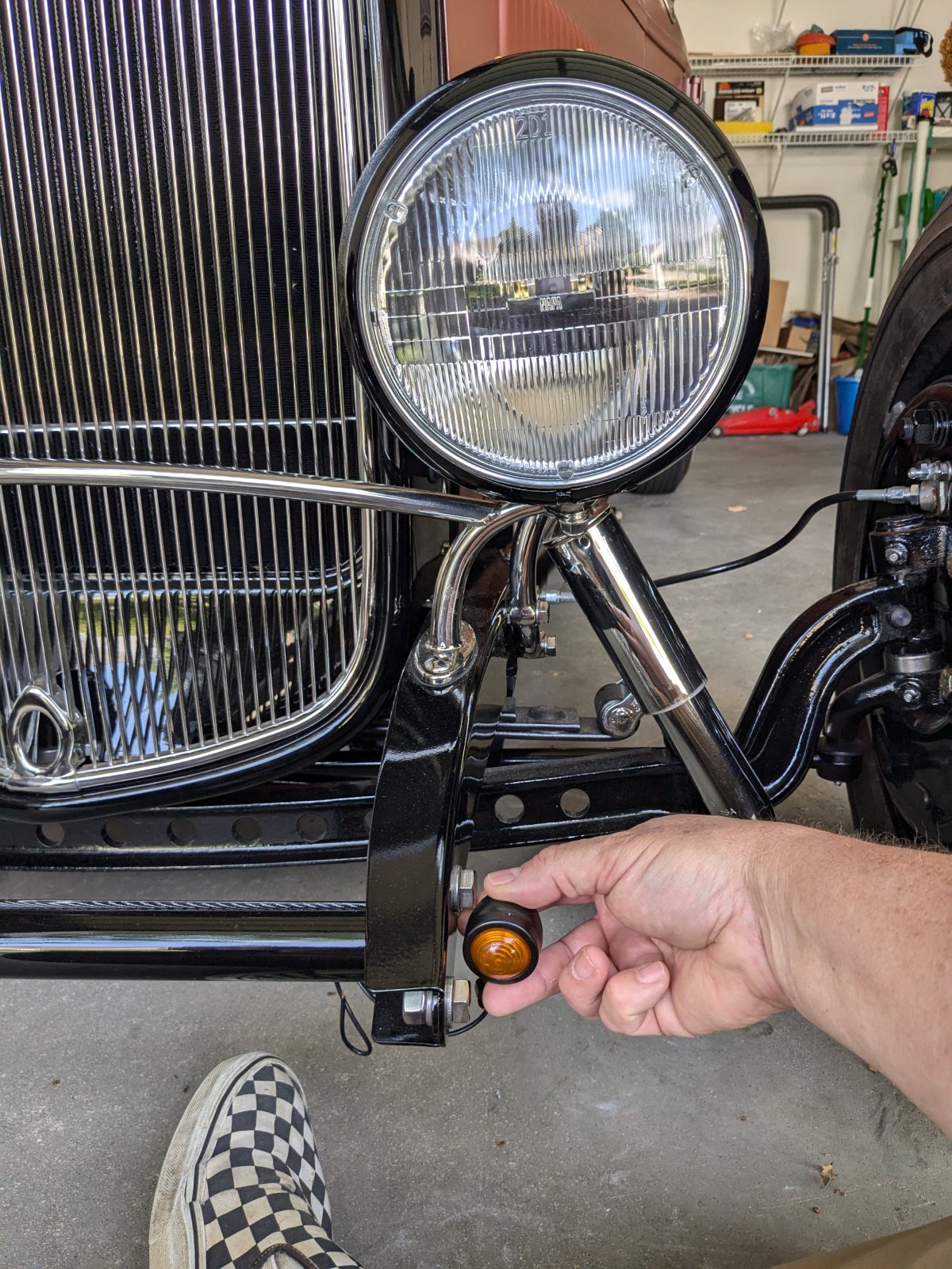

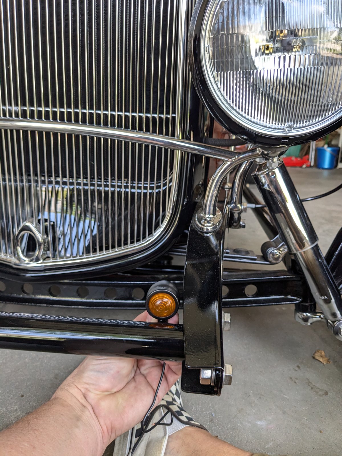

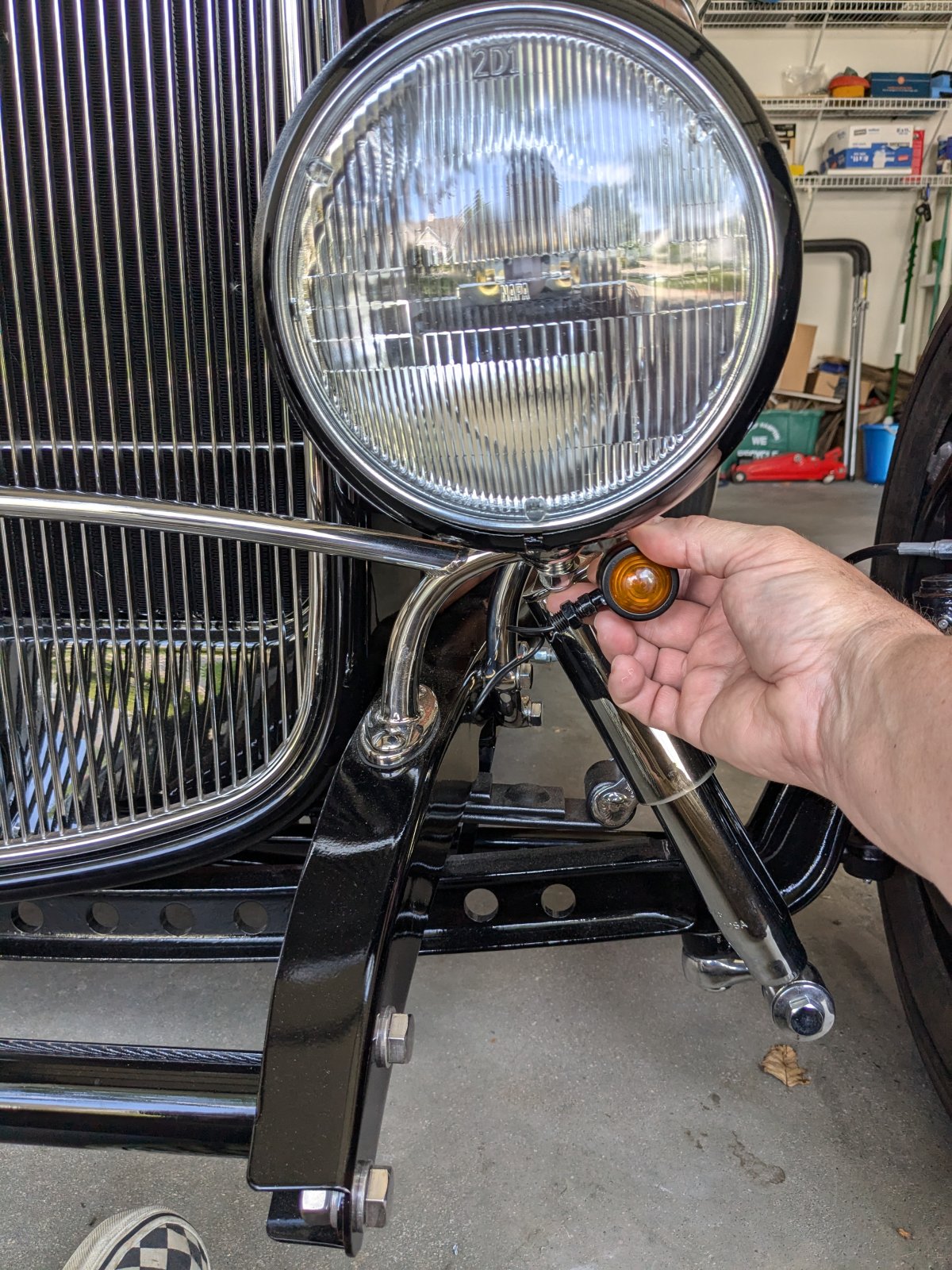

    I'm thinking that some of these positions are not con****uous enough... there's really no rules for where they have to be, but if I'm putting them on there, might as well make them be able to be seen by head on traffic at an intersection.
    Here's some ideas for placement...

    The blinkahs look good just behind spreader bar inboard of frame and that'll keep the DMV happy. Nice Van's, been wearing those since high school (BMXer)

    Can you hang the turn signal pod from the lower part of the headlight bucket, or inside edge of the bucket? (Where it doesn't conflict with the headlight reflector, of course).

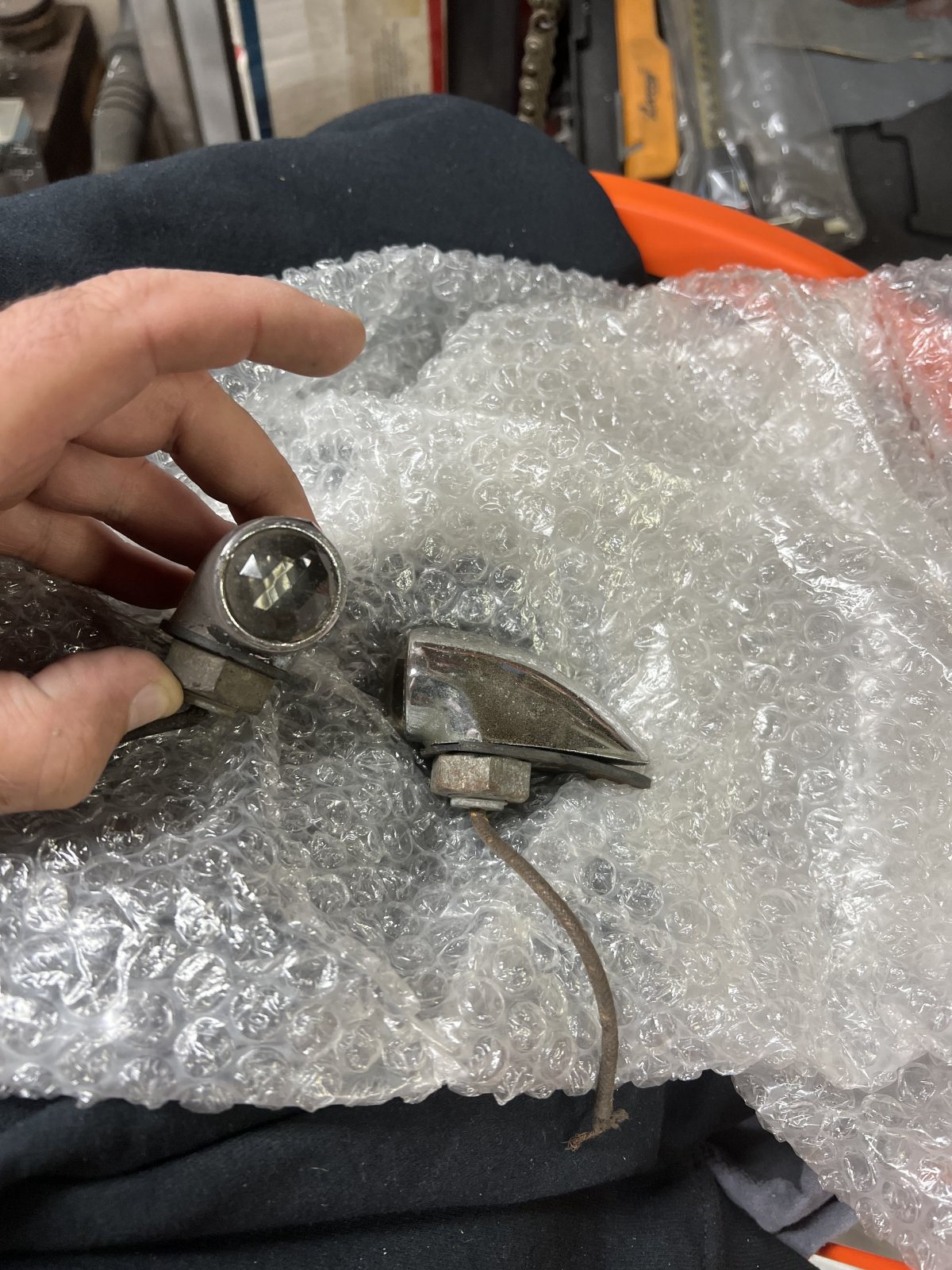

    What are those from?

    On my coupe I built a little L bracket out of aluminum that had a hole for the stud out the bottom of the headlight bucket.
  29. 19Eddy30
    Joined: Mar 27, 2011
    Posts: 3,915
    19Eddy30
    from VA
    I Believe they are Glide accessories,
    @ one time there was a Accessory Glide catalog , in a thread about 12 years ago
    Here on HAMB , I picked these up about 15 years ago , I believe they are 1940 ish , ?

    Non- permanent, cheap & easy front turn signals!
