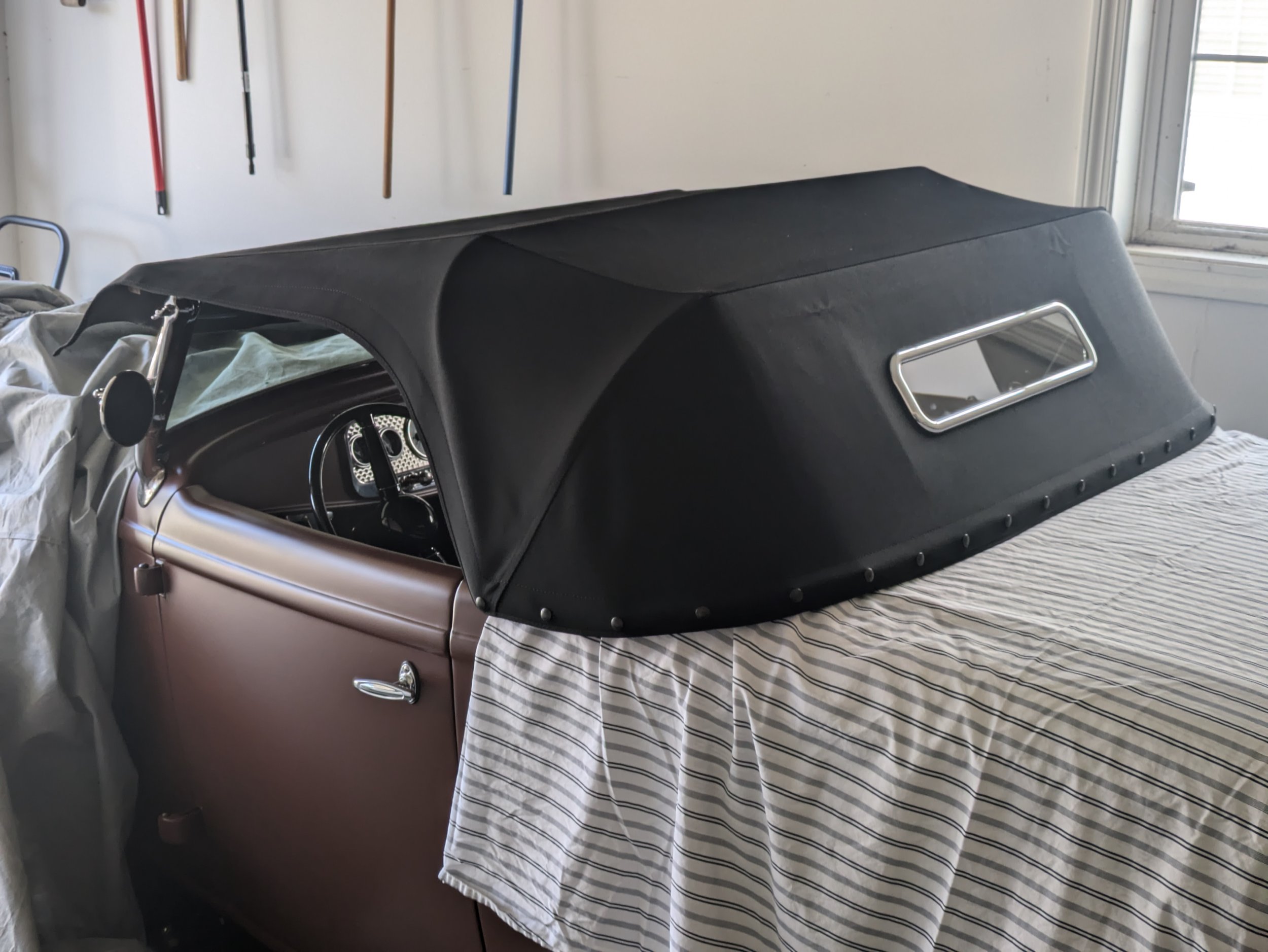

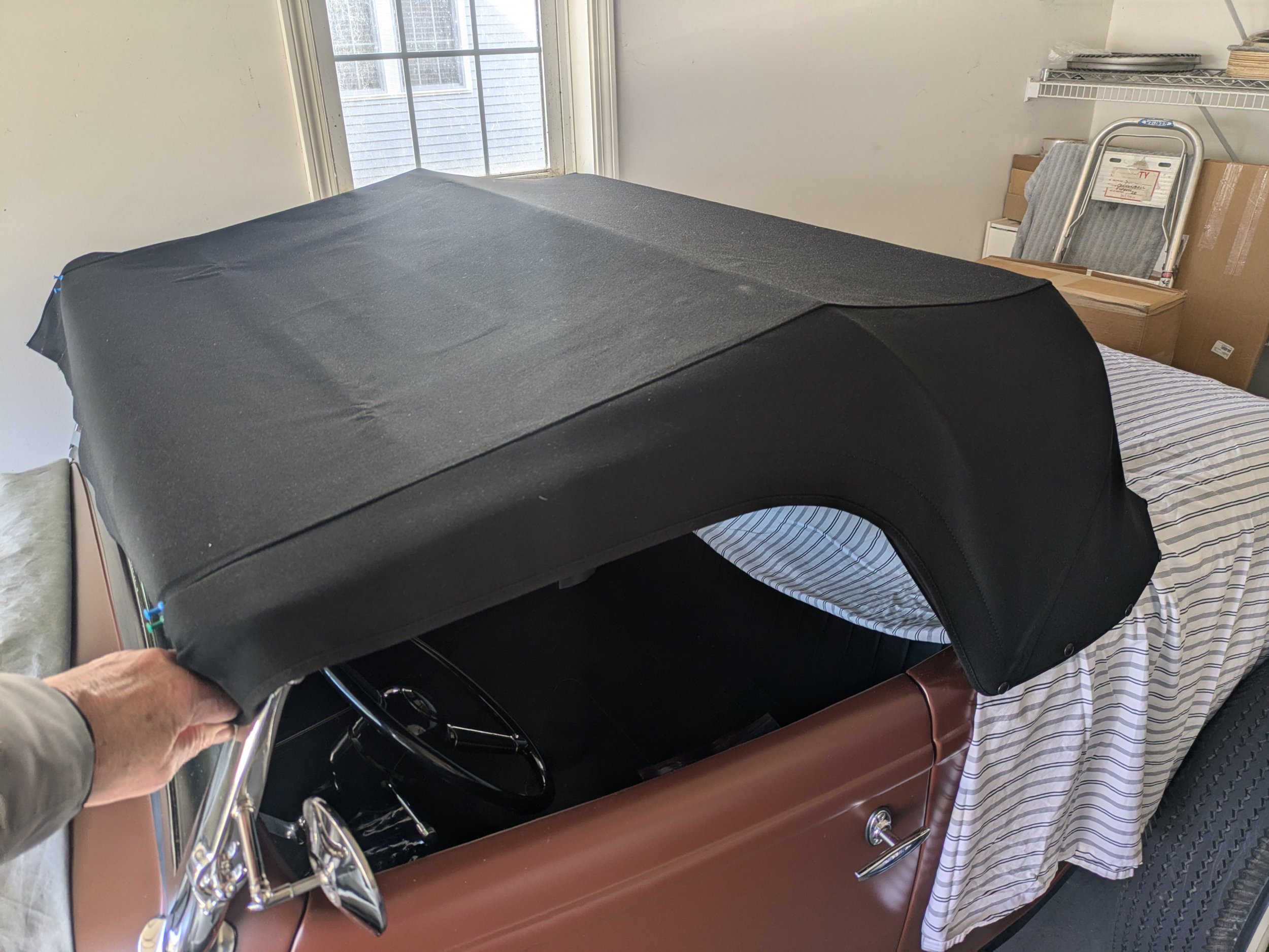

    Bop Top going together well.
    Made custom header-bow brackets in SolidWorks and 3D printed in stainless. This was necessary to properly accommodate the laid back windshield angles. Will post photos of the trial nylon prints when I get a chance. In the meantime, here are some photos of my progress... PXL_20250314_113553582.jpg PXL_20250314_181340983.jpg PXL_20250314_181506967.jpg PXL_20250314_181719757.jpg

  3. joel
    Joined: Oct 10, 2009
    Posts: 2,732
    joel
    That's one of the nicer tops I've seen. Does it have side curtains also?
  4. SDS
    Joined: Apr 28, 2011
    Posts: 1,056
    SDS
    Negative

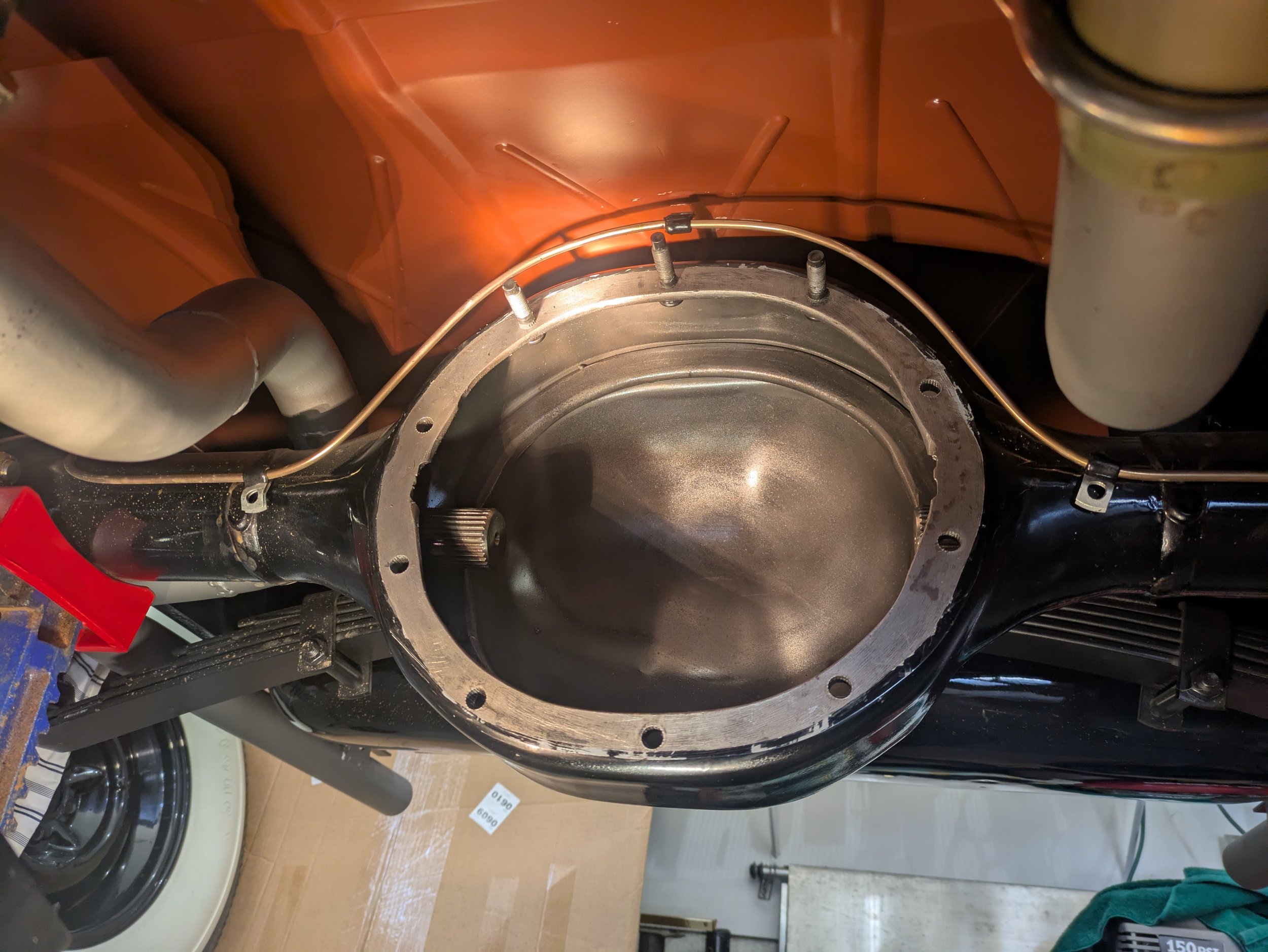

    I figured out what that boom noise I hear is when I hit a bump hard, as in Jalopy Hill climbing
  6. 19Eddy30
    Joined: Mar 27, 2011
    Posts: 3,901
    19Eddy30
    from VA
    Same on my sedan , Just because I do not want to notch , to set Low :D
  7. SDS
    Posts: 1,056
    SDS
    Beats the middle of the floor above the diff housing?
    I figure, sooner of later it'll metal form it's own little "hump" and no longer be a problem :p
    brEad and NoSurf like this.
  8. hotrodjack33
    Joined: Aug 19, 2019
    Posts: 4,877
    hotrodjack33
    Hahaha. LOL. That's basically the same principle I used to modify the grille bottom of my old '40/'37 pickup...it eventually flattened out nicely;).
  9. alchemy
    Joined: Sep 27, 2002
    Posts: 22,667
    alchemy
    Which caves first, the floor or the brake line?
  10. SDS
    Posts: 1,056
    SDS
    In the photo, the p-clips are bent upward to give access to the nuts. The brake line was not actually in-between the floor and housing. It's in the small recess over the edge of the pumpkin...very well protected.

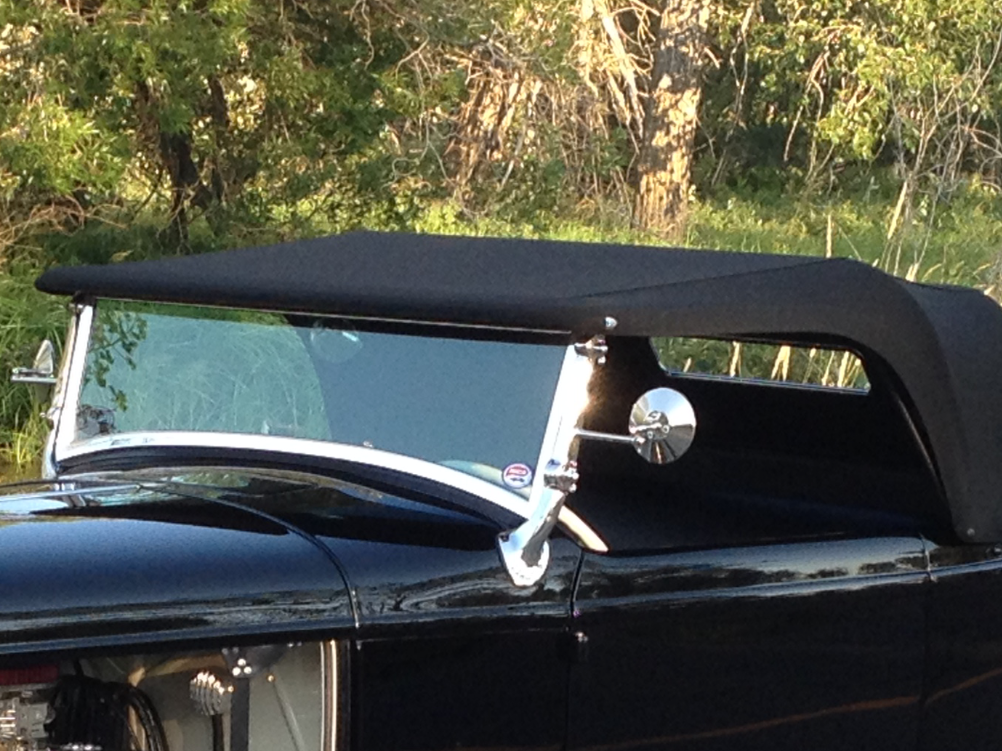

  19. RockyMtnWay
    Joined: Jan 6, 2015
    Posts: 601
    RockyMtnWay
    Interesting. I just switched from a two inch chop windshield to a three inch chopped one.
    Never liked the angle of the header before so I know I need to modify it even more for the new height. As I leaned the posts and didn’t mess with the wood header, it always looked like it was angled up. o_O
    My plan was just going to be adjusting (filing) the angle on the wood header where the frame mounts attach. Now you have me thinking. o_Oo_Oo_O
    This was the 2” chopped windshield.
  20. SDS
    Posts: 1,056
    SDS
    Keeping the windshield angle constant, if you change the height of the windshield/posts, you will independently change the angle of the tube which goes over the door. 3D printing allows for this to be easily and rapidly modified to accommodate. Nothing in my install is in a bind and the header-bow is dead horizontal.
    brEad likes this.

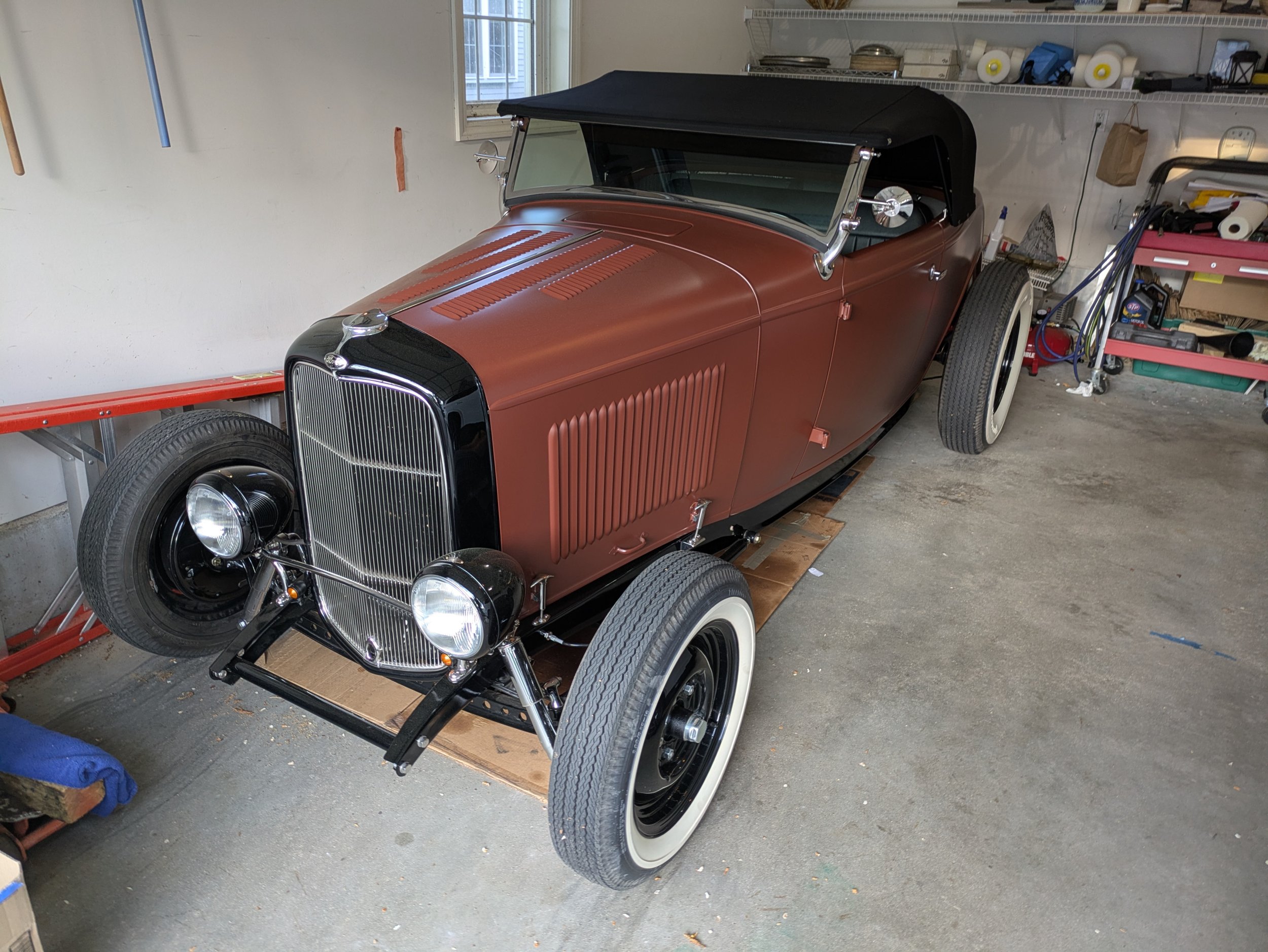

  21. SDS
    Posts: 1,056
    SDS
    Got it done, will post better photos when I can get it outside (raining for days here)...
    Paul B, brEad, VI Lonewolf and 9 others like this.
