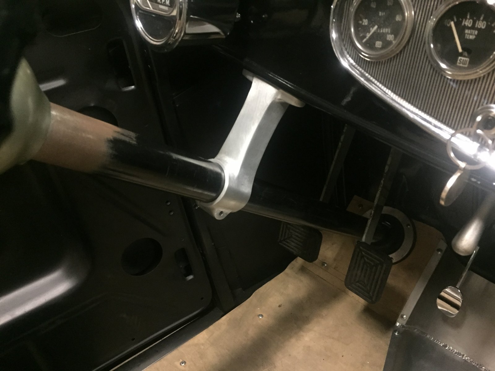

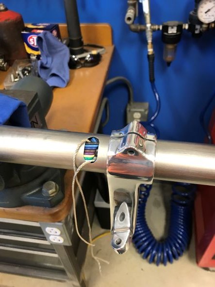

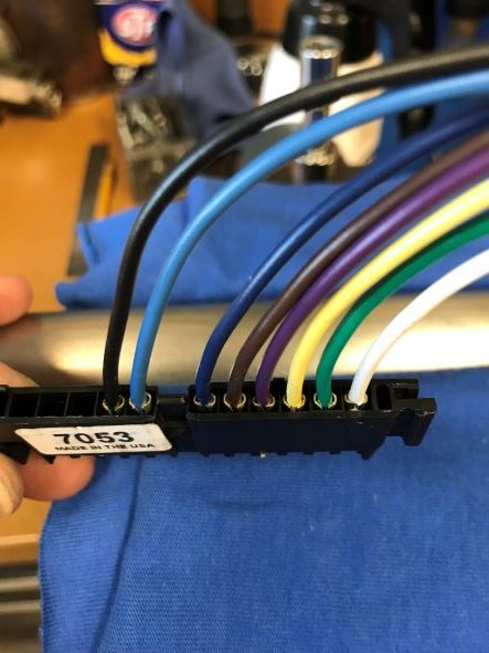

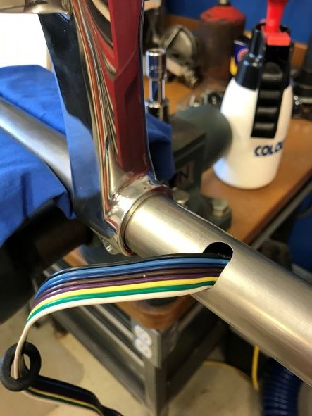

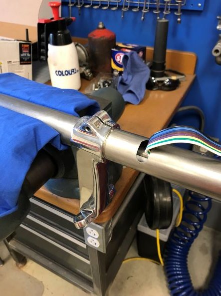

    Nice install of the steering column. Don't give up on using a Limeworks column drop just yet. I have a Flaming River column similar to your Speedway one. I ordered a 4" Limeworks column drop to use and when I tried to install it on the column I realized that there was no way to get past the wire harness sticking out of the column mast. When my panic attack settled down, I sat back and gave this a thought because I really wanted to use the Limeworks drop.
    First you need to remove the end connector on the wires, mine had a GM connector. Make a note or take a photo of where each wire goes before removing them. I think I used a small screw driver or the end of a paper clip to reach inside the connector and pop out the wire ends.
    Next I took the loose wires and lubed them up with some dialectric grease. I fed the wires back down the inside of the column mast tube towards the bottom. I tied a string around the wires to help pull them back out later. With the wires inside the mast tube, the column drop can slide over the opening and the string will p*** through the slot in the column drop. When you are ready, use the string to pull the wires back out and reinsert them into the harness connector.

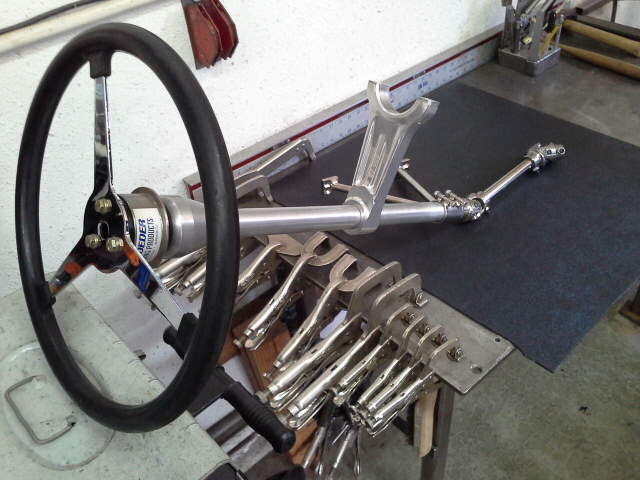

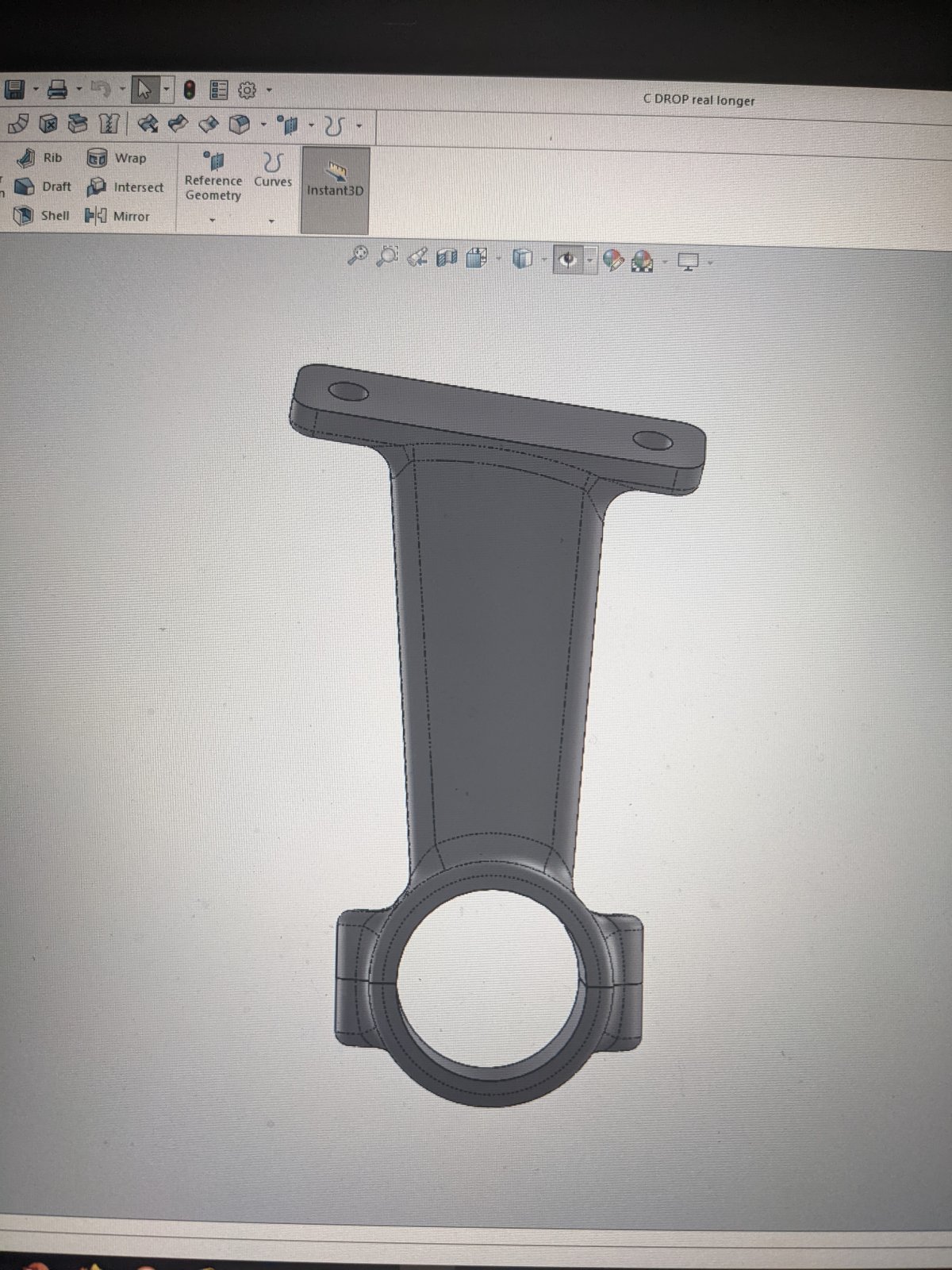

    I wish I could do that, the biggest problem is that they don't make a 5-in drop for a 1.75 inch diameter steering column. I think I'm going to design one in SolidWorks - with a cap like a connecting rod, and CNC it from billet aluminum (I'll blend all the corners & edges to keep it traditional looking)... Or, maybe I'll 3D print it from wax and investment cast

    Or use the real thing, got this at the CHRR swap meet, I was collecting pieces for my roadster long before actually getting my body.
    I made my own column so used the small end.

    I understand it's not traditional to speak of modern fabricating techniques and equipment, however, I think a person should take advantage of what he knows and has access to. Make it.

    Doing it... designed in SolidWorks, 3D printing mockup now - once I've confirmed the design is sound, it'll get CNC machined
    from a block of aluminum

    Very nice. I needed the same 5” drop for a 1-3/4” column for my last build, and ended up taking two of the drops from Hot Rod Works and welding then together. Wasn’t cheap but it got the job done!

    That's a beautiful design, I like the split clamp for the column. I wish I had the ability to design parts with CAD and do CNC machining, it opens up a whole new world of parts that can be made.

    Anderson
    Sorry, don't know why I said that. They were from Limeworks.

    Last car I built, I did the same to make a 4 1/2" drop... except for that I band-sawed the Limeworks column drop in half through the waist, then added a band-sawed u-shaped aluminum extension to the middle. After grinding, sanding and polishing, it looked like it came that way (saved me from buying two column drops and scabbing them together too).
    I would do that again in a heartbeat, it's much easier than CNCing a whole new drop, but because of the wiring harness exiting out the side of the column, I need the two-piece cap on the bottom.

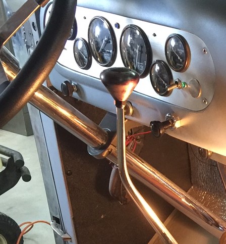

    Not nearly as elegant as your design, but I used a 2 pc. shaft collar for the drop on my F-1. I didn't want to mar the stainless column. Filled in the blanks with mild steel and painted it. (bad cell phone pic) column drop.jpg

    The first 3D printed model was a great learning tool - I realized that the drop is a little too much and that a few of the angles are off by a degree or two. I will adjust the SolidWorks model and print another one tomorrow...
