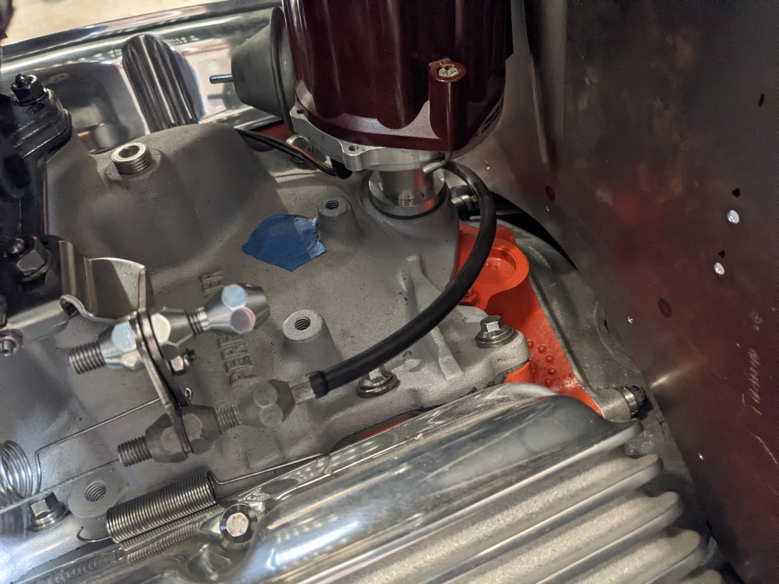

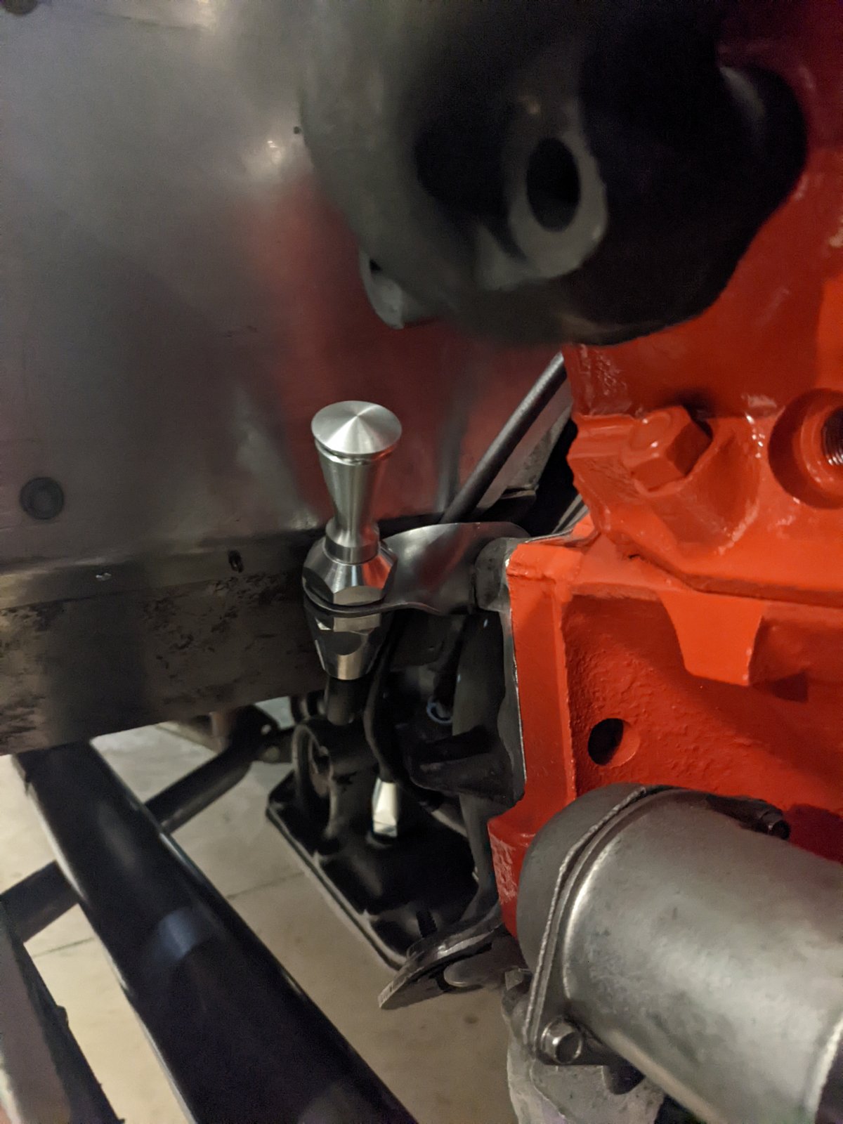

    Made a bracket for the firewall mount Lokar transmission dipstick tube so that it melts to the transmission bolt instead. Covered the braided stainless hose with black shrink tubing... Did the same with the kickdown cable. I'm going to turn the dipstick handle to look like my art deco Socal dashboard knobs.

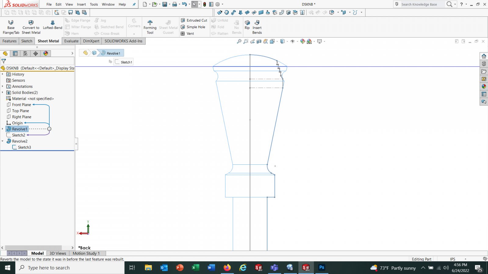

    De-billetized the Lokar transmission dipstick knob -made it looks art deco like my SoCal art deco dash knobs...

    Dip stick knob, did you reshape the Lokar item, or start with a fresh billet?

    Thanks - I re-shaped the Lokar knob, figured it out and CAD and spun it up on a Hardinge...

    Tried like hell to use a stock GM dipstick tube, but it was too invasive into the trans cover on the p***enger's feet.
    Bought the LOKAR firewall mount dipstick tube and realized that the movement between the engine rocking and the firewall might induce leaks, so I decided to make a custom bracket and mount it to a trans bolt - all happy now

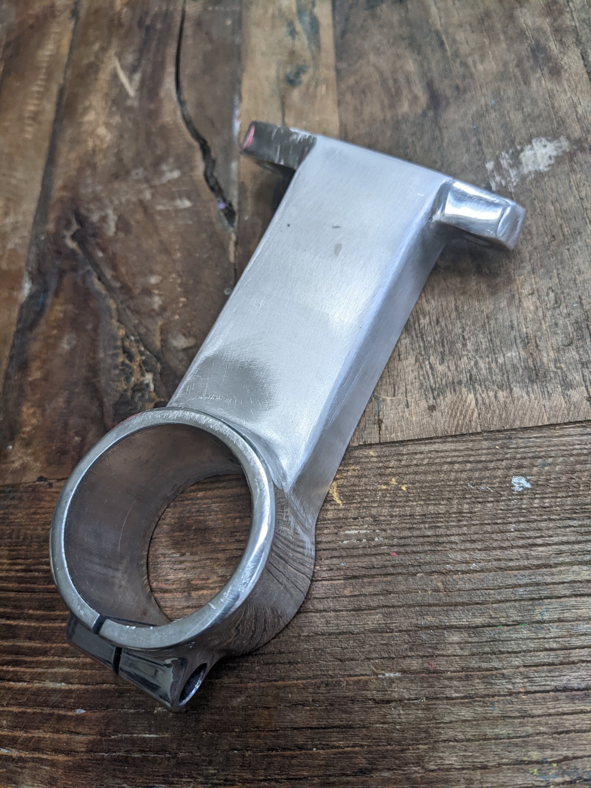

    I'm works finally has the 4" long 1.75" diameter column drops available...too bad I need a 5"...
    PXL_20220626_150329062.jpg Going to shape it, then TIG weld it. Has a 3/8-16 bolt down the middle for strength.

    Welding a Limeworks column drop is not a job for anything but an expert TIG welder. Lots of junk in the casting. Imperfections will need to be drilled-out, filled, then finished. I might have it chrome plated to hide the off-color filler.
