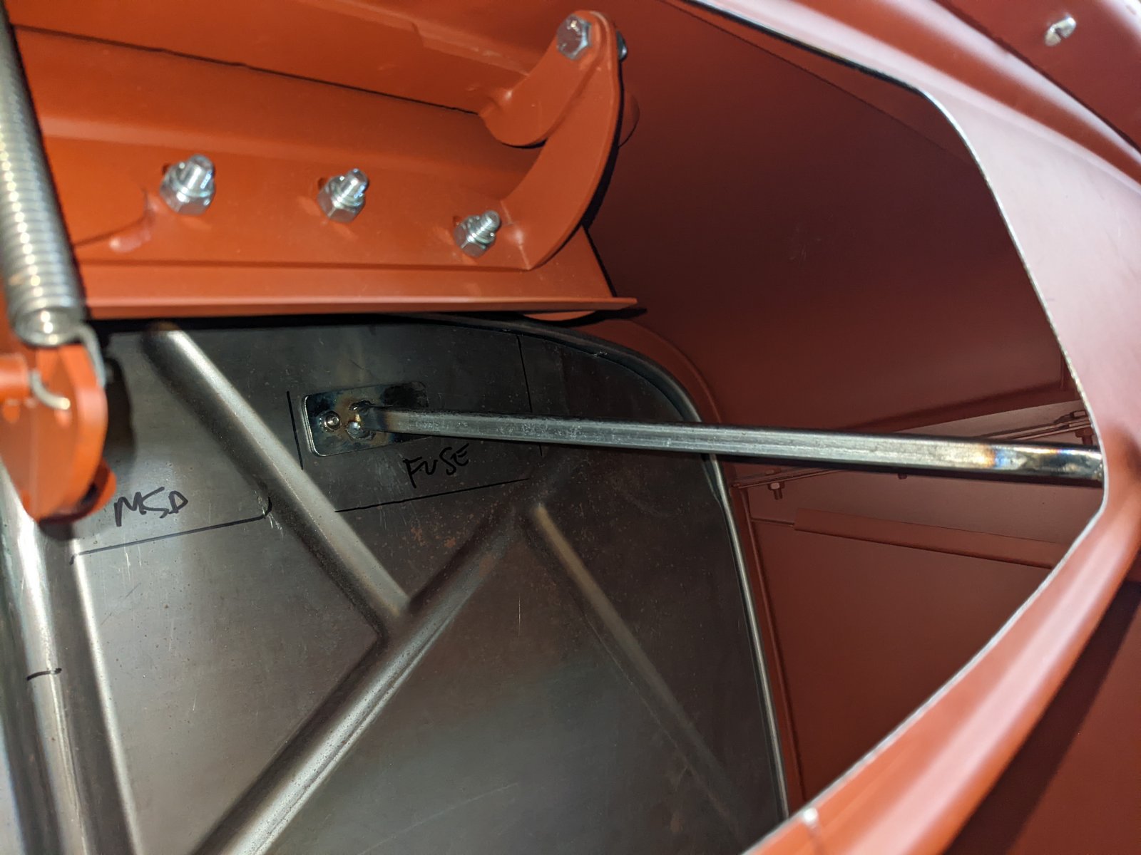

    SDS

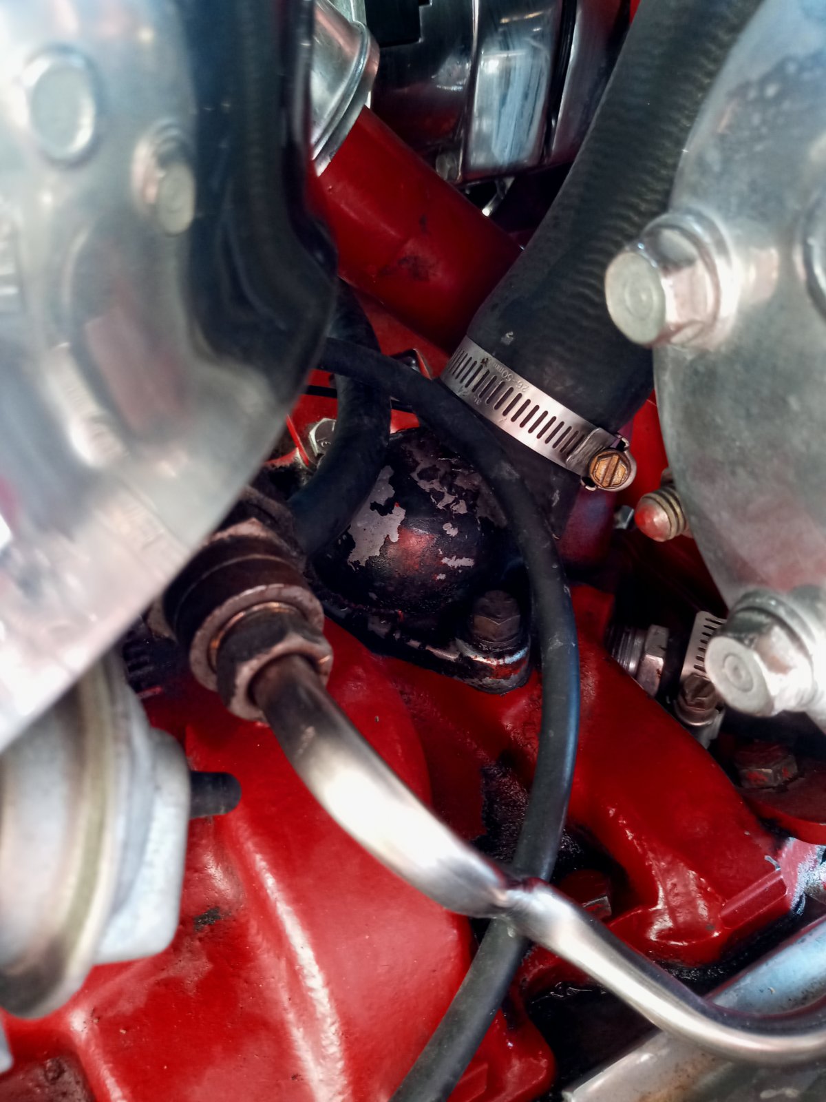

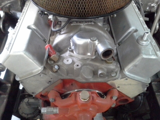

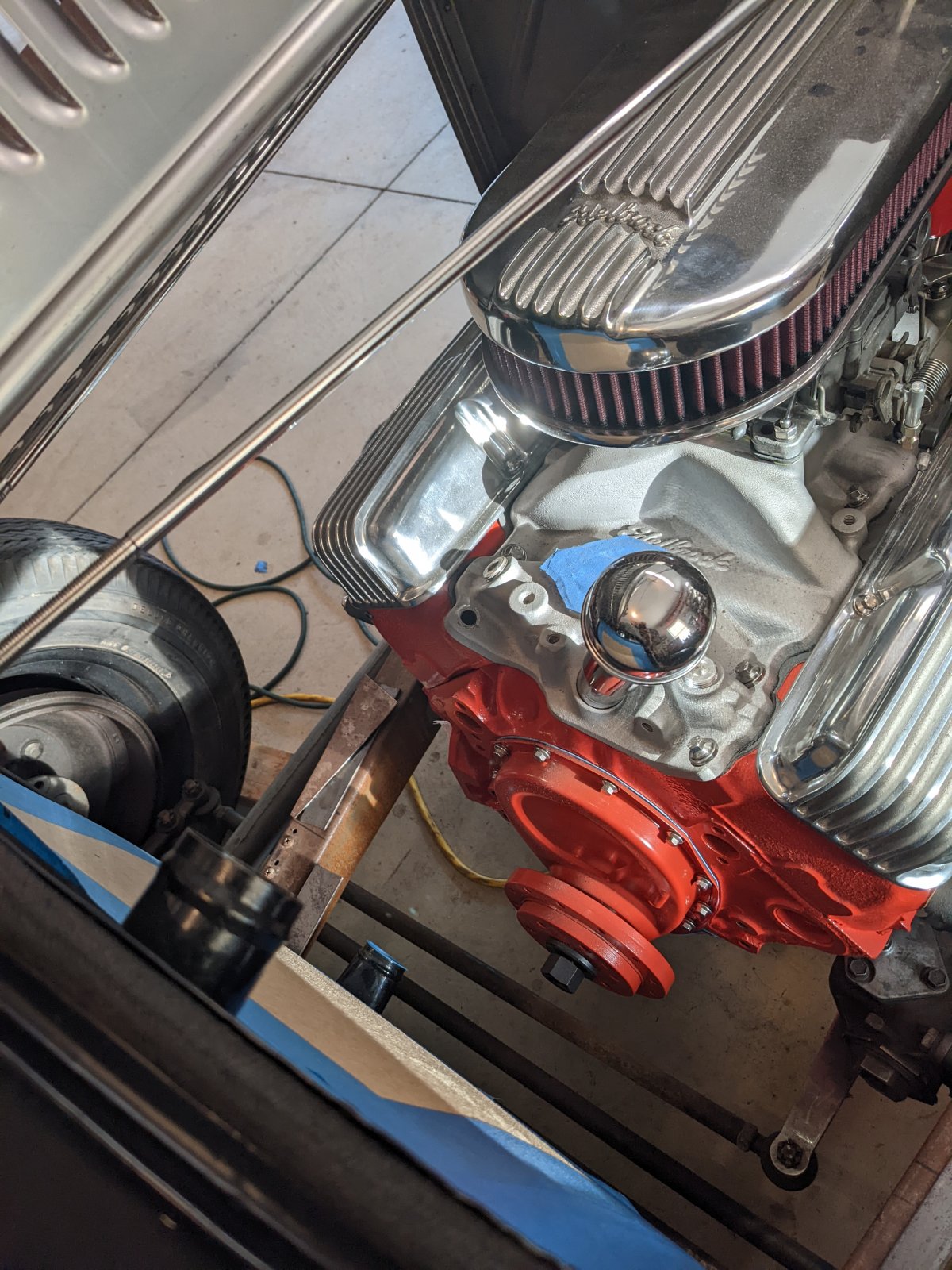

    Those are great suggestions and I think you guys for sending me those part numbers... I'm going to give it a try, but I think I'm going to regret installing that breather tube on my intake manifold

  8. @SDS it looks perfect on there!
  9. SDS
    Joined: Apr 28, 2011
    Posts: 1,060
    SDS
    Uh, sorry...what looks perfect on there?
  10. The breather tube.
  11. SDS
    Posts: 1,060
    SDS
    Thanks...Unfortunately, it's in the way of all the waterneck/hose combos that everyone haa suggested. Envisioned myself removing it in the near future :(

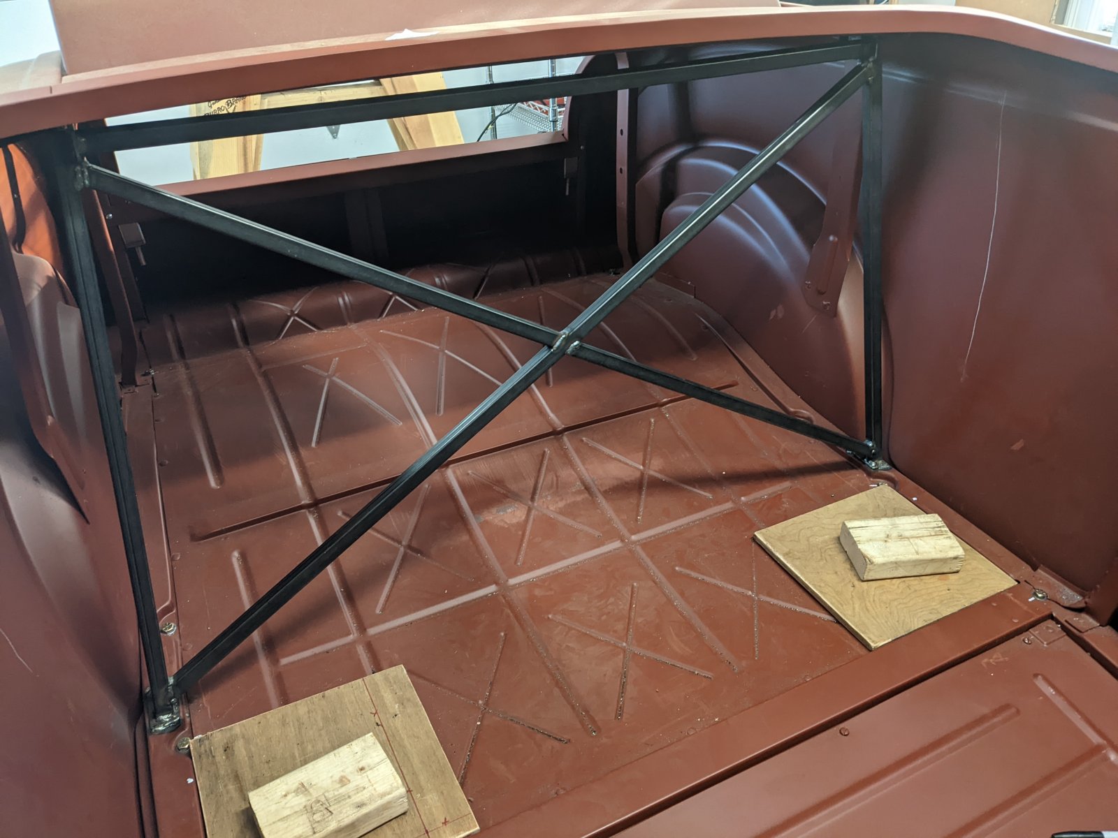

    Thanks to "wildest" for sending photos of his behind-the-seat cross-bracing. Besides his car making my heart race, the pix were great reference...
    PXL_20220701_224328748.jpg PXL_20220701_224353633.jpg PXL_20220701_224404292.jpg
    Tied the top into the body using one of the bolts that hold the seam together

    I did one almost exactly the same. Welded.

    Had to reorient the water neck on the engine in my 66 Suburban, this is an OEM Chevy cast iron water neck that came on many 60's hi-perf small blocks.
    I whittled out two 3/8" aluminum plates and rotated everything to satisfy the radiator hose hookup then had my buddy TIG weld them on the inside

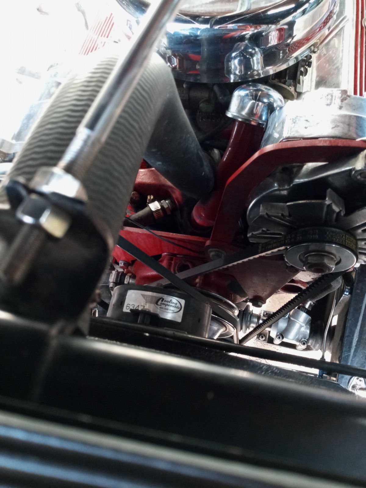

    My thermostat housing is pretty much straight to the front. The oil fill tube was pie cut to clear the alternator.

    Thanks, I'm trying that next... anyone have a part number of a similar neck?

    You could swap the neck and filler from side to side.

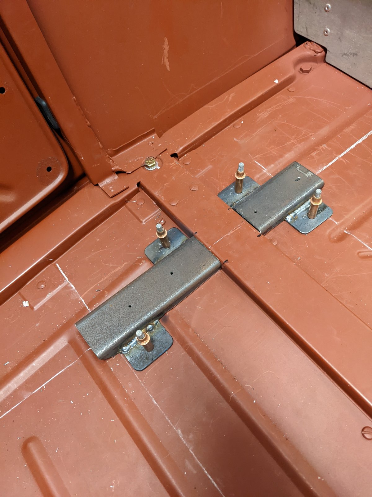

    Made the dash struts this morning - the plates on the firewall bolt on with the bolts that hold the radiator struts. There's a quarter inch plate over the steering column drop PXL_20220702_180527022.jpg PXL_20220702_180536836.jpg PXL_20220702_180558653.jpg PXL_20220702_180606994.jpg ...

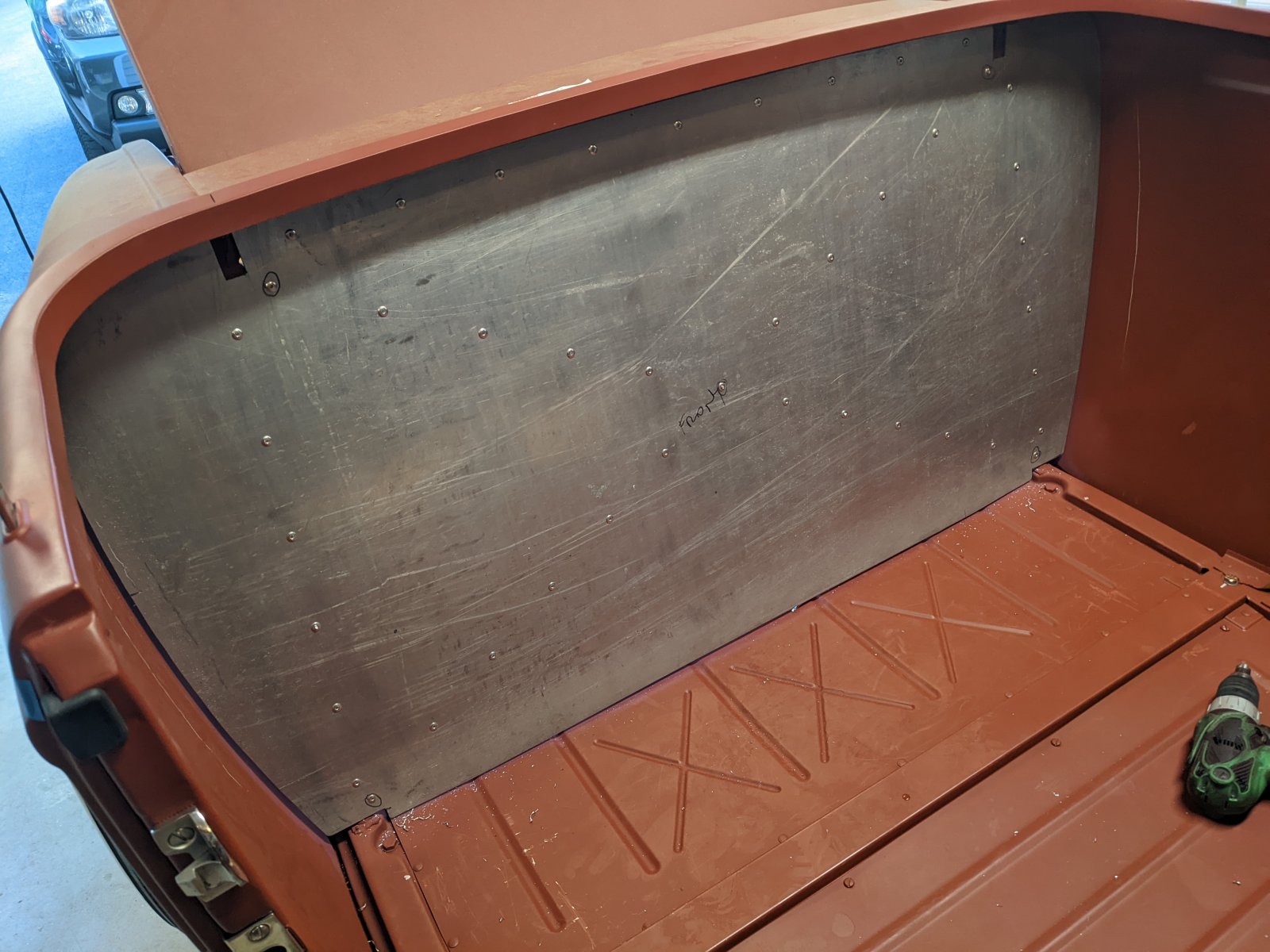

    Have been dragging around a sheet of 1/8" aluminum for 15 years, moved quite a few times
    Finally found a use for it, rear firewall mounted to the cross-bracing. Left 3/16" - 1/4 inch gap all the way around to allow the body to flex. 3/16" pop rivets every 4 inches into the cross-bracing.

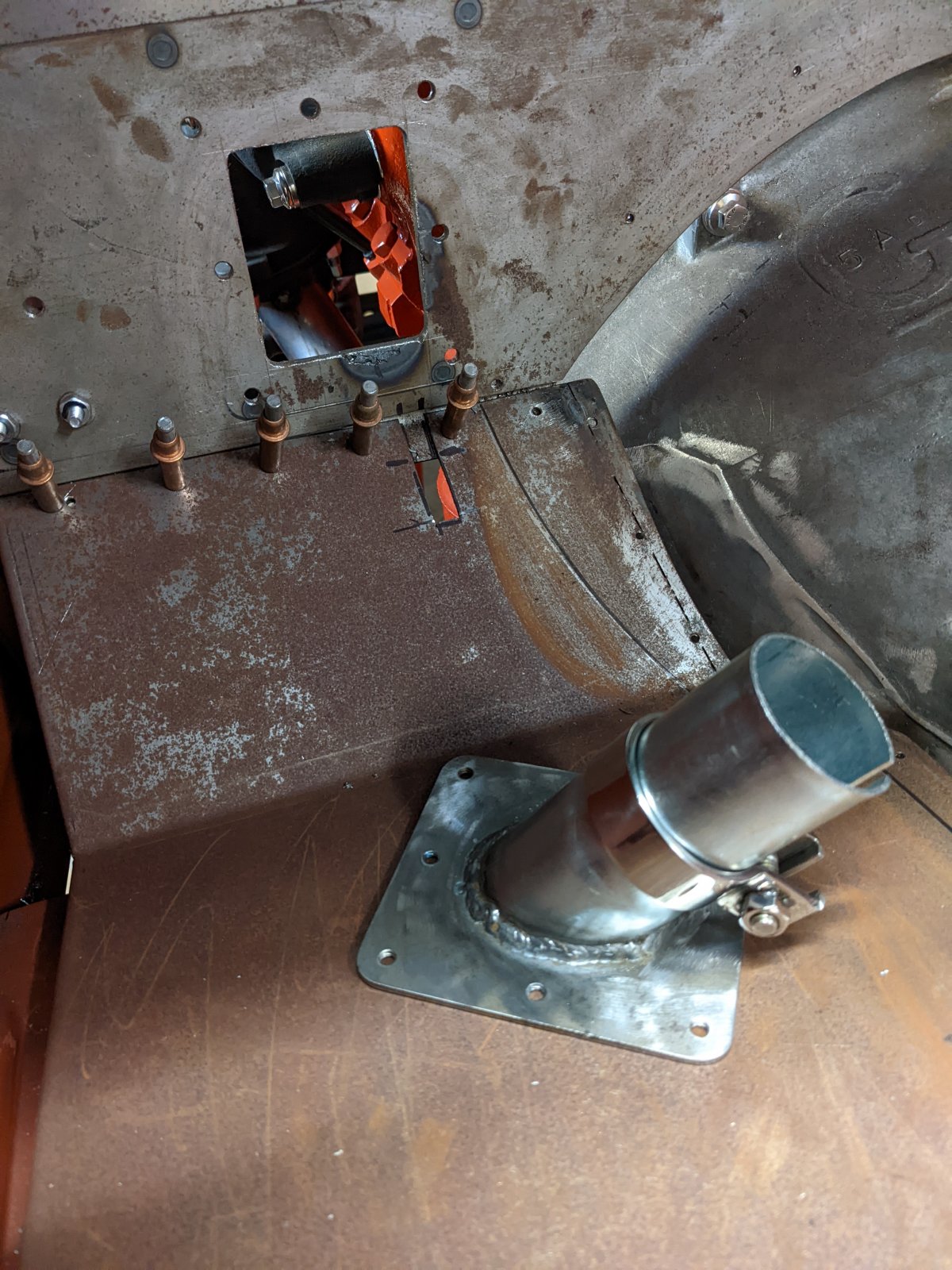

    Got a column collar from Drake - they're on clearance sale right now. Welded to a plate, mounts to a square hole in firewall. The snout goes on the engine bay side of the firewall and really makes the column solid

    SDS
    That's an interesting idea...it's pretty unbelievable how much what I did stiffened the body - noticeable difference when you shut the doors, much more solid

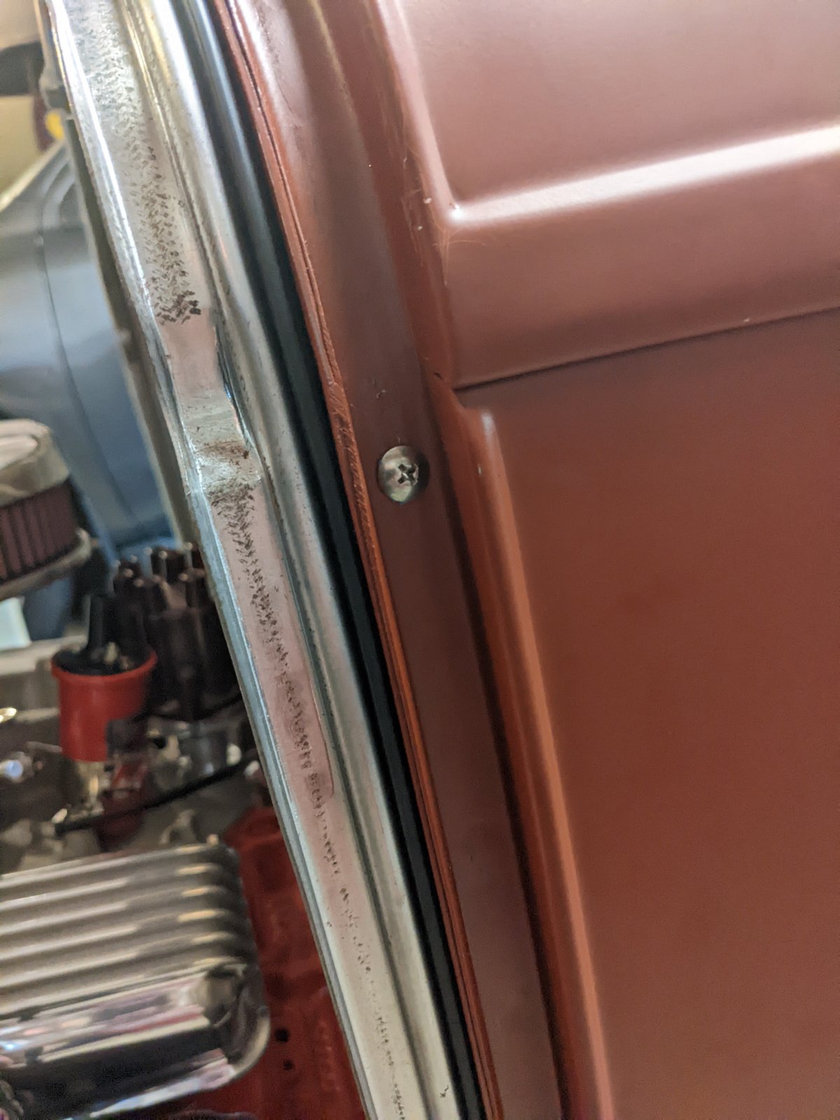

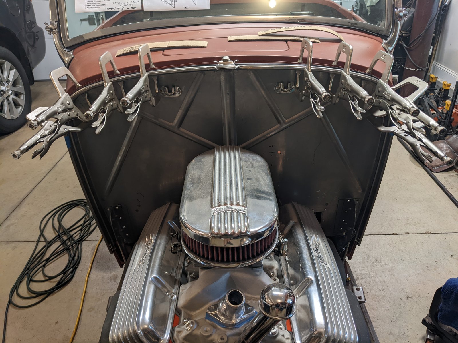

    The Brookville screw -

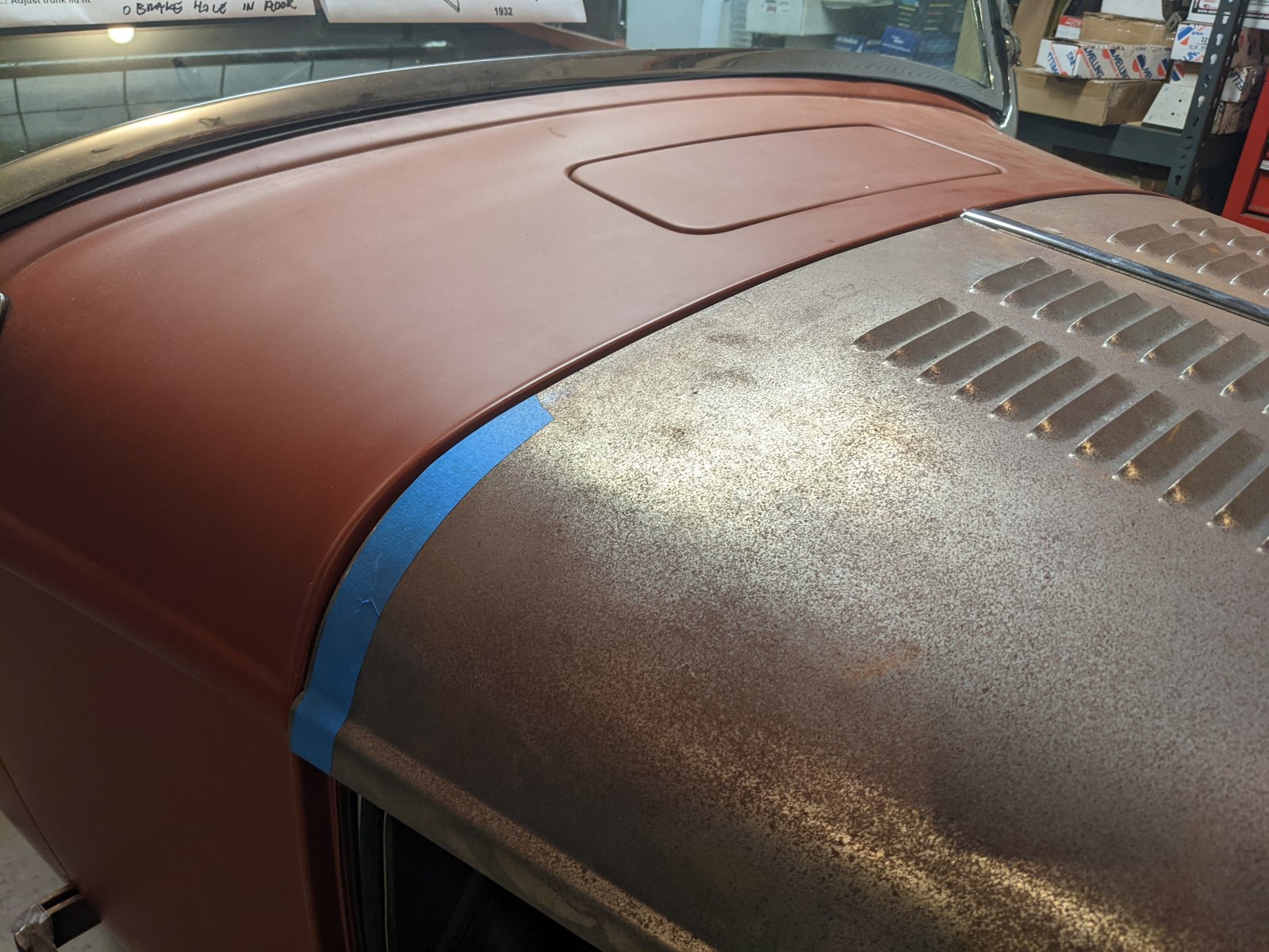

    Talked to Brookville's shop guy yesterday. To remedy the "not so tight" cowl to firewall for I have, they suggest clamping it from the center out and then drill/insert a #10 screw 1/2" below the belt line bead. I don't really want a visible screw there, but if it works, it's certainly an easier fix than alternate methods. The hood will hide the screw heads.
    Haven't drilled the hole yet, but put tape over the seam and clamped it... definitely moved 1/8-3/16" downhill.
    PXL_20220714_111736838.jpg PXL_20220714_111742057.jpg PXL_20220714_111748697.jpg
    shortypu and oliver westlund like this.
  25. SDS
    Posts: 1,060
    SDS
    Well, I got screwed.
    Started with a #10 screw on each side, 1/2" below the belt line bead. That helped, but didn't solve the problem.
    So, then I decided to put another screw in where the real problem is on top. That really about fixed the problem.
    Now, I have to beat the lip up a little bit to get the rope higher in a few spots and everything will be good.
    Right now, I have the cardboard strips (I mentioned previously) underneath the rope in a few spots.
