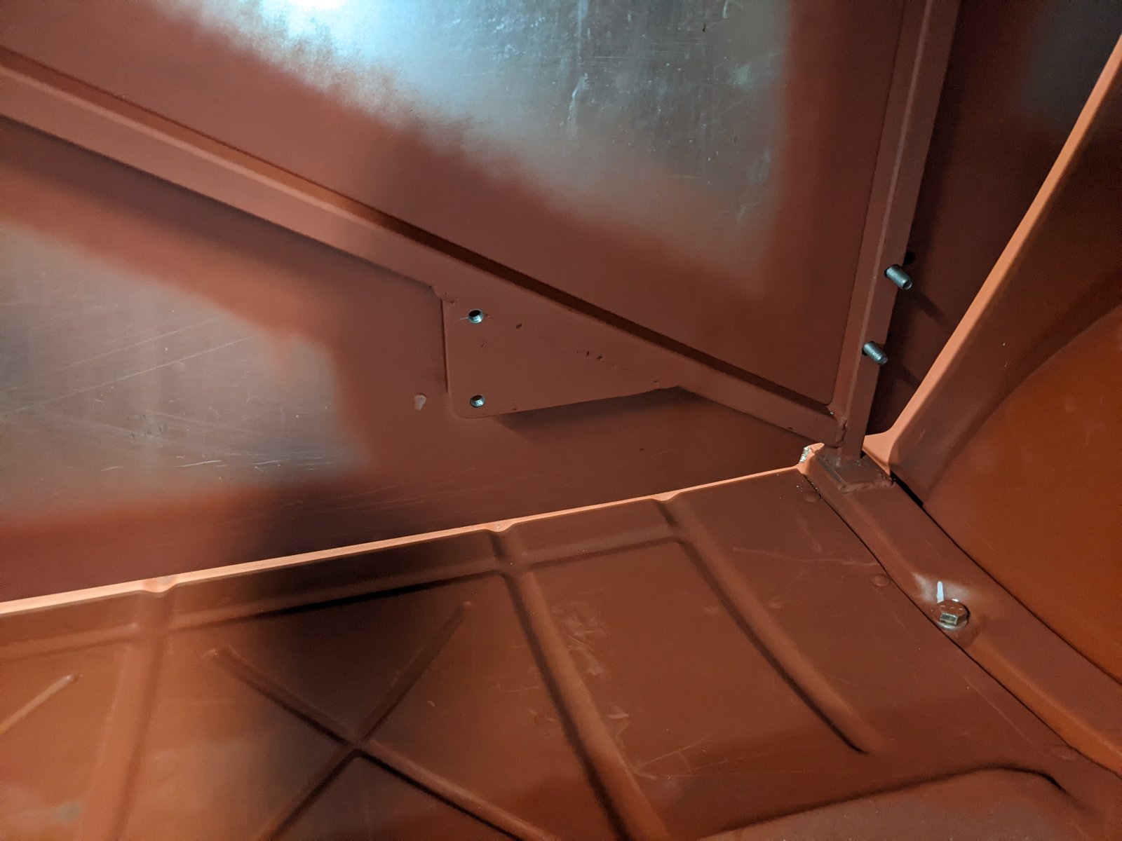

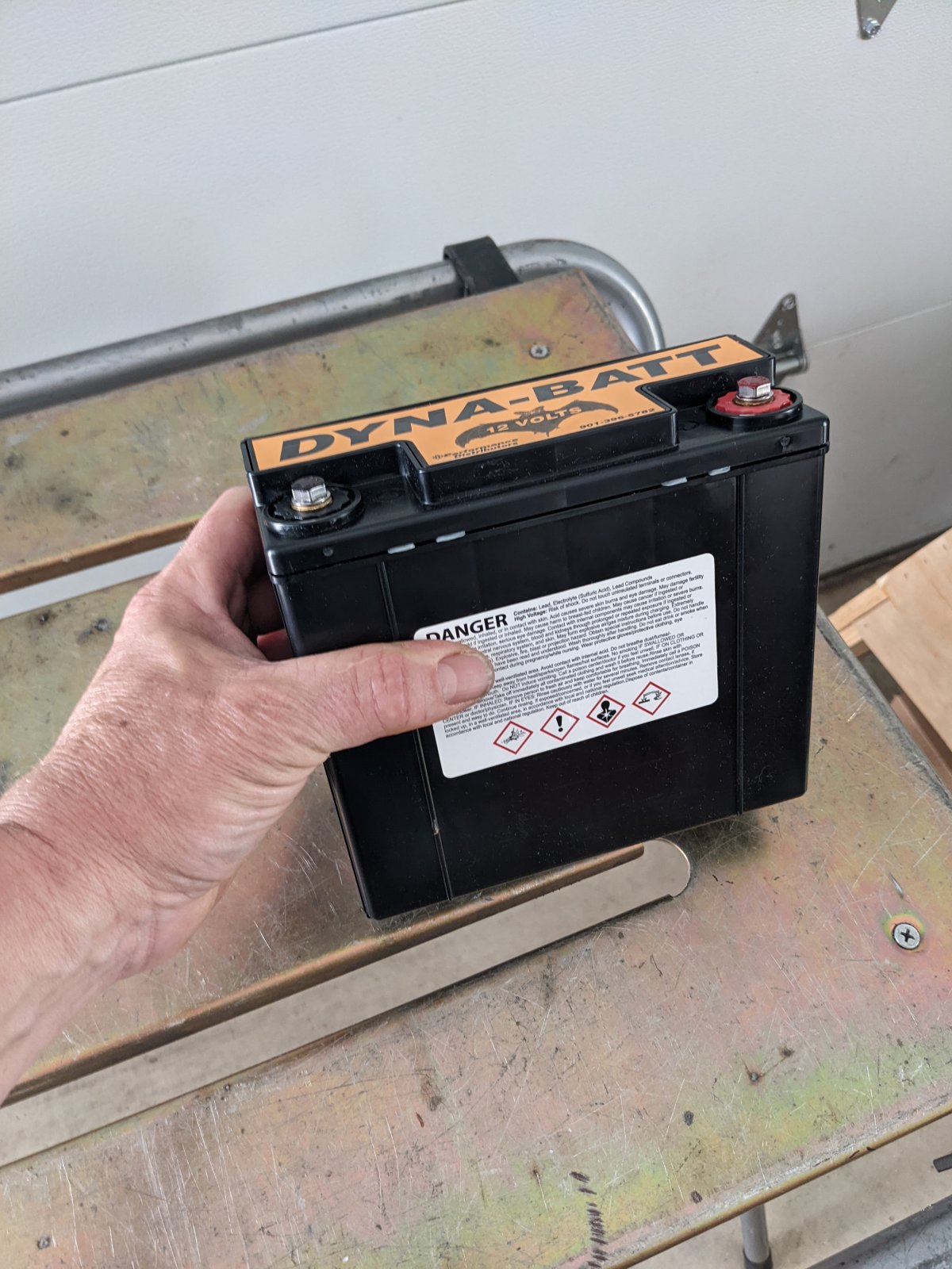

    PXL_20220724_201301967.jpg PXL_20220724_201322877.jpg Just got the Dyna-batt from Summit, battery box coming separately from Nevada.
    I intend to mount the battery box on the x member I installed back there for the rear firewall.
    I look at it but just can't believe that that's going to actually start my car over and over again. Makes me laugh.

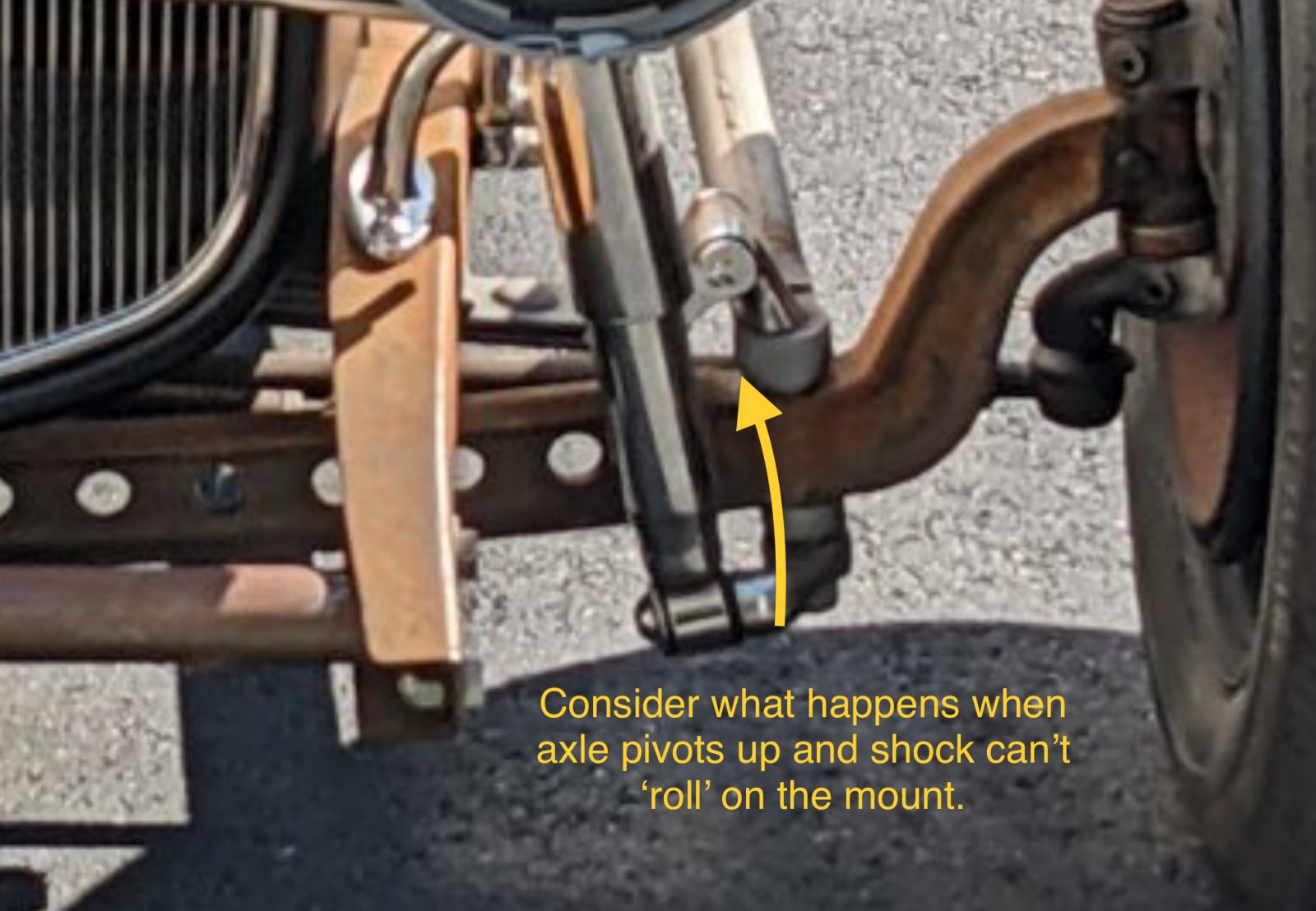

    I note unconventional lower shock mount orientation.

    Bought my first Dyna-batt approximately 15 years ago, the first one lasted 11 year's. The second one still has plenty of power.

    Unconventional lower shock mount orientation?

    Per lower shock mount orientation.

    Is i t not OK like that? Should I flip them back? I did not put them on like that, maybe the guy who built the ch***is did?

    I’d turn them out so they match the same orientation of the top mount.

    Yes they should be changed to similar orientation as the top mount!

    OK - thanks for the responses...especially from X38 for pointing that out. I can see how that orientation would cause binding problems. I did not put them like that and have no idea how they got in that orientation.
    When I put the eyes parallel, should I have them both outboard of the kingpin or inboard? Probably looks better inboard, but works better outboard.

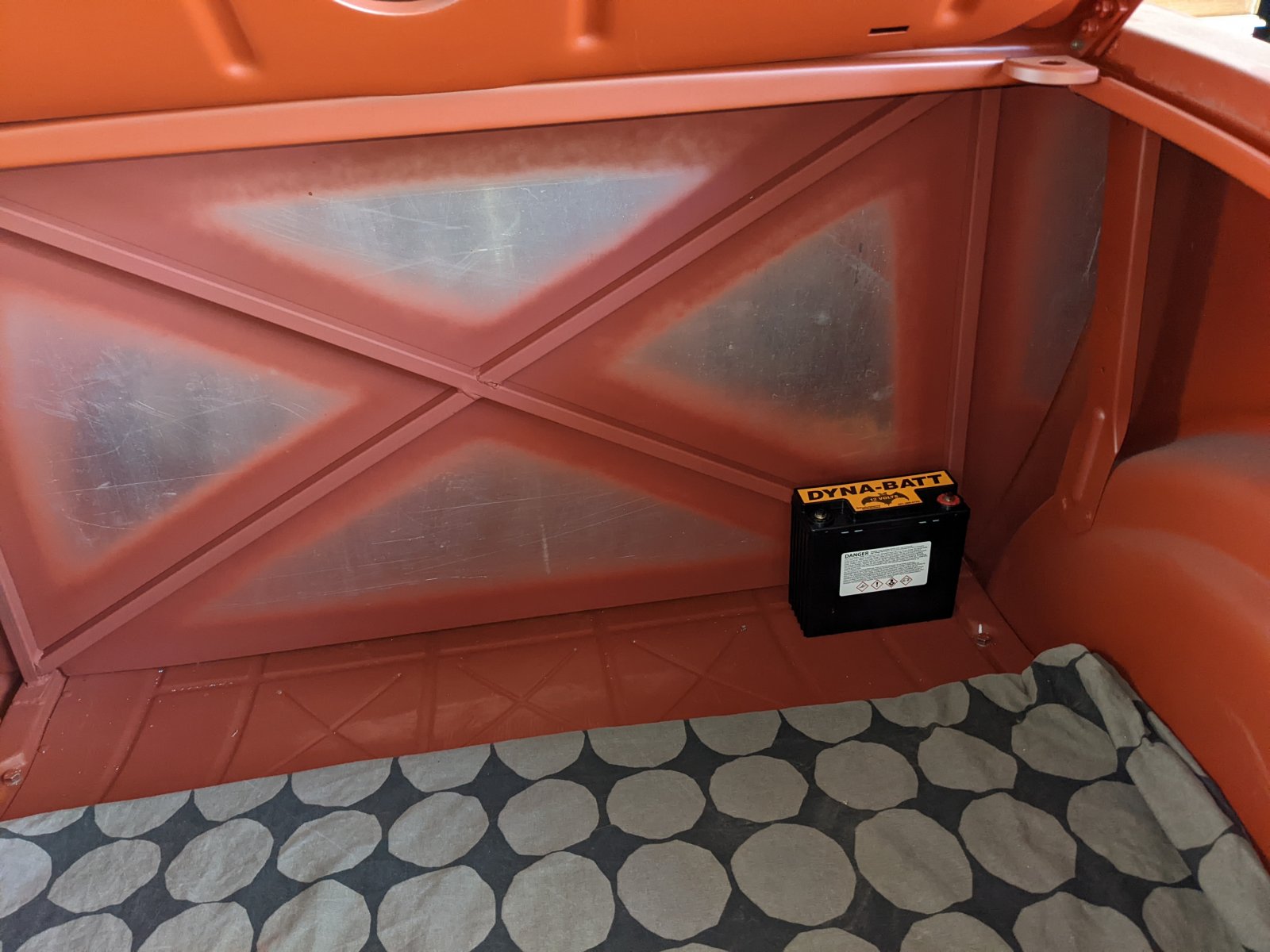

    Battery mount finished, bought the box from the guys who make the Dyna-batt - made a tab and welded it to the x-member.

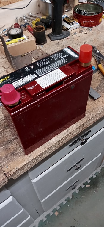

    Making good progress. What are the cranking amps on that battery? I have a similar one but from Stinger in Miami rated at 230 cca and it came with a steel box. So far it rolls the Olds over easily.

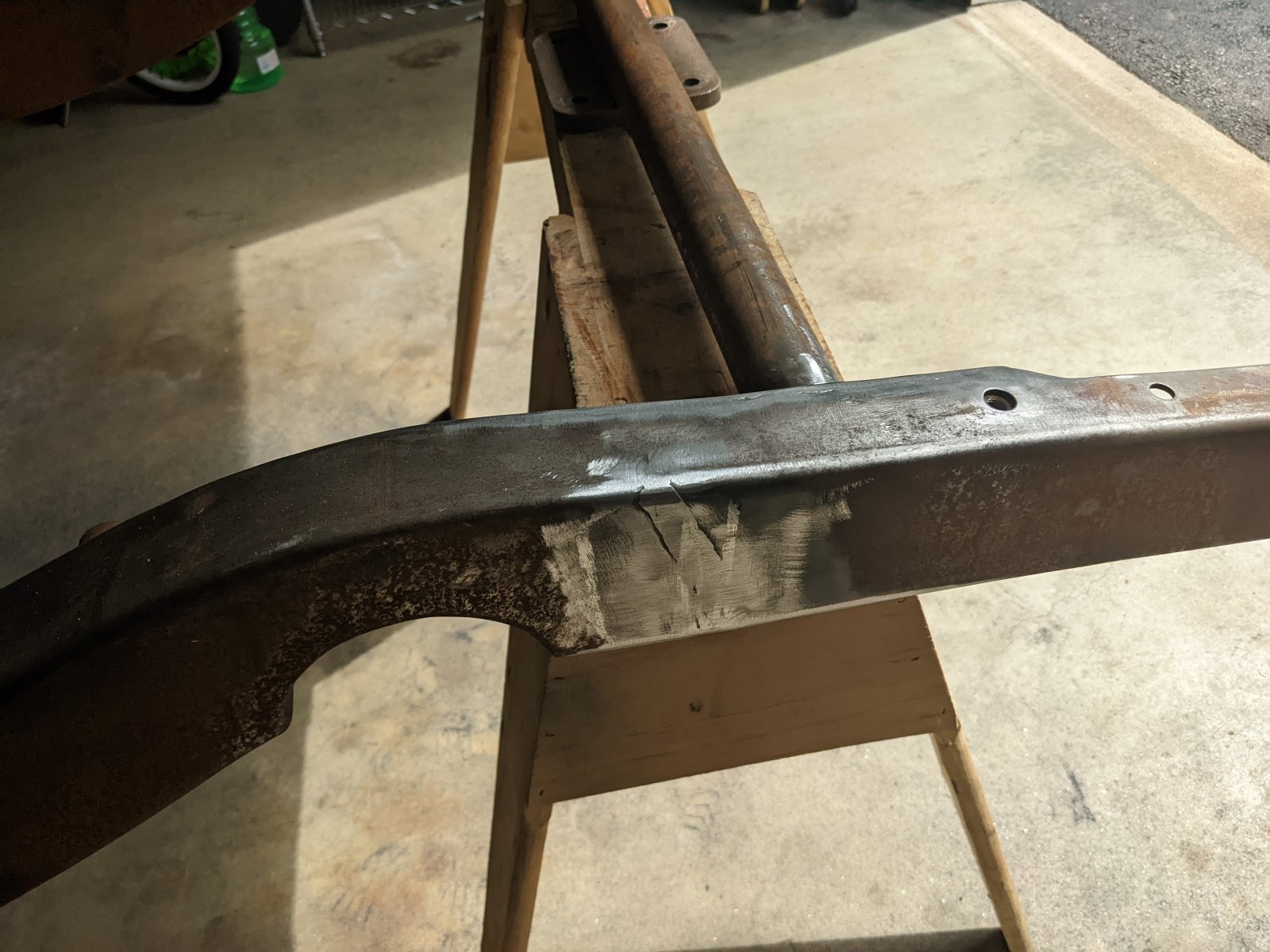

  29. SDS
    Joined: Apr 28, 2011
    Posts: 1,060
    SDS
    PXL_20220913_170212798.jpg PXL_20220913_170222474.jpg PXL_20220913_170227617.jpg PXL_20220913_170235128.jpg All welded up and ground flat. I didn't grind the weld flat where you won't see it (for strength). The cuts in the back are where I pulled the frame rails up to close the gap between the gas tank and the tail pan.
    The frame and some other pieces are going to the sandblaster tomorrow and then getting primed... I have a little body work to do on the ch***is (where you'll see it) and then it's off to paint.
    Stogy, shortypu and pprather like this.
