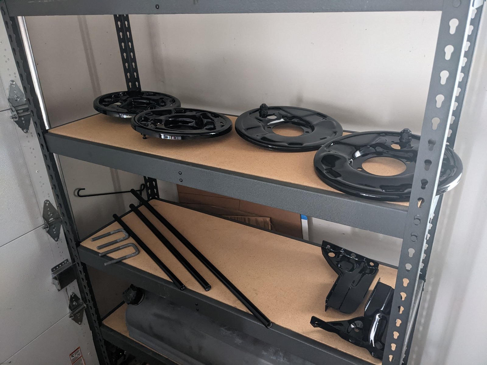

    Are there special fasteners to mate these backing plates to these spindles?
    I'm ***uming the nut goes on the inside...
    shortypu likes this.
  8. vtwhead
    Joined: Oct 20, 2008
    Posts: 5,307
    vtwhead
    Grade 8 usually, nut goes inside with lock washer. At least that is how most of the ones I have seen are mounted.
  9. alchemy
    Joined: Sep 27, 2002
    Posts: 22,774
    alchemy
    If you are using the grease shields like Henry intended (I can hear a forehead getting all scrunched up), they are used with a special square headed bolt, and the nut goes on the outside. If you are not using grease shields, you can do whatever you want.

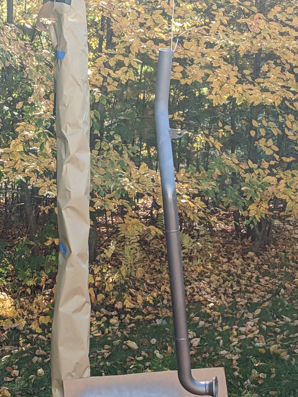

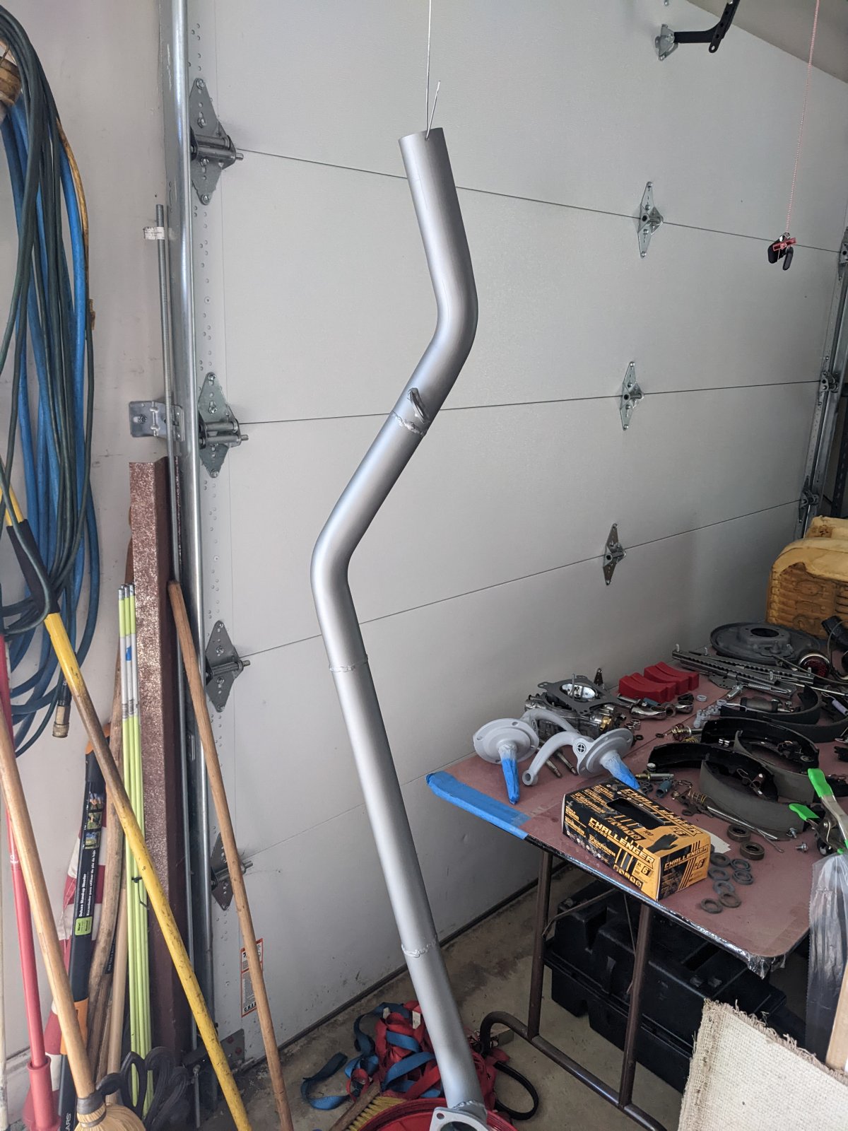

    Cerakote-C on the exhaust. The stuff sprays like a dream and comes pre-mixed. Holds up.to 1800 degrees F. Only used half a pint, cost $70. Like my paint booth?
    PXL_20221009_173203026.jpg PXL_20221009_173155672.jpg PXL_20221009_181211559.jpg PXL_20221009_181206040.jpg
    Budget36, Tim, 54reno and 3 others like this.
  11. Bcap55
    Joined: Oct 5, 2009
    Posts: 348
    Bcap55
    from PA, USA
    What color is that coating, silver or gunmetal hard to tell from the photos.
    Does it need to be heat cured or air dry.
  12. DDDenny
    Posts: 22,564
    I plan on doing my exhaust system in that color, I've heard it referred to as "***anium".
  13. SDS
    Joined: Apr 28, 2011
    Posts: 1,073
    SDS
    It's called Glacier Forge - it's silver, but a little on the graphite side. If you want bright silver, the nickel color is a better bet. Yes, air dry - dry to touch in a few hours, can be handled in 24 hours,vfully cured in 5 days.

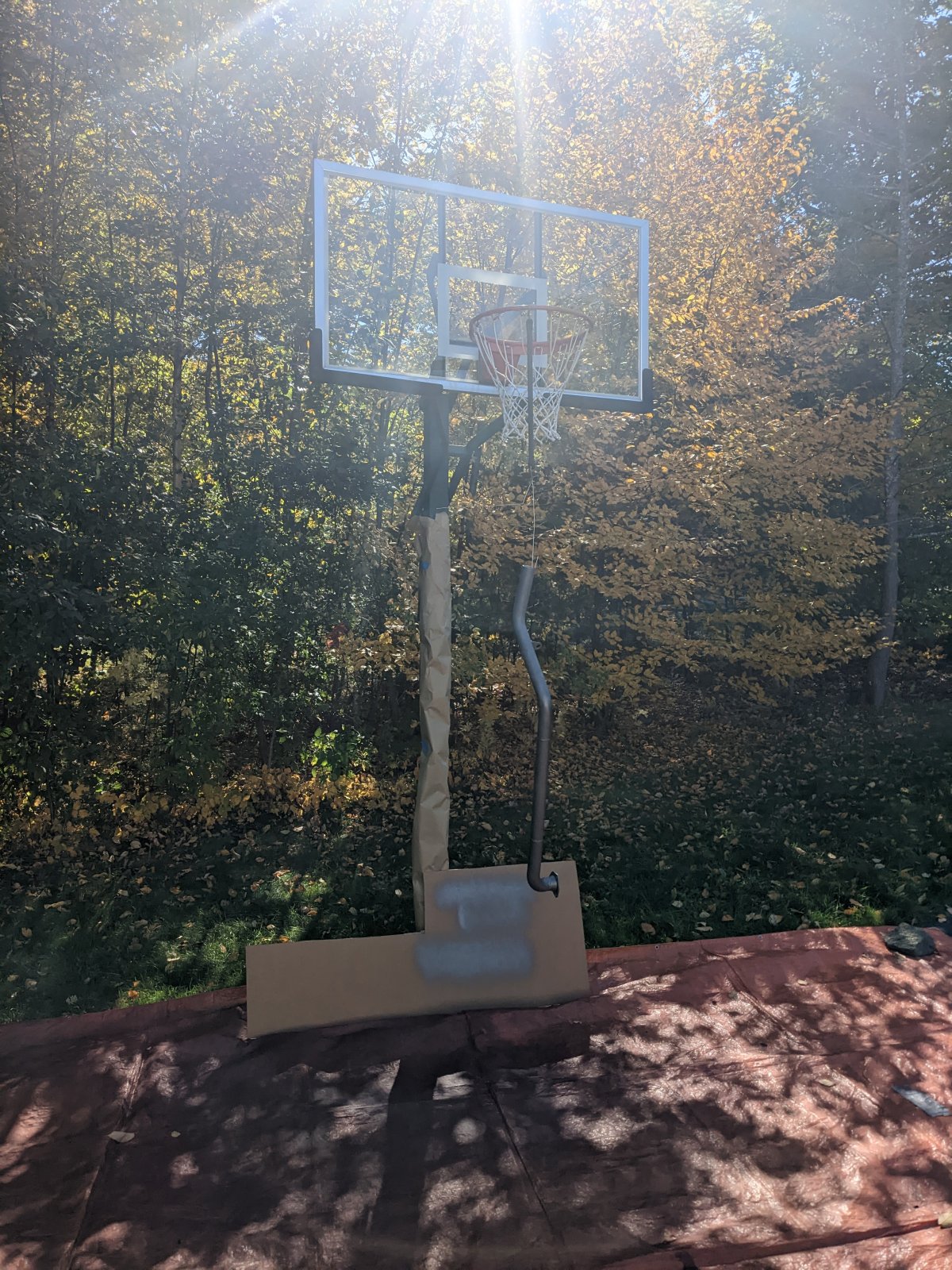

    More basketball court spray booth work...
    PXL_20221015_211158356.jpg PXL_20221016_204234308.jpg PXL_20221016_204206970.jpg
    Gotta rush it inside before leaves fall on the wet paint :p

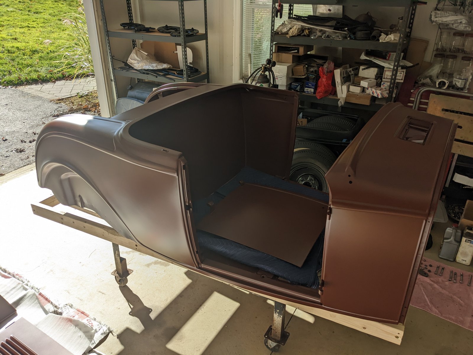

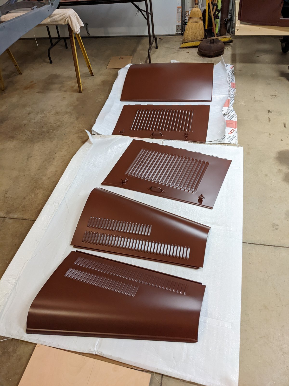

    Body came back from painting today. I'm very happy with the custom color base/clear and the painter did an awesome job!

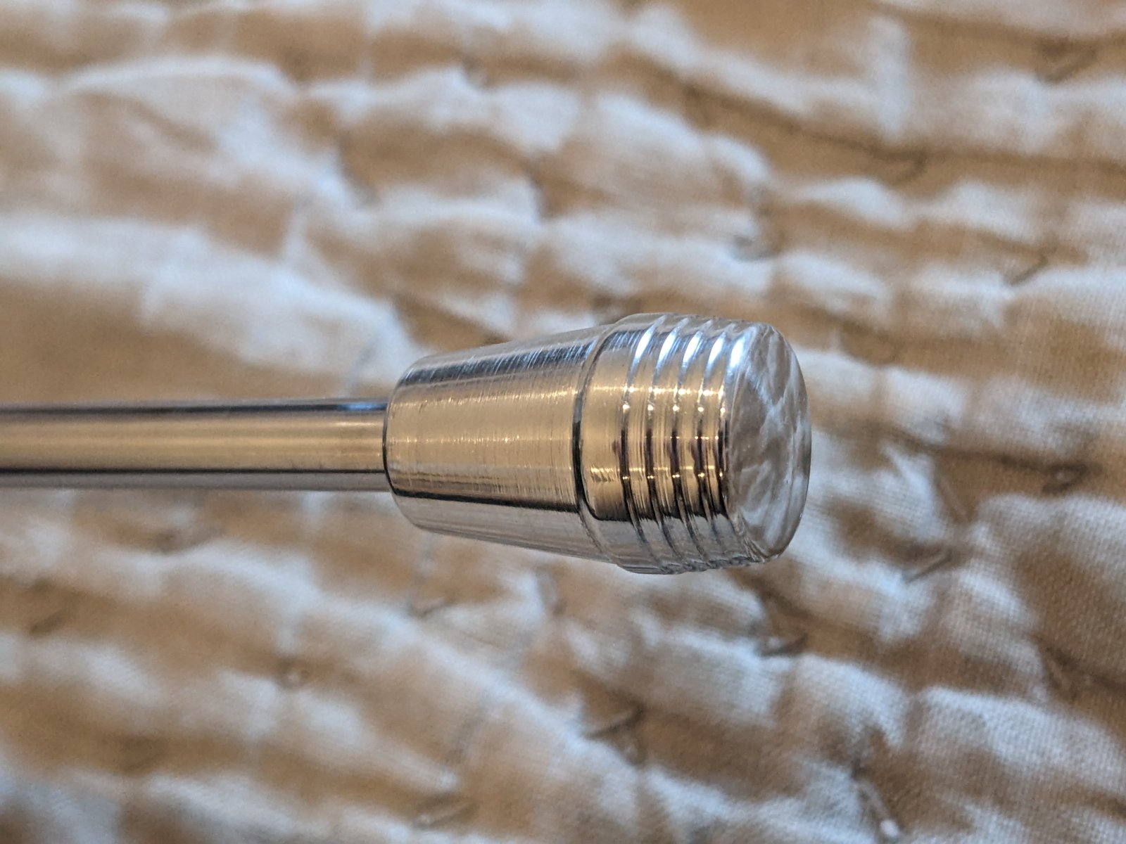

    Spun up my turn signal and emergency blinker knobs to match the SoCal dash knobs...
    shortypu, brEad, Bcap55 and 1 other person like this.

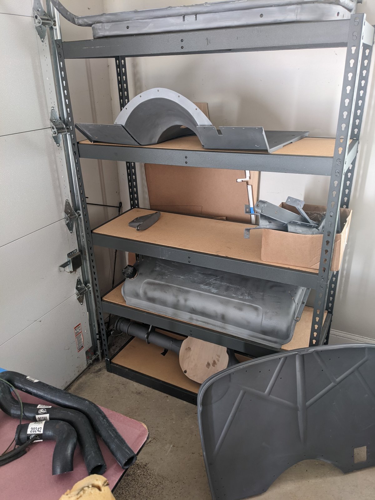

  29. SDS
    Posts: 1,073
    SDS
    Progress...
    Parts table starting to look bare
    shortypu and brEad like this.
