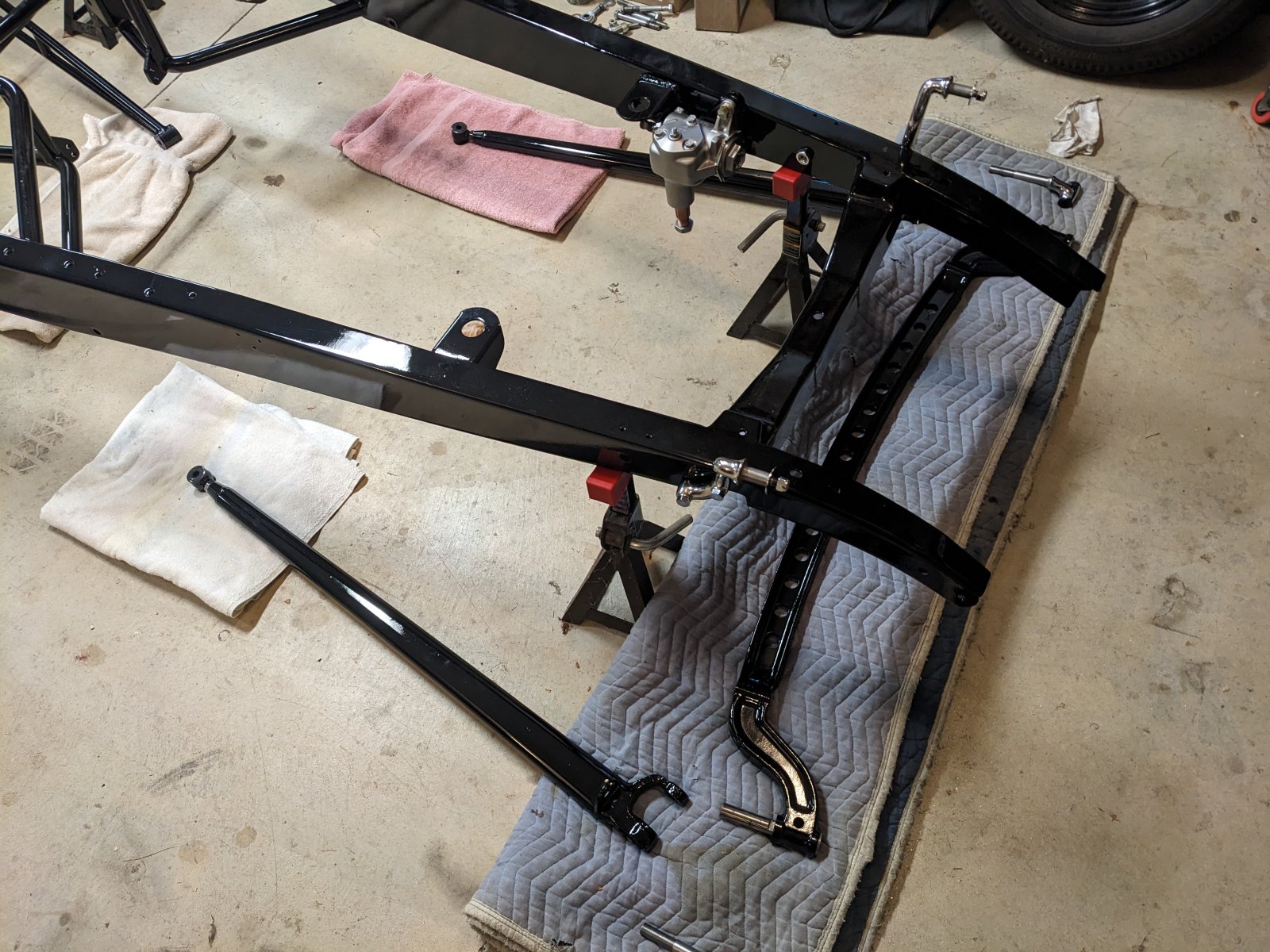

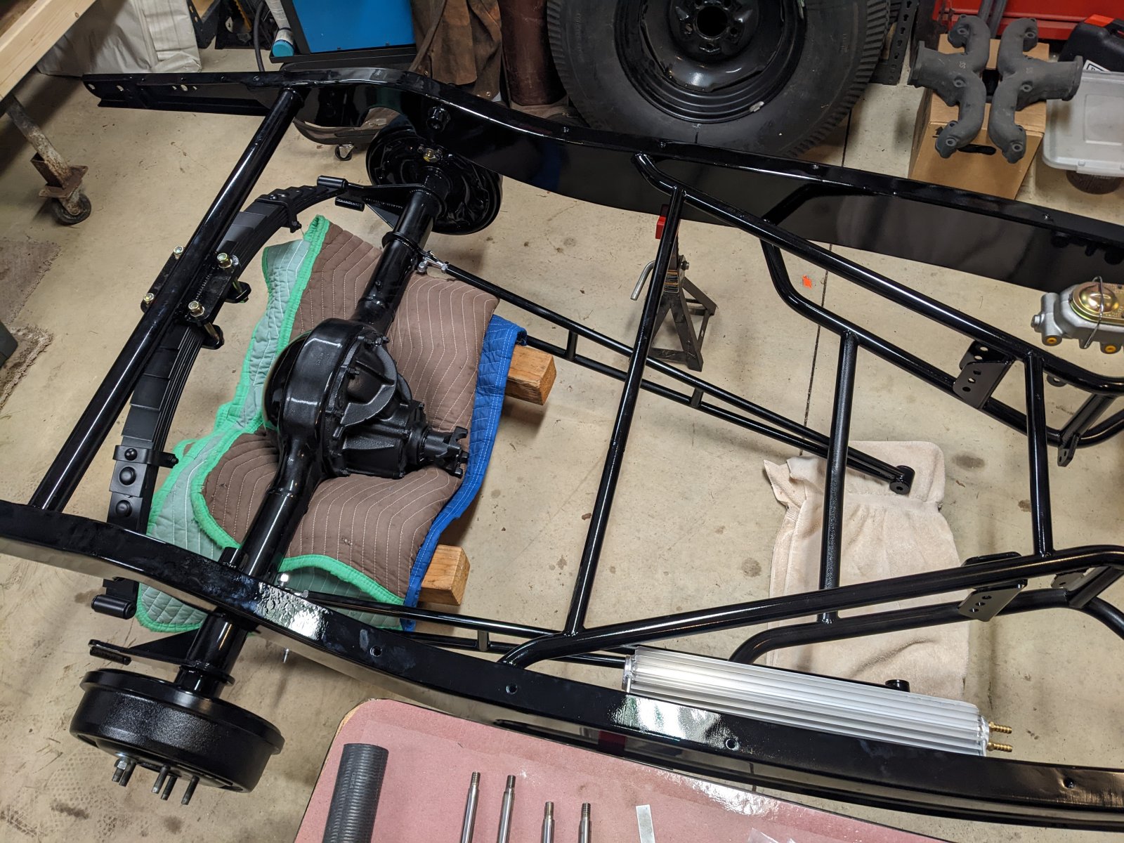

    Clean, buff, bolt on, repeat.
    Hopefully for good this time...
    PXL_20221206_165405306.jpg PXL_20221206_165410525.jpg PXL_20221206_165415074.jpg PXL_20221206_165716930.jpg
    This part is fun

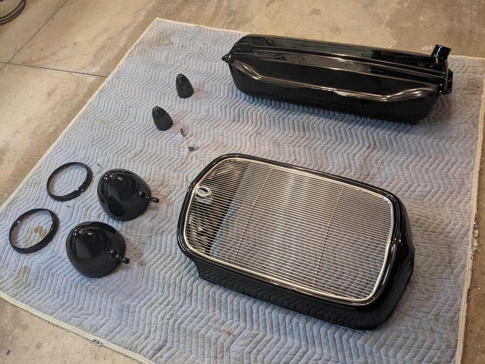

    Planned it this way - frame suspension gas tank headlights tail lights and grill shell are all single stage gloss black... The body is a custom mixed color to look like old school red oxide primer base (which is more brown than current primers), covered with a sand clear coat

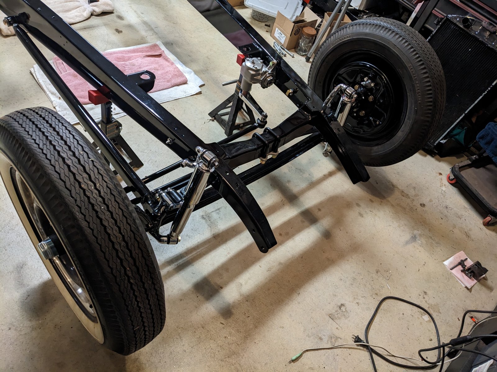

    Had a great day with my 12-year-old son today. We put most of the front end together...
    I introduced him to Never-dull, just like my grandfather did when I was his age. He was totally amazed at how bright it makes the chrome.

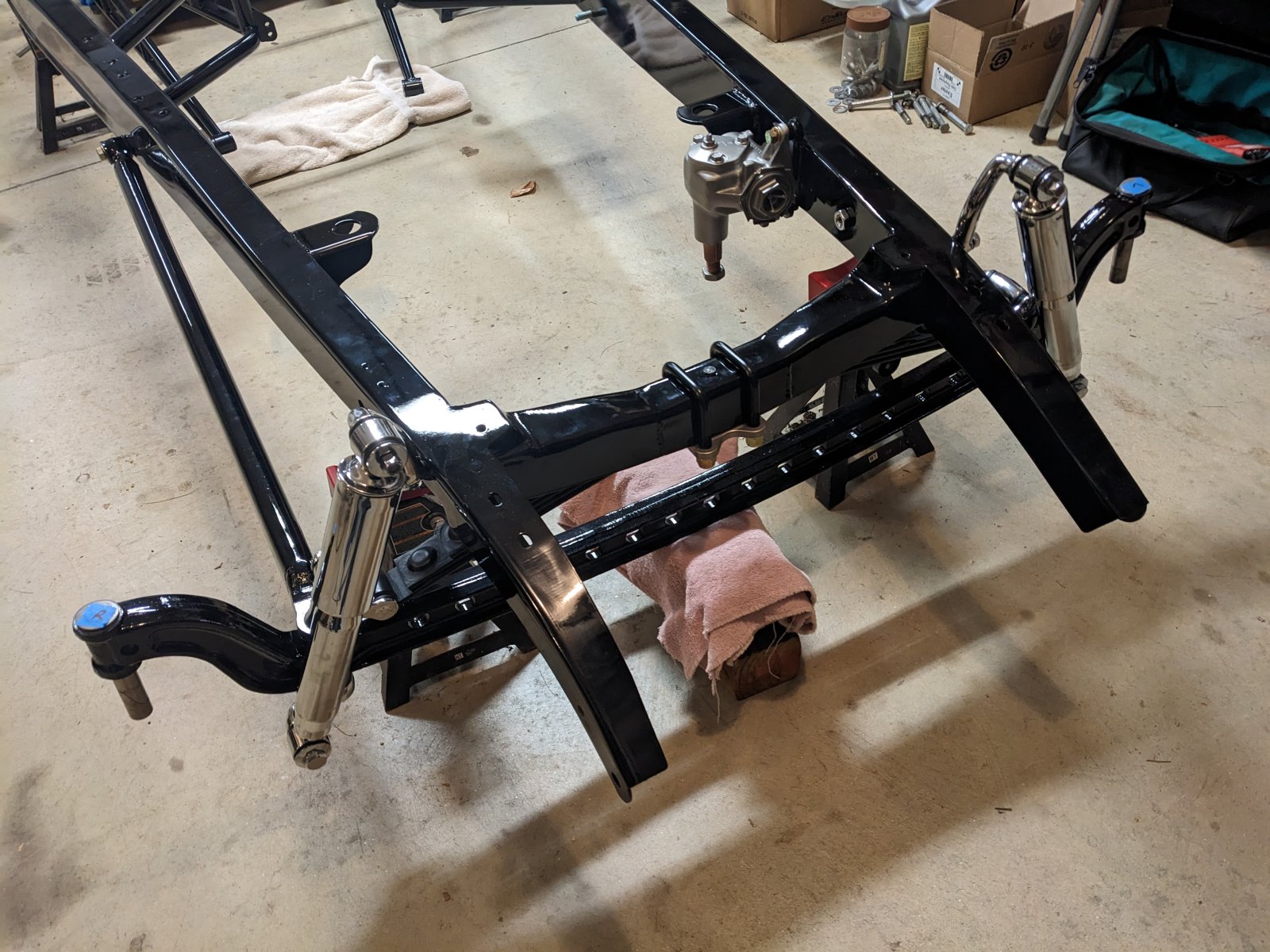

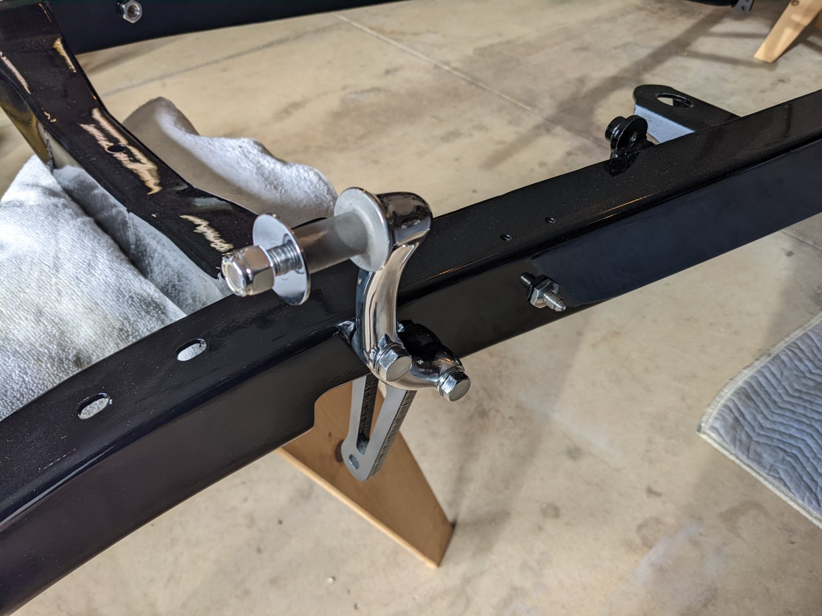

    Slow but steady, getting the details nice.
    PXL_20230115_234610146.jpg PXL_20230115_234602965.jpg PXL_20230115_182134416.jpg
    Bcap55, brEad and shortypu like this.
  21. alchemy
    Joined: Sep 27, 2002
    Posts: 22,645
    alchemy
    Straighten out the lower shock mounts before you put the torque to the perch nut. That's always a detail that's nice.
    brEad likes this.
  22. SDS
    Joined: Apr 28, 2011
    Posts: 1,056
    SDS
    Thanks - I will.
    Nothing is tight yet, I want to set it on the ground first.

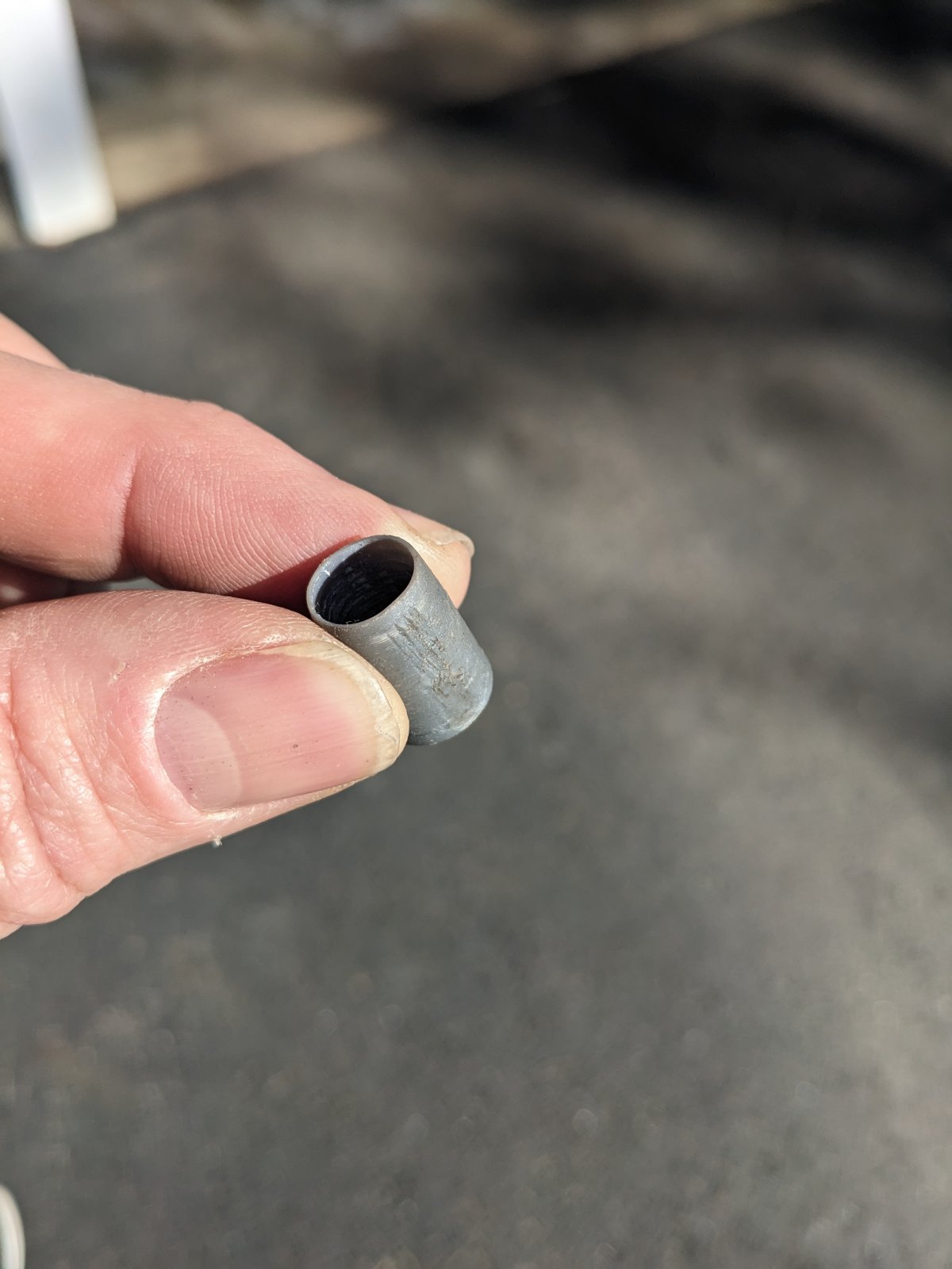

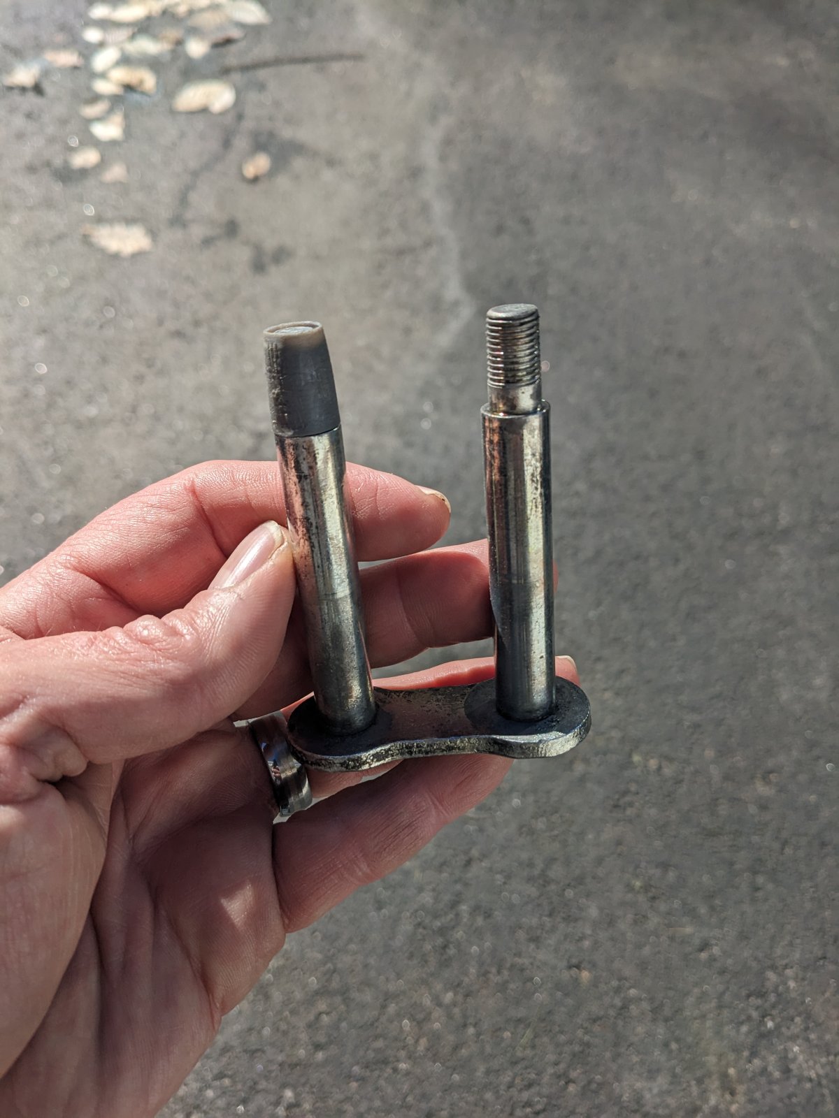

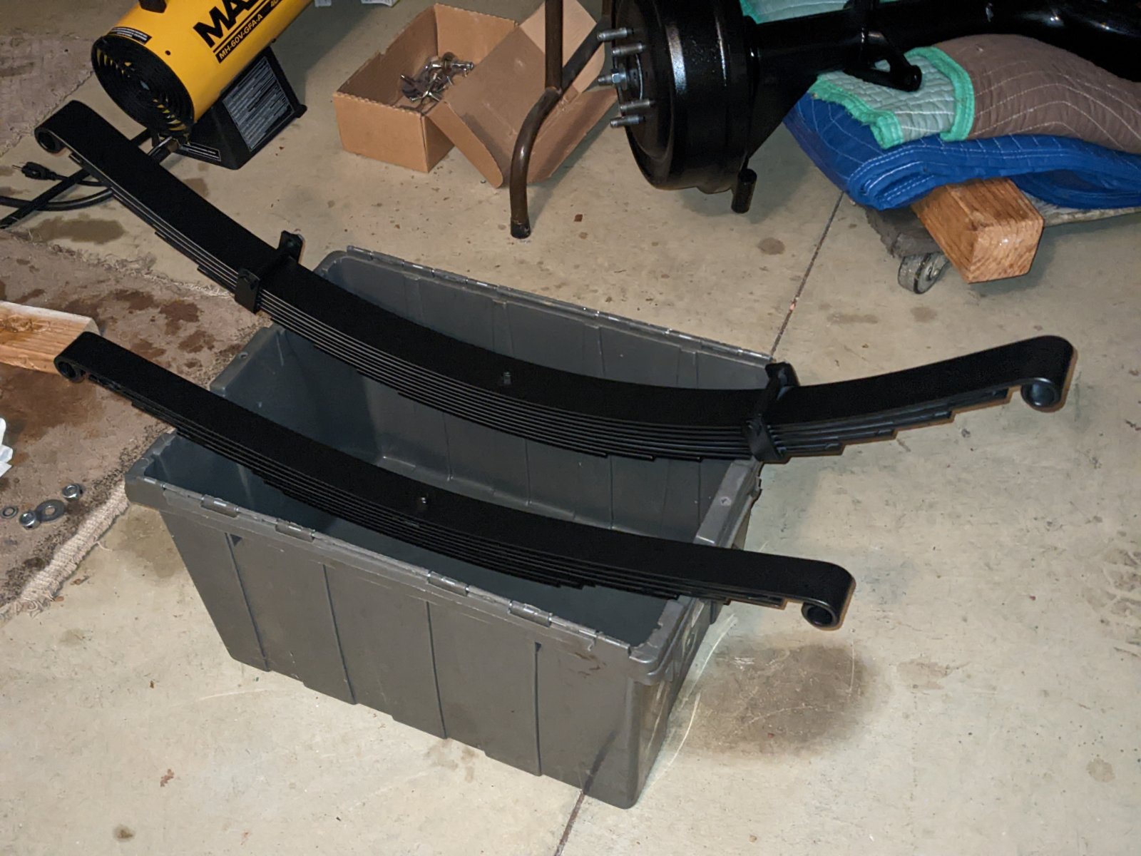

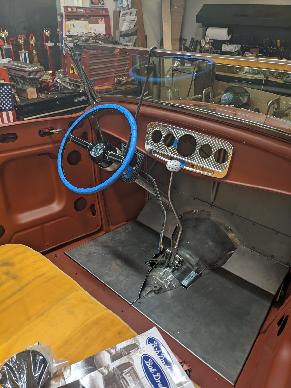

    Was able to accomplish the impossible today with some help from 3D printing and 2 heavy guys. ***emble a rear suspension with a 1200 lb. Posies rear spring ON the ch***is (without dis***embling the spring itself).
    We put jack stands under the spring eyes and I sat on one rear frame rail and my buddy sat on the other to compress it enough to get the shackles in.
    I 3D printed these little tapered slave/guides so that the misaligned shackles went in easy without pushing the back side bushing out.
    Worked great without a big deal.
    PXL_20230211_160529823.jpg PXL_20230211_160341602.jpg PXL_20230211_160310485.jpg PXL_20230211_160306028.jpg
