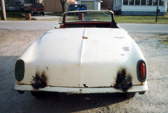

    Attached pic of progress on rear of bulletnose studelac

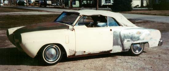

    attached pic side view of studelac

    another attached pic of side of studelac
  6. tragic59
    Joined: Sep 16, 2002
    Posts: 766
    tragic59
    Cool project, but right now it looks like a Kharman Ghia(sp?)...
