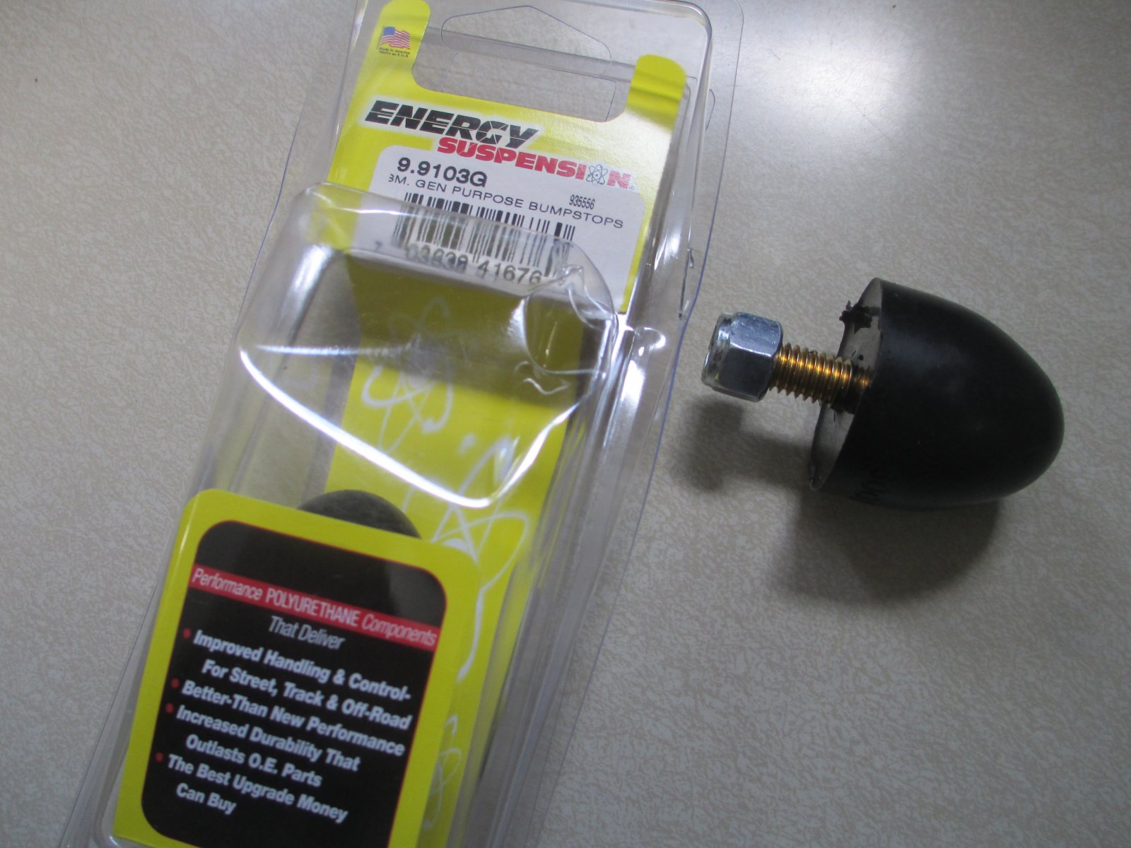

  7. Marty Strode
    Joined: Apr 28, 2011
    Posts: 9,685
    Marty Strode
    This is what I use, and mount them inboard of the c-notch. IMG_0155.JPG IMG_0156.JPG
