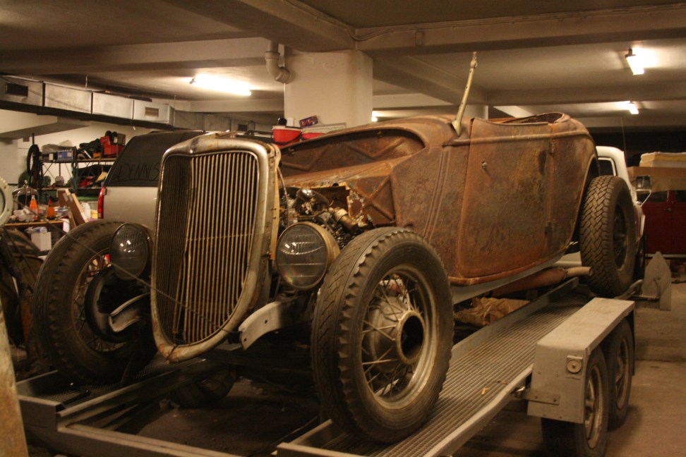

    It was a fire here in Norway, in a car shop named Eiker Motorshop, where 10-15 old cars got lost. I bought this 34 SAR roadster of them, and will try to build it..

    Doesn't look too charred. Good luck.

    Driver side is not too bad however the p***enger side might be different from what is show in your pic. Can we get a view of the other side & rear?
    Looks like decent start anyway if you got it really reasonable.

    The other side need some work..

    Looks like time to break out the porta-power and a few body working tools.

    The worst pices is the cowl and the right rear quarter, the frame is bent to, and rusty, so there is a lot of work to get it on the road ..

    flt-blk. 31Vicky beat me to it, but he hit the nail on the head. I speak from to many years of experience here, so try not to look at me like I'm too crazy, LOL, when I explain that the heat opens the pores in the metal and anything thats in the air...smoke, chemicals, fire supression foam, etc can get into the metal. Many times you end up with what can look like solvent pop and adhesion issues all over the car; even on a sand blasted and prepped car, if the car isnt cleaned very very well before body filler or primer are applied.
    Depending on how hard a car burned, you can also run into issues with the metal being very weak or (more commonly) very crooked and challenging to body work. It can be done, but it takes a load of patience and experience to bring back many fire cars.

    Looks to be a good score and very rebuildable

    It's sad to see an SAR Roadster like that
    I think if it was me, and considering both the damage and the fact it has been heat effected, I reckon I would contact SAR and get a right quarter, right cowl side and a cowl top.
    However I don't know the extent of your abilities with metal
    But that would be what i would do, as at least I know the SAR panels will fit that roadster
