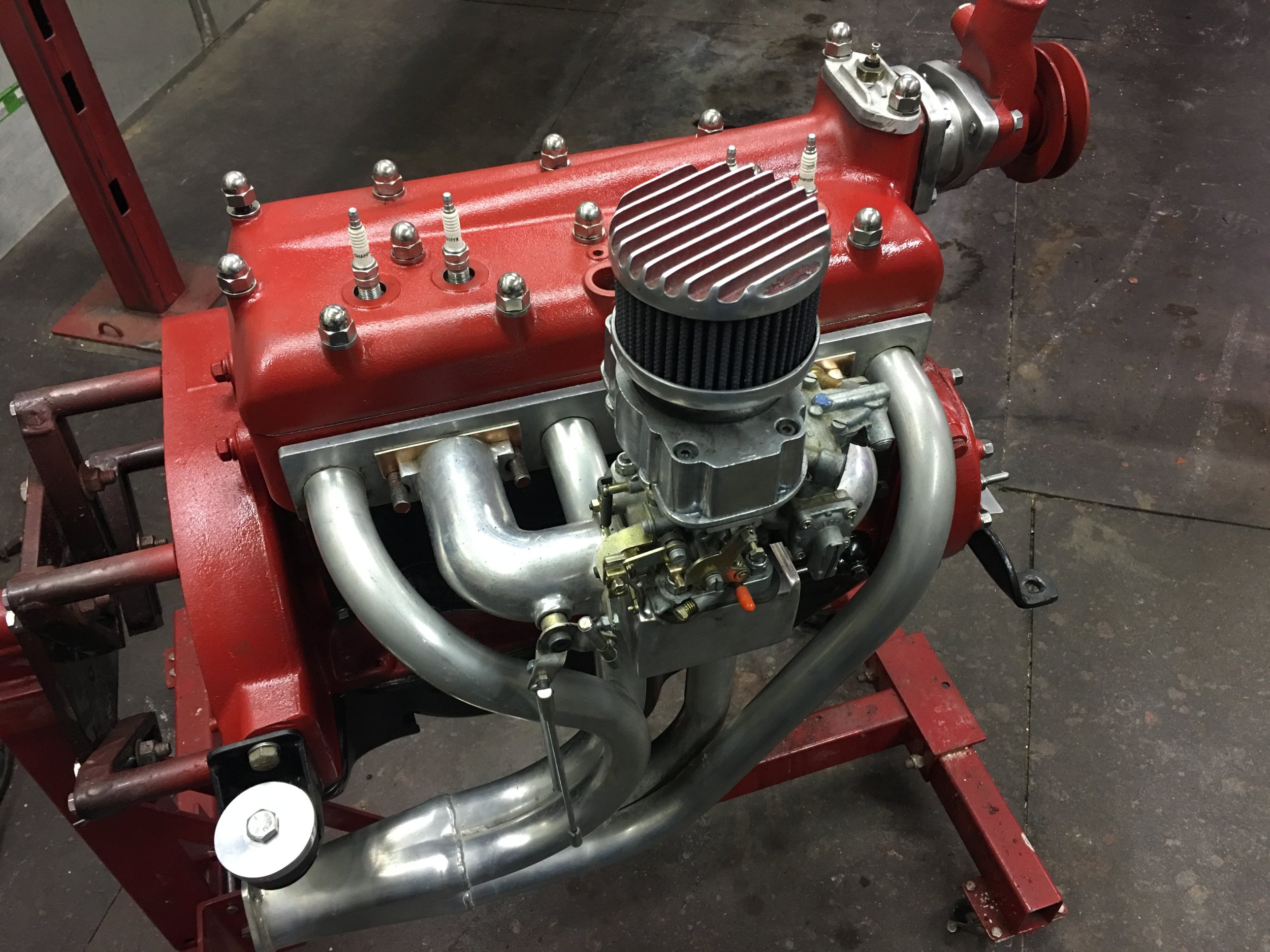

    I’ve used a number of intake combinations, including EFI on my A. Best all around intake in my experience is the Weber 32/36. It’s a 2 barrel carb with progressive ****erflies and it’s easy to adjust. I have the adapter that allows the use of a typical 97 air cleaner. IMG_0062.jpeg

    Denis, Who made the adapter for the 32/36 please?
    Thanks.
  25. denis4x4
    Joined: Apr 23, 2005
    Posts: 4,416
    denis4x4
    from Colorado
    Steve Becker at Bert's has the intake manifolds. He's also a Burtz dealer. Redline has the air cleaner adapter and jet kits.
