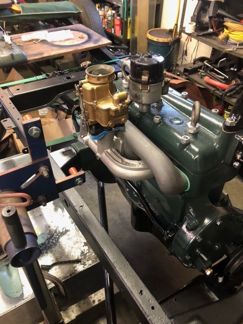

    To stick with the period look I'm running an old Mallory dual point distributor, they were used in combines and industrial engines in my Roadster Pickup. Basically a stock engine with a Snyder's 5:5 to 1 head, Burns intake manifold and a Holley 94.
