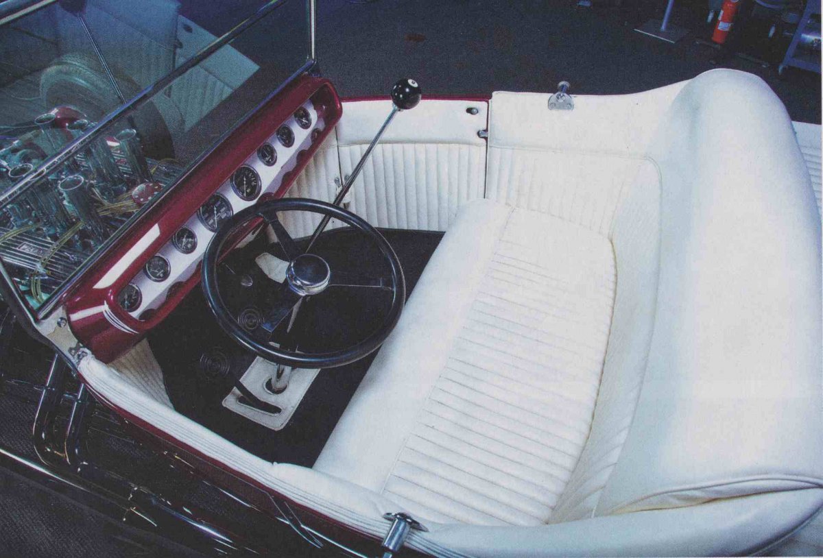

    I'm planning a ch***is for my roadster that I would like to use "bus" type steering as was popular in the early 1960's. I believe some of these used Dodge van boxes, (?) and many other configurations. I'd like to keep mine as close to the era as possible and was hoping I could get some insight and maybe pics of how this was typically done. I've done a search and I'm probably the only guy out there who wants to reincarnate this style becuause there doesn't seem to be much.
    Post away my friends.....

    I plan to do a near vertical steering column in one of my up-coming projects, but I wouldn't talk about it on the HAMB, my guess is, it will not go well. Period-correct T-bucket?

    We usually call it vertical steering. You might get better results searching that. It was popular on '50s to early '60s T buckets and T track race cars. It gives you more foot room in the small T body.
    What kind of roadster are you building?
    need louvers ? and dana barlow like this.

    George since when did we shy away from controversy on the HAMB. We know the "Fad T" crowd doesn't like Vertical steering but then we don't much like them either. I laugh when I see builders going through so much trying to fit everything in the floor of a T trying to avoid vertical steering. Swing pedals, ugly steering boxes showing under headers, mutable U joints.
    Koz is the below what you talking about?

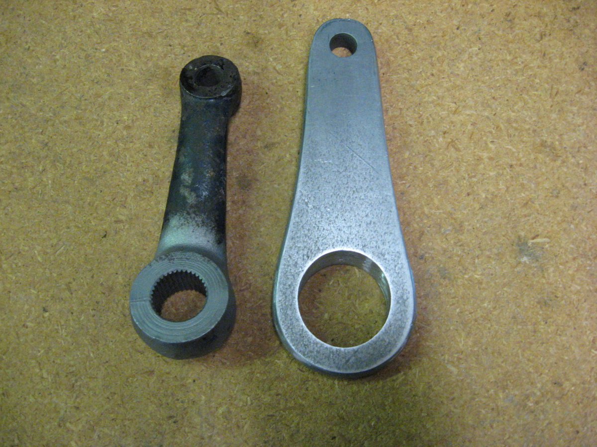

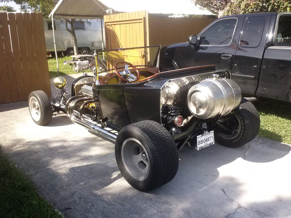

    In 1959 when trying to piece together my rod,my steering at the time was cut shorter 31A box mounted vertical for room,pic#1 was about 1960 when redo on my Y-block was needed. After a time I changed to a cut down F1 worked smoother ,however over the years F1 want bad an a few years ago I put a Vaga box in at more of an angle. I liked feel of the vertical OK,but now is even better. THis old hotrods been doing its thing a longtime. HRZ2.jpg rearView1.jpg

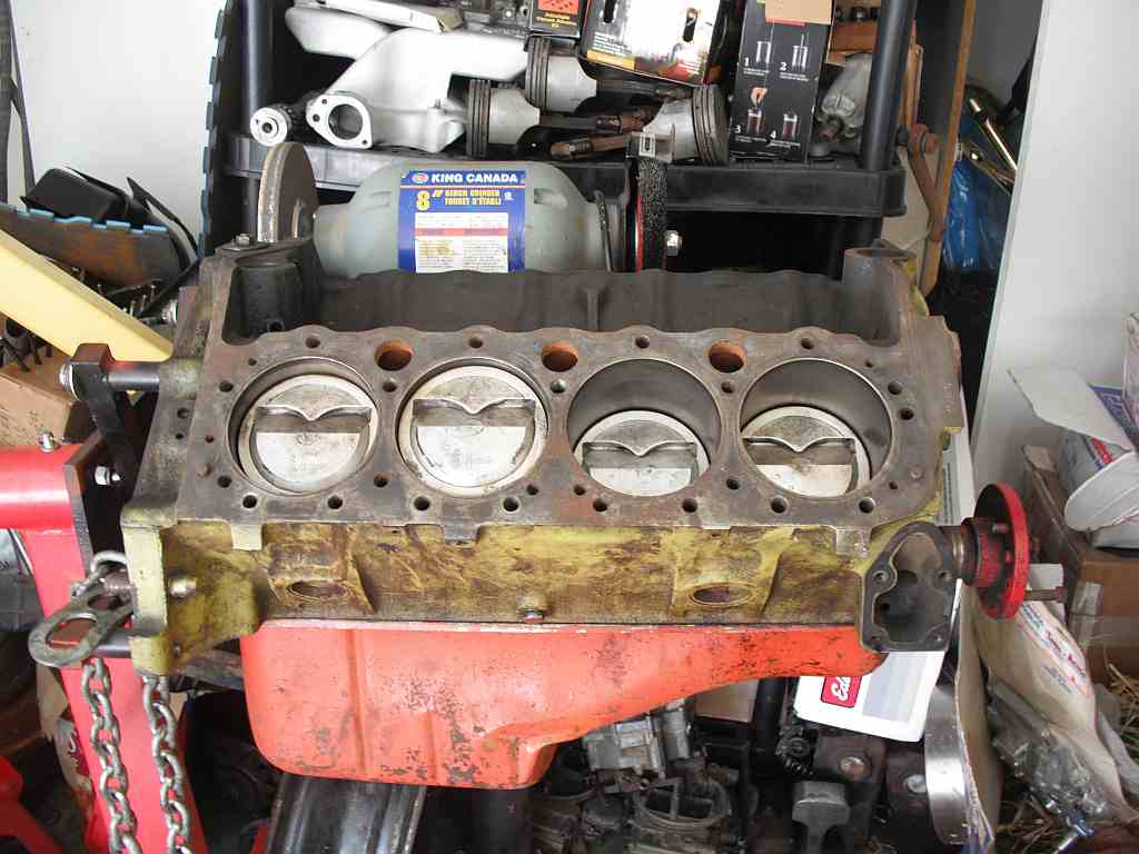

    A lot of the pics above are exactly what I'm talking about. My car is a steel body 1918 touring cut to a bucket. The cowl is slightly modified to give a bit more foot room but it's hard to tell. I have the ch***is near done, press braked of 10 ga. P&O to correct model A specs. The frame has the typical "A" holes punched in the visible part and will be hard to tell it isn't just a mint "A" frame modified as was typical 1960 fashion. The rear uses a flattend and narrowed '37 crossmember and the front uses a suicide bulldog riveted into the rails as would have been done in an earlier car that was updated over the years. ( As was bolted in on the Lightning Bug). All parts that are visible on the ch***is are riveted and discretely safety tigged/migged so as not to show.
    I have a '57, side mount delete engine with all the usual early sixties hop up stuff including an era correct 3x2 Rochester setup. Another HAMB find is the 1959 Merc Marine steel dual point and '57 Vette canister filter. All this is topped with a generator and '36 torque tube headers that will be chromed. A very early steel Powerglide ring and what I think is an Ansen, (?), adapter put a fresh '39 style box with Lincoln gears in back of it. This all hooks to a '40 Ford banjo with my favorite 3.78 gears and some NOS safety rings that are fitted to the '46-'48 brakes. I have some '46-'48 Merc. rims, two of which I threw 6" hoops on.
    This is where I'm at so far. The car has been mocked up and "sits" just right. I used to have a pic of some LA Roadster cars in front of some speed shop back in the day and they just screamed SoCal in maybe 1960. If I can build that California summer night look into this I'm happy. I think most of this stuff is pretty HAMB friendly and typical of a lot of cars on the streets at that time. This was a time frame I remember a young tyke and cars like this were just a daydream when I was supposed to be concentrating on Algebra or something. Throw on a little Beach Boys or Jan and Dean and we're talking!
    In reality a 'gl*** body would probably be more appropriate but there were a lot of steel cars still on the streets at that time. I really rather have a deuce coupe, (who wouldn't), but this one I can afford to keep and develop as time goes on. This is where I'm at so far and I'm open to suggestions as to other era appropriate stuff I missed.

    My motor pretty much ready to set in. Not the right valve covers. The right ones are at the polish shop. Doing the trip carbs in my spare time. It's actually more bronze than this pic shows.

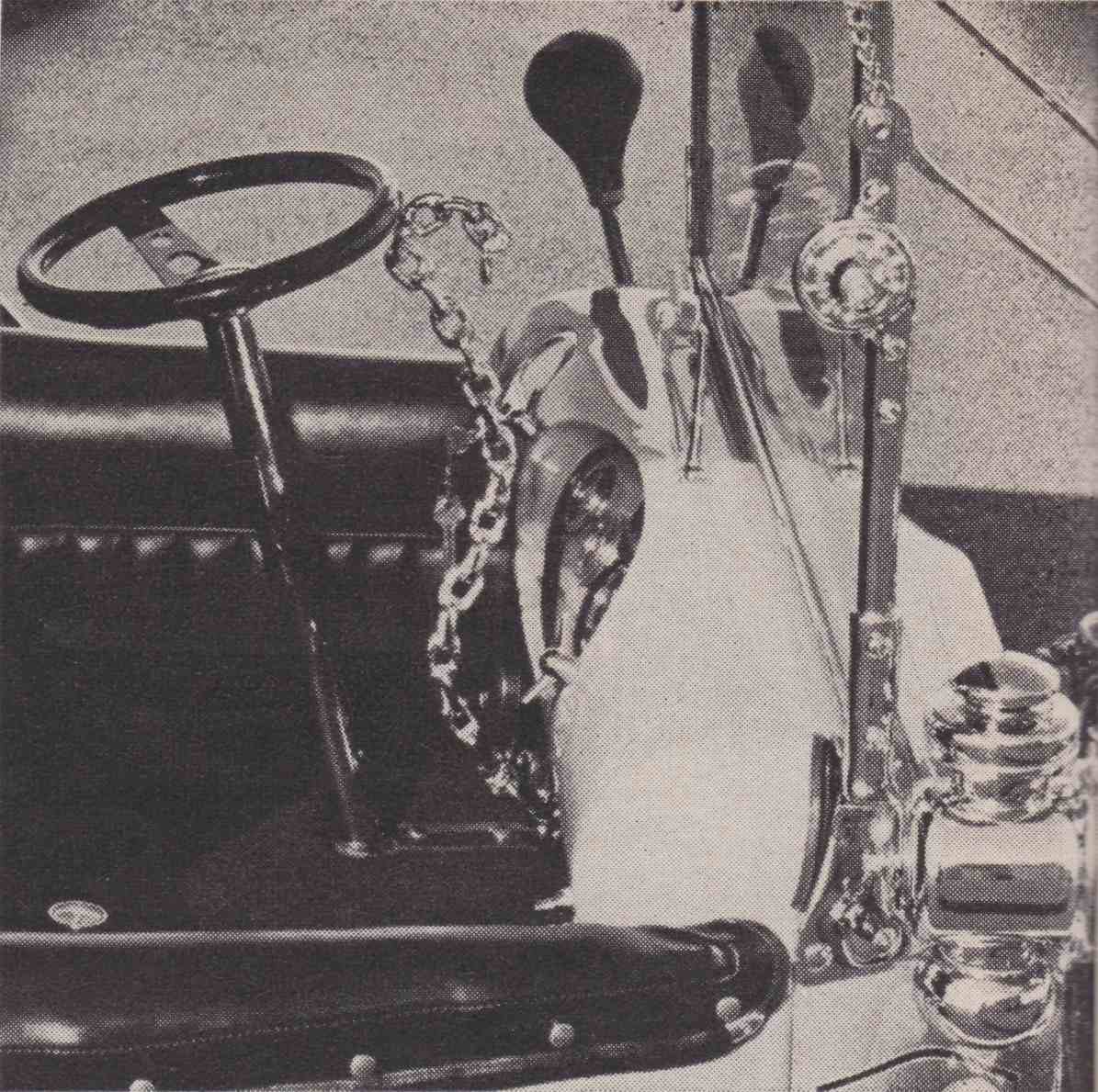

  30. falcongeorge
    Joined: Aug 26, 2010
    Posts: 18,339
    falcongeorge
    from BC
    Heres a pic of the steering column in the DeBenidictus car above. According to the old Hot Rod article, it had a '32 steering box, but I kinda wonder about that.
