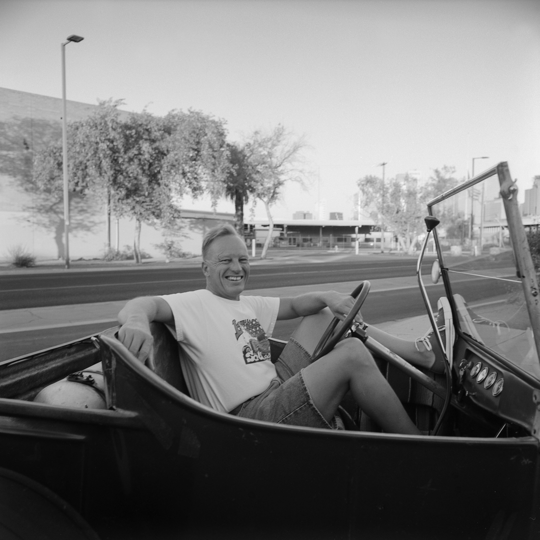

    The one in the B&W pic is the nuts! I've heard the Grabowski story too. I remember as a kid the bumper cars at Carsonia Park had reverse steering. Took a little practice to be able to do some serious damage to your friends. The number of times I was kicked off for violating the "No head ons" rule...... Eventually I'll score some dark centers. Until then steelies.

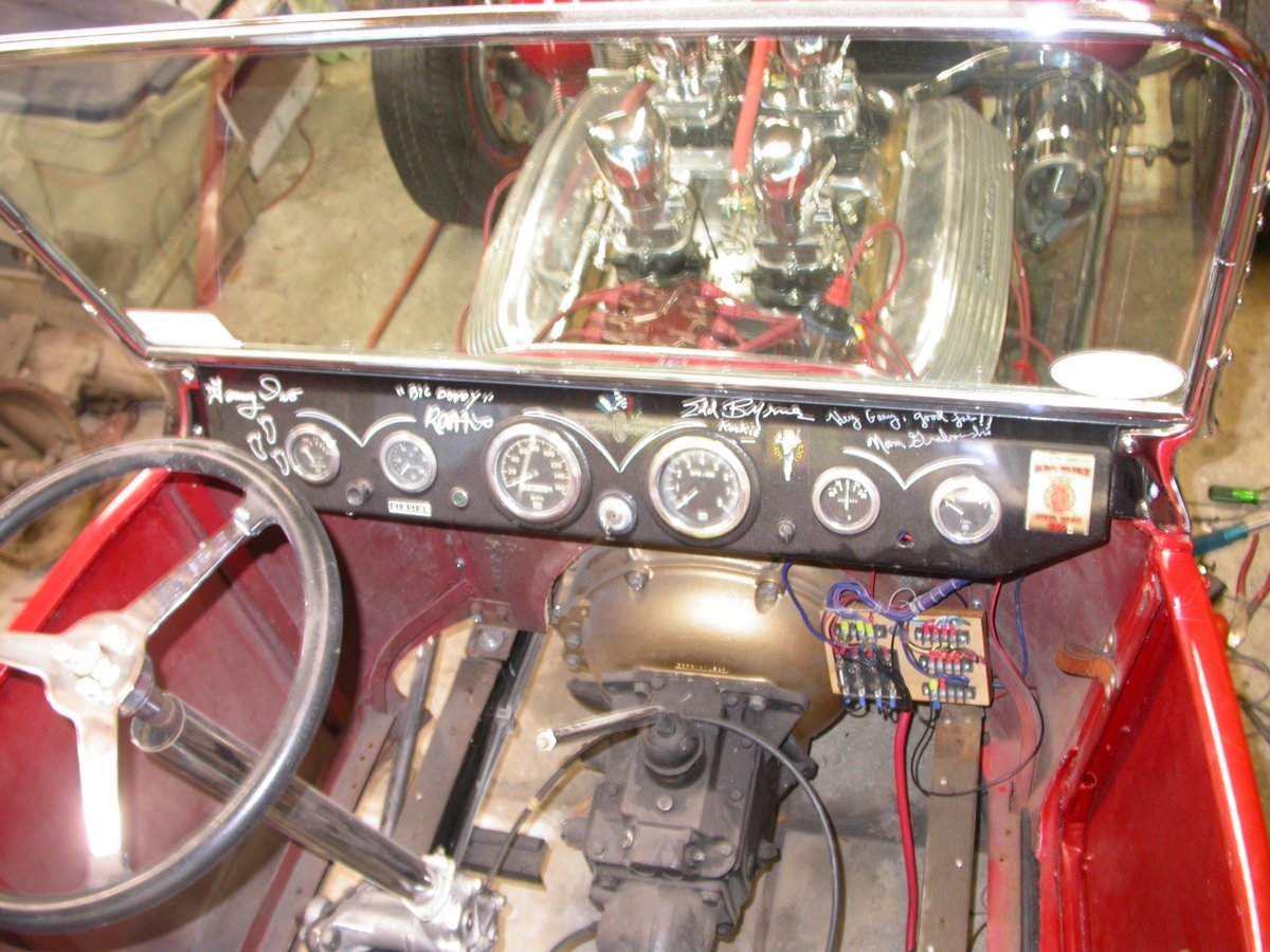

    Steel Rebel talking about windshield an column angles matching dose help a clean an should be there look of things,dose not have to be,but I like it when it can be done. Finding just the right place for a number of things takes work,don't just hook stuff up,test an retest. . I've built a lot of rod. For steering n seating by the time I know were the body is going to be,there are limits to room you have. But by time you need to finish how seat an steering will be,your pedals should already be as far forword as you can ,an out of were steering column is coming between or near. The steering box so its clears an has as min. bumpsteer{gives about were box/bottom of column too be. So with a number of odd custions to play with to be temp seat to try {an adjust an moving the column/steering wheel around tell the fit feels as good as can be for driver. You can end with something much more drivible then many rods. This was my son an I playing with fit with his T-bucket we built together for him.
    PS; I did a lot of rods an in "T"s I really like adding a column brace that you don't see in too many,a close look at photo dose show the type I build that gives a stronger feel for driver. Goes too dash an then to firewall,helps.

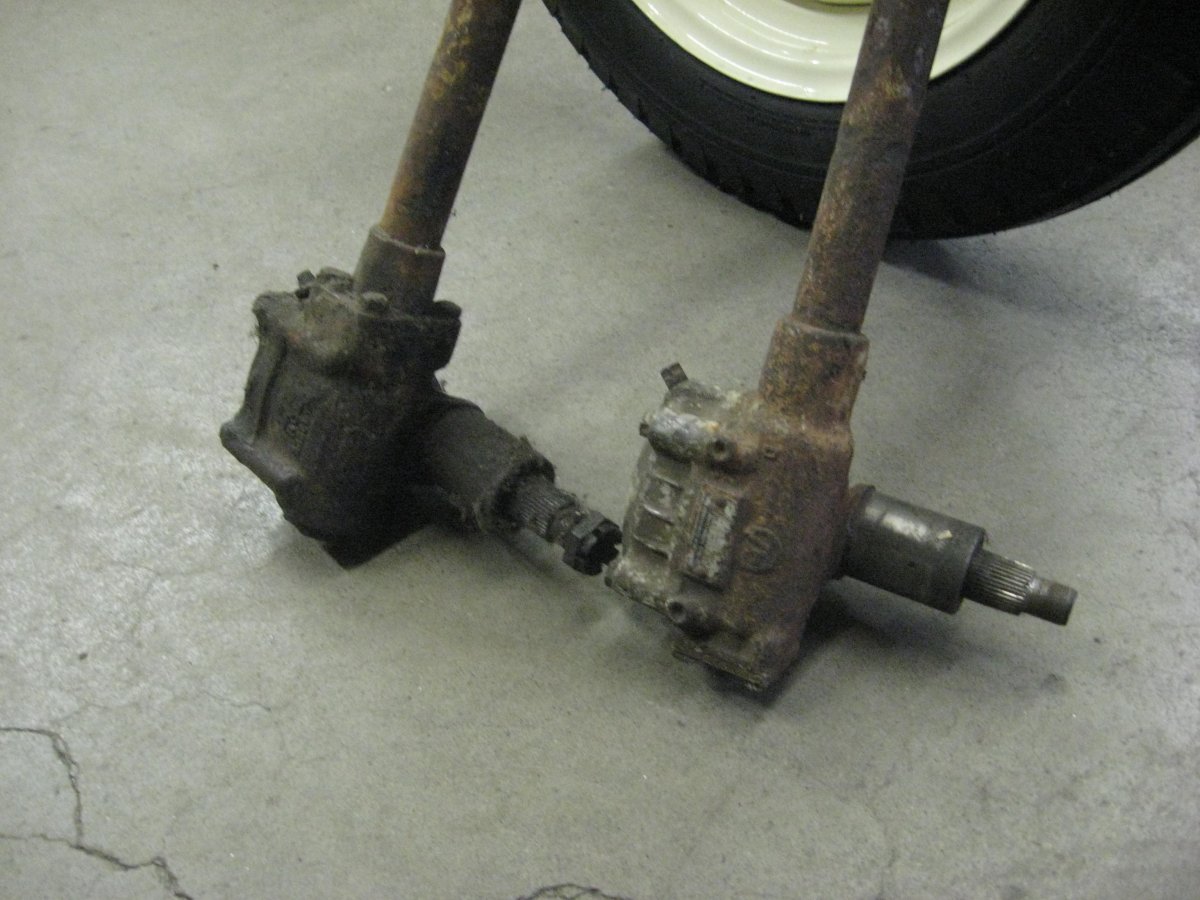

    Yeah, They came with Ross and ZF, and they were built totally different. Notice the removable m*** jacket on the Ross. They shared the the same clamp mounting, which is a nice feature. IMG_7175.JPG

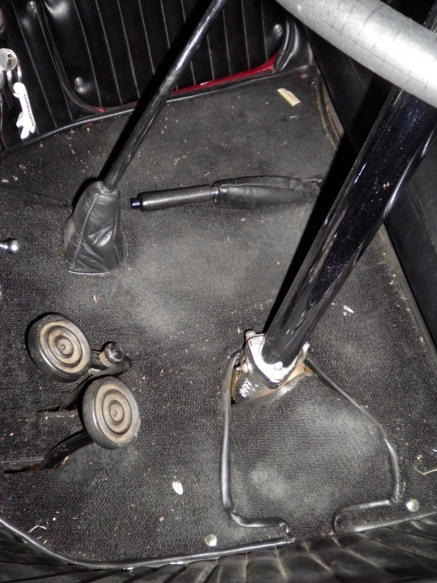

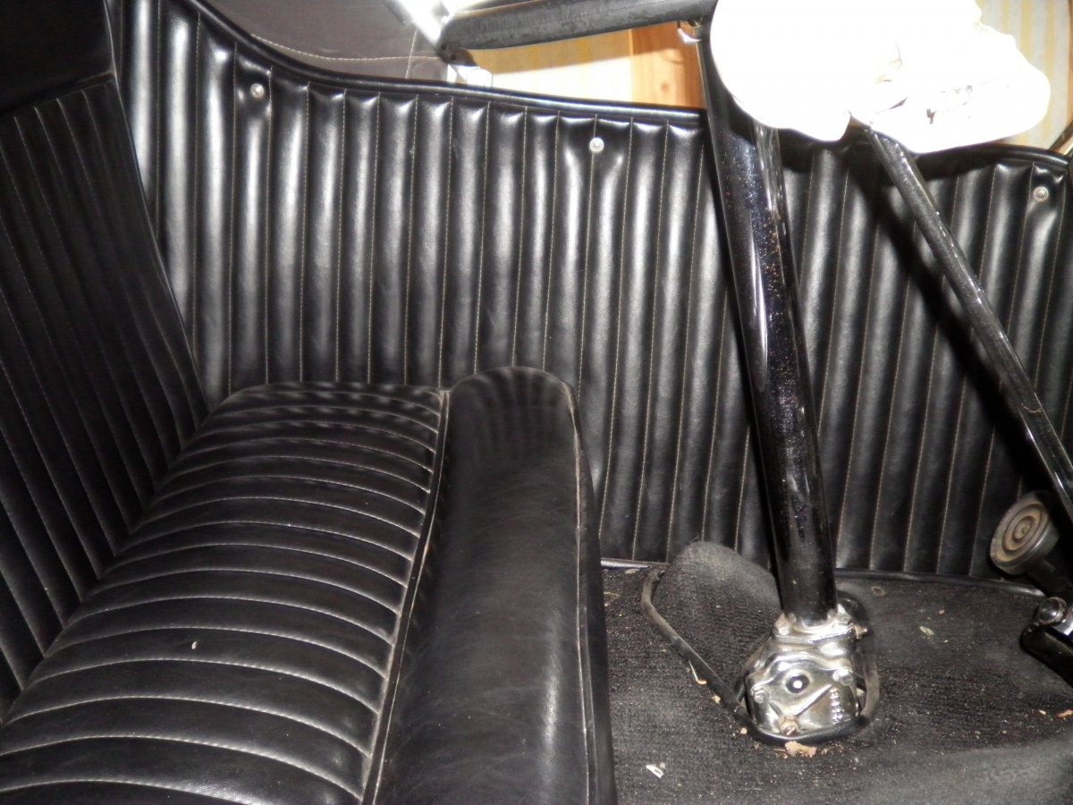

    Learn something every day. Norm's roadster probably had the clamp mount as I heard his used to move forward and back. Mine has a bracket with bolt holes on it.

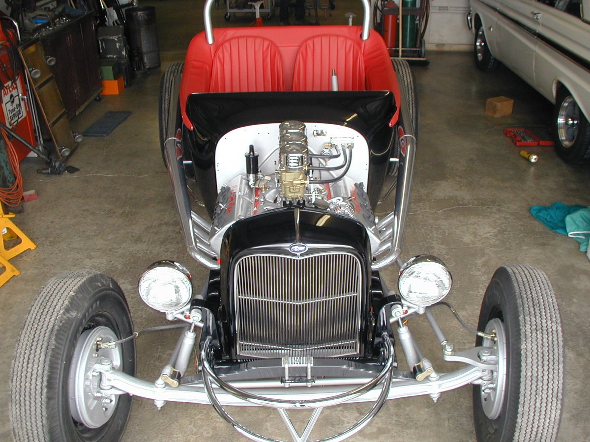

    You can see the wheel position a little bit in this shot taken at Rod Tops shop.
