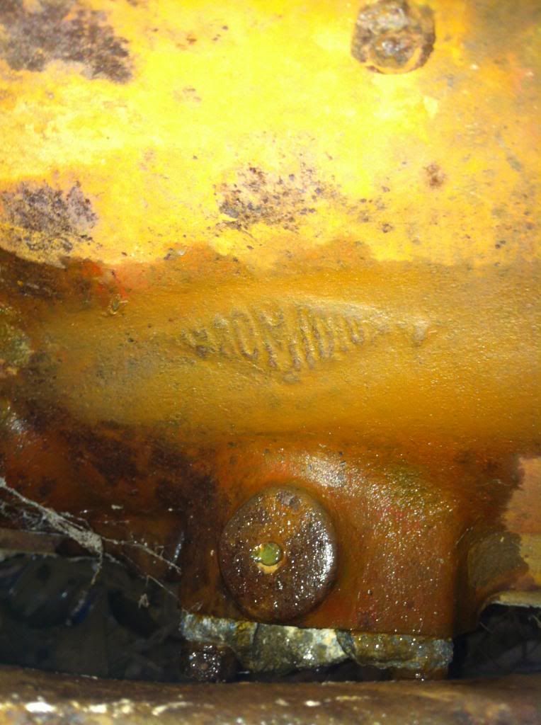

    I still couldn't find any markings on the chassis rails anywhere but, I heaved the engine block over and found that it had a name cast on the other side of the engine block.
    I can't really make out the name but it is something like "CHROMIDIUM" or "ROMIDIO" or something like that. I took one photo of it then chucked some water over it and took another.
    There is also a photo of some numbers cast onto the top of the bellhousing part of the block which seems to have SC inside a diamond and some engine numbers. "M07030" above and "LP 223"
    There was also the part number Z390 cast into the engine fan boss.
    It does definitely have a cast aluminium sump aswell.
    Any ideas?
  6. jelp
    Joined: Oct 1, 2009
    Posts: 17
    jelp
    from australia
    Morris or Morris-Commerical

  11. fletty999
    Joined: Apr 21, 2013
    Posts: 23
    fletty999
    from Australia
    Thankyou everybody for your replies,
    I have concluded that the truck is a Morris Commercial T type, which was made from 1924-1931.
    Apparently that model did not have front brakes, and it has the same front suspension and light mounting bar.
    If you have a look on this page and scroll down a bit there are a few photos of the same truck with the
    same engine with dual rear wheels:
    http://www.flickr.com/groups/1447329@N22/pool/
    Also the Chromidium on the engine block was a type of casting metal used by an english cylinder manufacturer as well which helped narrow it down.
