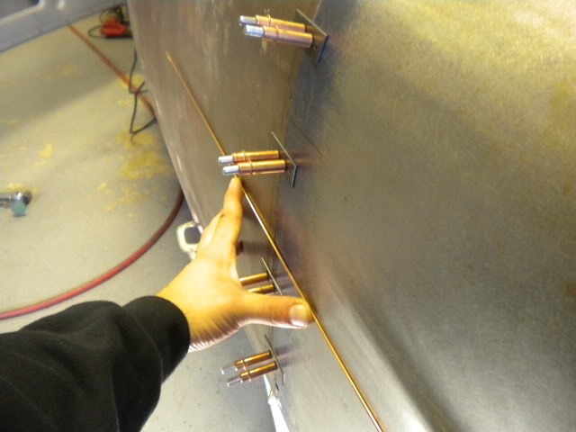

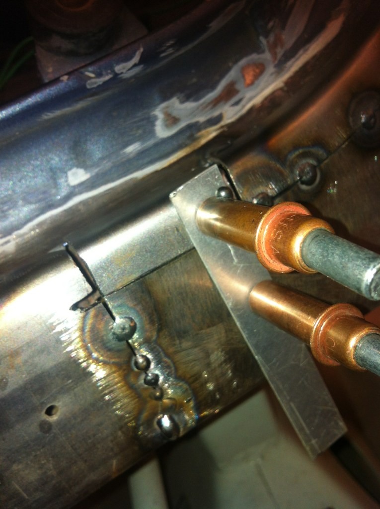

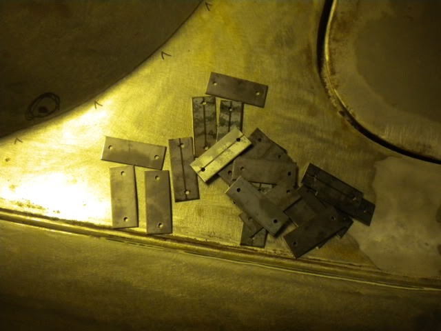

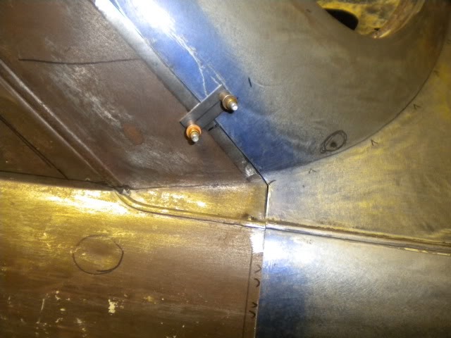

    Why not use clecos and a few strips of steel.. This is what I have been doing ever since I saw these pics here on the hamb works like a charm
    ImageUploadedByTJJ1361294398.713774.jpg ImageUploadedByTJJ1361294418.259184.jpg ImageUploadedByTJJ1361294460.380866.jpg
    Taken from here from .. Guy who made is 4dr shoebox into a 2dr

    This might be a dumb question; how the "beep" do you get them out afterwards?
    I might be a dumb ****, but it will only work on stuff where you can reach the backside?
    The cleco looks more like something that i could use, but that is only for stuff you lap?
    Is there ar DIY Cleco?

    Lossen the wing nut ,tap the pin out on the back side ,remove the clamp. Not for blind areas without acess unless you dont mind losing the pin.

    The pins actually come out pretty easily but usually the clamp get used on panels that you have some access to the back side anyhow.
    I don't think it would be productive to make your own clecos but they are readily available from a lot of sources including aircraft surplus stores, tool supplies that cater to aircraft work and ebay. You do need the pliers that go with them to use them though. This Ebay add has 50 clecos and a pair of pliers for 38.95 and there are dozens of similar adds for them. 190628766805

    Had to Tig weld this little corner piece in on Monday didn't have anyone to hold it while i spotted it in place and couldn't get a clamp on it... Used the ole **** weld cleko trick ...thought I would show it... I use it all the time ImageUploadedByTJJ1366768102.615757.jpg
