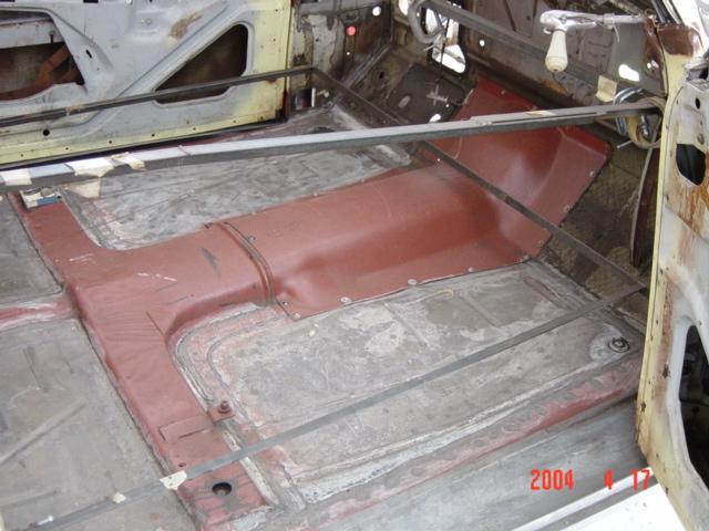

    If you decide to lap weld. Use a flanger puncher to pop some holes in your new panel then plunge weld the holes. Use weld through primer on both the old metal and the new panel. then weld both top and bottom . Use seam sealer both top and bottom to seal from moisture .
    Or just **** weld the panels 2012-01-09 00.59.47.jpg and seal them . Floors **** welded. Spare tire well lap welded.

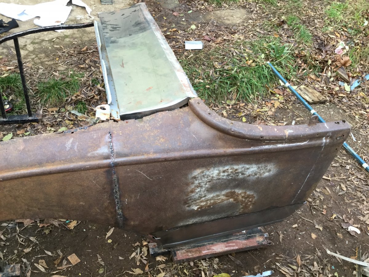

    I was an iron worker for 30 years fitting and welding sheet, plate, shapes, you name it. Lap welding sheet correctly requires twice the work as **** welding if your doing it right, (weld one side, turn it over weld the other side), warping is the culprit doing this. I much prefer **** welds.
    I had to move my drive line tunnel when bringing the body down because of the offset of the Jag pumpkin and **** welding was the ticket. 100_1414.jpg
