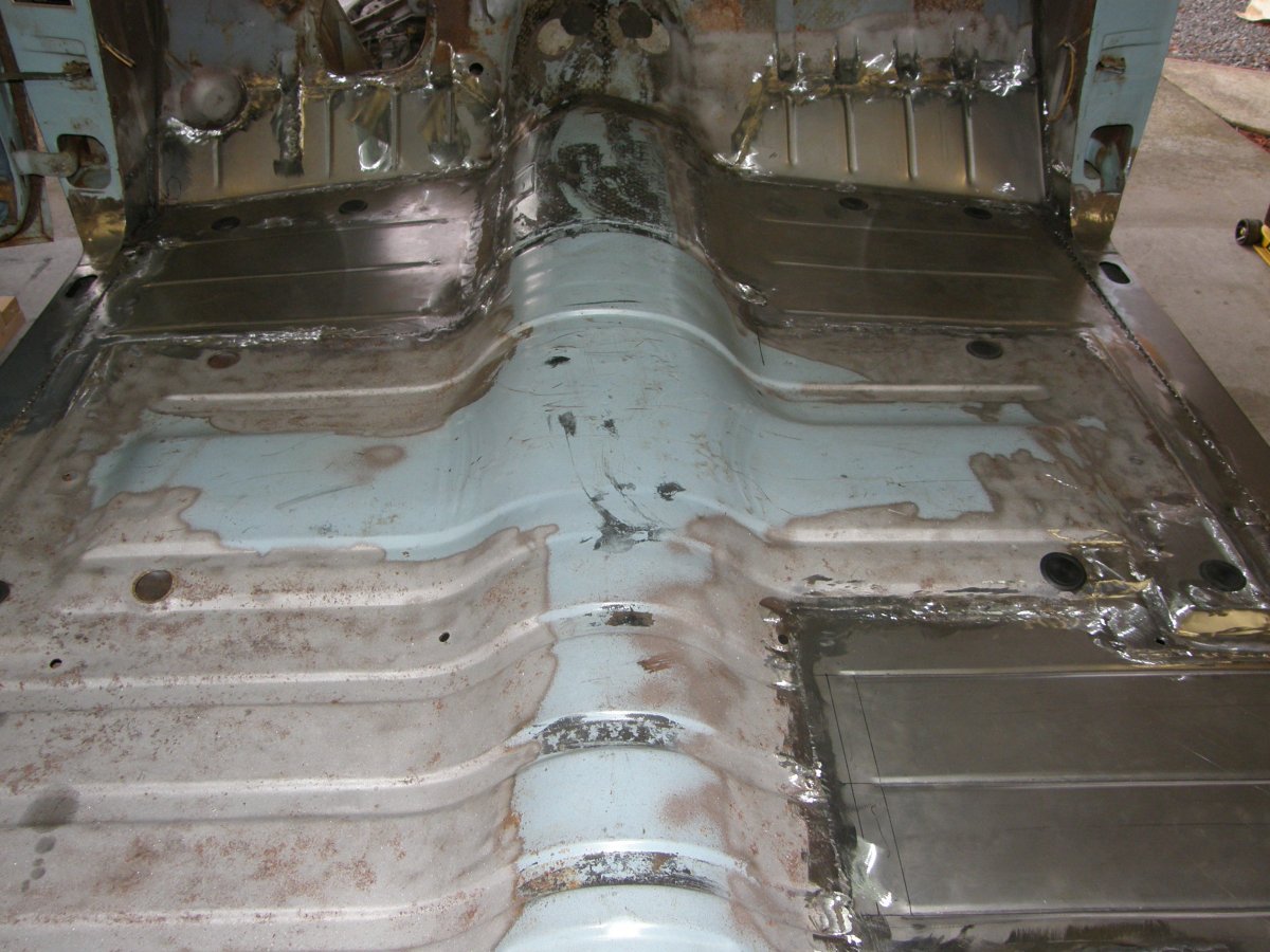

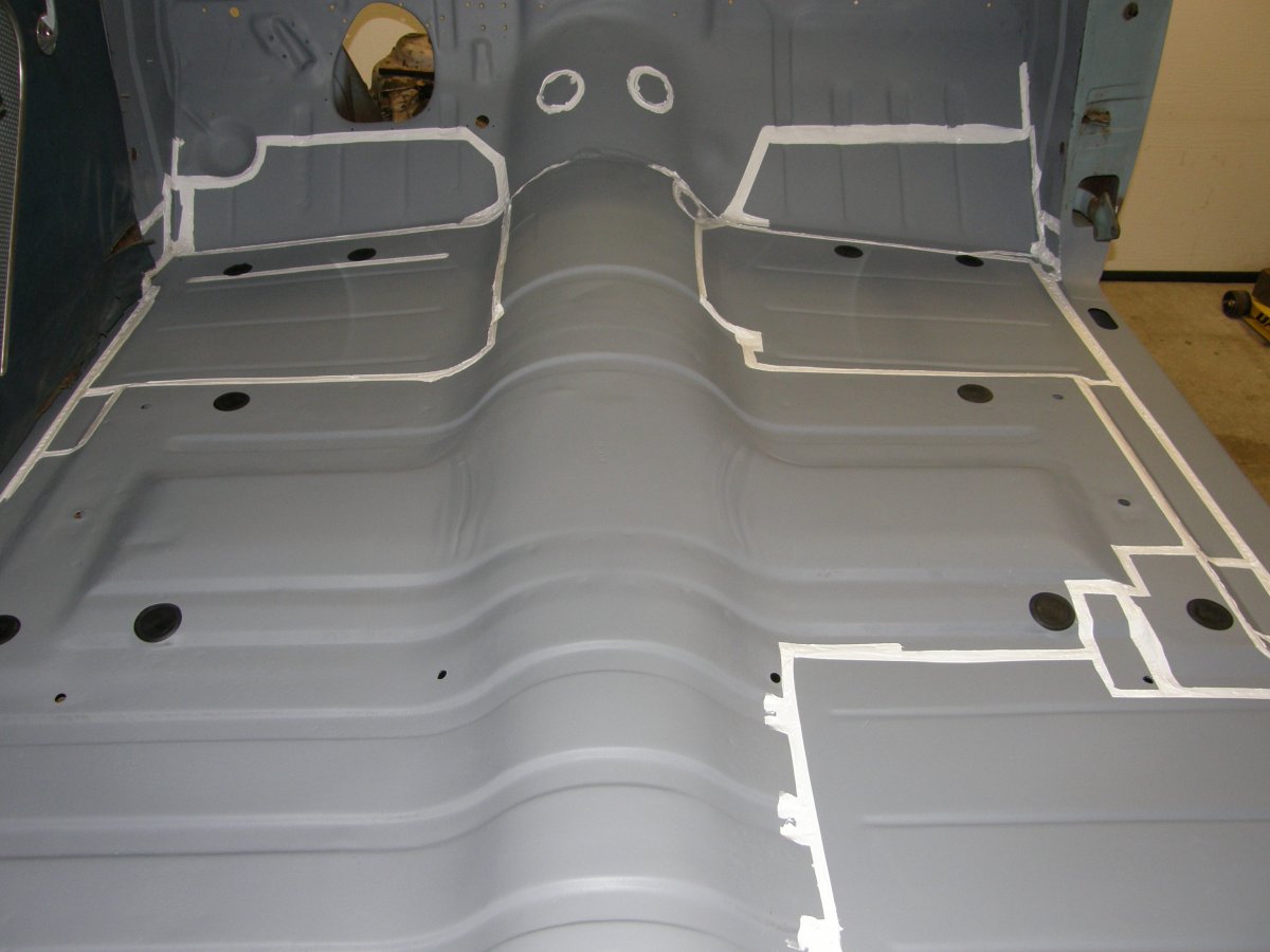

    Forgot about this thread! Well, I **** welded everything. Primed and sealed it and I'm done. Definitely improved my welding skills and am very pleased with the outcome!

  5. Looks great

    That finished product looks really good. You made the right choice there.
