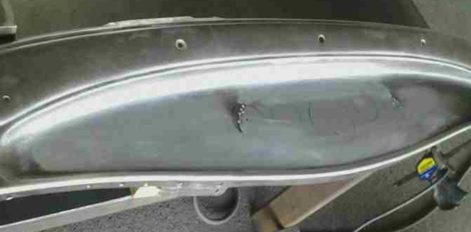

  22. wex65
    Joined: Dec 19, 2012
    Posts: 1,144
    wex65
    from WV
    Despite being the OP I have held off replying to let the discussion flow a**** those FAR more experienced than I. I am happy I did.
    I truly appreciate the time people have taken to provide an insight as to how they would approach this type of job. I spent some time trying to get an even gap but found it nearly impossible with the curve of the panel and trying to hold it in the precisely same place each time. I will do the best I can but practice the bulk of this weekend till I get to the point I am no longer blowing holes.
    Confession time, I have a second set of wells en route from Snyders (see my other thread and AVOID Brookville wells!) after trying to tack one of the first set on. Didn't have enough patience and attacked the job only to blow multiple holes though. A learning experience... rather than butcher it I will simply remove the panel, hide it from the world and practice, practice, practice BEFORE attempting it again.
    I am using a Millermatic 211 Autoset which is a VERY good unit. I have it on lowest setting and still blowing holes. I am using it on 220v, maybe need to step down to 110v. Also, have 30 wire in it, will switch to 23 and see if that helps.
    Keep the comments coming, they are appreciated by many I am sure...

    Don't fret a mistake or miscue, at least unless you keep making the same ones. Since you're waiting for new stuff, here's something to try. Got any heavy aluminum? Can you back up what you want to weld? Try it. The aluminum becomes a heat sink to the thinner metal and will allow the fusion w/out burning away. It gets hot quickly.

    Well, I offered to bring you a copper backup bar, "free" and being a 30 year experienced weldor could get you rolling on your panels. Either your paranoid and think I`m caseing your place or just don`t want any personal help, that`s fine, you can learn the hard way, keep blowen them holes and buying new panels:rolleyes:

    Take the offer for copper backup and instruction. You can learn a lot watching someone with experience.

    Sheet metal ****clamps and tack ... Tack... Tack...tack...tack

    Fitty.I will PM you. Being honest I wondered what the hell you were referring to but just checked back and seen your first post, missed it before. I am more than humble enough to realize I don't know what I am doing and ALWAYS welcome help. Happy to provide iced tea/beer and burgers too!! :p

    I remember someone saying to me a while back. You will wither get good with the welder or good with a grinder...:D
    Happy to say I will be seeing Fitty in a couple of hours. The plan is as follows:
    1) he arrives *
    2) he spends 30 mins in the workshop laughing at my work thus far. This will likely involve him having to sit down till the pain in his sides subsides.
    3) he points me in the right direction and sets the welder up to weld as opposed to blast away everything in its path.
    4) he has a final look at my work as he leaves and spends 10 mins sitting in his car laughing before driving away.
