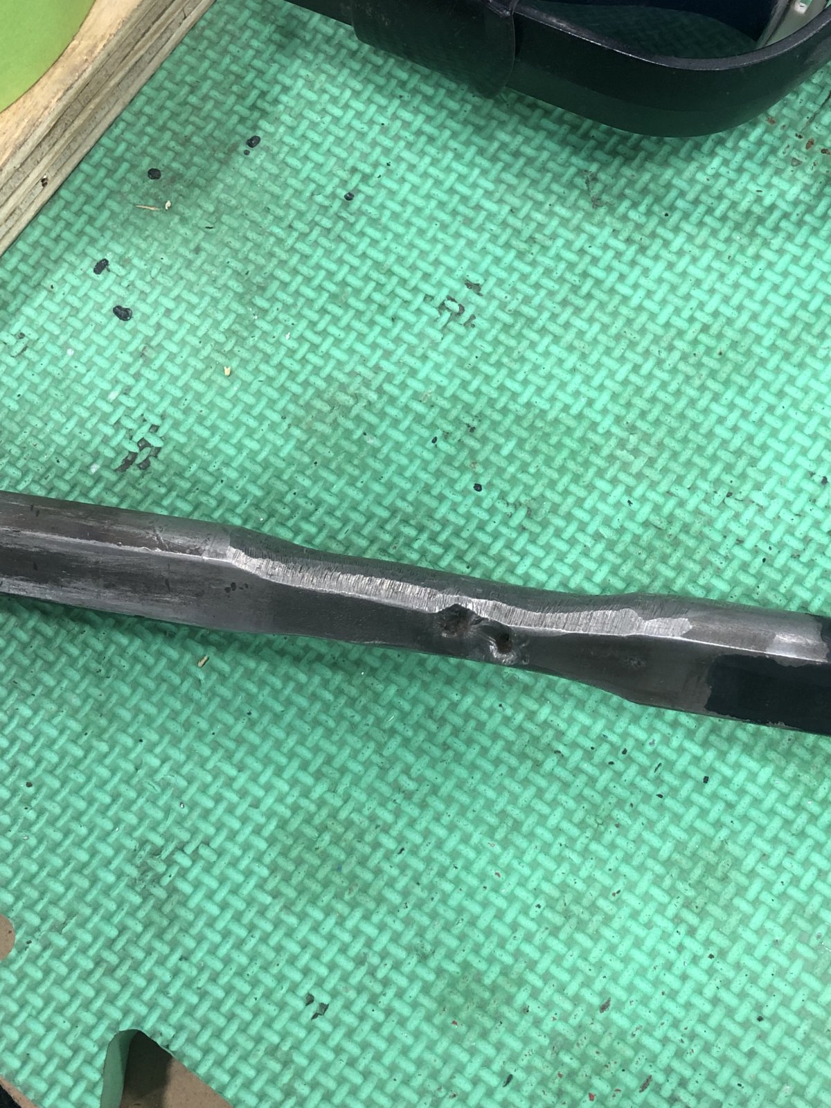

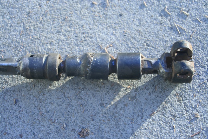

    here's a 40 Ford pickup built in the 80's with an interesting steering set up where the previous owner used swivel sockets to link the column to the rack. it seemed to steer fairly well but the booger welds on the mount and the cracked weld on the boxing plate were a bit scary. note the collapsible column in the first picture. also note the thin wall tubing in the first half of the steering set up.
    a friend inherited it from his father inlaw.
    felt much more solid after a call to Borgeson.

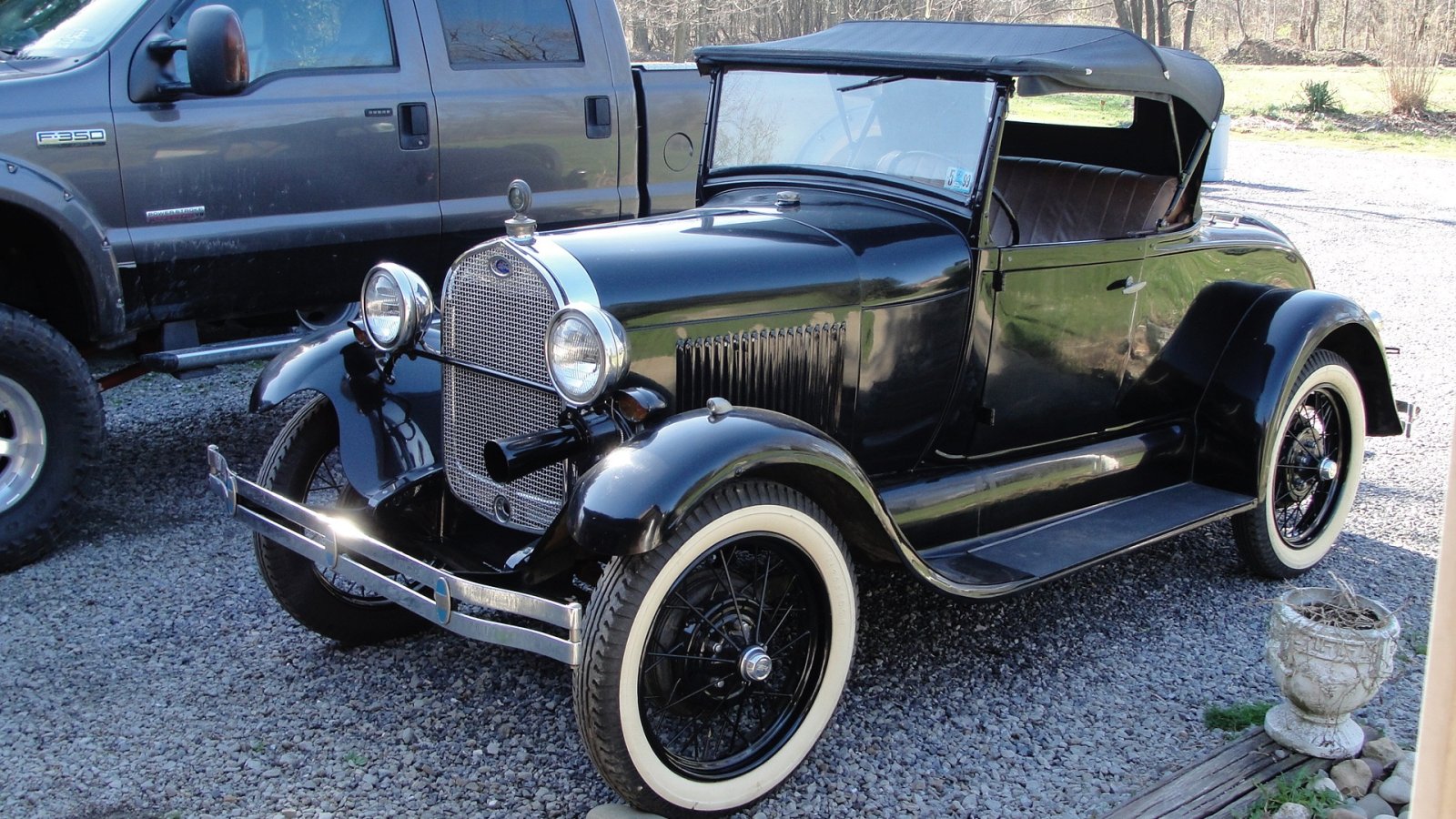

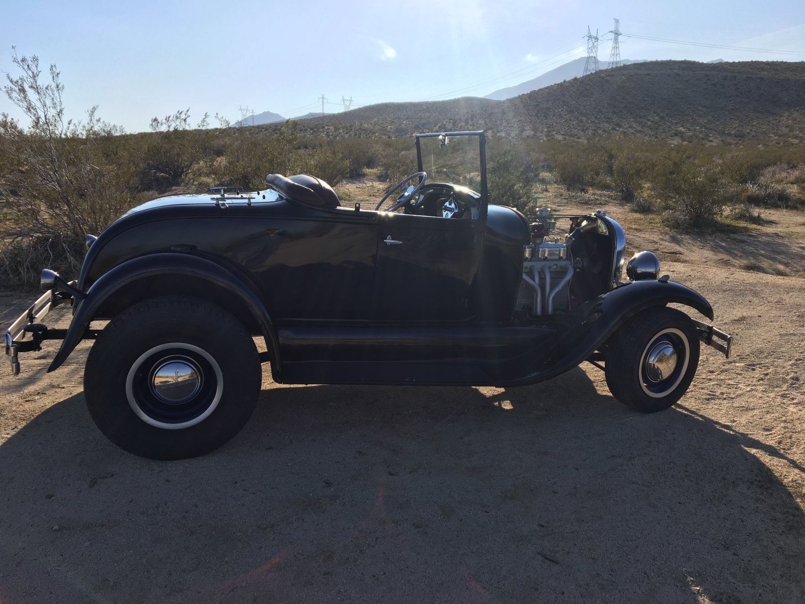

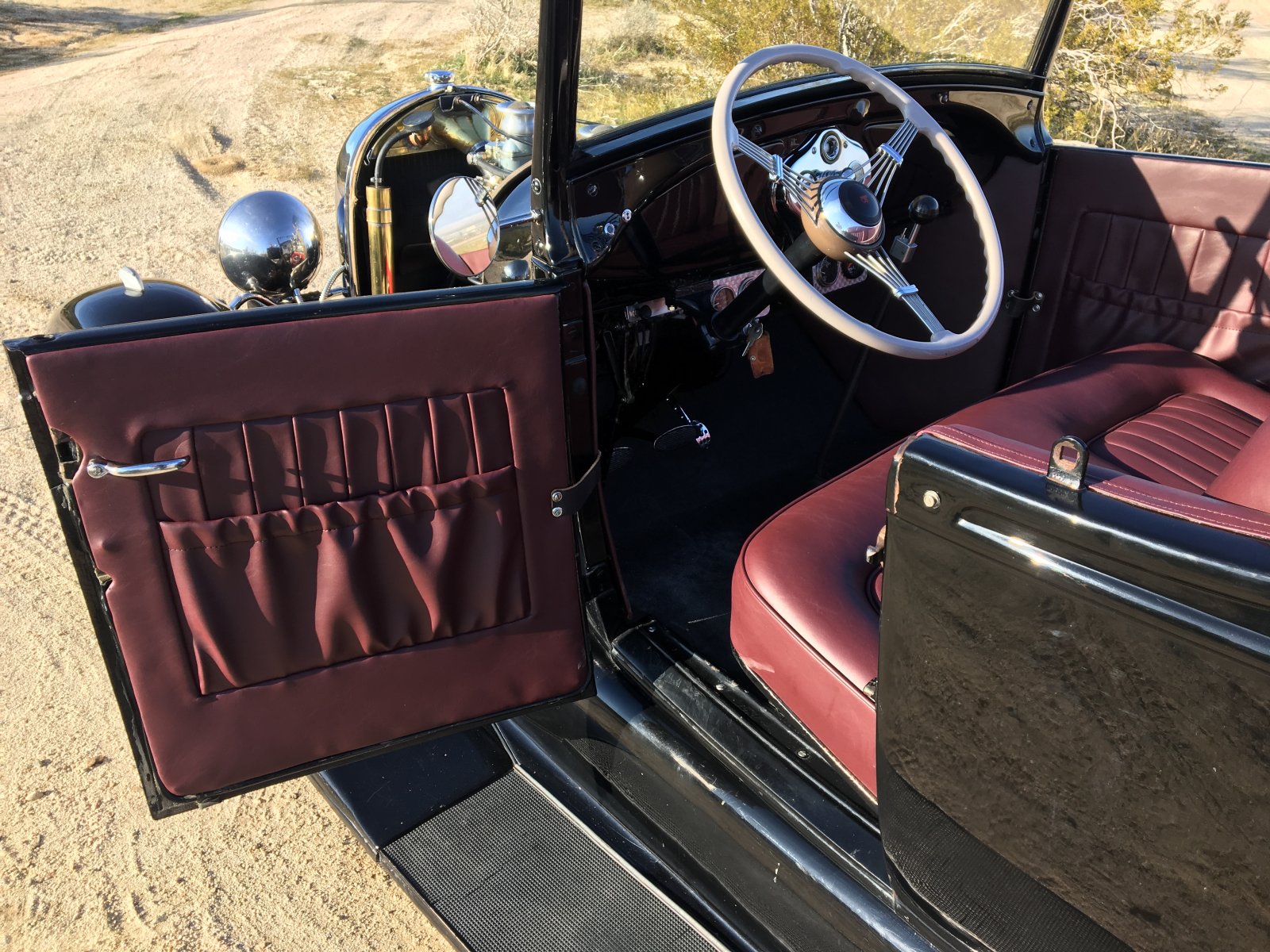

    This is my roadster. The previous owner was the second owner. He bought it when he came home from WWII. According to his son, it was restored in 1989 by his father who was a "master mechanic" and was such a famous mechanic that he was called upon to go to Florida and work on the space shuttle. DSC06293.jpg This was the picture on eBay. I drove across country to get it. Looked like a perfect start for a hot rod. It had a Pennsylvania inspection sticker from 6 months after it was "restored". Pennsylvania must like copper brake lines.
    IMG_0323.jpg Hydraulic brakes are an improvement if done right. The Penn safety people must have thought this was an improvement. IMG_0630.jpg You need a good emergency brake to go along with the improved brake system. IMG_0655.jpg If you dont have cotter pins to secure the rod nuts you can use pal nuts. Actually any old nut will work as long as it has at least two threads to catch. This might have been how the "Master Mechanics" would balance engines back in the day.
    I could go on but I think this might be in the top ten for nice looking cars that are a POS. Oh well, the body really was pretty decent and the 1989 Impron paint (there was a tag under the kick panel) is still pretty damn good after 33 years. How it looks today 10K miles later: IMG_3871.jpg IMG_4025.jpg

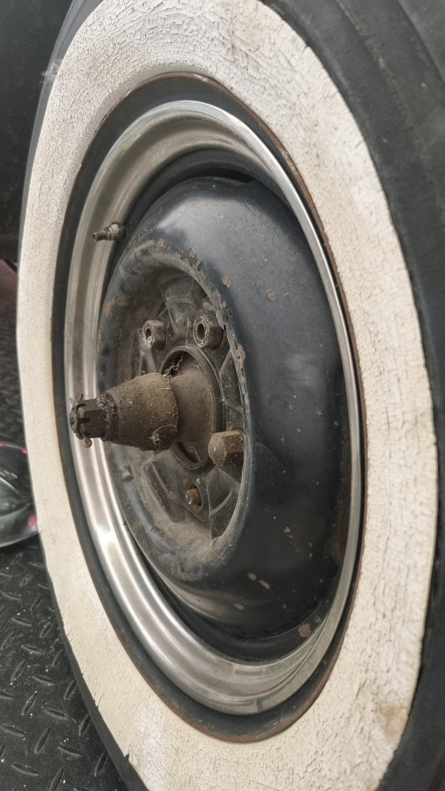

    My Model A came with 40's ford wheels. This is what i found when i took the caps off. Only 4 wheel nuts, the ones that were on only had about 2-3 pitches of engagement. The 5th stud did not have enough good thread to even get a nut on.

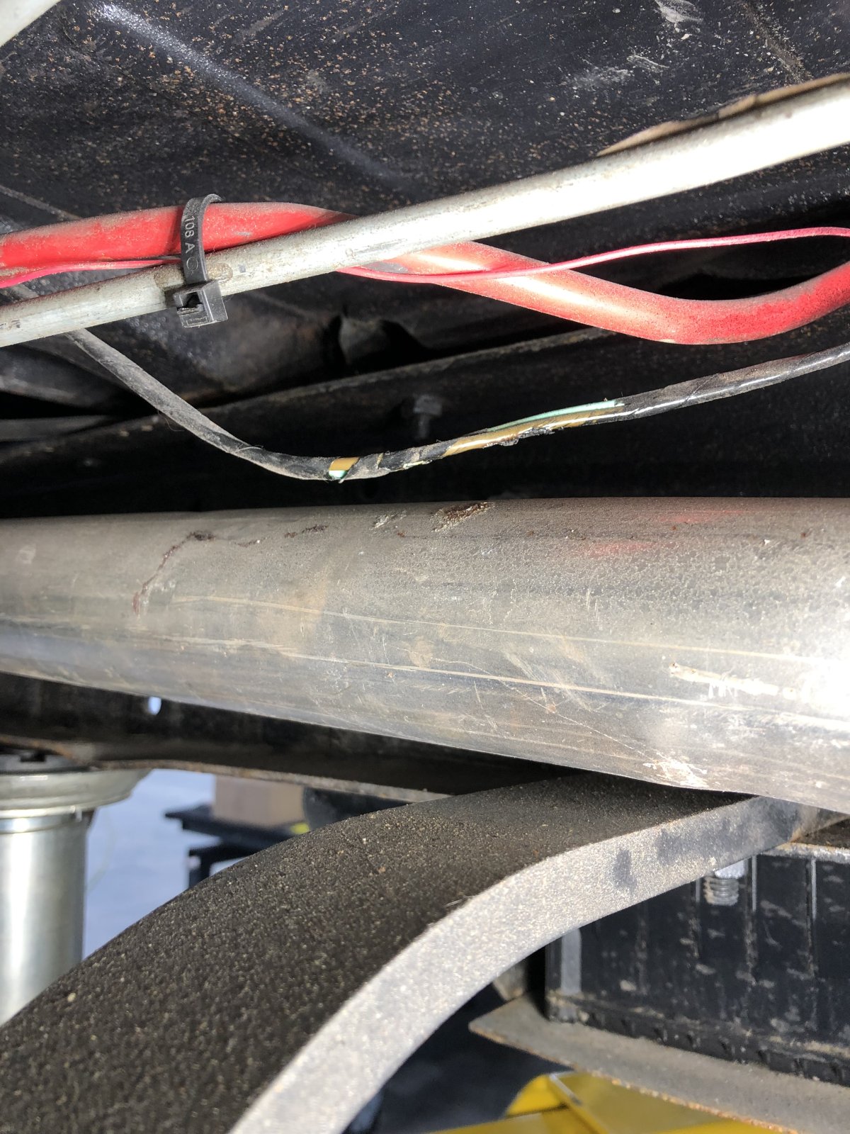

    My buddy who owns a nice shop had a customer bring in a '64 Impala SS ragtop that he bought on a TV auction, he called in his "winning" bid by phone.
    I mean it LOOKS nice, the paint itself was good. It was on the lift when I saw it. The entire ch***is was plated with steel and painted... wonder what was under that mess. The body lines were awful and it had a good amount of bondo on it. It eventually needed a valve job, after that it ran well.
