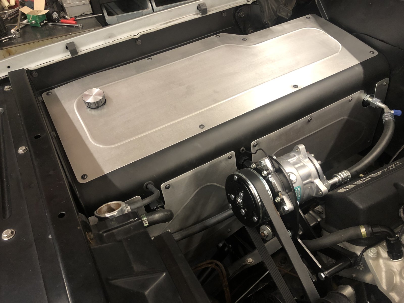

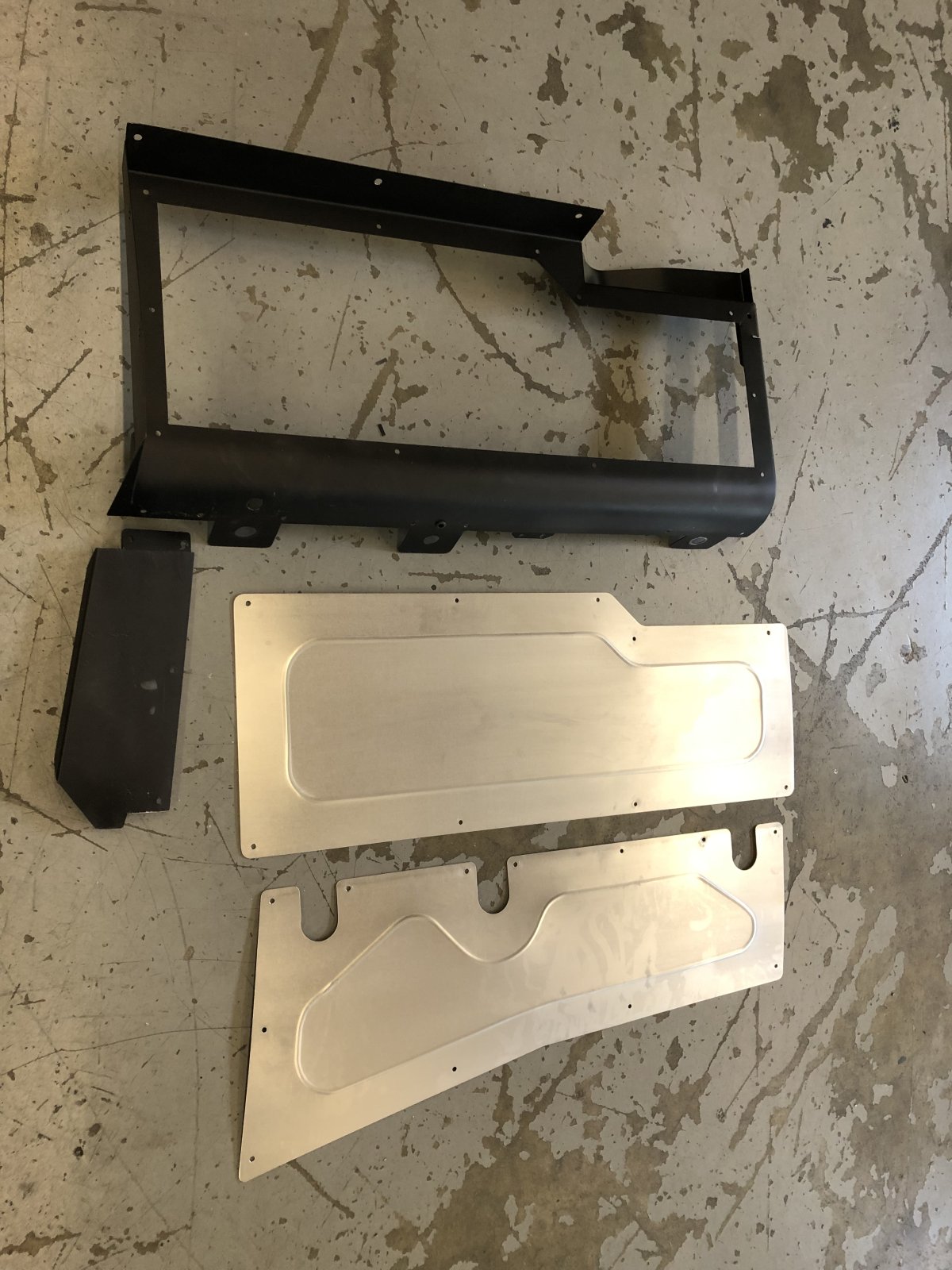

    I use my Tennsmith 4 foot finger brake almost every day. You can make an unbelievable amount of cool parts with a brake and shear. Made these inner fenders Friday for an OT truck but you get the idea. You can make rolled corners by clamping a round bar stock under the fingers as well. 95435C7E-4F4F-45EF-B7E0-EED220721ABD.jpeg 62FEC442-5CF6-41E5-AFDC-E4ABEE1D688A.jpeg 6D9F859E-DFD8-4D4B-ACA0-C835EB3F96AA.jpeg

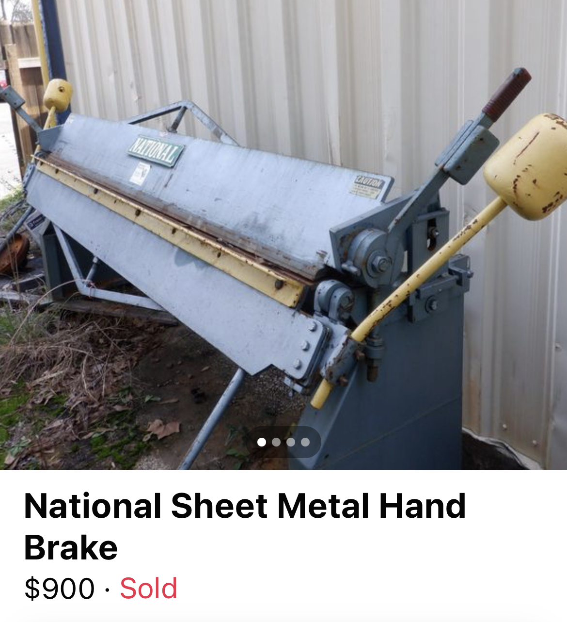

  23. I stole an 8ft brake for $900 then a 4ft box pan for $150 on marketplace
    Do some shopping
    You spend most of your fab time cutting.
    A shear would be on my list.
    Bought one from a s**** yard.
    The 3 foot ones are usually cheap.
    I have a 10 inch bench shear I use all the time. Cheap from Woodward Fab
