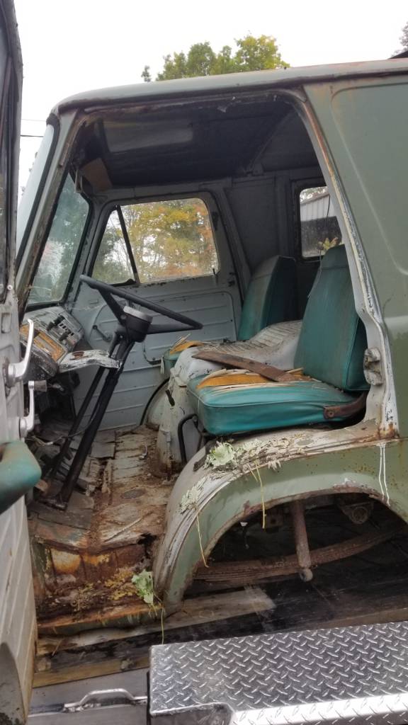

    Hi all, like the ***le says I'm picking up an early econoline on Monday. Saving it from the crusher.
    Problem is the front straight axle is missing. It will be put on my trailer with a loader, and most likely skidded off.
    What are my options for a replacement front axle?

    What’s wrong with buying another econoline axle? Were the wheel wells cut or is that rust? Cause if it’s rust, my guess is an axle is the least of your problems. Good luck!

    Wonky wheel well cutting .

    Its rot. I'm in New York state, honestly for a 60yo vehicle from here it's not that bad.
    The plan is to cut some wheel arches from another car and graft them in.
    Finding another econoline axle nearby isn't going to happen...

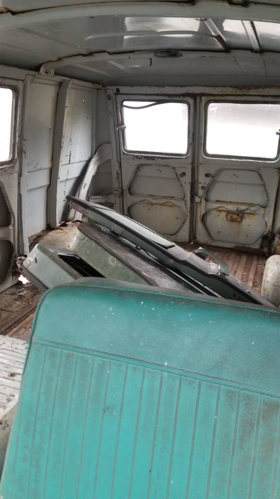

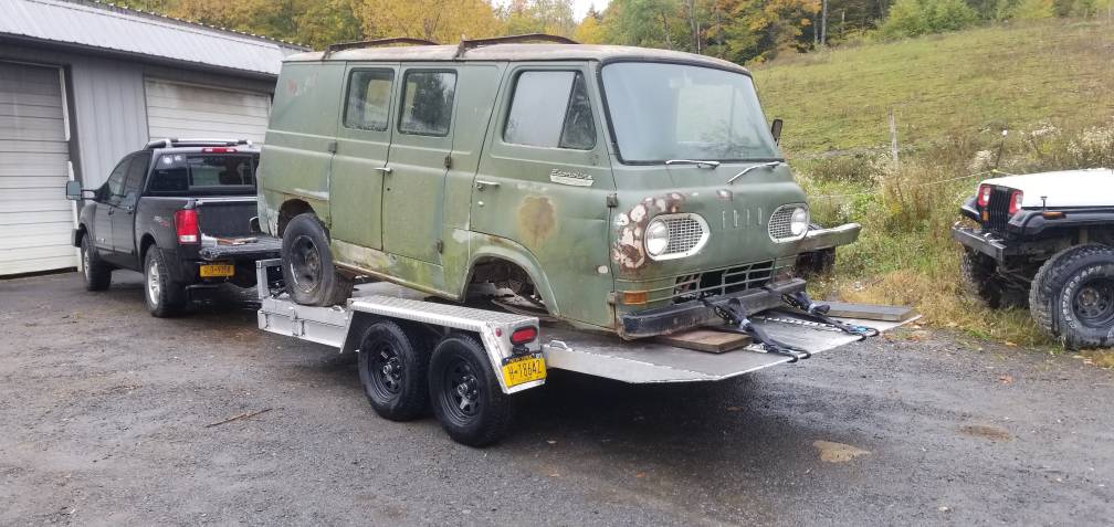

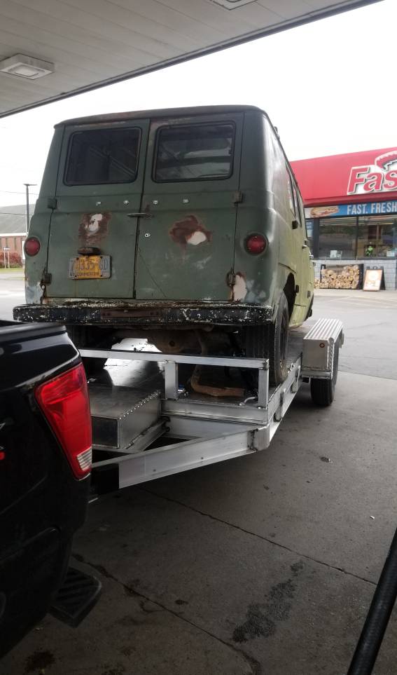

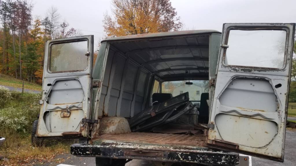

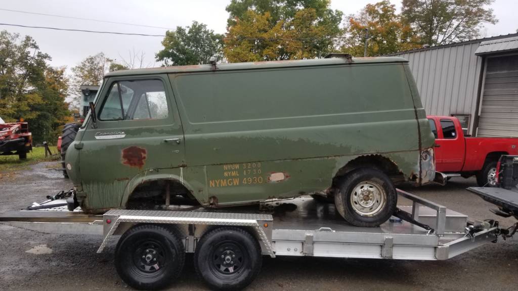

    It's a sickness, but the rear axle alone is worth what I paid for it 20201005_115341.jpeg 20201005_110511.jpeg 20201005_120141.jpeg 20201005_120154.jpeg 20201005_120210.jpeg 20201005_120215.jpeg 20201005_120446.jpeg
