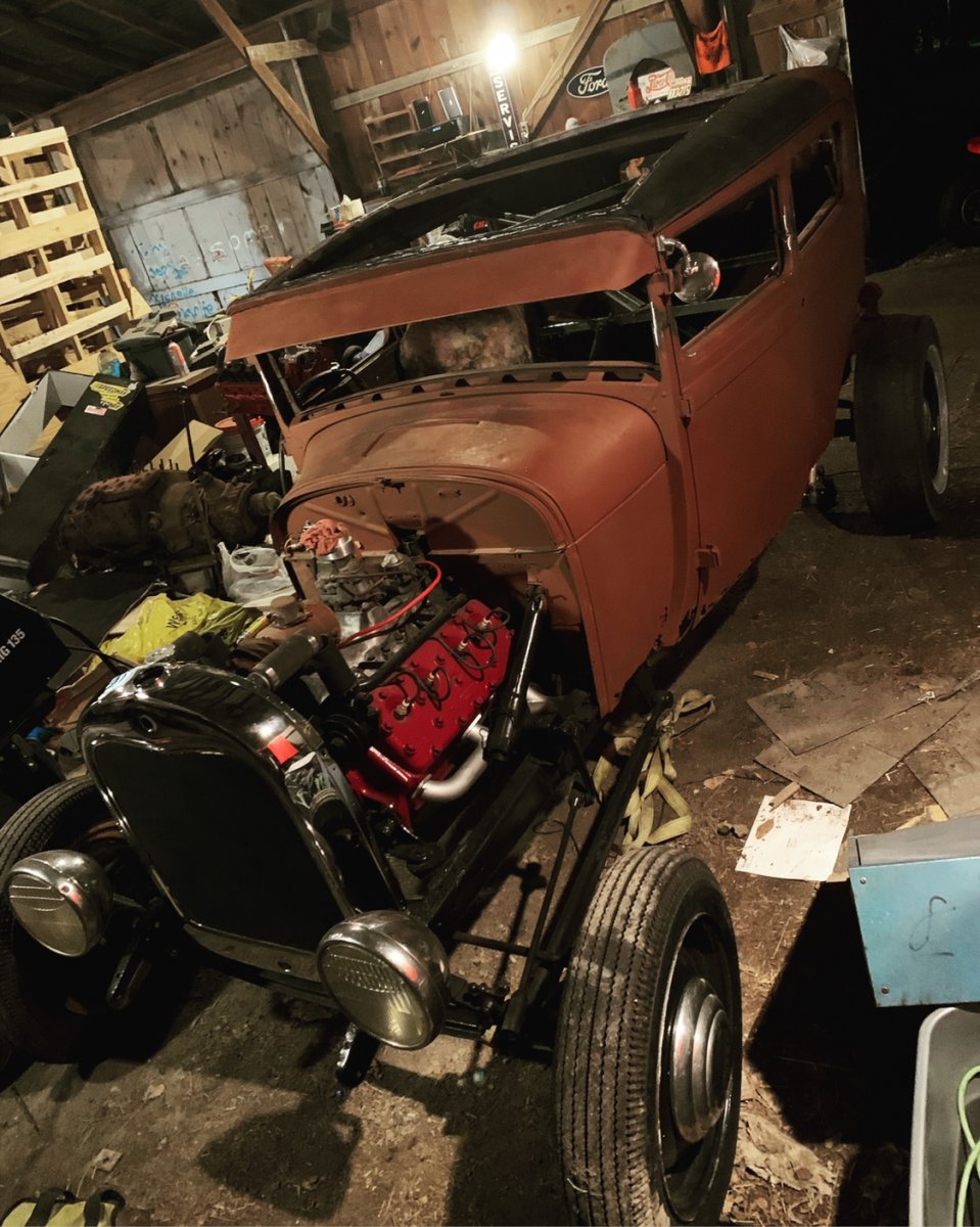

    Love this shot of the back. I look at the before photos and thing damn you could drive a Mac truck threw that back window! Looks so tough can’t wait to see it all stitched up and outside AD1C2E8D-F2C8-40C9-81B3-7C28B3290784.jpeg

    Me either man. There’s a little odd crease in the back right where someone along time ago appeared to have backed into a telephone pole or something haha could get tricky when stitching it up

    Welded up more of the roof tonight man there’s a lot of nooks and crannies!!!

    C3DAD54D-AF90-465C-8EDC-41A60A82AFCA.jpg 81693478-BD0B-4876-A3EA-CCE36B9365A6.jpg weld grind weld grind weld grind... I think it’s all worth it haha. Never think of what chops look like from different angles so climbed up on the shelf’s and wasn’t disappointed [emoji23]

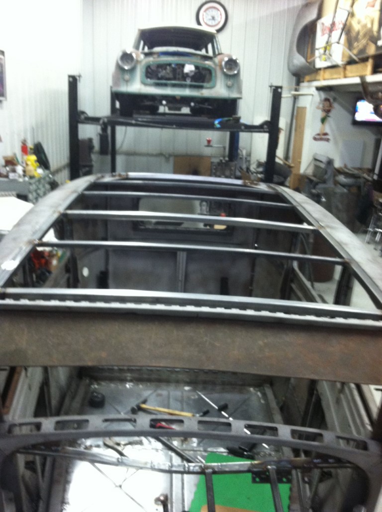

  23. Actually the top bows could easily be made from 1x1 tubing. We could give them a little arc with a bottle jack and a couple of blocks to prop the ends up.

  28. Kinda fuzzy but here's how we used 1x1 16 ga tube to replace the top wood on Pat's '29. We also framed in the back window opening with tube. The arch was rolled with a home made roller; but 16 ga is easily bent by other means. We formed and curved 18 ga channels to fill the door posts. Not in this picture; but we also welded the header in place and filled between it and the first bow with sheet metal.
    Also replaced the wood mount blocks with steel and webbing.
    Stogy, Okie Pete, porknbeaner and 3 others like this.
