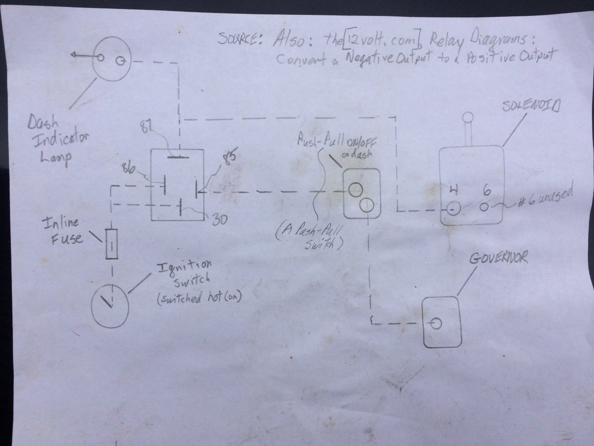

    This is the way I have been running two different overdrives for over 20 years on a dd/only vehicle now at 114 k miles in this form. I have a push/pull switch mounted conveniently on the dash using the 'T' throttle knob and position, to those of you that are familiar with Advance Design Chevrolet trucks. I am three on the tree and I have modified my home-bent shifting rods to accept heim joints for smooth shifting. Further modification was done to the shifters in the engine compartment, I shortened them and I used the shortest transmission shifter arms to achieve smaller radii. By doing this my shifting is precise, short and crisp.

    Squirrel said something that was spot on so I'll have to walk back to see it. Yes, he mentioned how the Overdrive ON Lamp functions... the way I have it wired above, the light comes on when the governor reaches the cut-in speed, for me ~30 mph. An interesting side note to this '69 OD governor is that it has two adjustments where a guy could actually adjust the cut-in point to achieve a 6 speed! I actually had her set up this way for a couple years... 1st, 1st overdrive, 2nd, 2nd overdrive, 3rd, 3rd overdrive! A true 6 speed. You should have seen friends faces when I 'rowed through the gears'! Hahahahaha.

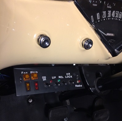

    I made my 3 spd OD into a 6 speed using the following diagram The switches are on a control panel bolted to
    the bottom of the dash. It probably isn't practical (my truck has a 348 with 3:38 gearing in the differentials). but it is fun. I can't find the article online anymore, but a pdf attached.

    Fun idea but seems not very user friendly. Even using the BW unit as a five speed is overly complicated with marginal if any gains to be had.
  6. donsz
    Joined: Nov 23, 2010
    Posts: 253
    donsz
    This is just something I wanted, so I constructed it. I don't think it is complicated, but I have
    been accused of making the simple overly complicated, so you may be right. However, I don't
    believe everything needs to be entirely rational, otherwise the world would be very boring.
    don
