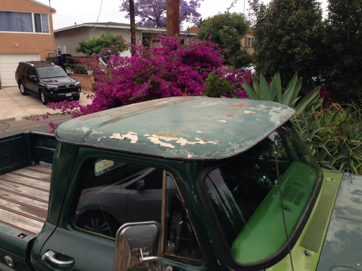

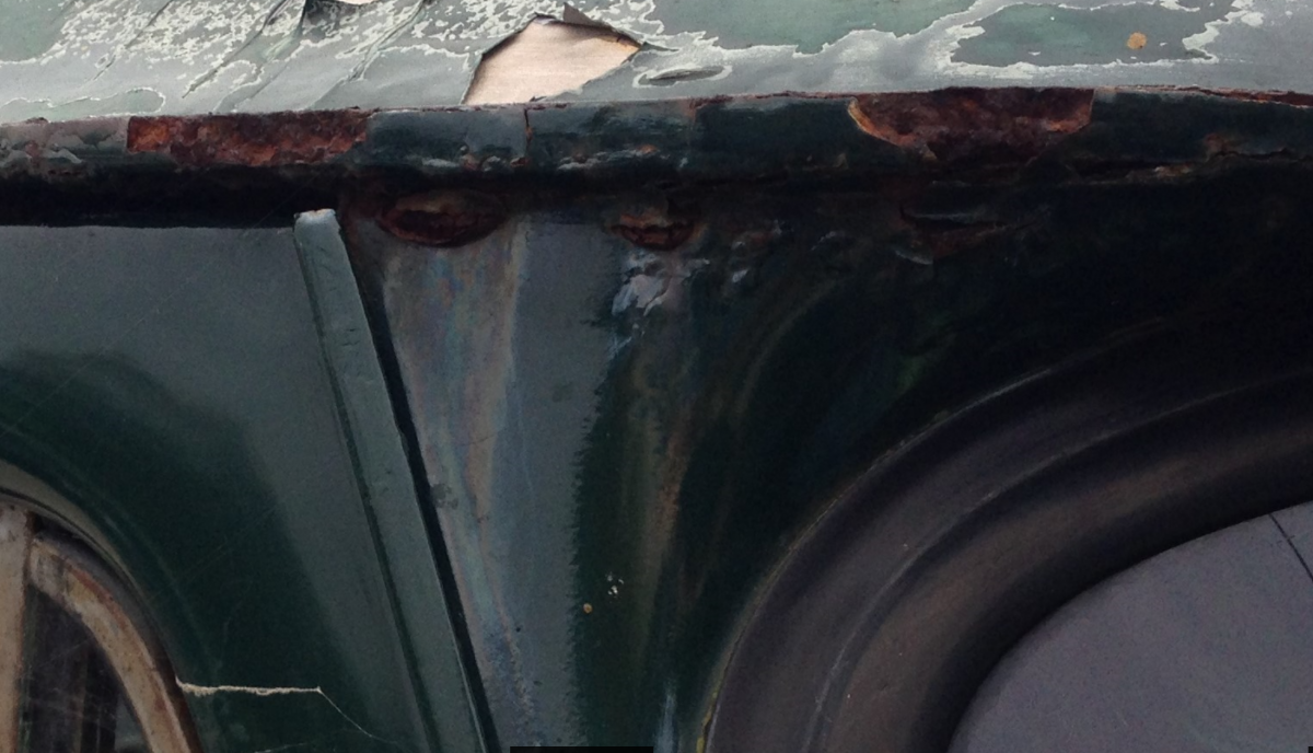

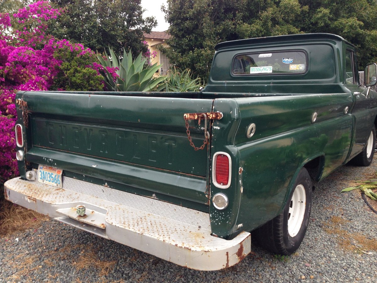

    Hi All,
    It's been forever since I've logged on here much less posted (been super busy with work travel for the last several months).
    My C-10 has some body rust, some of it surface rust and some of it looks to be severe (above the windshield, etc). I've enjoyed driving the truck around short distances every now and then since I got it last October and am hoping to hold on to it for some time (maybe a few years) but I am not going to put much money or any body work into it and may get a nicer C-10 and sell this one as is later on instead of dumping money into this one.
    That being said, should I buy POR-15 (along with the degreaser and metal prep bottles) and paint it on the parts of the cab and roof where the metal is really getting eaten up? Should I leave the surface rust on the roof/hood and all those other endless places on the bed/etc alone? Or am I better off doing absolutely nothing? I don't mind applying that stuff with a paint brush to the areas that are severely getting eaten up but I don't think I'll have time to be sanding huge areas down and spraying (and I may make a huge mess and get neighbors complaining to the landlord), and certainly no body or metal work. If for some reason it does seem like it won't be too hard to sand some of the roof and hood, I'd have to do a rattle can job on everything outside.
    Thanks!
    Here are some photos:
  2. 49ratfink
    Joined: Feb 8, 2004
    Posts: 25,378
    49ratfink
    just leave it alone. putting something on it will just be one more thing to remove whenever someone decides to fix it right.
  3. metalman
    Joined: Dec 30, 2006
    Posts: 3,299
    metalman
    Brushing a little Por15 on those rusty spots can't hurt and might slow the process. Get the light grey and it will blend in better (primer look) then the black will. Wire brush the loose scale/ paint off first.
    The damage is already done and a proper fix requires a lot of work which I understand isn't feasible for you right now.
    The Por15 will just be a bandaid but better a bandaid then an open wound!
  4. 53CHKustom
    Joined: Jun 24, 2014
    Posts: 1,433
    53CHKustom
    Thanks.
    Yea I bought it with a lot of that rust but I bought the truck mainly just to have fun with it a few years knowing I would dump it as is at that point with no real need to recoup any of that money as I paid very little for the truck.
    Are you suggesting I put Por15 on those bad areas under the cab roof just above the windshield and along the side? I think that part of the roof is called a bonnet?
    The surface rust with larger areas on the roof looks like a a lot of work and will look uglier than it already is? Unless I were to paint green with a rattle can after.
  5. squirrel
    Joined: Sep 23, 2004
    Posts: 60,095
    squirrel
    park it inside, and don't worry about it. If you can't park it inside, then don't worry about it, either...it will still be rusty when you sell it, or decide to spend a bunch of effort fixing it.
    Painting Over Rust is not really fixing anything, it's just making more work for the future.

  7. gimpyshotrods
    Joined: May 20, 2009
    Posts: 24,570
    gimpyshotrods
    I have yet to see someone reproduce the roof panel. I wish someone would. It is such a common failure point.
    I have one that I cut off of a cab that we were s****ping. I have thought about pulling a mold, but it has not come up on the projects list.
  8. harpo1313
    Joined: Jan 4, 2008
    Posts: 2,589
    harpo1313
    from wareham,ma
    Don't be poking around on the front corners of that roof, good chance its very thin or already been messed with [as in hastily repaired] been there.

  10. 53CHKustom
    Posts: 1,433
    53CHKustom
    Yep, there are some thin areas and probably has been messed with before from what I saw. I could almost see some patch type pieces in some areas but I vaguely remember. I will leave it entirely alone.
  11. Budget36
    Joined: Nov 29, 2014
    Posts: 15,393
    Budget36
    I'd wire brush it and paint over it with POR15, would look better that rusty boogers hanging off it.
    Besides, if someone was to restore it, etc, they'd probably have the truck sandblasted.
    PS..I'm just talking about the area above the windshield, the rest is just surface rust, just use some RustMort, etc., on them to keep it at bay.
  12. treb11
    Joined: Jan 21, 2006
    Posts: 4,144
    treb11
    that cab is still easily saved. If you let it rust too much longer, it will turn into major damage i.e. harder to sell.

    If you want it to look a little better you can wire brush and sand the rough edges where the paint is chipping smooth, Then mask off the bottom of the truck and rattle can prime the roof. Top the primer with white or cream rattle can Epoxy appliance paint. It will hold up really well outside and there are quite a few of those trucks that were green with a white top. Would be a quick weekend project, and cost less than a hundred bucks.

  17. abner36
    Joined: Nov 5, 2014
    Posts: 77
    abner36
    This is what I was thinking as I read through here just paint the roof in another color an afternoon and some rattle cans if you take your time it will look good for a driver not a lot of money and it improves the look of the truck

  18. 53CHKustom
    Posts: 1,433
    53CHKustom
    Thank you! That's a great suggestion and I can rattle can it after with maybe another similar green. In all honesty I get countless compliments every time I drive it to Sunset Cliffs and get out to surf or even go to the grocery store. Weird, a truck in that state gets so many compliments.
    I don't mind throwing $100 to get a little better look. I actually love the rest of the truck as is, and enjoy not worrying about every little paint chip or bubble and am actually using it to do functional things.

  20. indyjps
    Joined: Feb 21, 2007
    Posts: 5,398
    indyjps
    Sand down the whole roof, use a DA not wire wheels, and brush rustoleum on it, off white, or a green thats close, theyll tint it for you. Thin it a little with acetone and read up on brush tipping, the paint should smooth out OK.
    It will protect it, look ok on that truck, and anyone wanting to restore it will strip it anyway.
