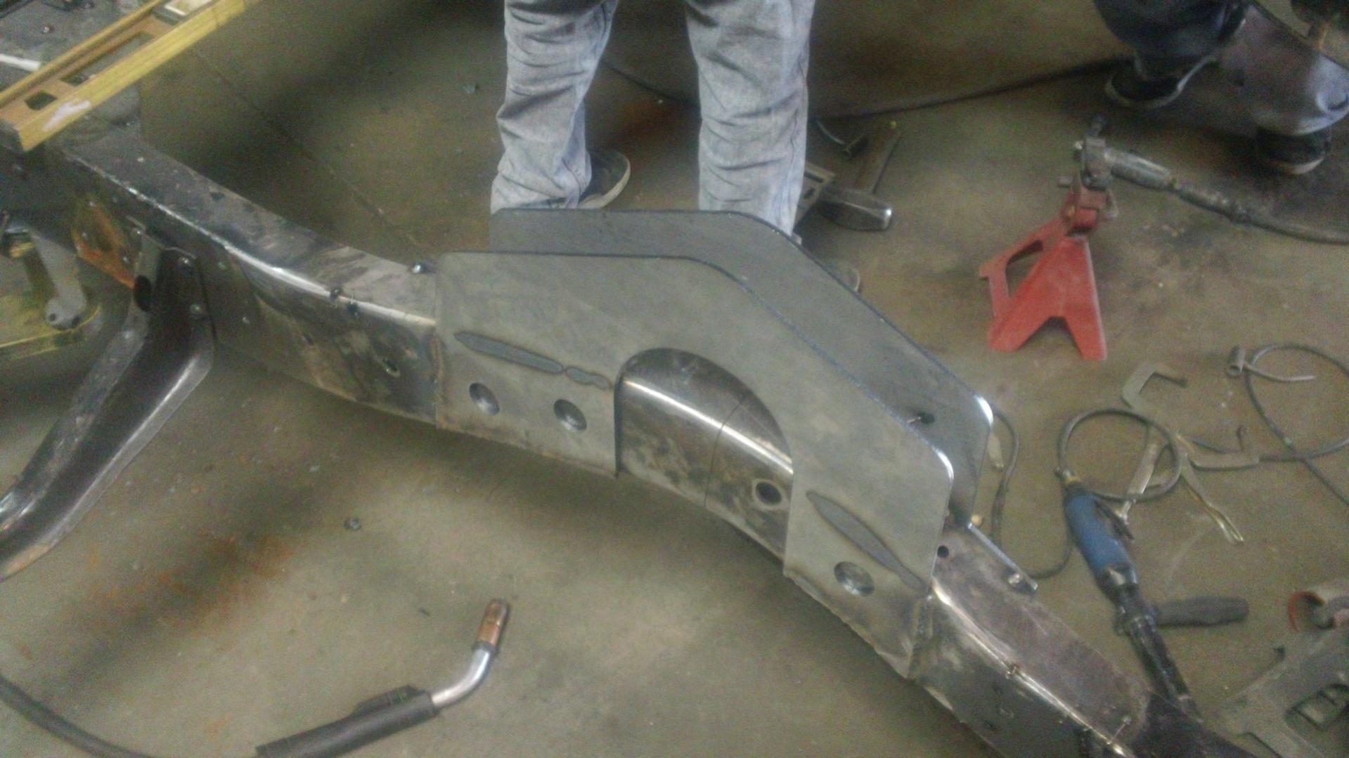

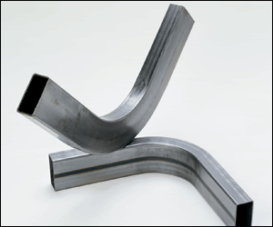

  5. Welders Series makes weld together frame curves in various sizes you may be able to get to work to make a smooth curve. They are an alliance member.

    I am looking for more of an arched frame look like 117Harv did. Im going to check out welders series. thanks so far

    Sounds like you want a "full" notch, and not a c-notch. C-notch usually describes a relief in the stuck frame rail, which is why people are recommending round pipe. If you want to cut all the way through the frame, Welders Series bend chunks would work great, and they have easy and hard way bends to choose from. Or, grab a sheet of 3/16" plate and cut whatever profile you want.
