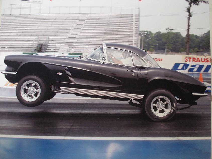

    C1 Corvettes are so cool but when they do this, the are even cooler! Lets see or hear about your successful performance upgrades on these cars
    Thanks to Jim (Vetrod62) for an awesome photo

  4. vetrod62
    Joined: Jan 2, 2010
    Posts: 347
    vetrod62
    Great ideas, Are we starting a trend to take restored C1 vettes back to where the all began, racing?
    I think you two should combine threads
    . Jim
    These are not drag cars, but rather street cars now that see the track once in a while.
    loudbang and 31hotrodguy like this.

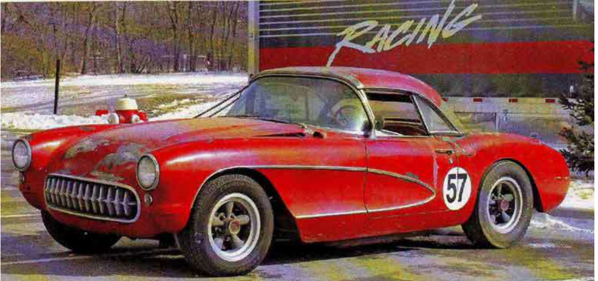

  17. FritzJr
    Joined: Feb 11, 2007
    Posts: 864
    FritzJr
    Here is a picture of the #57 car with hardtop (before restoration):
    31hotrodguy and loudbang like this.

  19. Dave Gray
    Joined: Sep 4, 2010
    Posts: 310
    Dave Gray
    Thanks for posting that picture of the # 57 airbox car. I had not seen this photo before.
    Dave
