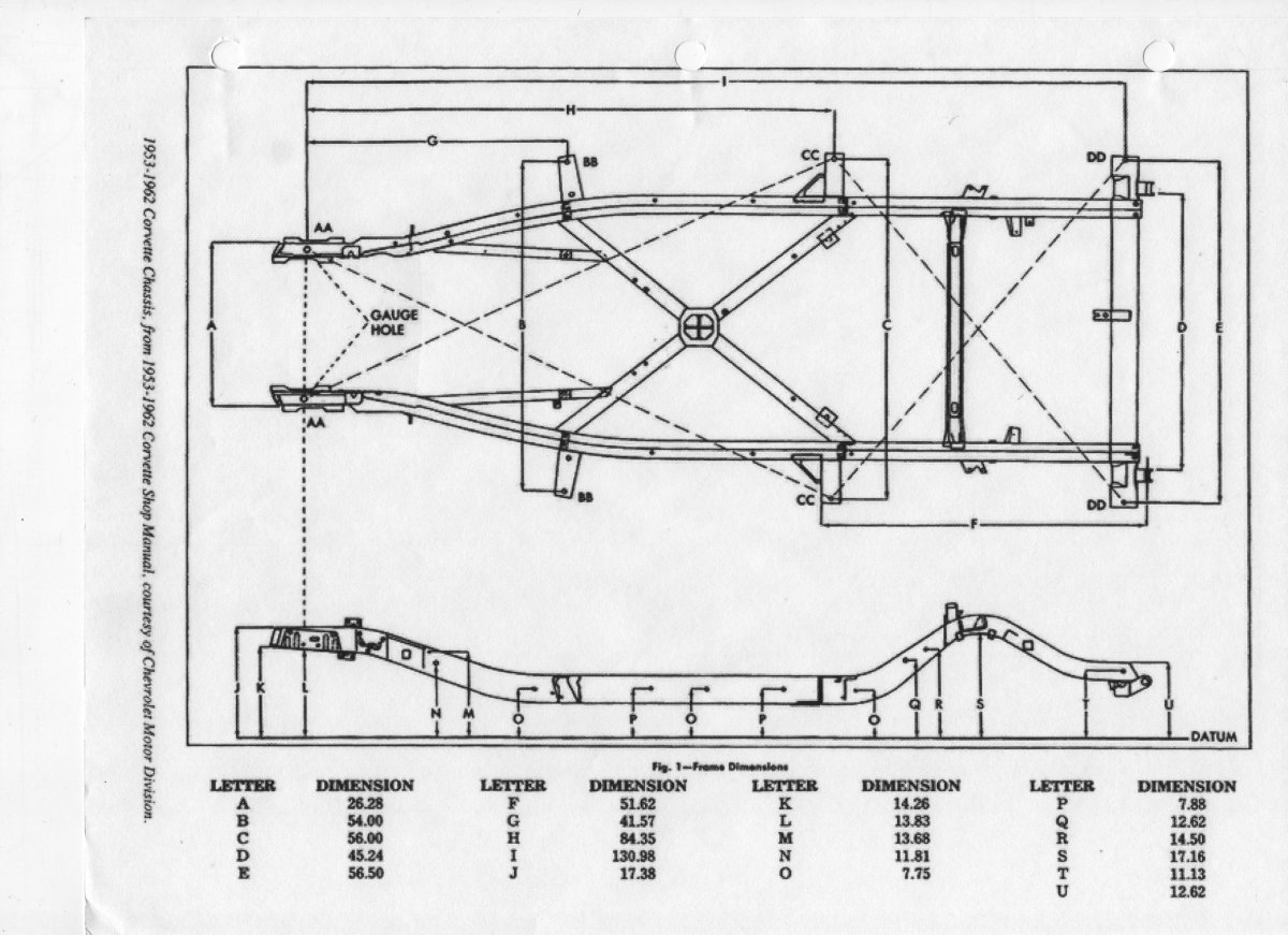

    Movin on- maybe this will help.

    Jim: Thanks with that I can calculate the AA to CC measurements and get close to what I need.
    Movin/on
  3. movin/on
    Joined: Jan 18, 2007
    Posts: 1,110
    movin/on
    Jim Looking at it again: measurement O is 7.75" from the datum line.
    Any idea how this measurement relates to the CL of the front and rear axle center heights?
    Movin/on
  4. jimdillon
    Joined: Dec 6, 2005
    Posts: 3,322
    jimdillon
    No I am not sure of the relation and my cars are anything but stock in height. I see O as the centerline of the frame longitudinally in the center portion of the frame, when it is sitting level. If I had one stock I could take the 7.75 and set that measurement and then find the front and rear axle heights but anything I could do with mine may be a bit cloudy. I used this schematic when I repaired a frame that was out of whack and it came out well but never played with components in relation to the frame, other than when I mounted the body it worked out well. If I can take a measurement with what I have let me know. I have a frame with a Dana 60, a Ford 9 and a stock housing. All of the fronts ***emblies have been changed from stock height.
  5. GearheadsQCE
    Joined: Mar 23, 2011
    Posts: 3,669
    GearheadsQCE
    Alliance Vendor
    Aren't the axle centerlines just a function of tire diameter?
    For example:
    6.70 x 15
    6.7 X 2 = 13.4
    13.4 + 15 = 28.4
    28.4 / 2 = 14.2
    There has to be some allowance for tire 'squish' but that should get you close.
