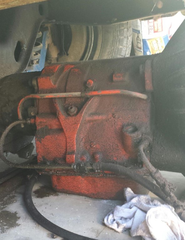

    Option 2 - C4 from a truck with a 351W motor. Buyer has sent me pictures of it, but I see 2 possible issues with it.
    A) - Is it even a C4? Every C4 I've ever seen has the 2 round servo covers on both sides. This one does not have them.

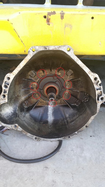

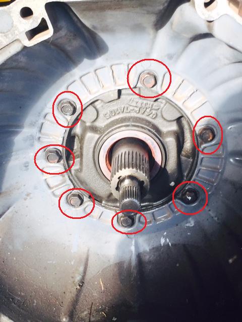

    B) is the bolt pattern on the pump even the same? I took a picture of a C4 that I bought (pan filled instead of case fill -long story but it won't work) and the patterns look different. The casting number on the case has it made in 1980. Anyone know if the bolt pattern changed then?

    That red colored monstrosity in not a C4. You need a case-fill C4. The 5 bolt bell will not work on a pan-fill case. It's possible your 260 Fordomatic flex plate will work with a C4 converter, but I am not sure. The flex plate need's to be 157 tooth and 28 oz. imbalance. A 289 torque converter should be just fine with your 260. It just has to be correct for the case-fill transmission that you will be using.

  3. That red-cased box is a FMX; dead giveaway is the iron case. Ford very rarely (if ever) used the C4 behind anything larger than a 302 (I've never seen a stock install), you always found a FMX behind the 'intermediate' motors unless it was a truck, then you got the C6.

    The first trans is an FMX. The pan fill C4 will work. Unbolt the bellhousing from it. Then you can remove the pump bolts and bolt the 5 bolt bellhousing on. It looks a little strange but if it will fit in the trans tunnel it will work. Make sure you get the proper torque to fit the flexplate, starter and imput shaft.

    I didn't think it looked like a C4. Thanks for confirming it.
    As for my pan fill C4, there is a pretty good gap between the case and 5 bolt bell where the case flares up and the bell doesn't. It does look goofy, and I had another guy tell me it would work, but it just didn't look right. By the time I knock the bell far enough back to seat the bolts into the pump, I'm concerned the torque converter will stick too far out past the bell edges and not have enough clearance for the flex plate. That's with putting the converter that came with the tranny on it. It's from a 302. Do I need a different converter for a 260?

    Just use a converter for a 289. Possibly it may be the same coverter as the 250 cube six cylinder model. You can find out what is called for through a trans parts supplier.
    As for the 6 cylinder C4, it depends if it is case fill or pan fill style. If case-fill, I'd use it. There might be a difference internally, i.e. fewer clutches in the clutch pack, or some such, but since it was for a 250, it may be the same specs as the V8 model. If it's case fill, that/ what I would go with. If you have it overhauled, now or later, any internal difference between a 6 and 8 can be dealt with at that time.
    Whether or not the case fill and pan fill trans are both compatible with your 5 bolt bell is, in my mind, very questionable. But even if it is doable, I would not be satisfied with the case mismatch....it looks like a hell, in my opinion.

    Just like has been said the red transmission is an FMX, it is a cast iron case, and not desirable at all. It is very heavy due to the cast case. Some of the internals were reworked and found their way into the AOD transmission
