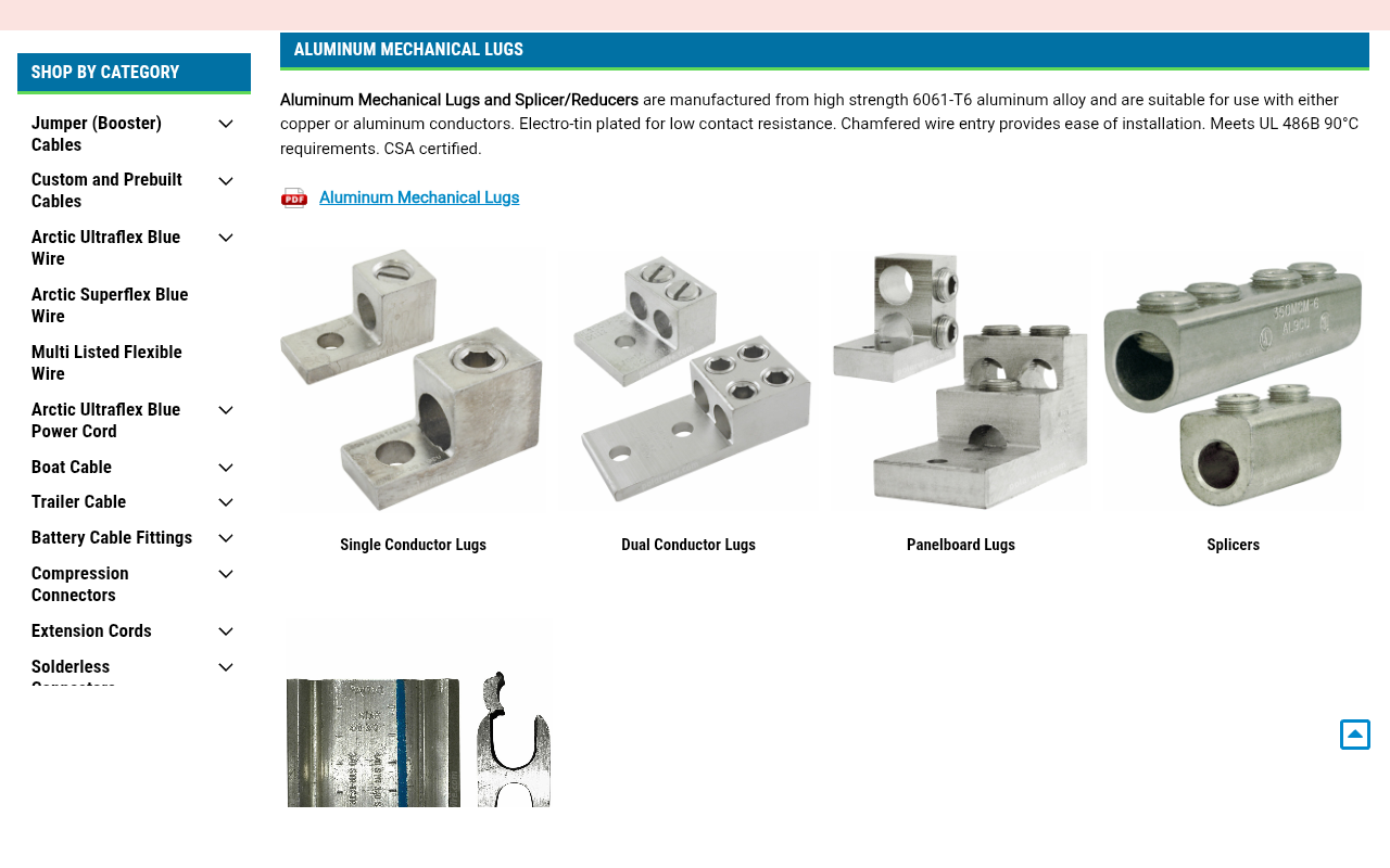

  17. And I'll throw this out here for your consideration... Aluminum building wire. Lighter, cheaper and easier 'worked' compared to copper building wire. One downside is to get the same amperage rating you need a bigger wire. For example, to duplicate 4/0 copper wire you'll need to jump up to 350 mcm cable. Weight is only .4 lbs per foot, 4/0 copper is .75. Price, the aluminum is $4.30 per foot, considerably less than welding cable. Yes, it will still be harder to work compared to welding cable as it doesn't bend as sharply but not horribly so and it will need to be properly secured with insulated clamps. You'll also need crimp-on terminal lugs (don't even think about screw lugs) and take care not to nick the strands when stripping. Seal the terminal with industrial shrink tube. But it is doable, I've done this way in the past.
    Sharpone and alanp561 like this.

    Screenshot_20250607-162256.png I believe these are the " screw lugs" you're referring to ? These are listed as being appropriate for both aluminum & copper wire ...
  19. ... but they don't like vibration...
    lostone and Sharpone like this.
  20. 2OLD2FAST
    Joined: Feb 3, 2010
    Posts: 6,067
    2OLD2FAST
    from illinois
    That applies to most mechanical fasteners ..

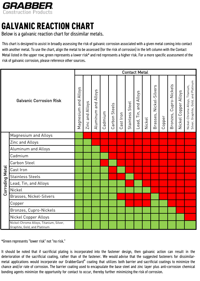

    You might get away with copper and aluminum in a controlled environment, but out in the open, you're going to get a galvanic reaction. Copper corrodes aluminum. The following chart tells you which metals play nice and which don't.
    lothiandon1940 likes this.

    Look at the chart above that @alanp561 posted ! Nickel chrome likes everybody!!
    alanp561 likes this.
