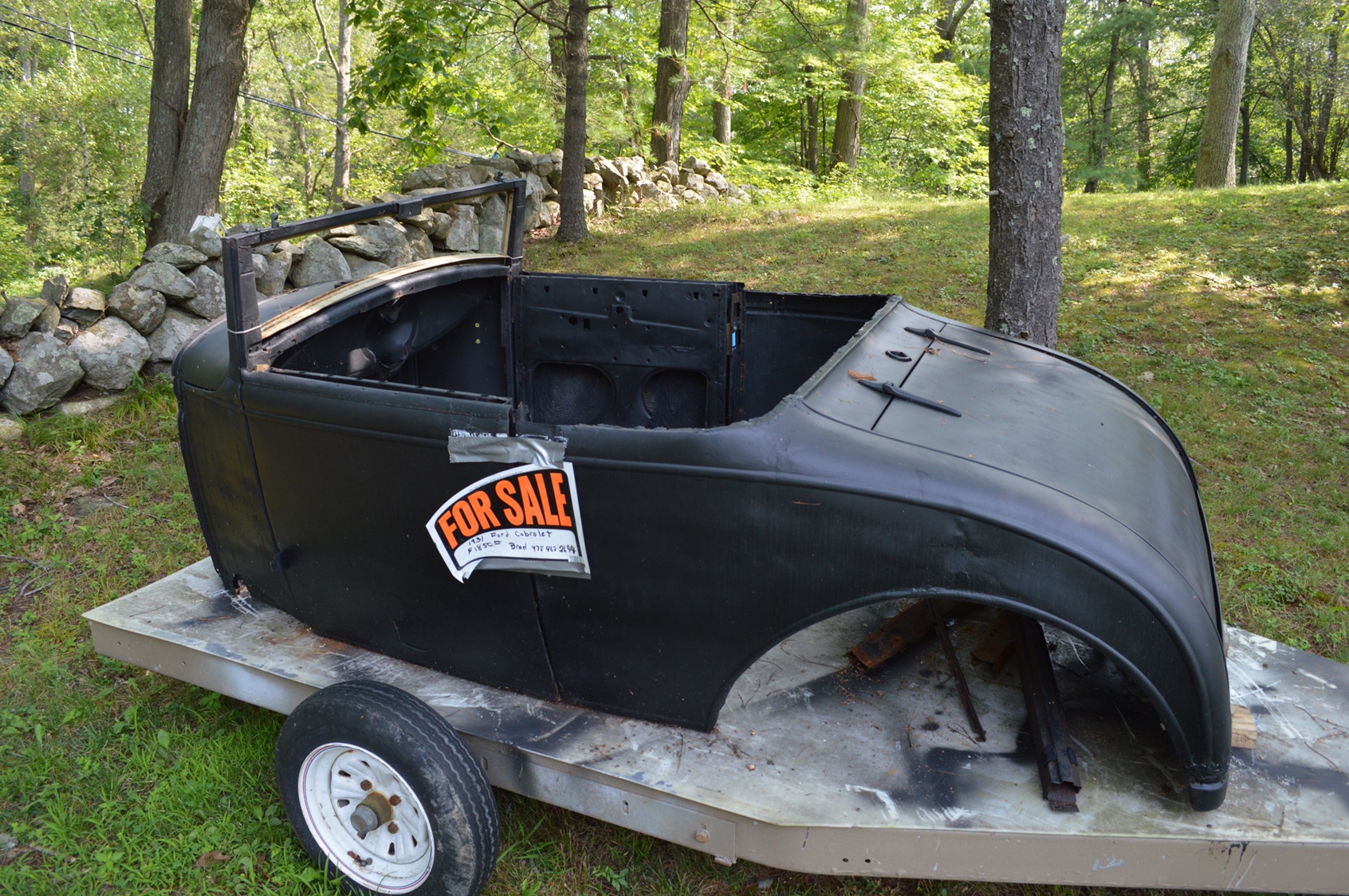

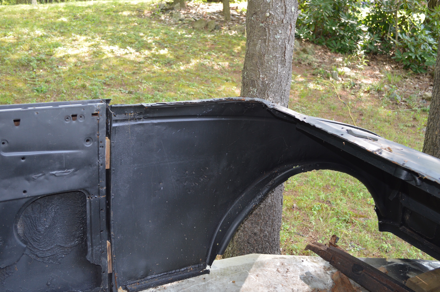

    This is the body sitting by the road at Brads house. [​IMG]

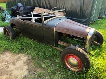

    Here it is at my house a few weeks afterwards. The Body sitting on an old hotrod A ch***is from the late 50’s early 60’s that I picked up in West Springfield M***.
    Summer 2019 (just to keep it off the ground)

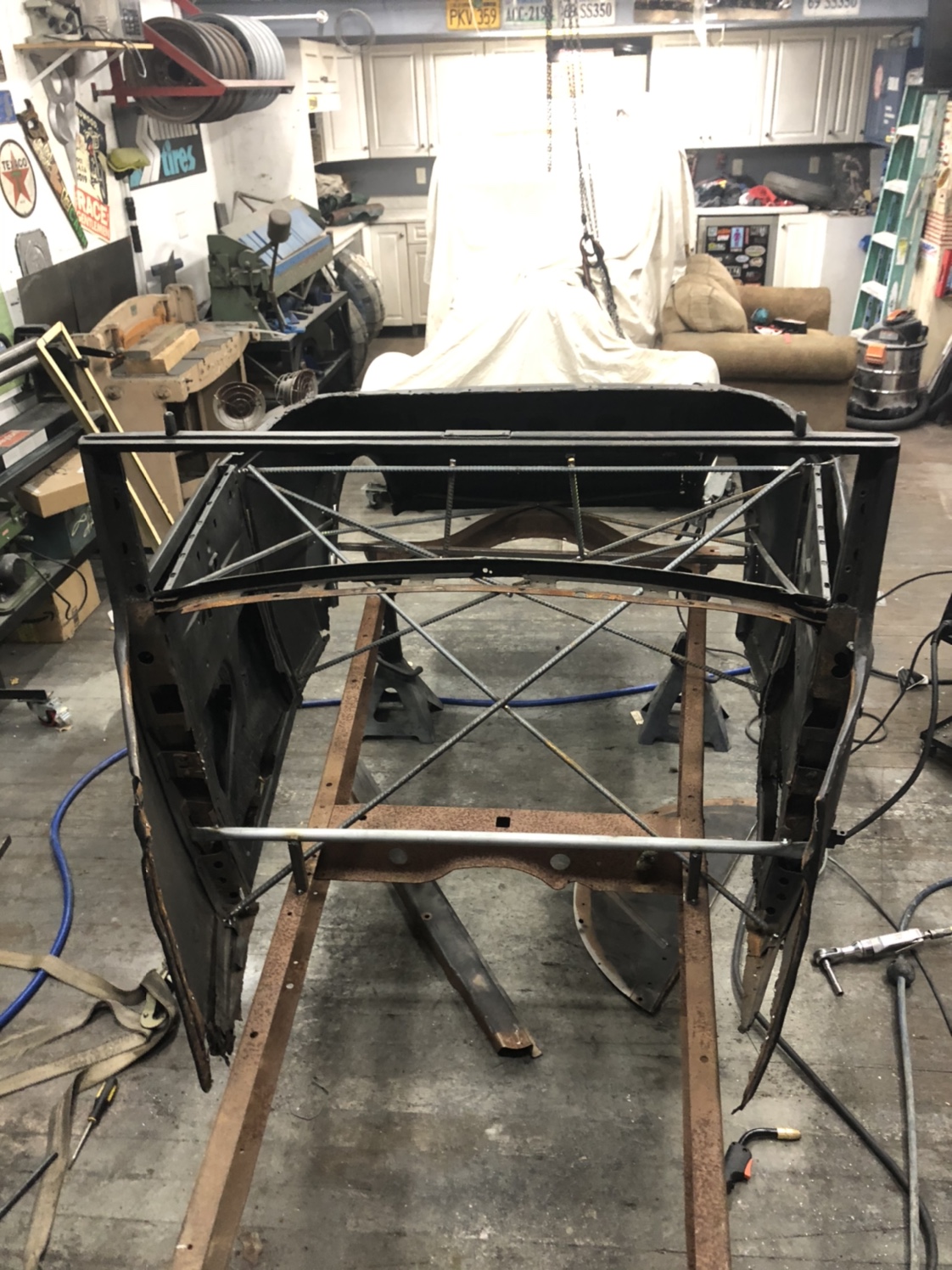

    I moved the body into my garage.

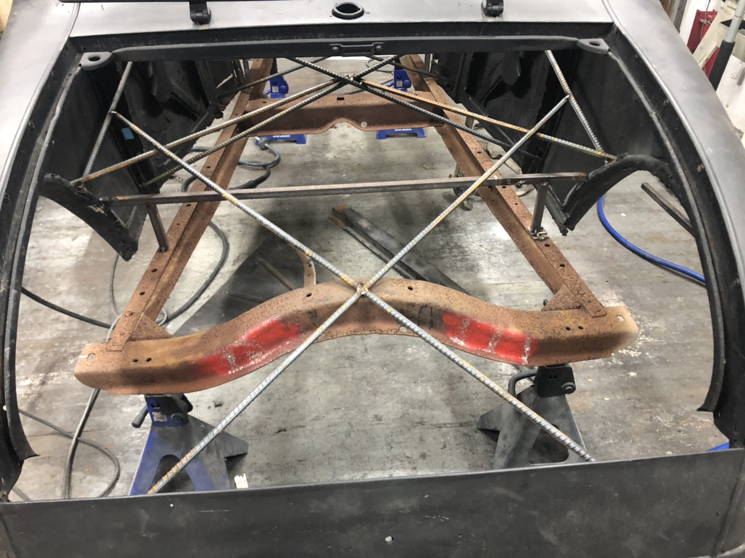

    Braced everything up real good. Welded the doors set with tabs making sure my gaps were good.
    Got the body sitting where I wanted it.
    I moved an extra A ch***is I got from Mike Bowling into the garage and set the body on w a 4” channel at the firewall and 3” channel at the center of the rear wheel well arch.
    Give it some extra rake
    I came up with this idea when I channeled my sedan two winters ago.
    It worked then and it worked now.
    https://www.jalopyjournal.com/mobile-gallery/e9ccb33182a8345b1f4b07ffb0b7035e.jpg[/
    IMG]
    [IMG]https://www.jalopyjournal.com/mobile-gallery/3fb359eb07eb23c4b8e97cc6cc15cdd0.jpg
    You can see the stanchions in some of the pics. It helps to have the chain fall and trolley.
    I couldn’t do it without it, that’s for sure.

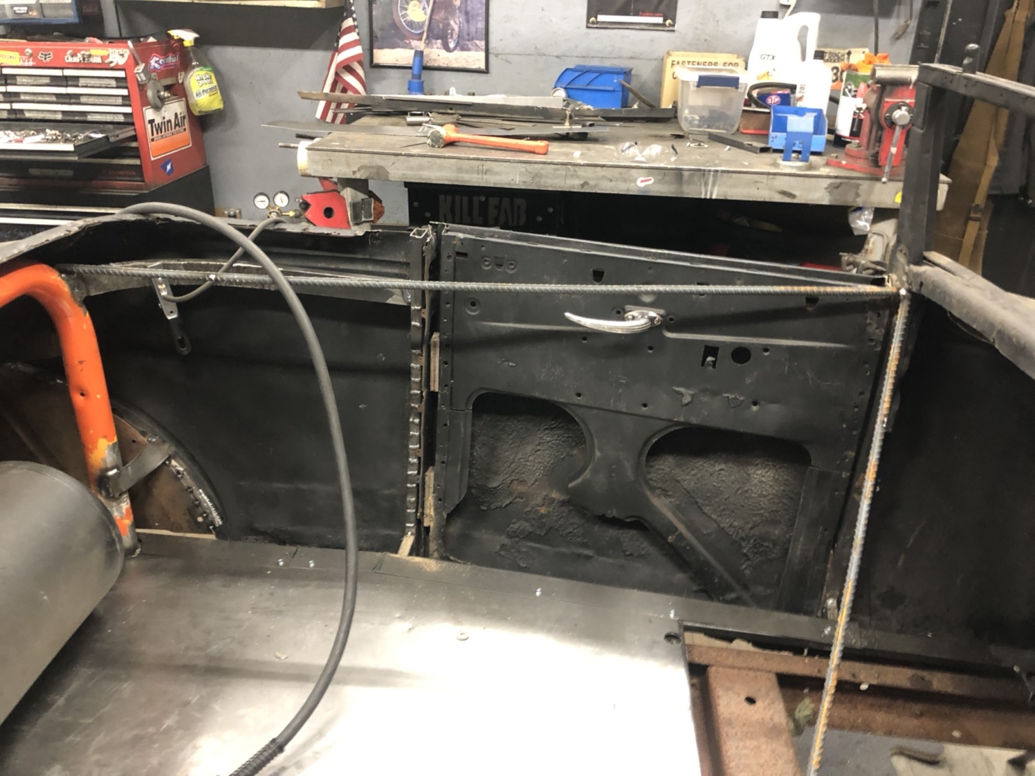

    Made sure everything is level and straight. I used a string form the front cross member to the rear of the body. Tacked the feet of the stanchions to the ch***is.
    Just so it wouldn’t move around.
    Added a pair of old frame horns to the bobbed frame.

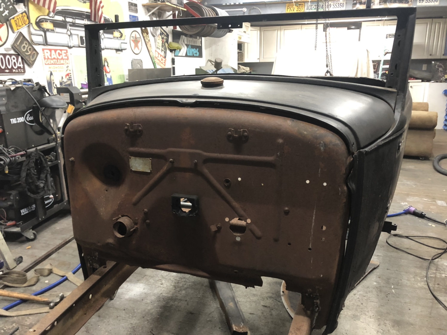

    In the last pic you can see the firewall is already removed.
    It was an old channeled hotrod from back when. Story has it is was pulled from the back of a cemetery in Fla and trailered north to NH. Then to brad, then to me. [emoji16][emoji1598]
    I removed the torch cut firewall because I have a few good donor firewalls and I wanted to get the body back to as untouched looking as possible.
    Even though I was going to channel it.

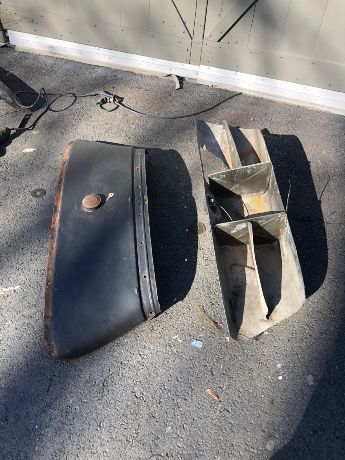

    So I removed the firewall and fuel tank.
    Put in a new 31 teardrop firewall and received the bottom of the tank.
    Day 1
    Hate to say it but this tank was beautiful. I had no idea ... I would have cut a different one if I had taken the time to look at it.
    But, that’s life and hotrods.

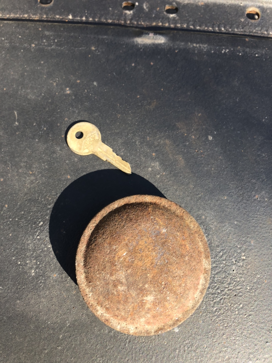

    I discovered a [emoji360] inside the tank when I opened it up.
    Much nicer now.

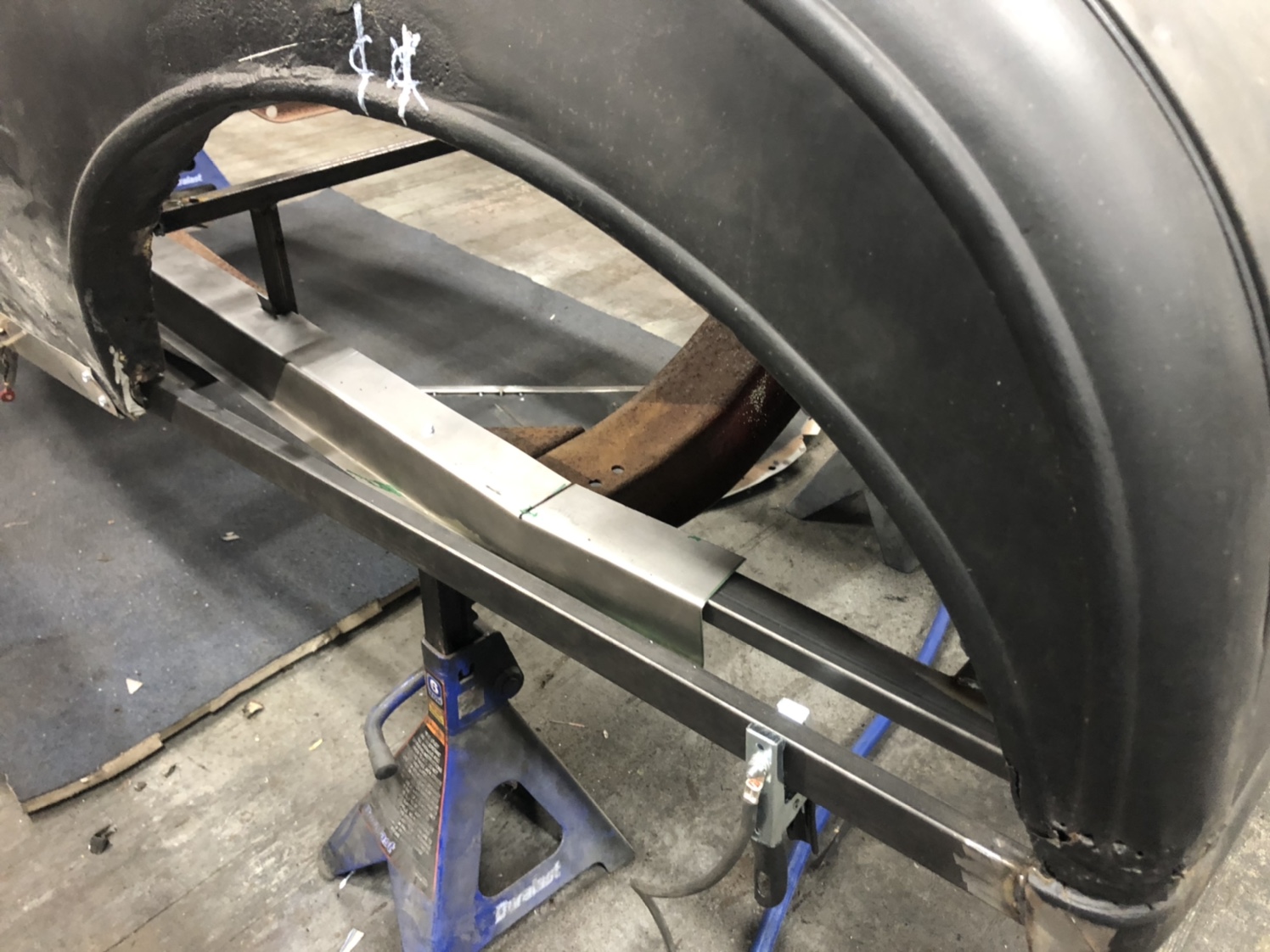

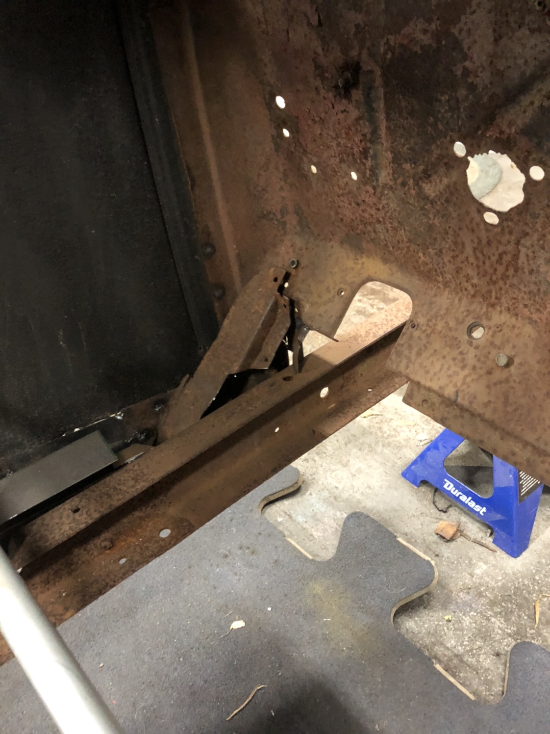

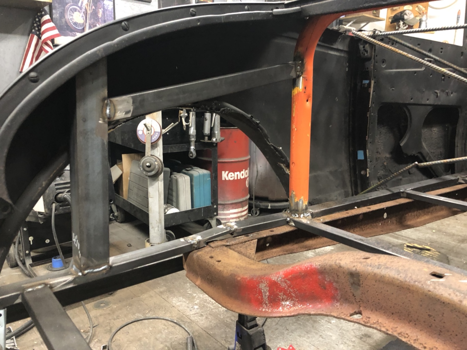

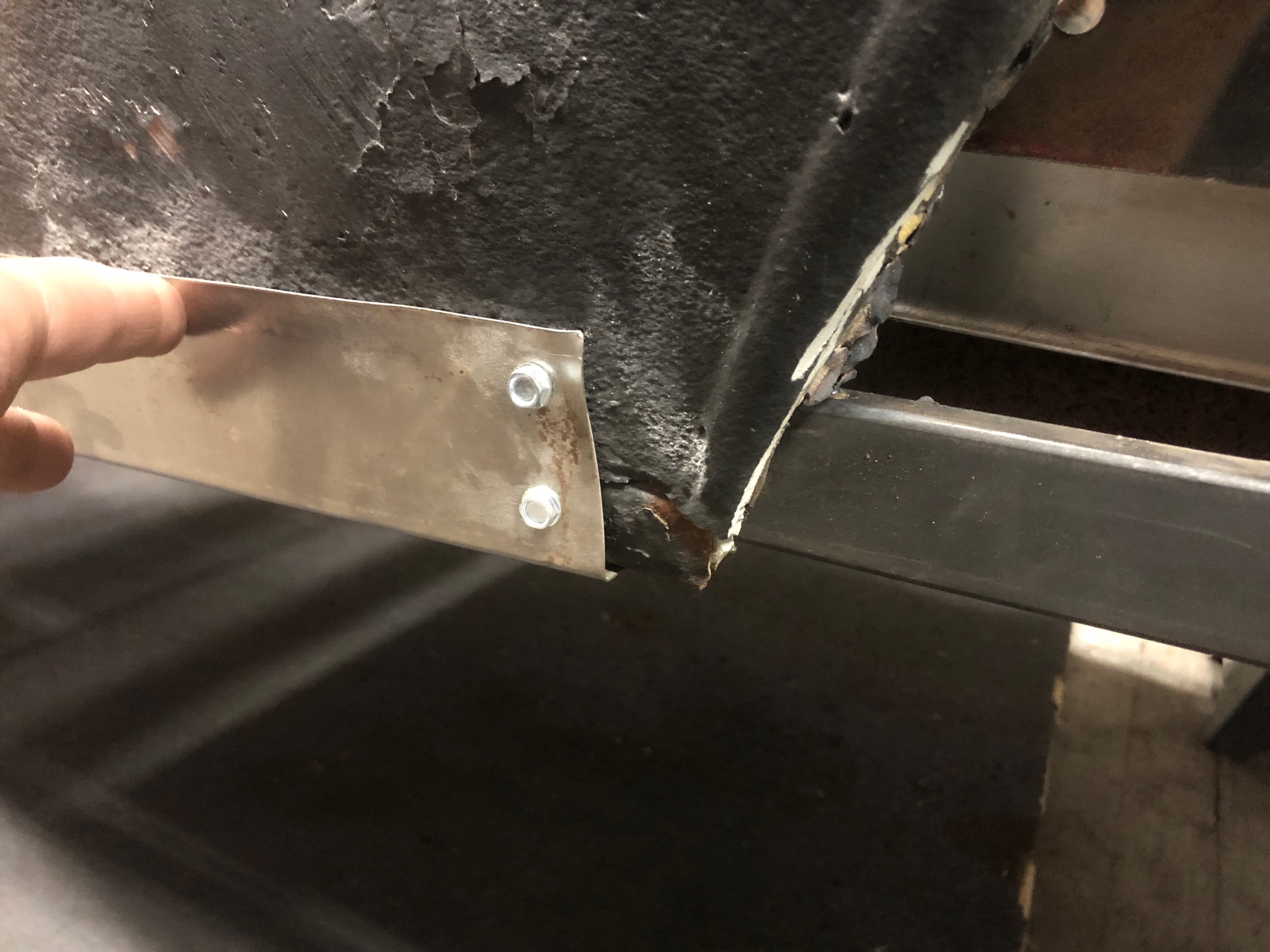

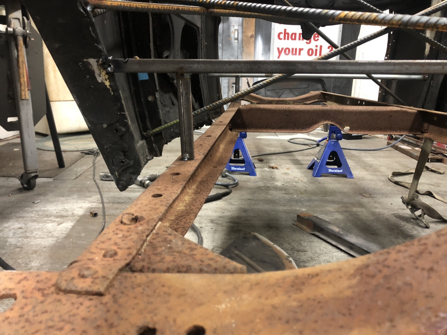

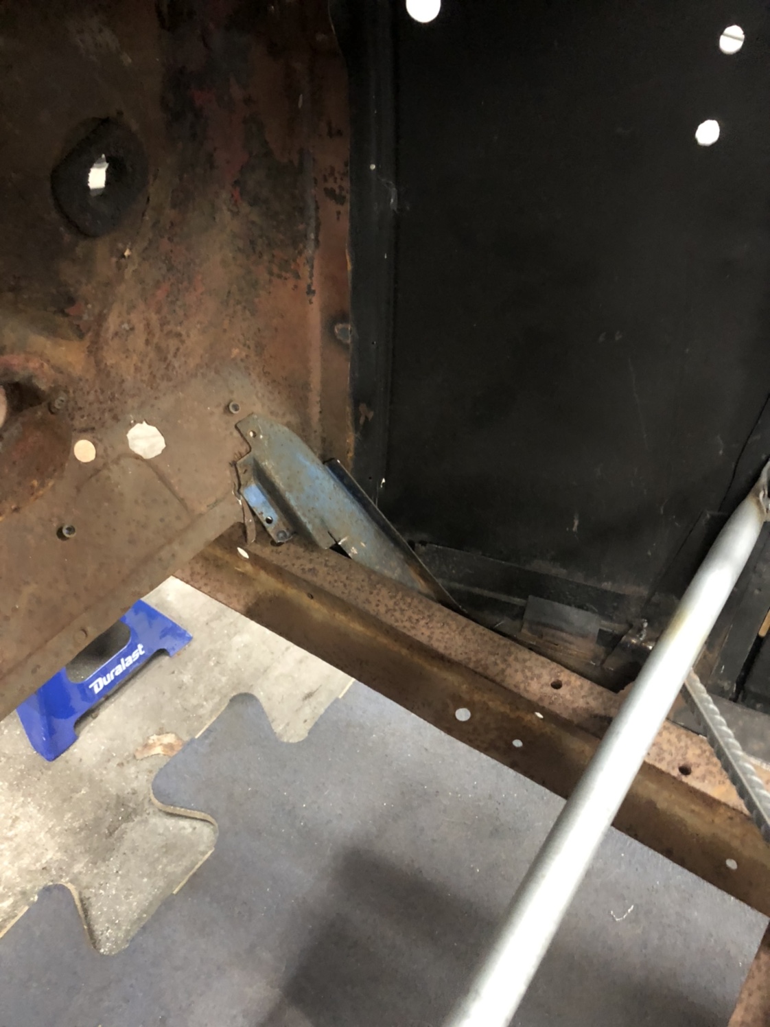

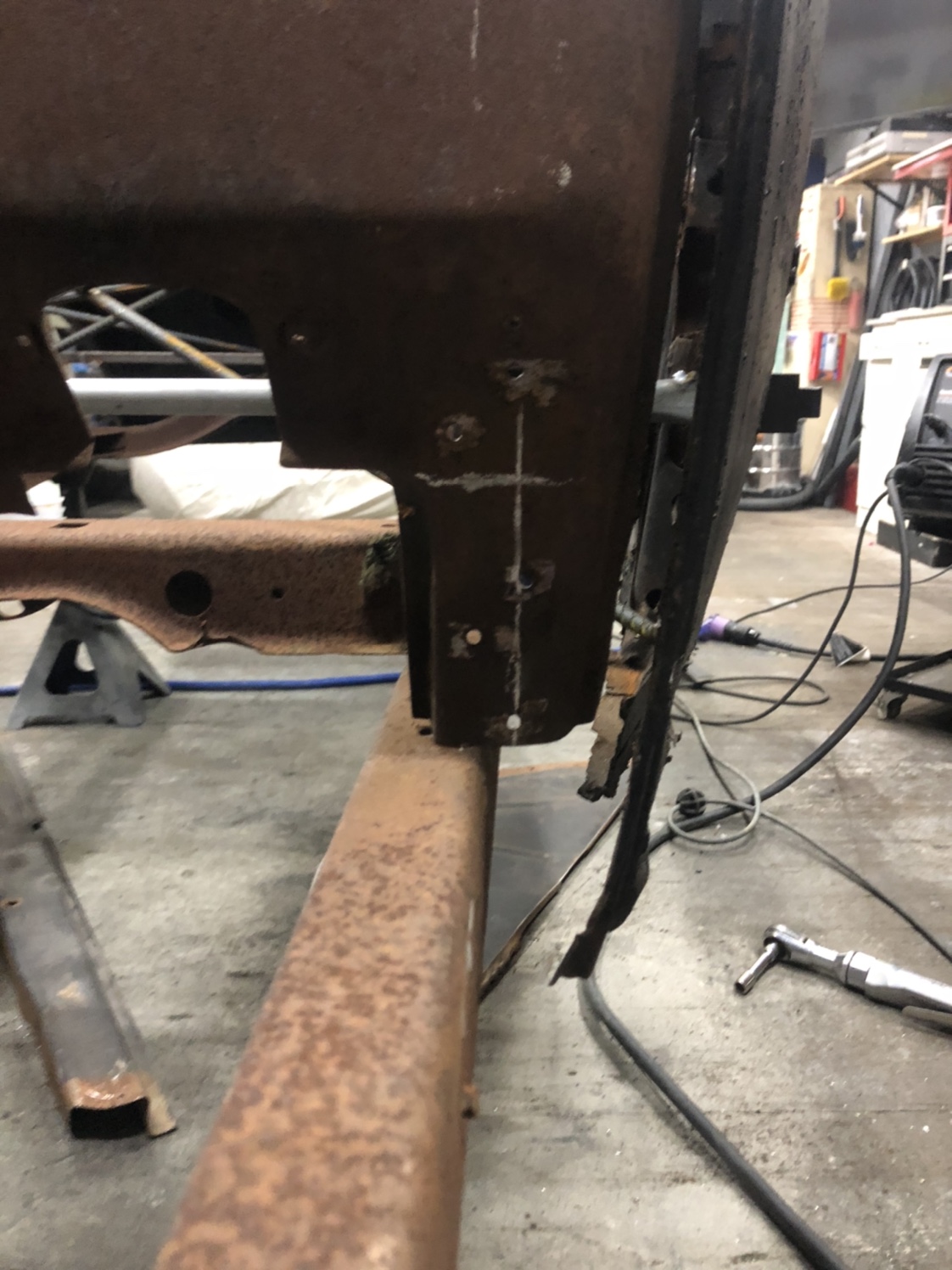

    I started by measuring the bottom of the body in the best places. Then measuring to the top of the frame and adding 3/4” because that was the thickness of the material I was using for my subrail.
    You can see the 3/4”x1.5” stock laying across the frame.
    The bent sheetmetal is a Z that goes from the top of the subrail down past the frame to the top of what I will use for my subrail/ inner rocker or door sill.
    (I guess you will call it). Technically it would be the position of the original subrail that the body would have been attached to.
    (Riveted at the body at the base of the A and B pillar.

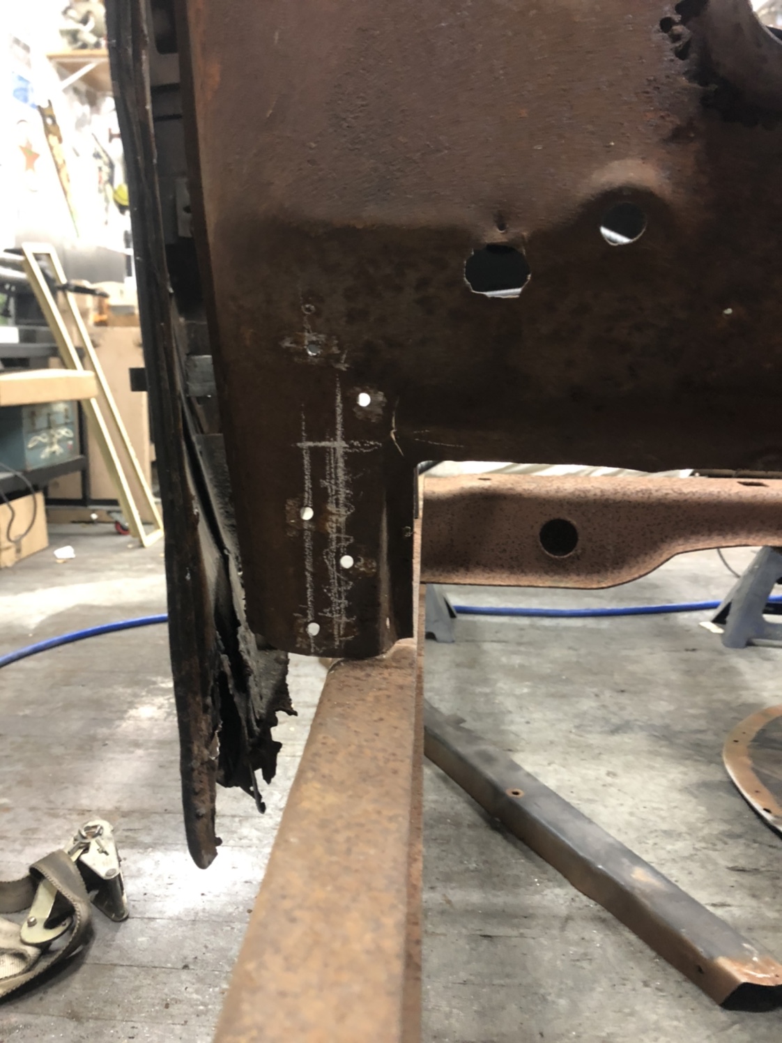

    In this pic (drivers wheel well) I’ve got the 1.5x3/4” stock from the orig rear subrail crossmember all the way to what would be the base of the b pillar.
    I did this on both sides. I used sheetmetal to hold the tube stock up so it would not protrude below the side of the body. As it would have been.
    I’ve also got the drivers side subrail from the cowl to the rear of the frame laid out at this point.
    Making my cuts as needed to follow the contours
    You can also see the Z shape of the sheetmetal.
    The drop of the body or lift of the floor. However you’re looking at it
    Day 3
    You can see at this point I’ve got the subrail across the rear of the car and have fabricated it down the p*** side. Enough to have started running perpendicular supports across the body.
    Few more shots do you can see how I’m going about it.
    My stanchions did end up being slightly in the way. I had to cut the tack welds and lift the weight off the body. Moved them slightly inward so that the tube stock would clear past them.

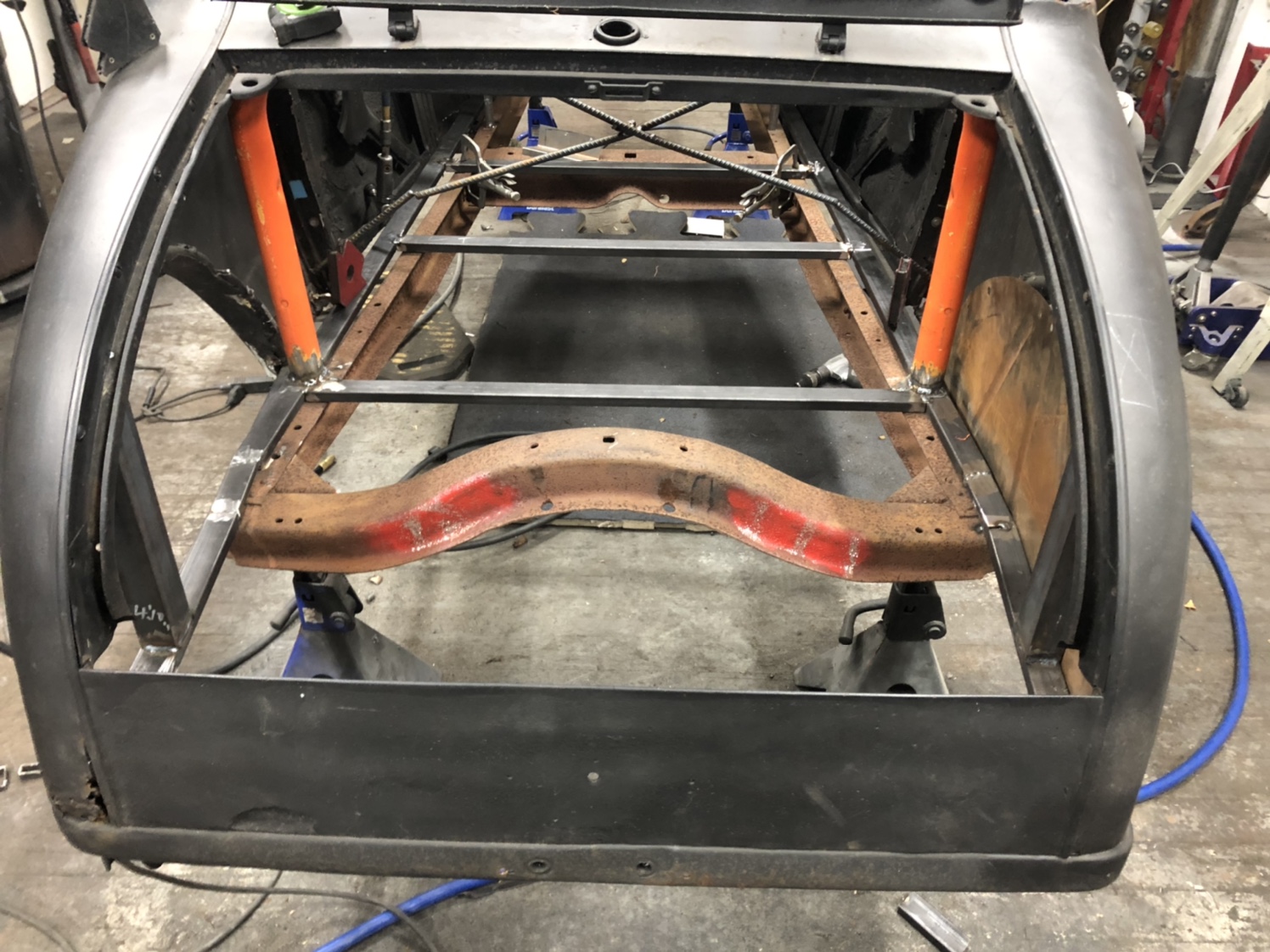

    I am building the body with parts I’ve acquired and ac***ulated over the past 4 years. Mostly the past year if I’m being honest about my swapmeet spending habits. ‍♂️.
    Long story short, they worked out after some measuring and cutting.
    If I didn’t say anything no one would ever know
    I added some quarter panel braces to the rear of the body.
    The old ones have been torched out.
    The remnants are still there.
    I used them as locators for the new ones.

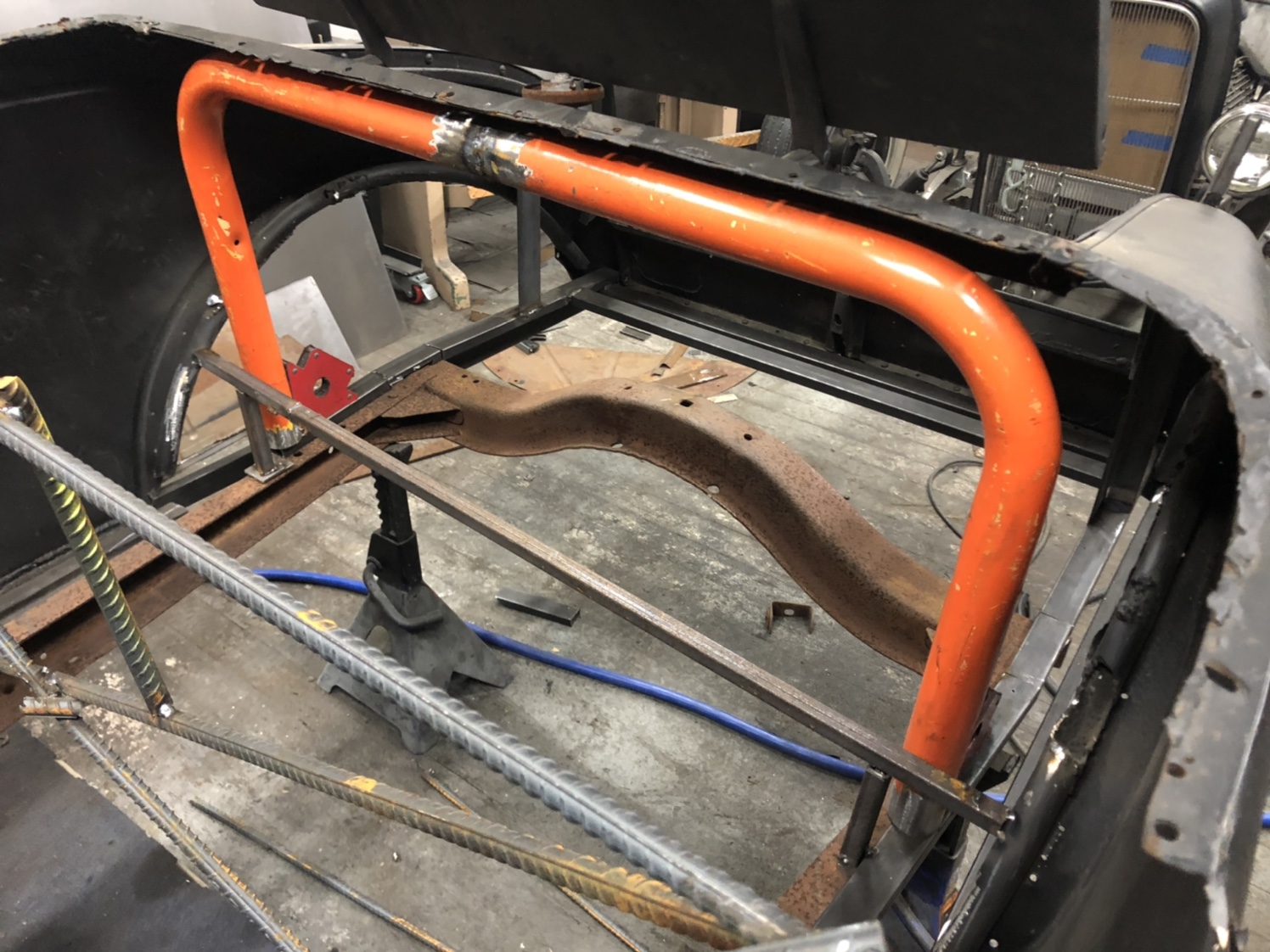

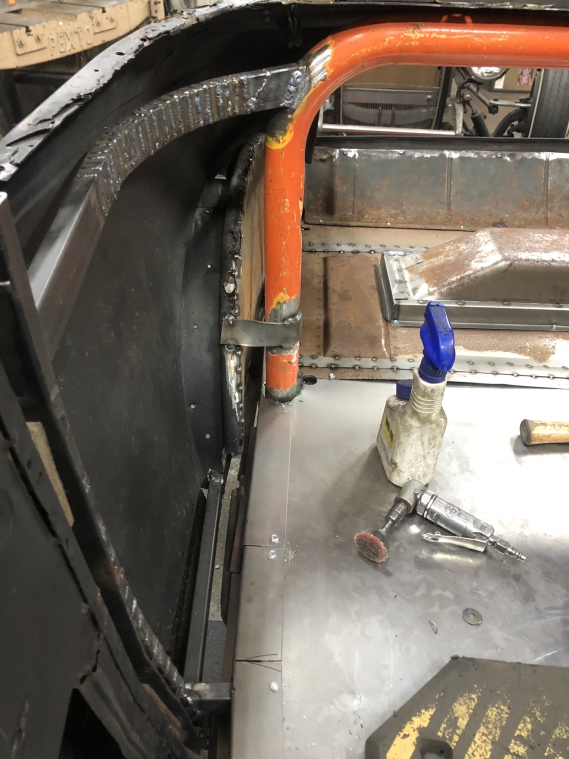

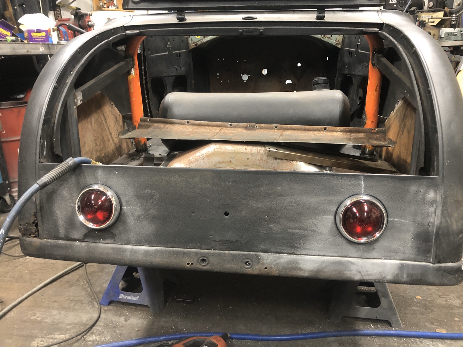

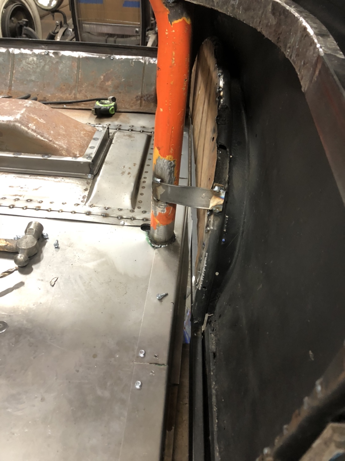

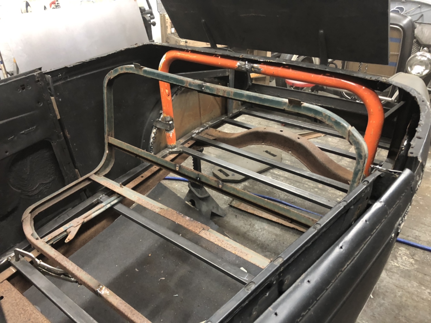

    I cut it down, sectioned it. Decided it would make for a great body hoop and something to start tying the body to as I went along.
    [​IMG][​IMG]
    In the last pic you can see At some point in the Cabrio’s lifetime someone had added round tubing at the rear wheel wells.
    They made for great material to add bracing from the body hoop to the quarters. To start getting the body in position for the floor.
    Tied in the rear support to the hoop.
    The rear of the car is really starting to stiffen up at this point.
    [​IMG][​IMG]

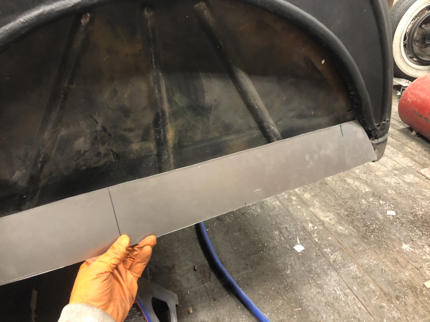

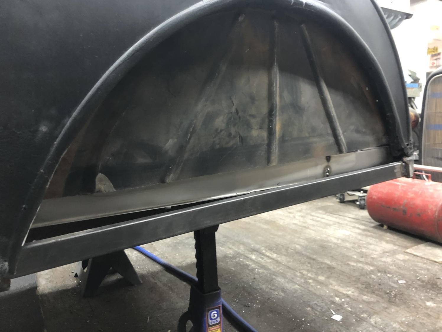

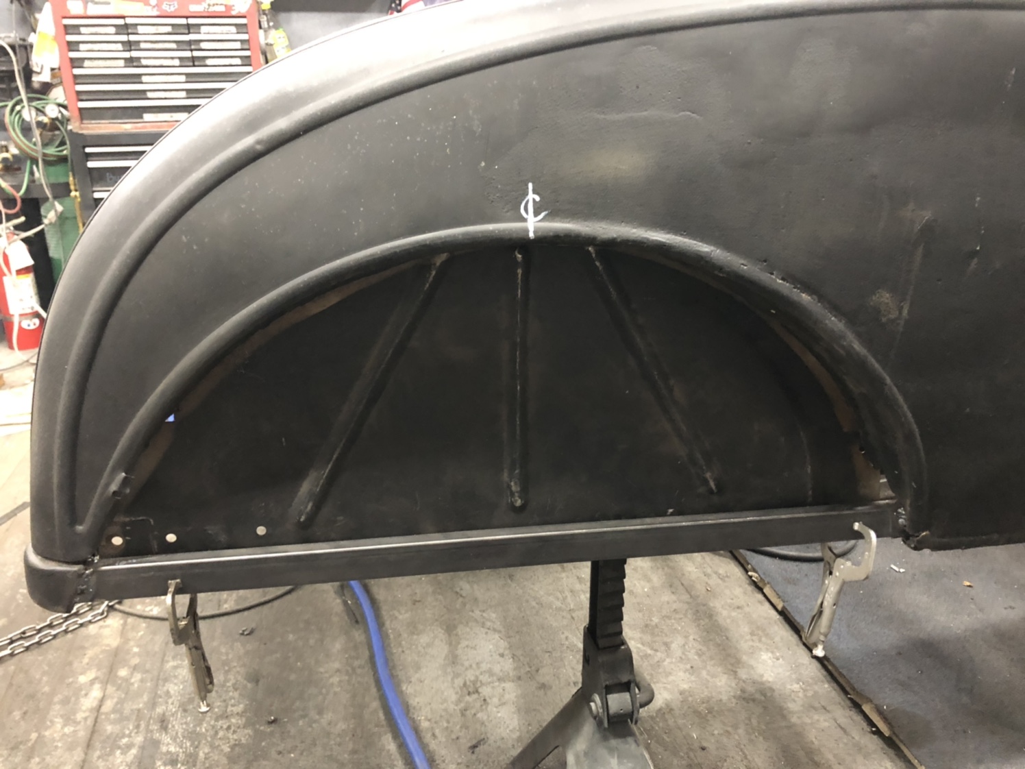

    Before the night was over I started fitting a set of inner wheel wells I got as part of a parts haul with the old 50’s hotrod ch***is from West Springfield m***.
    The p*** side was good to go.
    This drivers side has had the bottom 3” cut off of it.
    Guessing someone used it as a patch panel at one point in time.
    It’s okay... I’ll fix it.
    P*** side. Dry fit

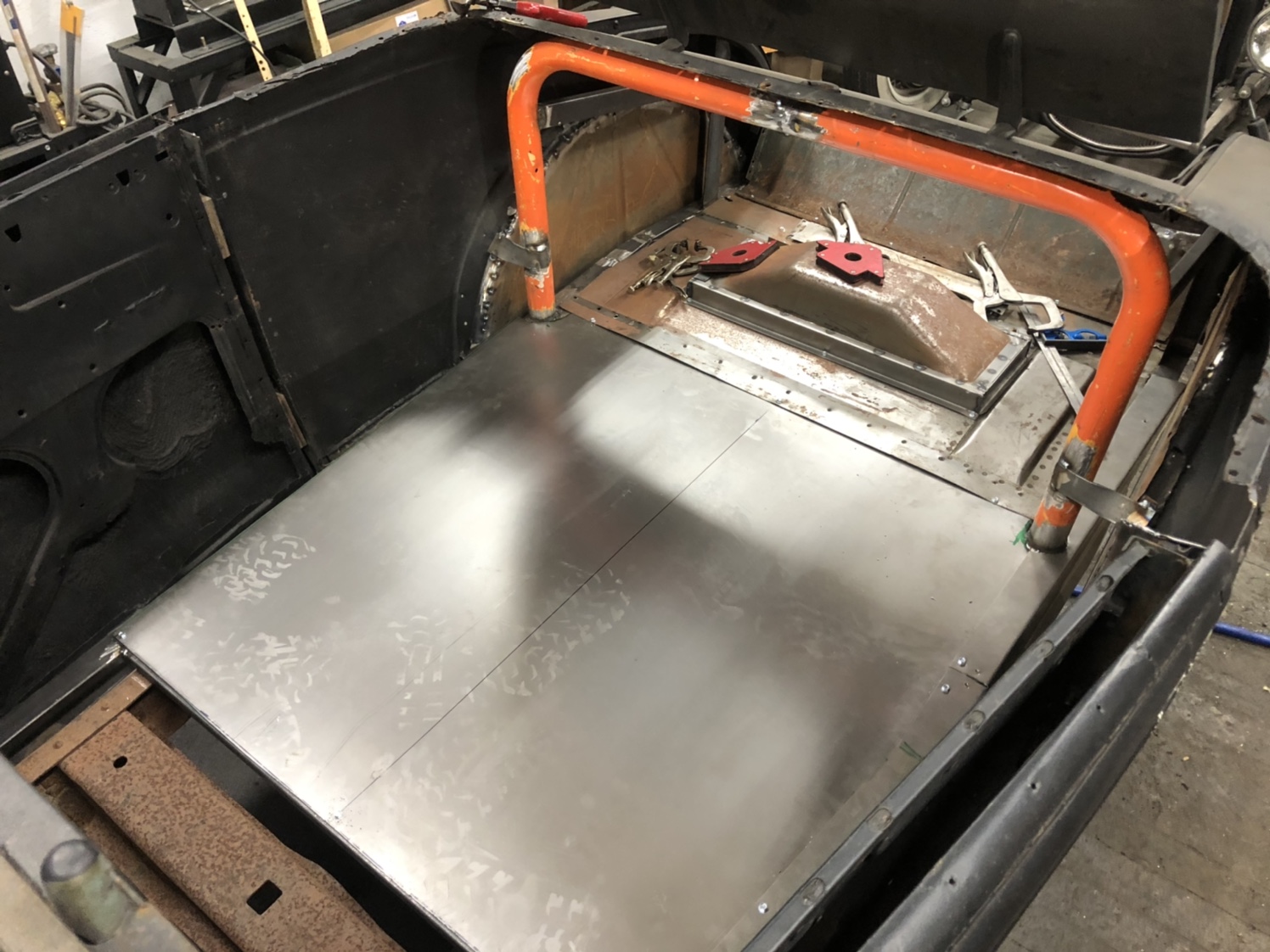

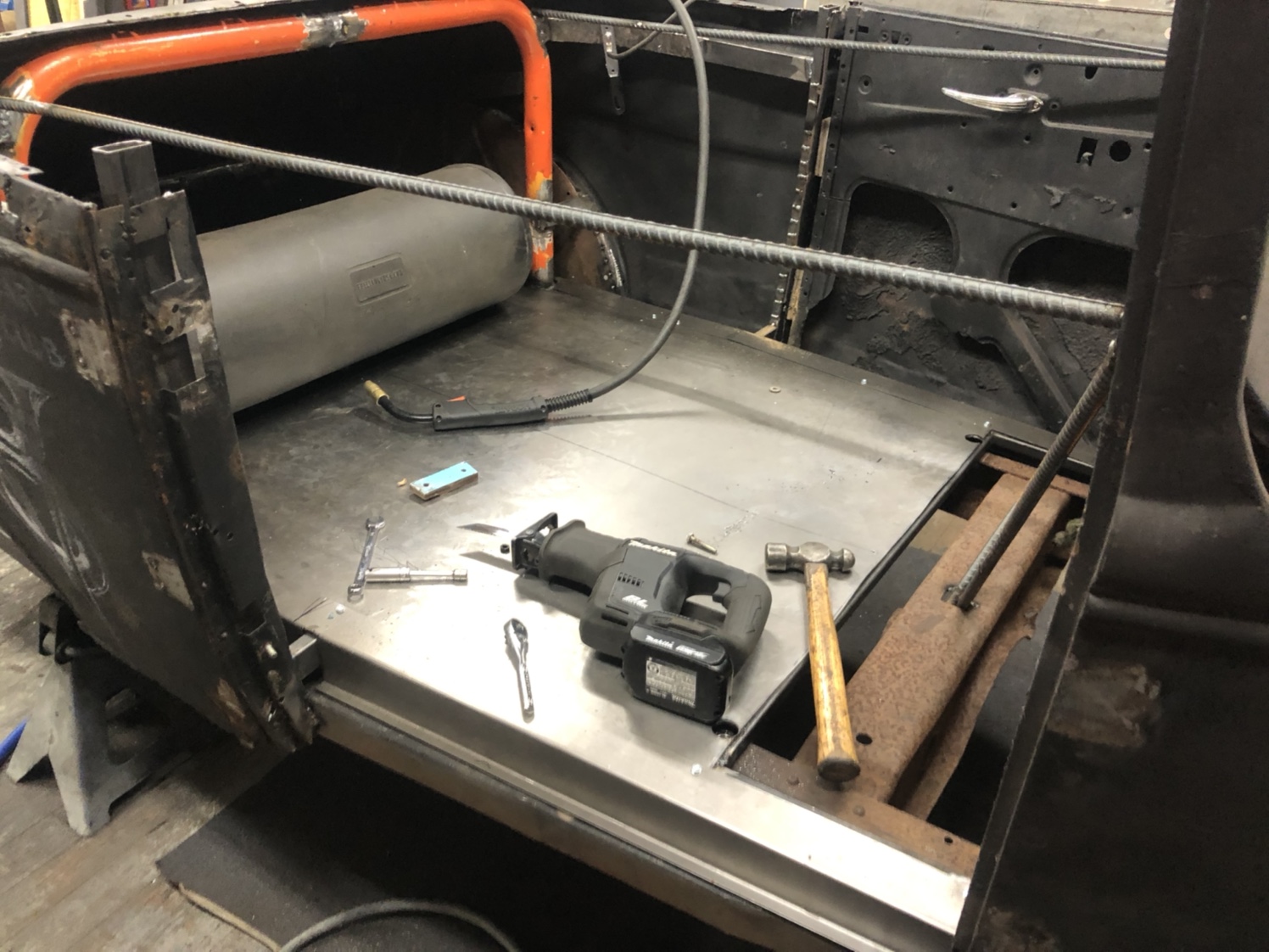

    Day 5 thanksgiving morning ... not cooking this year. Kids are sleeping ... I’m making good progress so I’m in the garage early.
    I worked until 12:00 then ate. My kids went to their moms and I went back to the garage. As everyone expected I would do.
    Over the summer I picked up another parts lot in New Bedford M***.
    An old timer working on a sedan, Never finished it and had p***ed.
    I purchased the remnants of his sedan project
    Lots of good pieces but I moved most of them along. Kept a few parts for moments like this.

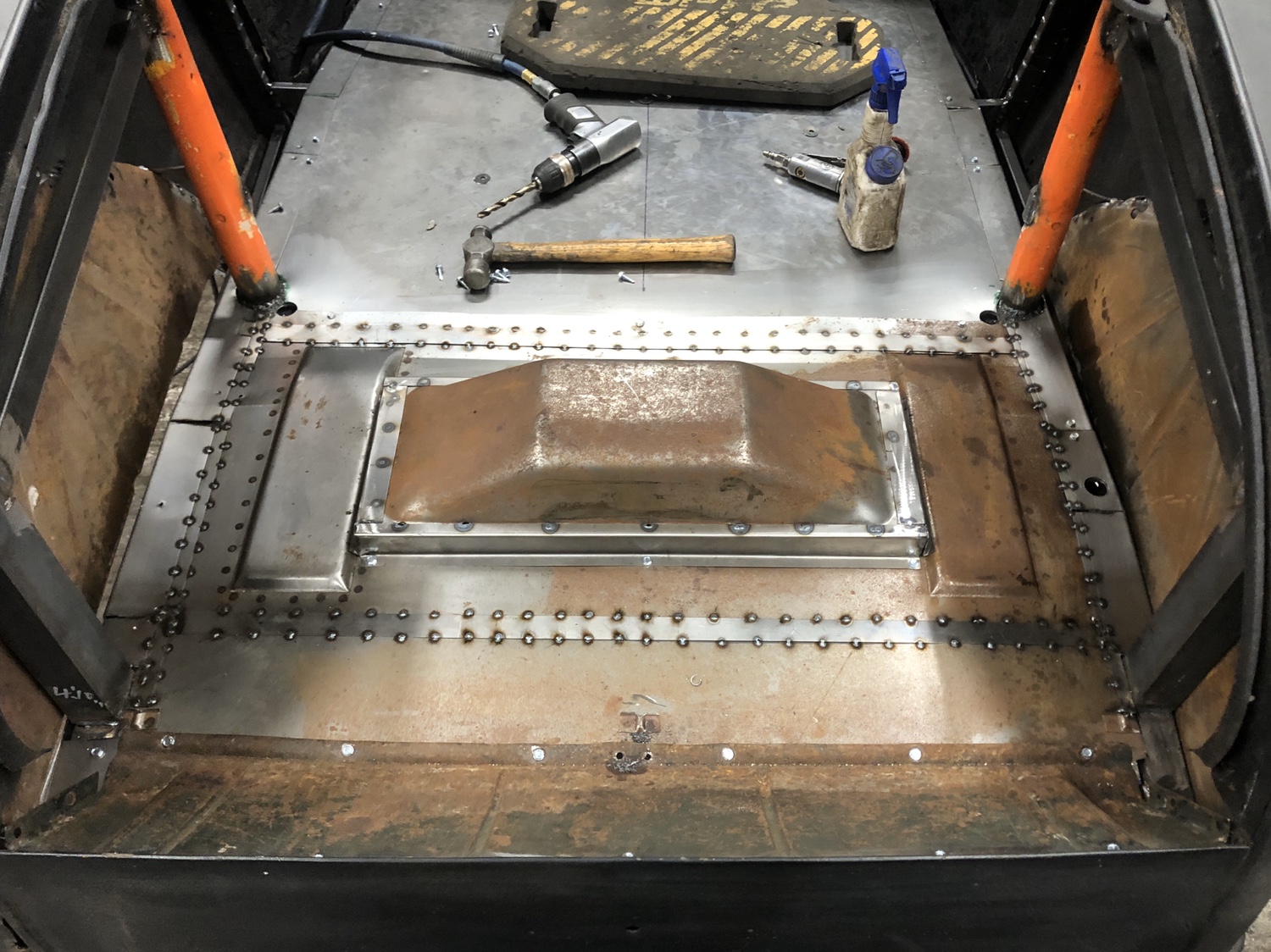

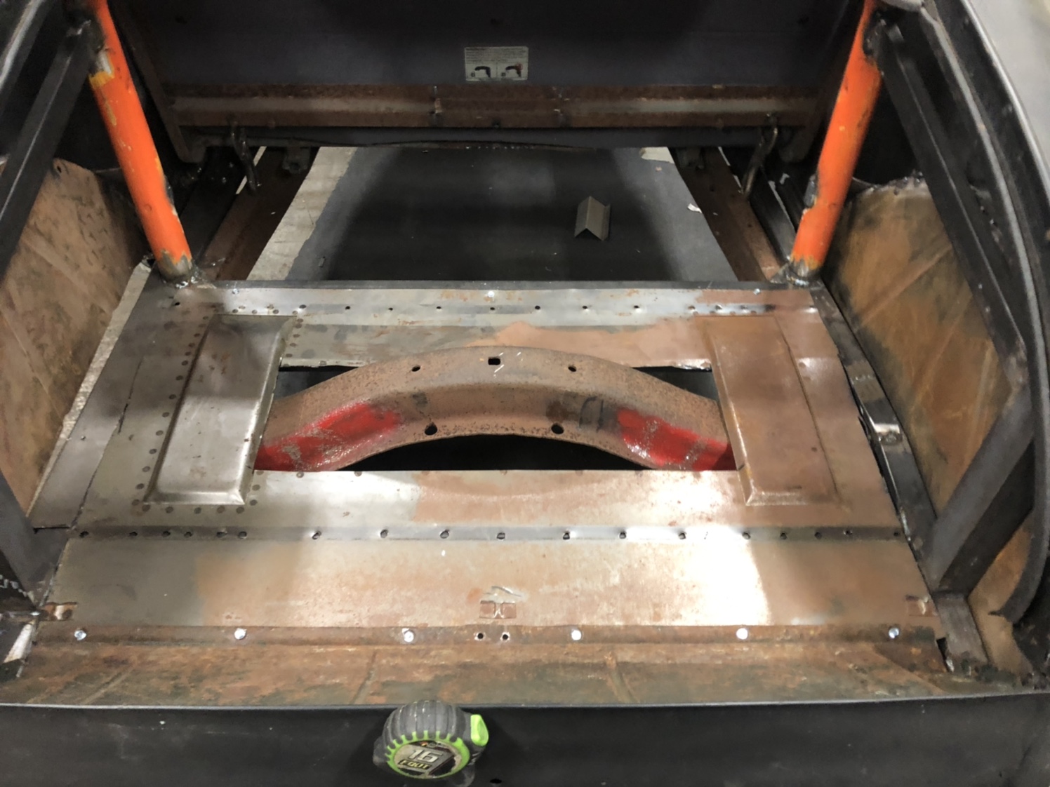

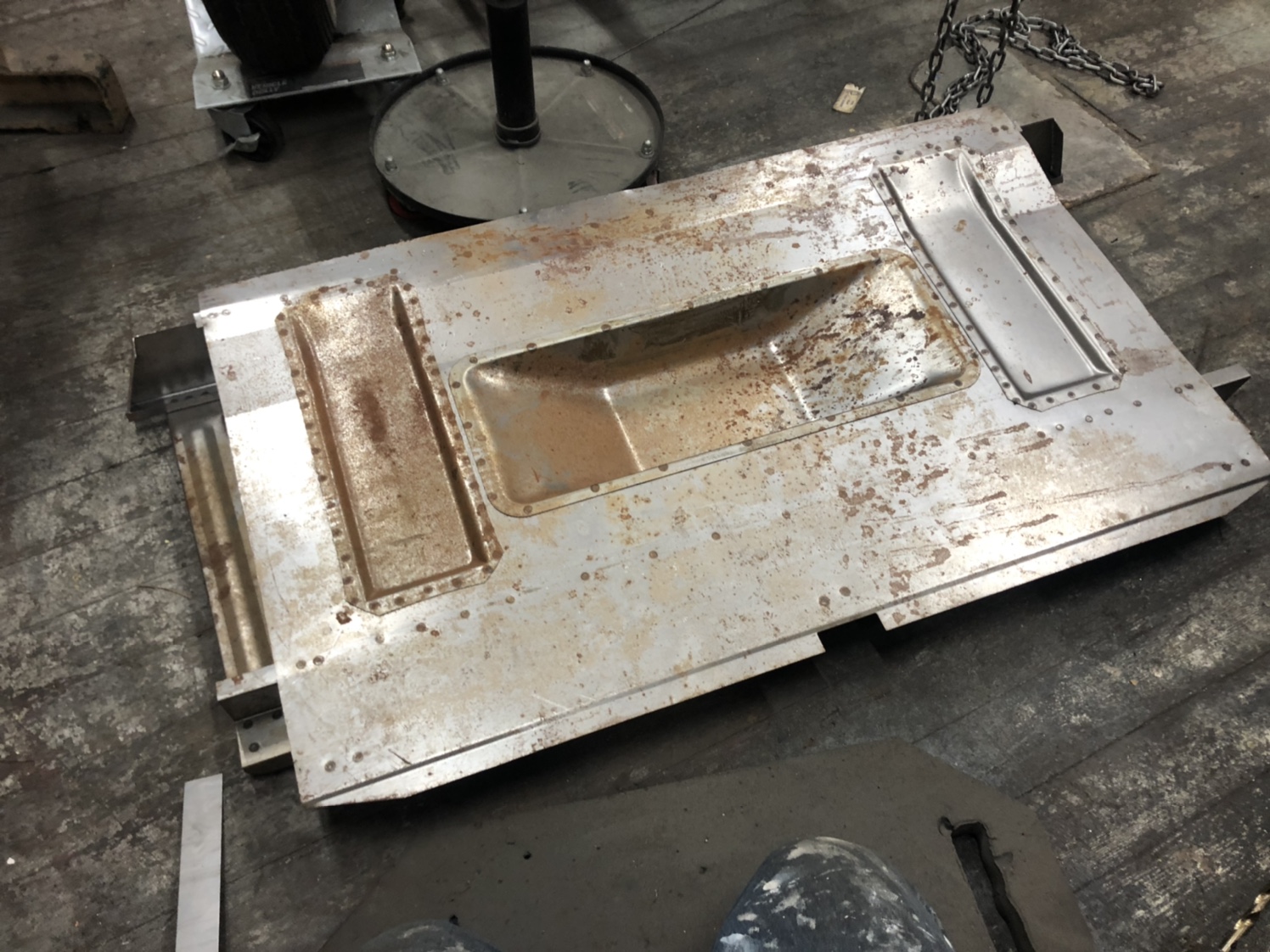

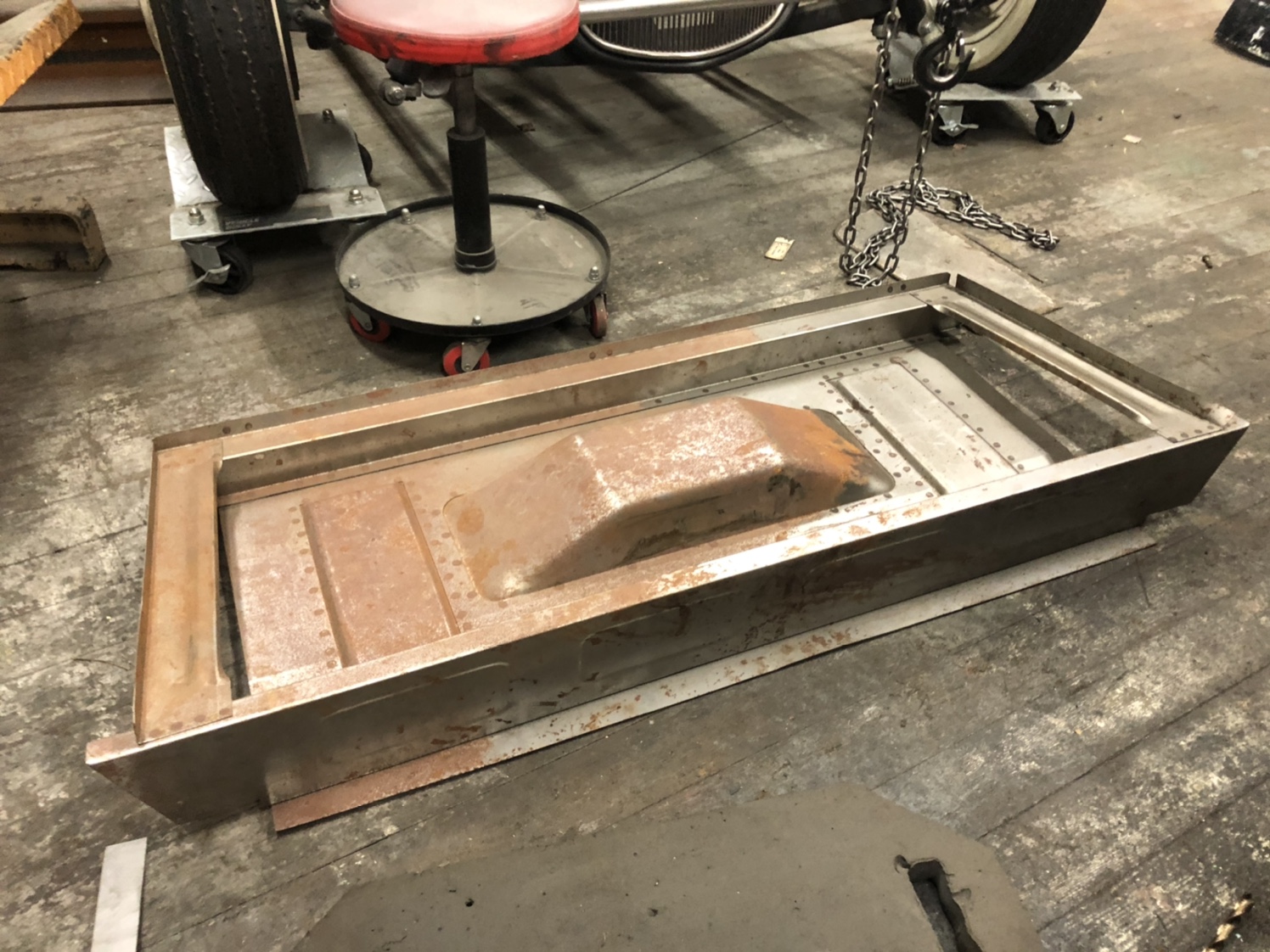

    This is a 30/31 sedan rear seat riser.
    I don’t have a 30/31 sedan and have no need for it.
    I had it listed for sale (pre rust), however like some things, it didn’t get sold.
    So I cut it up [emoji16]

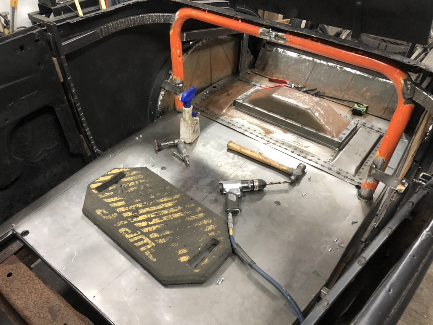

    Removed the hump because the crossmember now sits far too high for it to fit.
    I drilled out so many spot welds !! Holes everywhere. But I needed to separate the seat risers and the hump.
    I fabbed up some risers and raised the hump 1.75” to clear the rear crossmember.
    This damn seat riser pan fits perfectly within the new subrails /floor structure and rear quarter braces.
    It was like I pre built everything for this panel.
    Some things just work out like that.
    Joe (51box) had given me and sold me some parts and pieces from his 28 coupe he had no need for.
    One was this rumble seat rear pan that goes below the decklid.
    He used the top half for his coupe and discarded the rest.
    I used it and Perfect fit again [emoji1360][emoji1362]
    You can see in this pic the tabs I made to brace the body to the hoop.
    Just twisted those up in the vise and bent them on the horn of the vice to radius around the hoop.

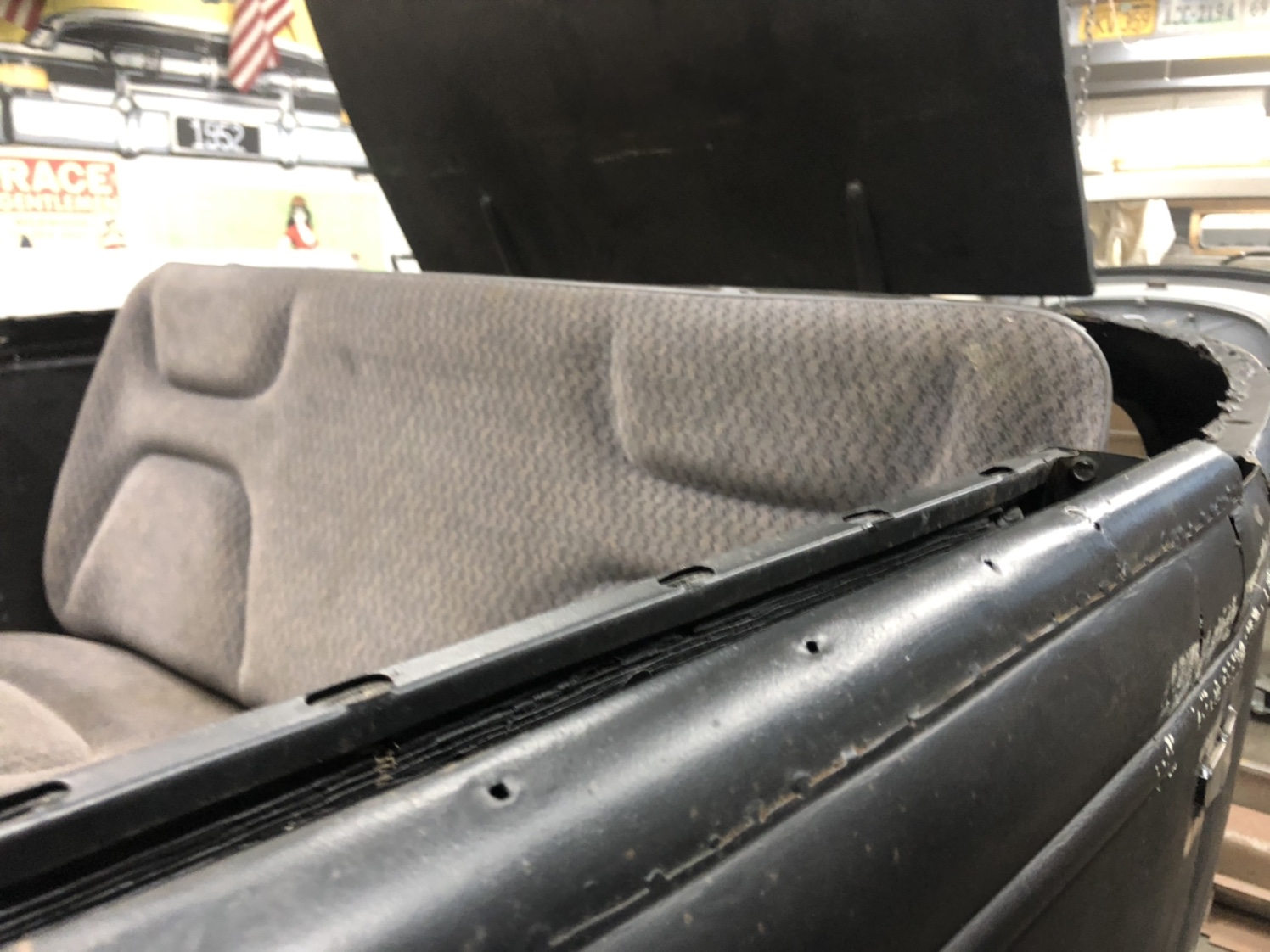

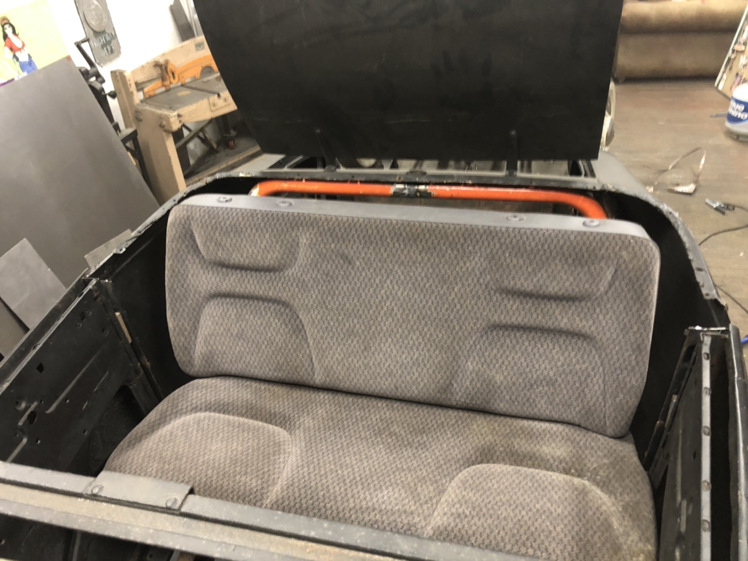

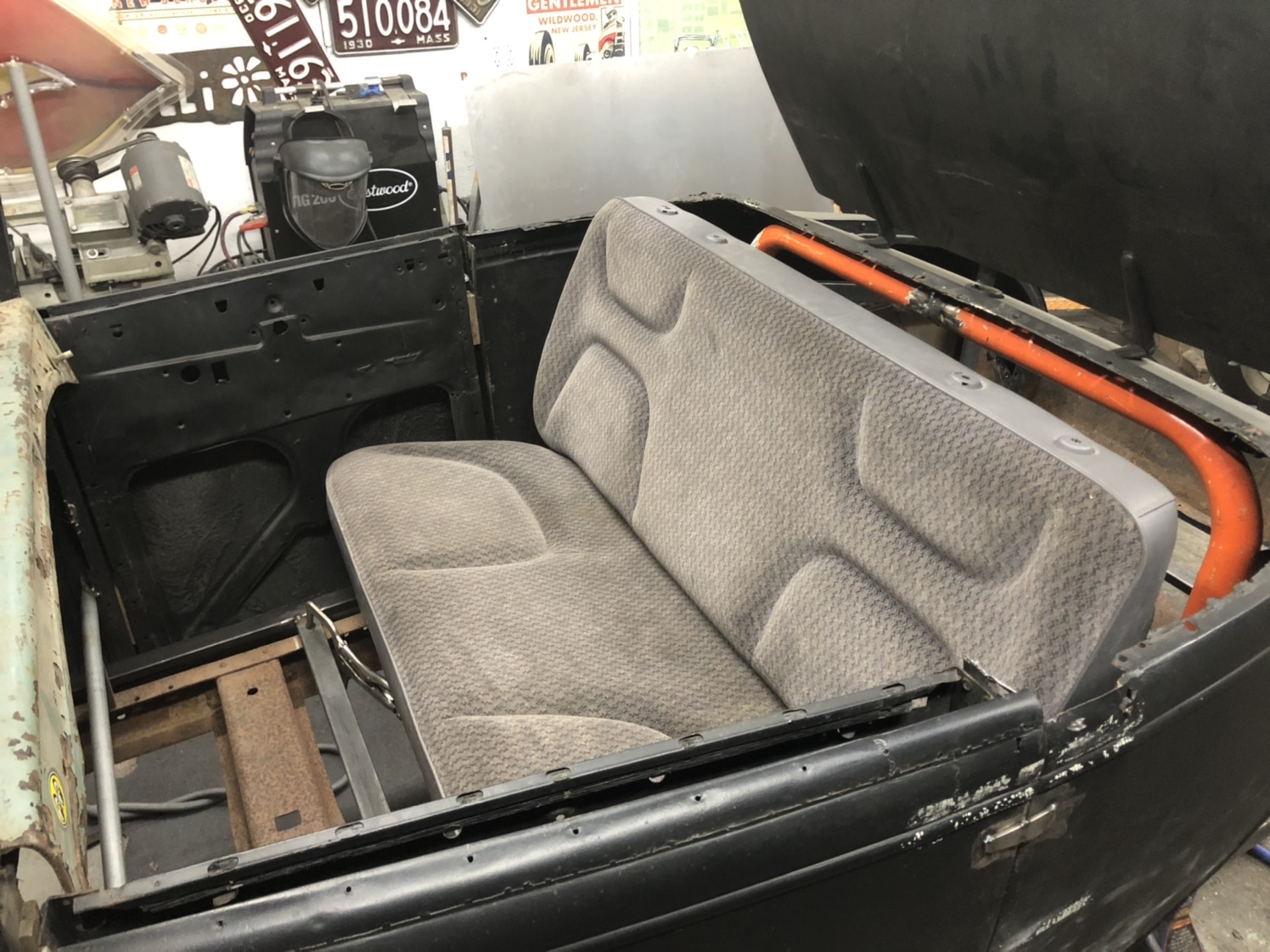

    I had been given an old F1 seat frame a few years ago. I had intended to use it for the sedan however I decided to use a mini van seat for the rear.
    The F1 seat was 8” too wide for an A body. So out came the cutoff wheel. And viola it fits.
    You can see in this pic it’s sitting just a touch higher than the body line.
    With the channel the floor height to the top of the body is 21”.
    My sedan is 22”.
    The seat will look good once the body wood is installed behind it.

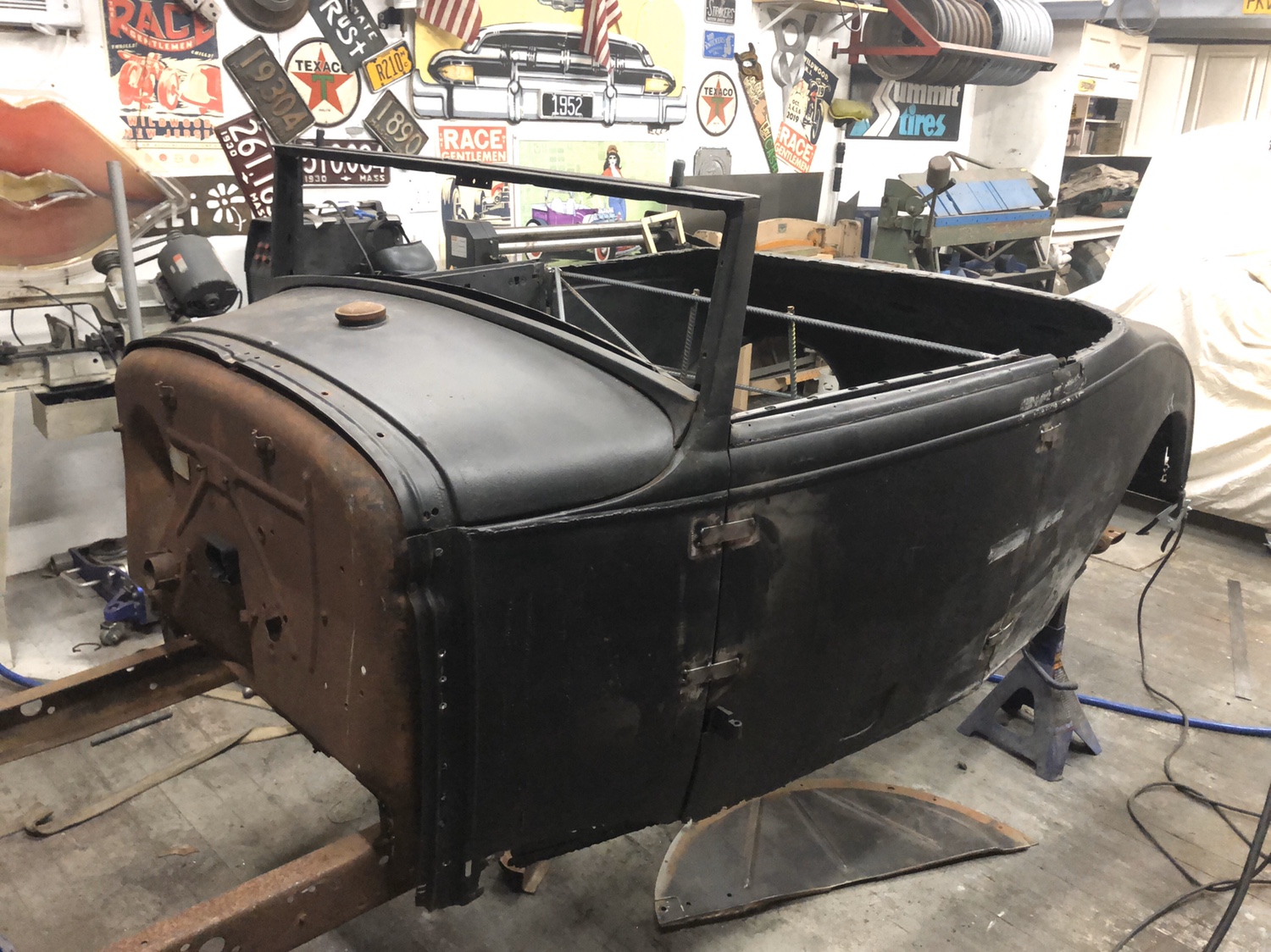

  8. sloppy jalopies
    Joined: Jun 29, 2015
    Posts: 5,256
    sloppy jalopies
    good stuff... going to be a neat hotrod...
    is that the correct dash ?, Vicky and the slant w/s's are different...
    was the cowl originally a slant wind shield ?
    filler panel between the tank and w/s frame is shallow, '30-'31 closed cars except the slant w/s cars... [twice as tall]
    inner doors look odd maybe '31 only cabbies...
    '29, '30 +'31 cabbies used the same rear quarter...
    '29 cabbie,'28-'29 coupe, sport and special cpe, '30 and '31 cabbies all used the same above deck panel...
    it doesn't look like you need any panels...
    . go mike go !

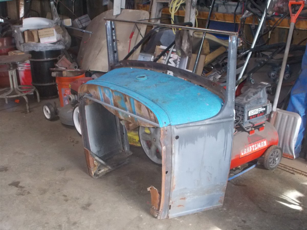

    You are a wealth of knowledge Mike. [emoji1373]
    Thaw cowl was not a slant windshield. It was standard from what brad told me.
    He chopped it and sectioned the doors after removing the window frames and handles
    Dash...my addition. No clue.
    Doors. Are Cabrio specific.
    Like I mentioned, parts are all off the storage container shelves.
    Only thing I’ve bought is the tube stock and sheetmetal thus far.
    Whatever I have that I can make fit, is going on the body.
    So far everything has fit one way or another. [emoji375] [emoji375] [emoji375] [emoji41][emoji1360]

    Day 6.
    I had to add bracing to the floor where the seat would mount, I modified the seat brackets and made some feet to now mount the new seat. Allowing it to be adjustable using the orig adjustment mechanism.
    Cut a sheet of 18ga for a floor.
    No fancy beads no fancy bends. Just a straight forward floor
    After the floor was in and the subrails were complete.
    Day 7
    I fabricated the new B pillars that would follow the contour of the body.
    Off the B pillar I added another brace that also contoured to the body. I made sure I kept it low enough to allow me to install the wood on the rear deck.
    Tied it into the body hoop
    Lots of cuts and welds to get the tube to take the shape I needed.
    Without a bender that’s my only option.
    Heat just collapsed the box tube.
    The B pillars attached to the box tube that I installed from the rear sub rail crossmember that went through the wheel well into the lower quarter and extended to the bottom of the B pillar.
    patmanta, dana barlow, Stogy and 7 others like this.
  21. Mikel50
    Joined: Mar 30, 2015
    Posts: 1,113
    Mikel50
    Day 7

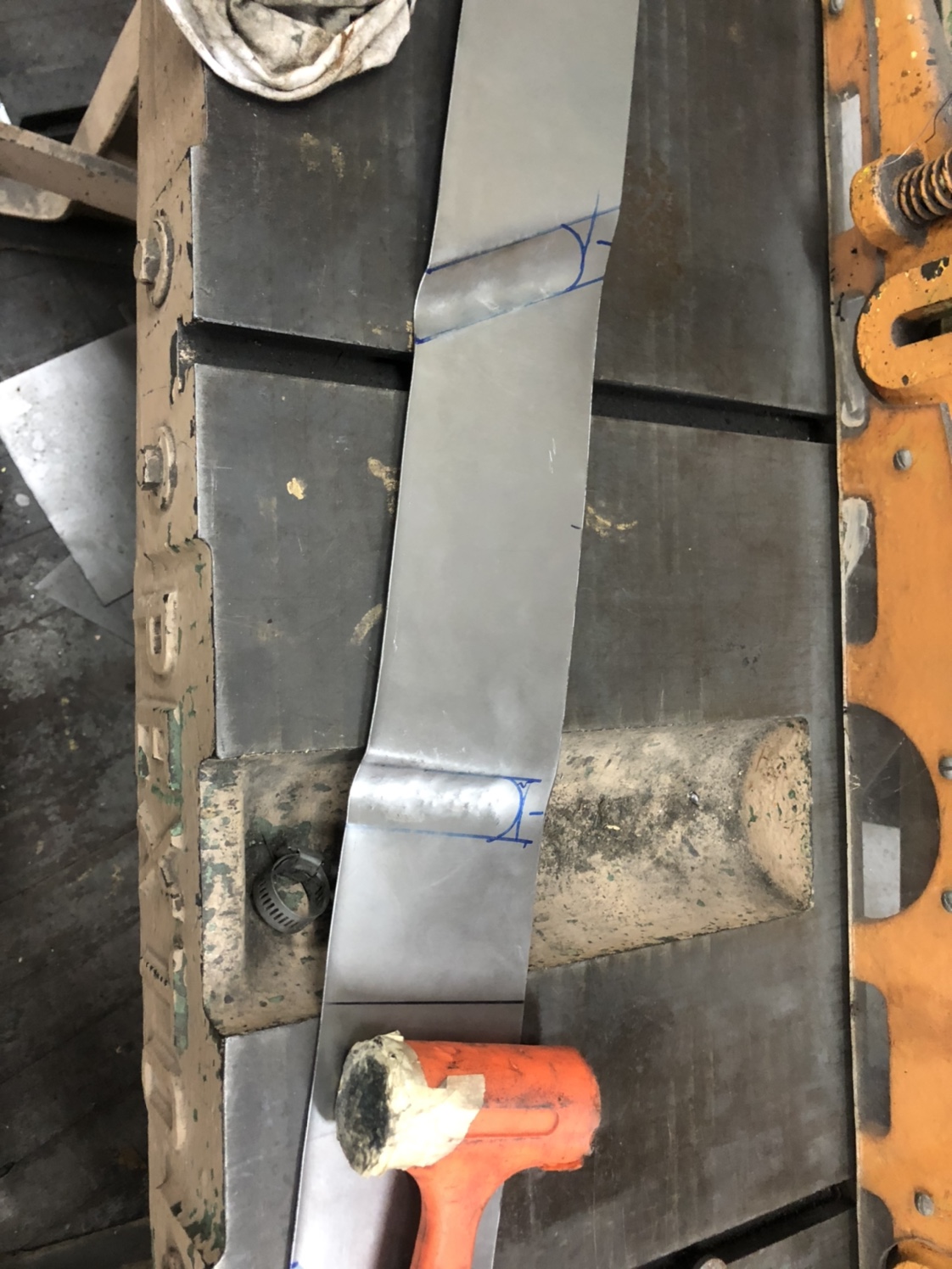

    Time to attack the drivers side wheel well [​IMG]
    Cut a piece to fit

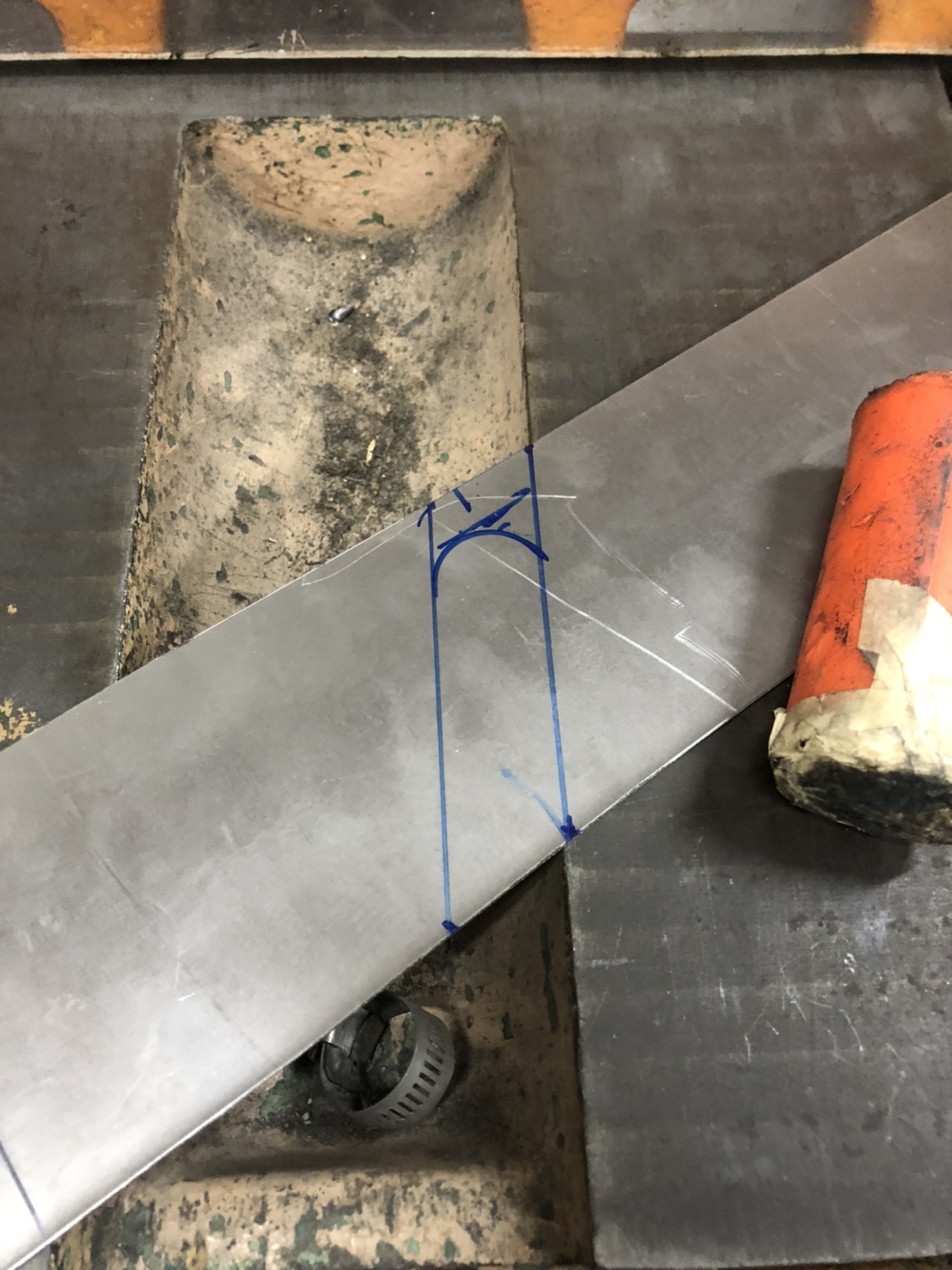

    Using my jump shear I used the sharp edge to hammer the crows foot beads into the sheet.
    I don’t have a die for that reveal for my bead roller. So I improvised as I usually do.
  22. sloppy jalopies
    Posts: 5,256
    sloppy jalopies
    I may steal the little bent strap from wheelwell to vertical brace idea... x 2...
    should help hold the lower qtr where it need be... mostly for when I weld on the patch panels...
    will let me push a little when tacking them on...
    … keep those good ideas coming … we can use 'em...

    Next came time to locate the fuel tank.
    I made sure I added additional support in the sub rails for the tank when I built the floor.
    This tank came with my sedan when I bought it. It has been waiting it’s turn to be used.
    I wanted to get the tank in place and the seat located where it was going so I can build the bulkhead.
    (I have everything to build it, just haven’t got there yet)
    Maybe today.
    I wanted to cover all the holes I had to drill to separate the sedan seat riser.
    So I cut some 1” strips and just tack welded them every inch.
    I’ll seam seal them when the floor gets epoxy.

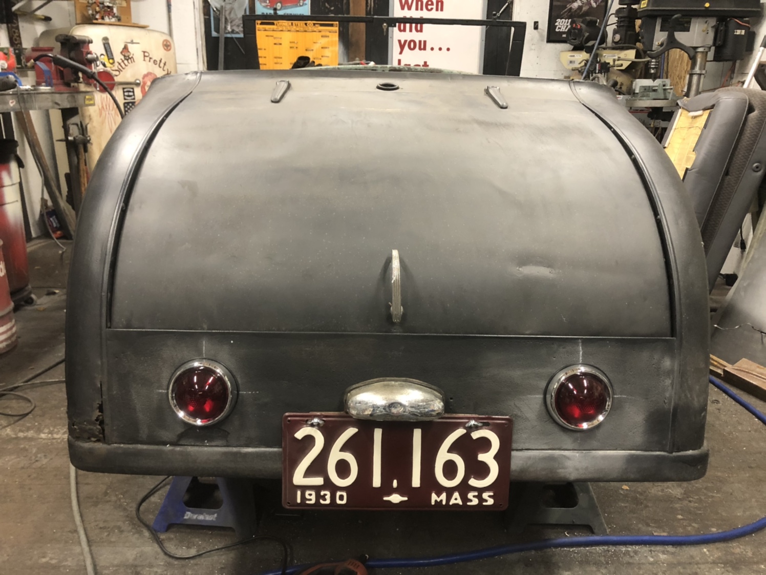

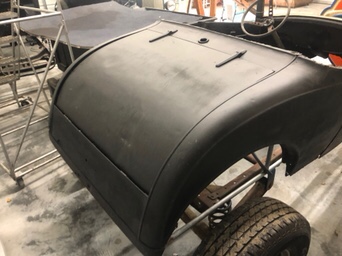

    I had a set of door handles and a matching rear trunk handle. I modified and few things, drilled a hole in the decklid and installed it.
    I heated and bent it to follow the contour of the decklid.
    Worked like a charm.
    I’ll make a latch for it in the future
    I had picked up a pair of Pontiac tail lights from a parts haul.
    The gentleman bought and never used them.
    This went in nice and smooth
    And fit the eta the car will be representing

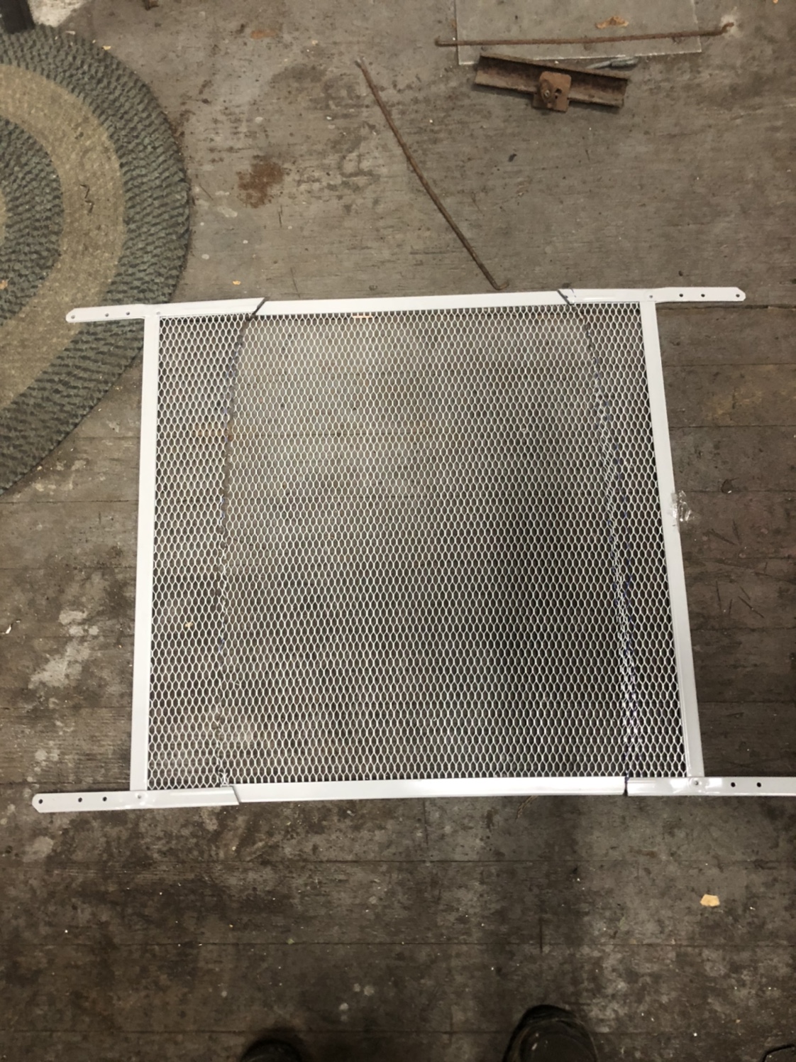

    Threw on an old yankee plate holder and the back of the Cabrio looks great.
    Then I decided to add in insert to the 30 grill shell that will go on it.

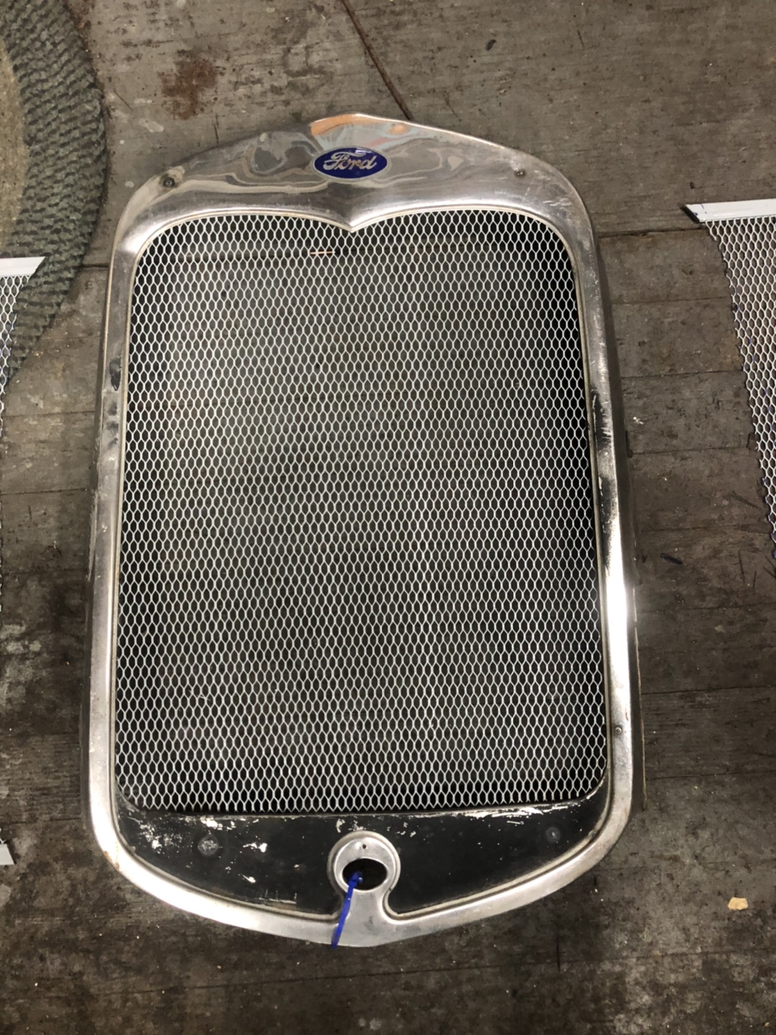

    Not sure where this metal grate came from but it worked and gilt like a charm
    It’s a storm door screen. [emoji1360]

    Then I added the bracing to the cowl so I could remove the doors and get to work on making them open.
    Not sure when the last time the doors functioned on the Cabrio. But I think it’s been quite some time.
    [​IMG][​IMG]
    Got the tabs cut off and the doors off of the body
    [​IMG][​IMG]
    That’s where I’m at.
    Build my own hinges out of round bar stock and flat 1/4” x 1.5 steel
    I can work on my rocker panels or door sills at the doors. (I’ll take pics)
    I’m now able to access the points at the base of the A pillars and B pillars to finish weld the structure.
