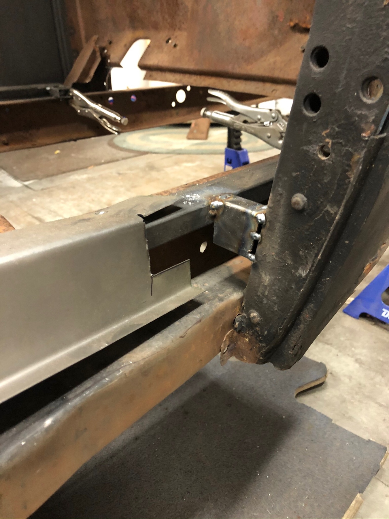

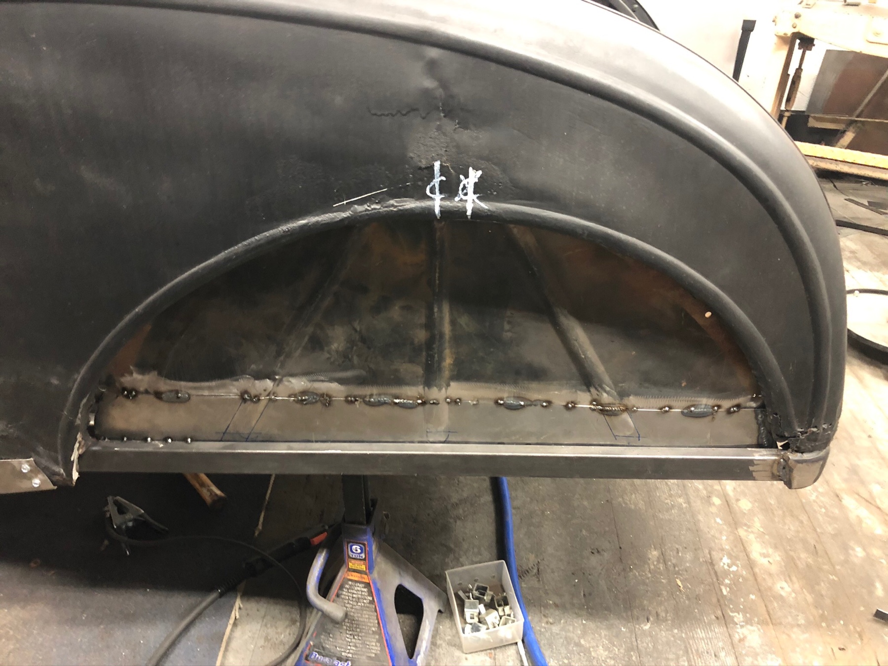

    Got the lower drivers side wheel well patch tacked in place.
    Moved onto the B pillar covers.
    Got them fitted and welded in.
    [​IMG][​IMG]
    Got to access the A and B pillar bases and the channel area behind the doors.
    Got things final fitted and all welded in
    This is the metal that was bent in the brake
    Notched to fit around the material for the subrail that attaches to the A pillar
    Notched[​IMG] to fit over the material that attached the subrail to the B pillar
    These are the subrail from the rear of a sedan subrail structure.
    They work after a bit of fine tuning.

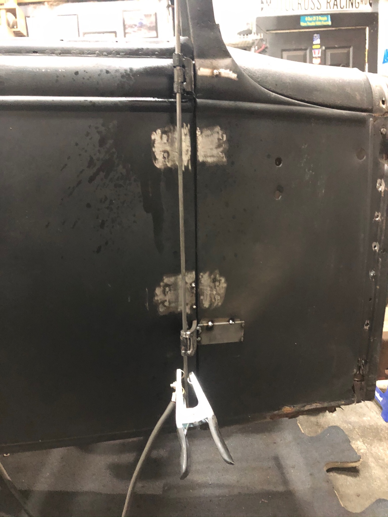

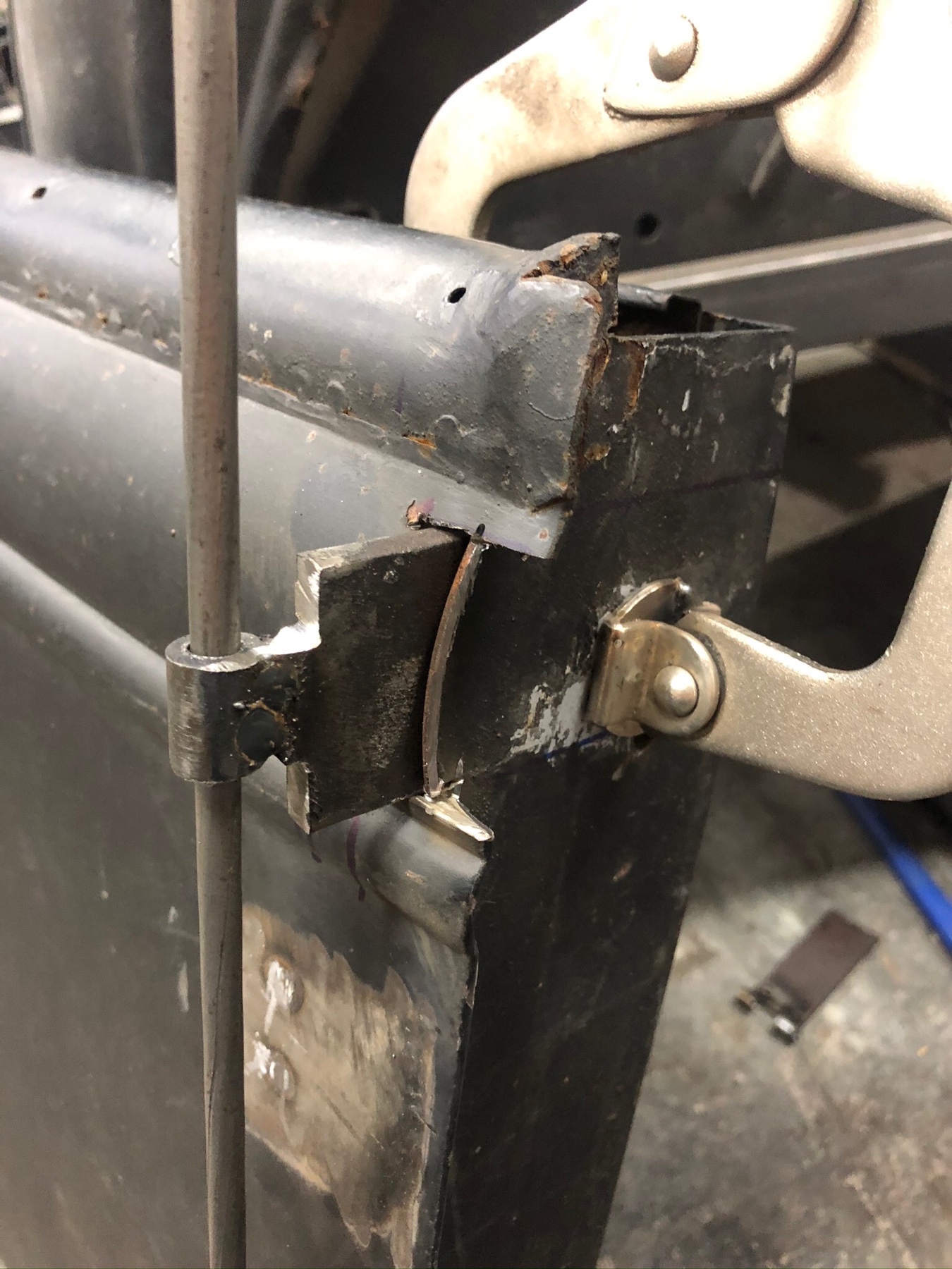

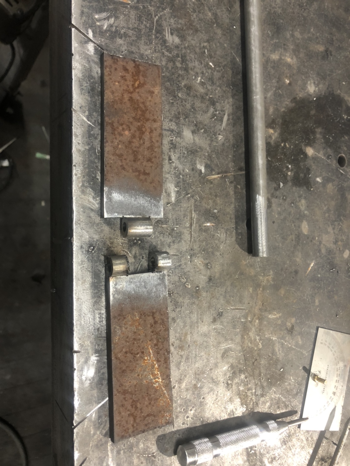

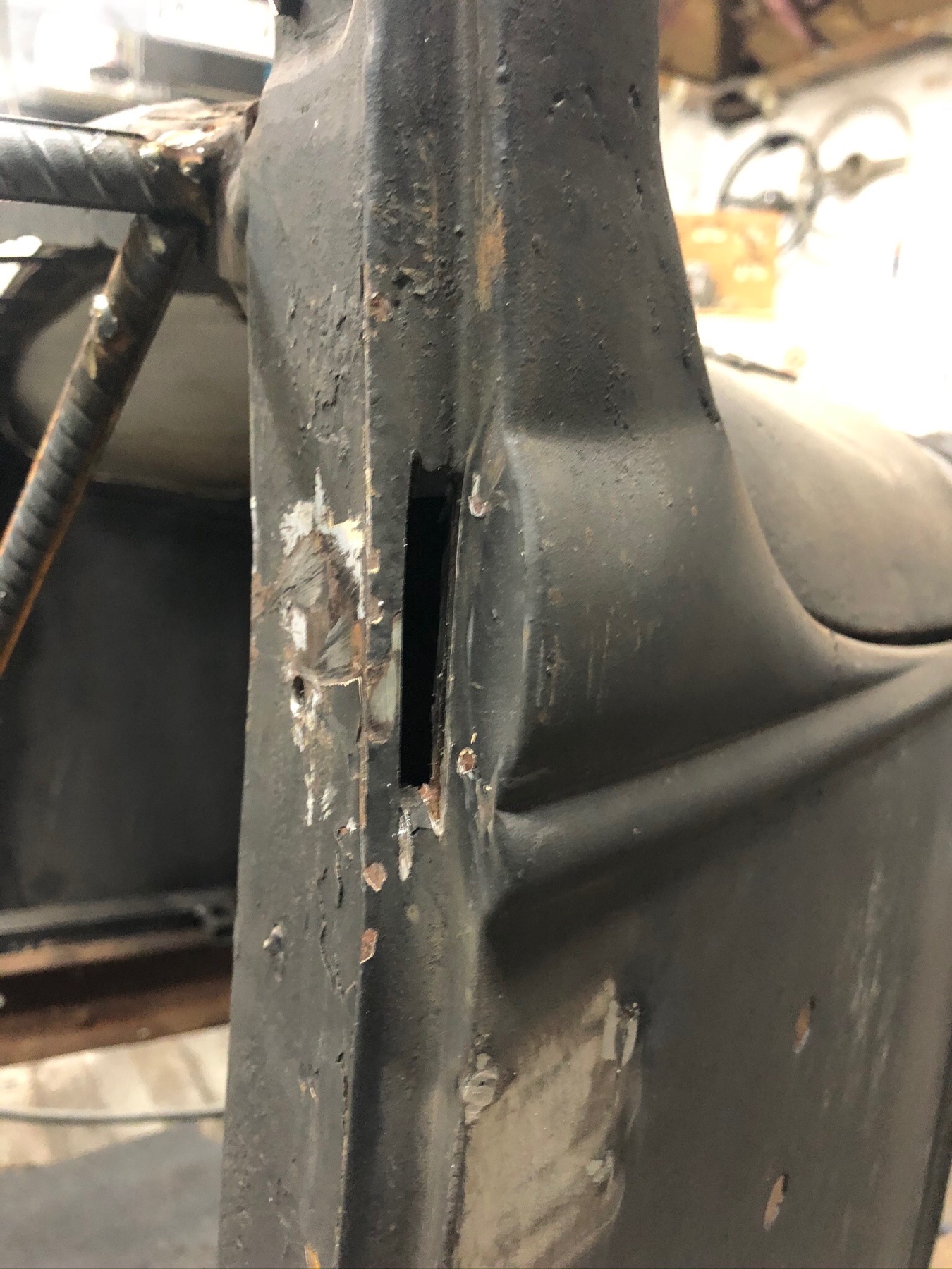

    On to the Hinges
    Flat stock was a rusty piece of 1/4" flat steel
    Cut my hinge material out of this
    I stacked two flat hinge plates, I thought if I welded on the outside of one hinge plate and the inside of the other I could then cut my hinge
    I had to cut slots and notches in the door to install a hinge.
    Heated and bent the flat stock on the cowl side of the hinge to get the hinge to close and line up properly.
    I had to cut a slot in the body for the hinge
    I used the flat plate to help with the fitment of the door. I tacked it to the body then to the hinge once I had the depth of the hinge set. The surface of the cowl and door told me where the sweet spot was. Once I knew, I tacked the plate to the hinge.
    P*** door opens and closes beautifully
    Body lines look great when it's closed.
    Next is the drivers door and install a set of bear claw latches.
    Tomorrow afternoon [emoji1360]

    It’s 1/2 steel round stock. I drilled it out w/ 1/8” bit up to 1/4” for the hinge pin stock. I’ll make the pins out of the rod I’m using now or buy some stainless repop pins.

    lathe or drill press ?
  12. Mikel50
    Joined: Mar 30, 2015
    Posts: 1,113
    Mikel50
    Hahah lathe. You’re cute. A drill w the round rod in a vise w/ my fingers crossed.

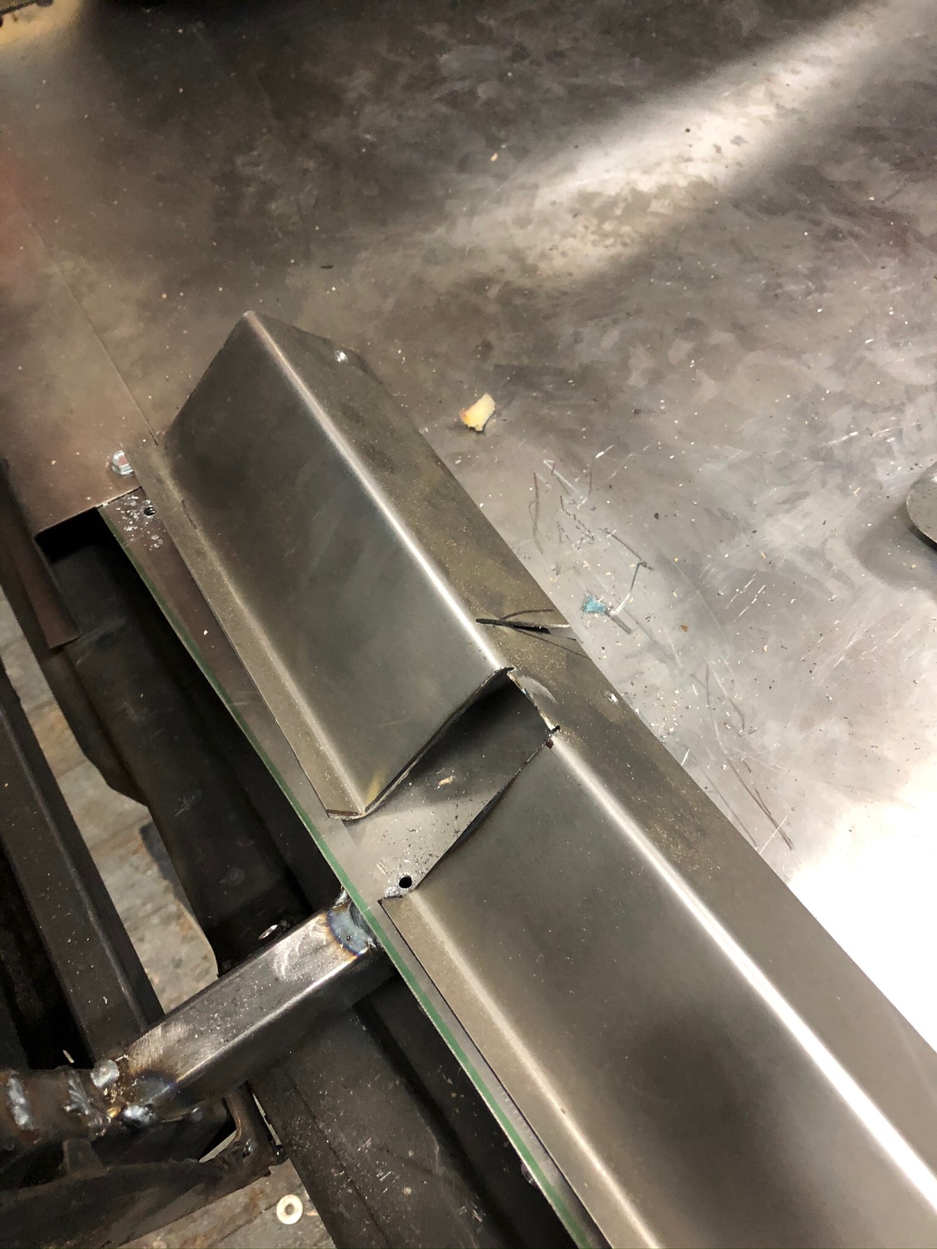

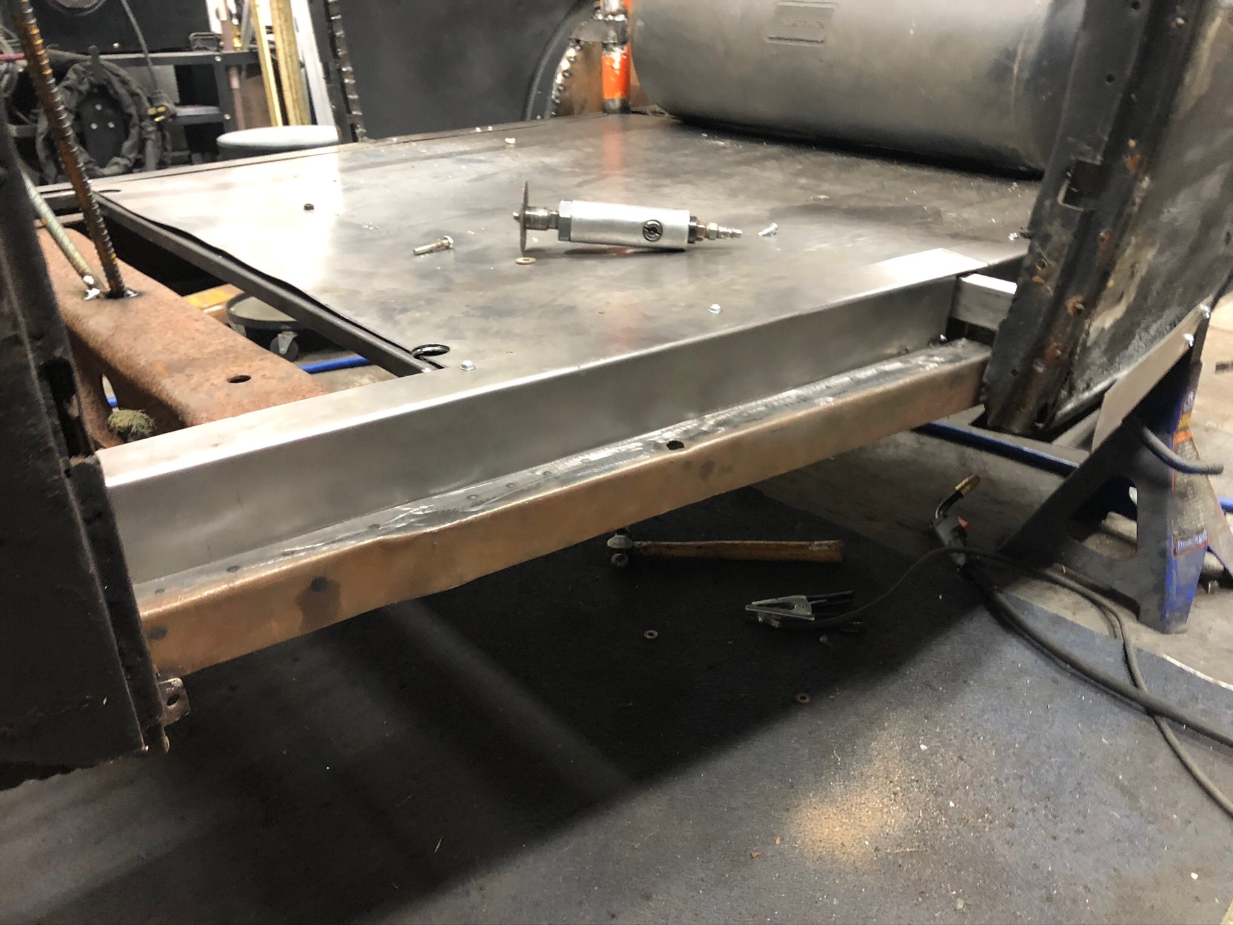

    Worked for a few hours after lunch today on the bulkhead for the trunk.
    No fancy bead rolling on this car, just getting it done so it can go to its new home.
    [​IMG][​IMG][​IMG][​IMG]
    One more item off the list. [emoji41][emoji1360]
