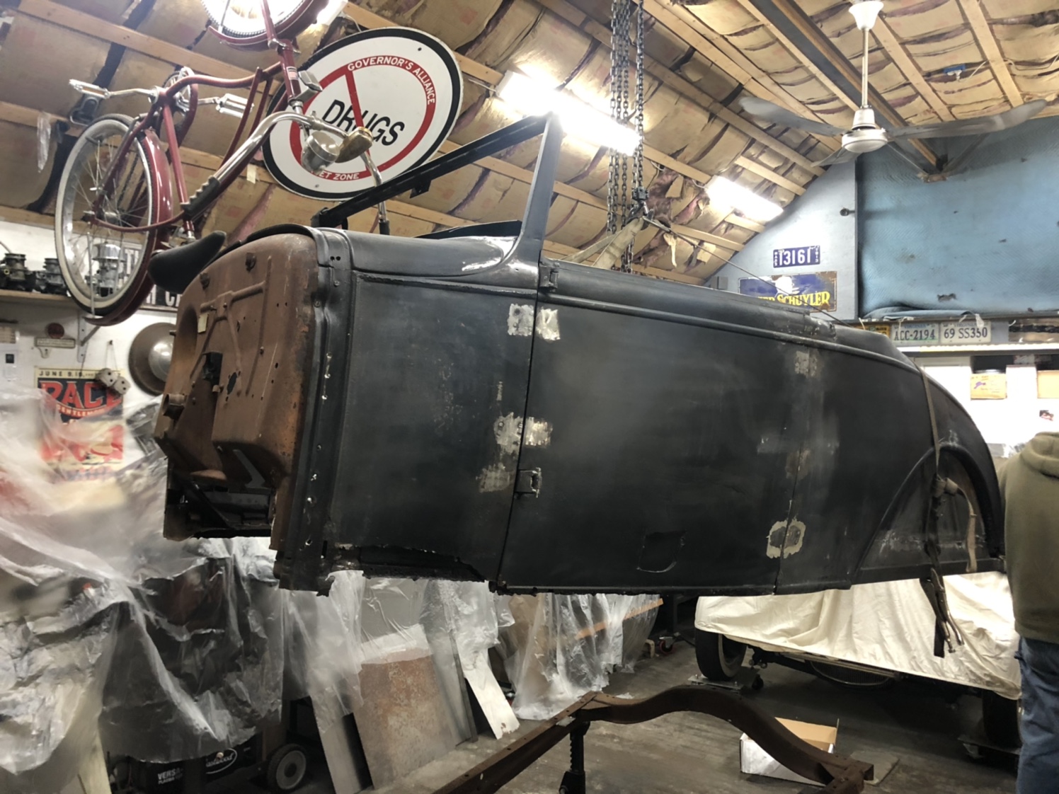

    It’s been 2 weeks as of this afternoon that I started work on the Cabrio.
    I finished bolted the body to the frame, finished the subrails at the cowl to secure the front of the car. Mounted the windshield frame, finish bolted the firewall in, finish welded the remainder of the underside of the subrails. (Lifted it off the ch***is before finish bolting it) I mounted the fuel tank, built new decklid stops to set the height when it’s closed and installed new bear claw latches and strikes.
    (I had the day off).
    She’s ready to be painted (new metal) and rolled out into the daylight of some stock A axles.
    Final mounting of the fuel tank
    B pillar (before latch strike)

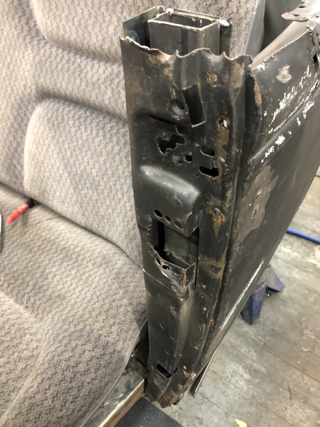

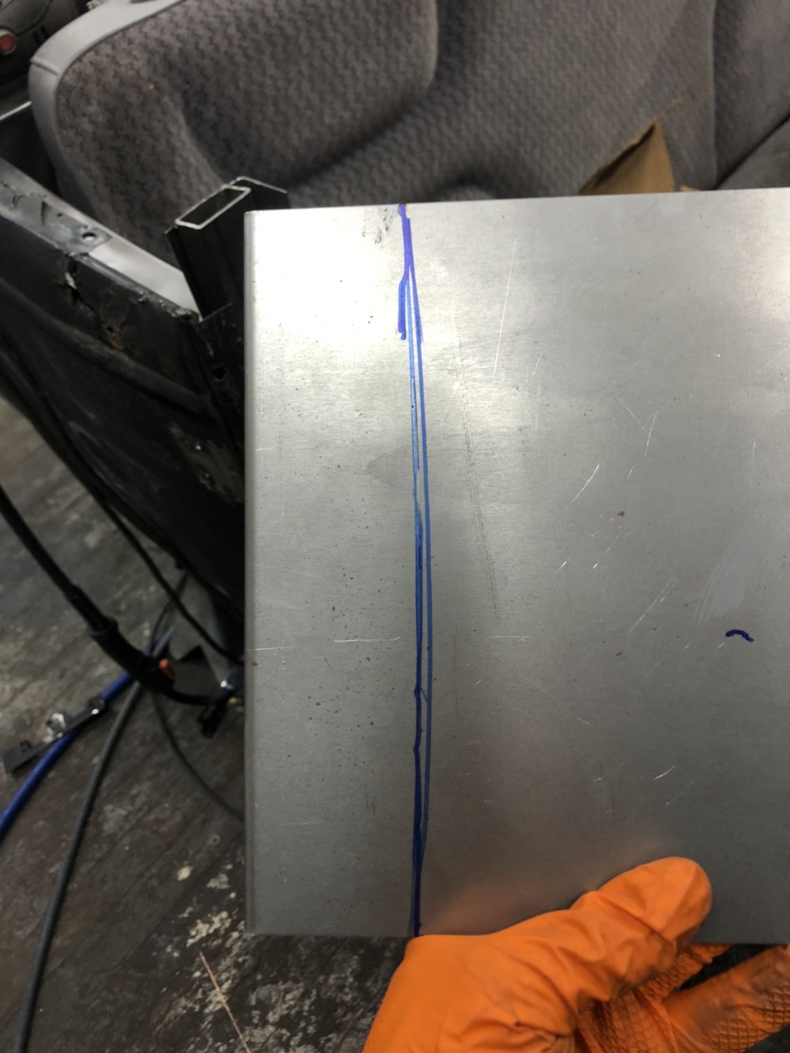

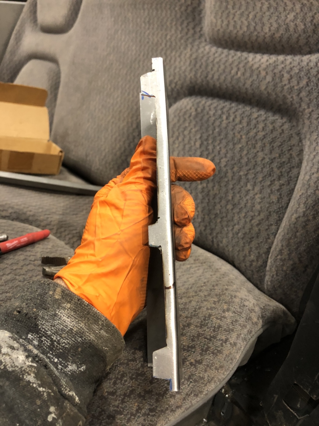

    B pillar during rebuild (there wasn’t any good metal to attach the catch to, so I remade both sides)
    [​IMG][​IMG][​IMG][​IMG][​IMG][​IMG]

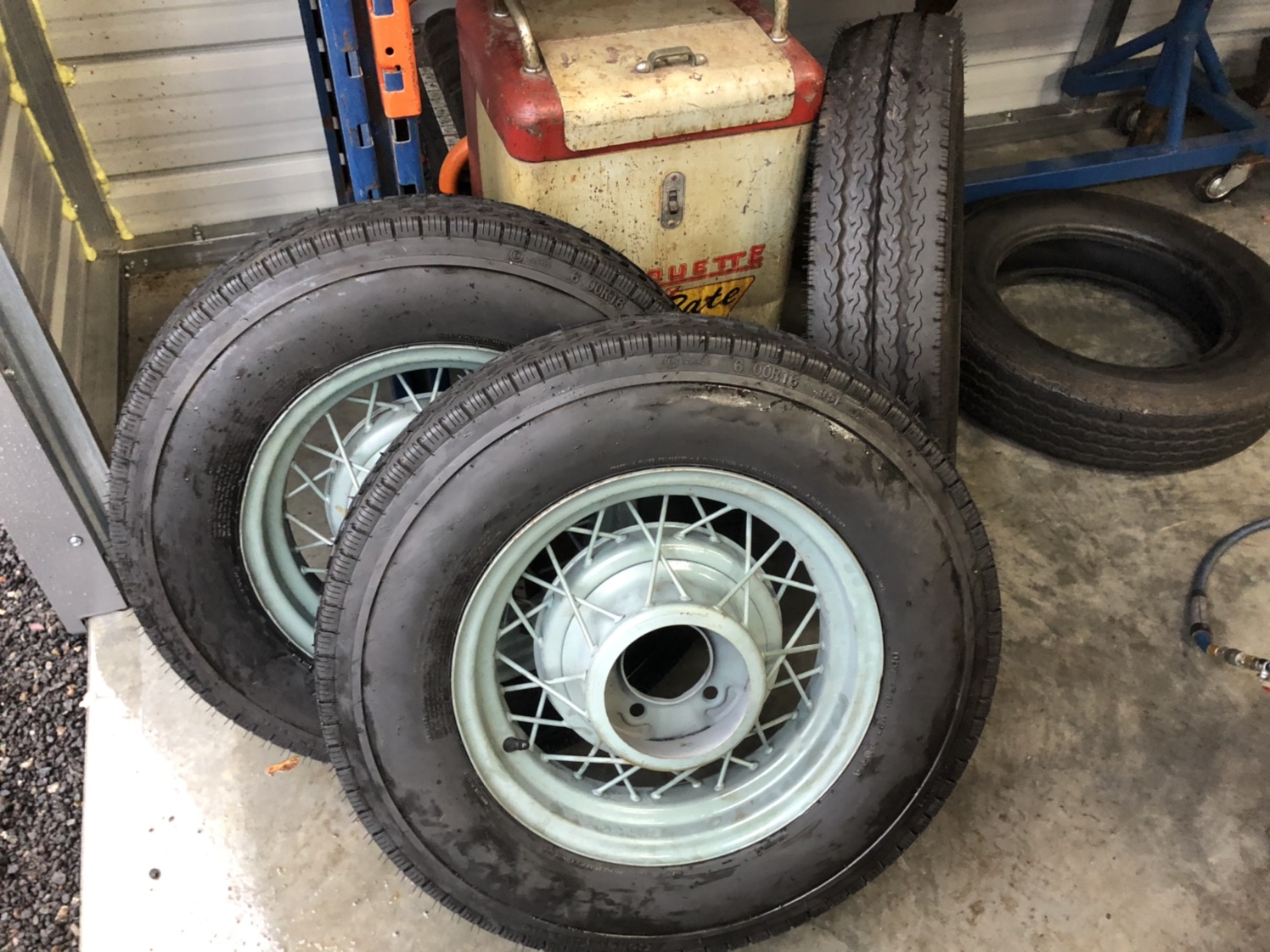

    The day before yesterday (Tuesday afternoon) I tried out for the first time an old Coats tire machine that was given to me over the summer.
    The new owner of the cabriolet brought over his 35 Wires and a set of NOS Coker Cl***ic big and littles.
    He got them from an older gentleman who purchased them years ago and never mounted them.
    He ran out of time, so we were unable to move the axles into the shop.
    But that’s one step closer to it rolling. [emoji1360]

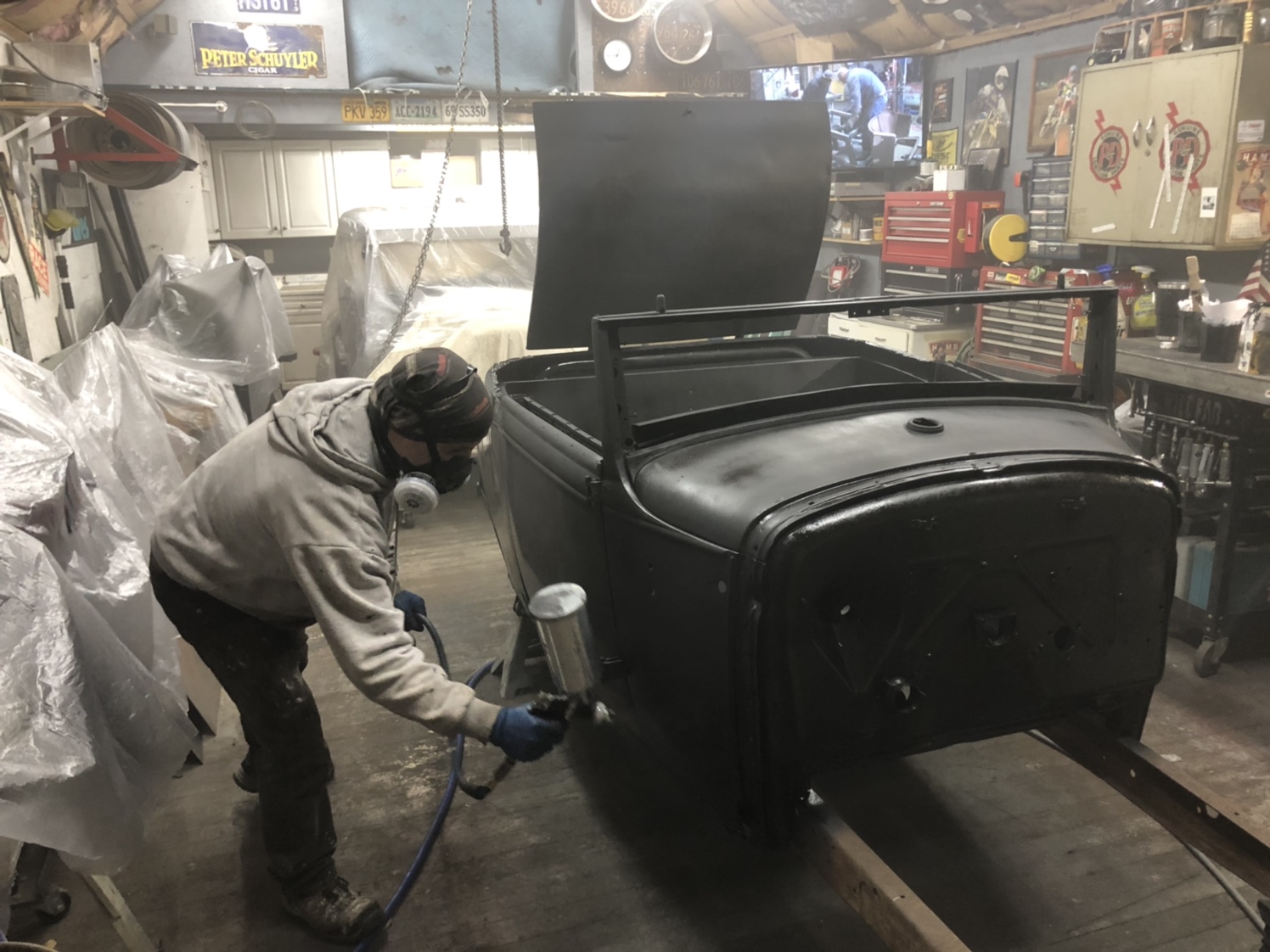

    Half day today allowed me some extra garage time.
    Got the cabbie scotch brighted wiped down and sprayed the whole body in black epoxy.
    The new owner came by seam sealed the new metal and took some pics as I sprayed it.
    As always I did a few more things like building a decklid latch and installing some leather door straps. (Took them back off before painting).
    Tomorrow it gets the axles and it will be off to his house. [emoji41][emoji1373].
