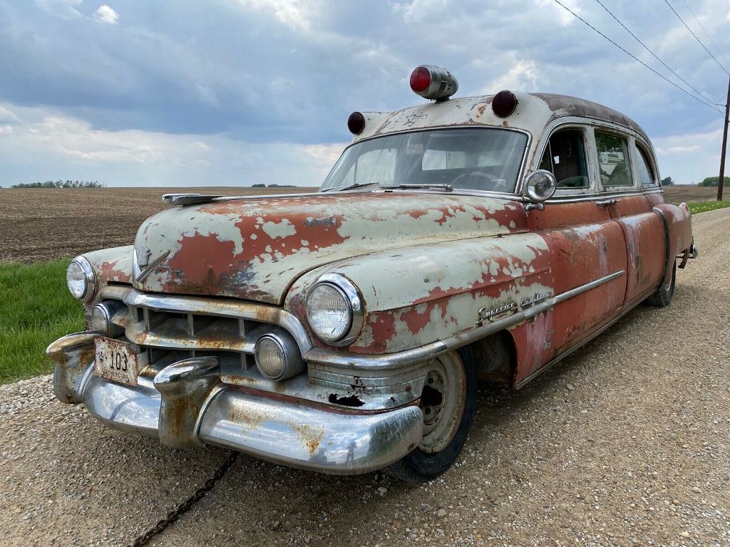

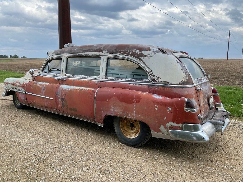

    I'm getting started on a '50 Cad ambulance project. It's has the early integral bellhousing block and stock 3 speed. Motor will need a full rebuild, but I found a '55 331 in running condition.
    If I run that block, I'd have to get the Wilcap or Speed Gems adapter, and run a GM transmission...
    I plan to actually use the car for shop hauling and to pull a light car trailer. Would like to keep the rest of the ch***is stock except for brakes. Any transmission suggestions besides a Muncie? For period correctness, a Borg Warner overdrive might work, but would it hold up to the weight of the commercial ch***is? T-5 or NV4500?
