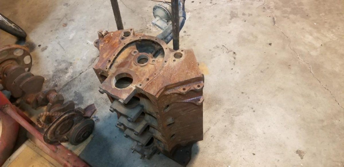

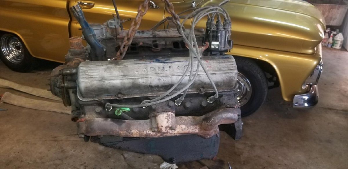

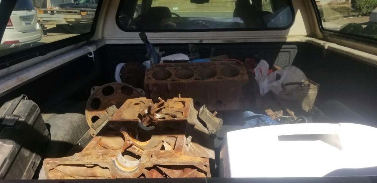

    Building a vintage Cadillac engine was kinda a bucket list for me. No real reason, just something I wanted to do. Bought a core 61 390 with a trans that I didn't want but the seller wouldn't separate. Which in the end turned out to be a bad deal. Here is a picture of what I started with. 24833.jpeg

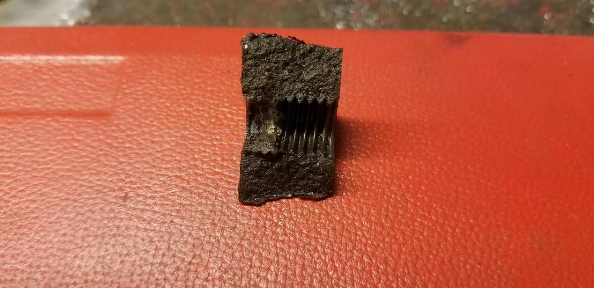

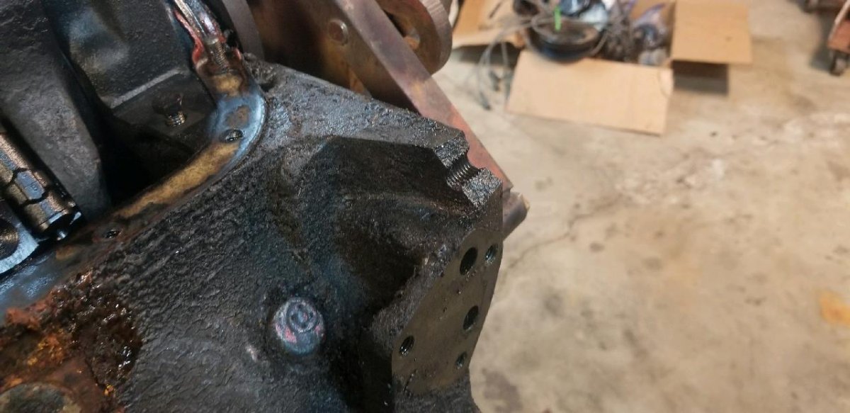

    Now to show you the bad part of this deal. Not only was the block already .060 over but some a-hole in the past apparently broke the corner off and JB Welded it back on. 24837.jpeg 24838.jpeg
    So the search was on for a new block...

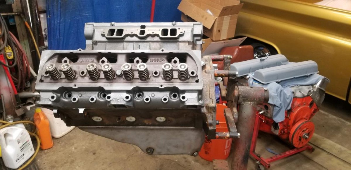

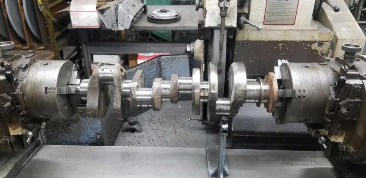

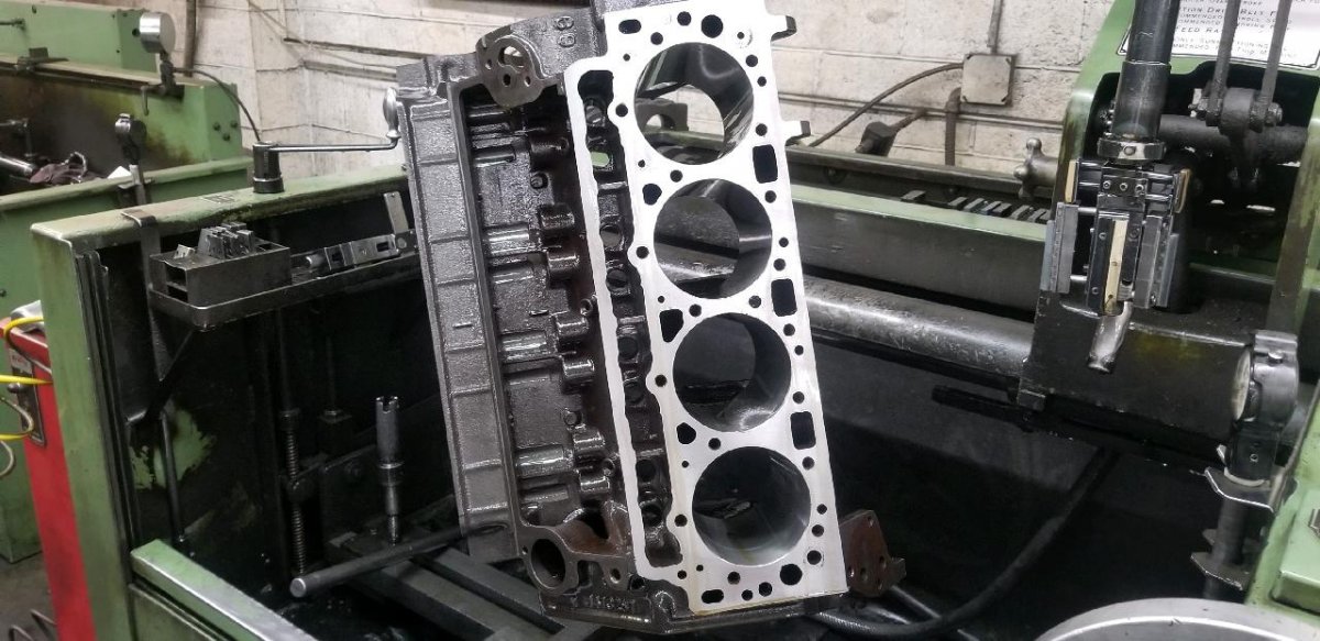

    So I hauled all the parts down to my friends at Wholesale Automotive Machine and did the full block combo. Decked, line honed, bored, the whole nine yards. Crank was standard and we just polished it. 24842.jpeg 24861.jpeg
    I did some minor porting and clean up work on the heads and had the guys install hardened ex. seats, all new valves and valve springs.

    24865.jpeg 24847.jpeg Then I took it home and began ***embly work. Made a trip down to the guys at Schnieder Cams. 24863.jpeg 24853.jpeg

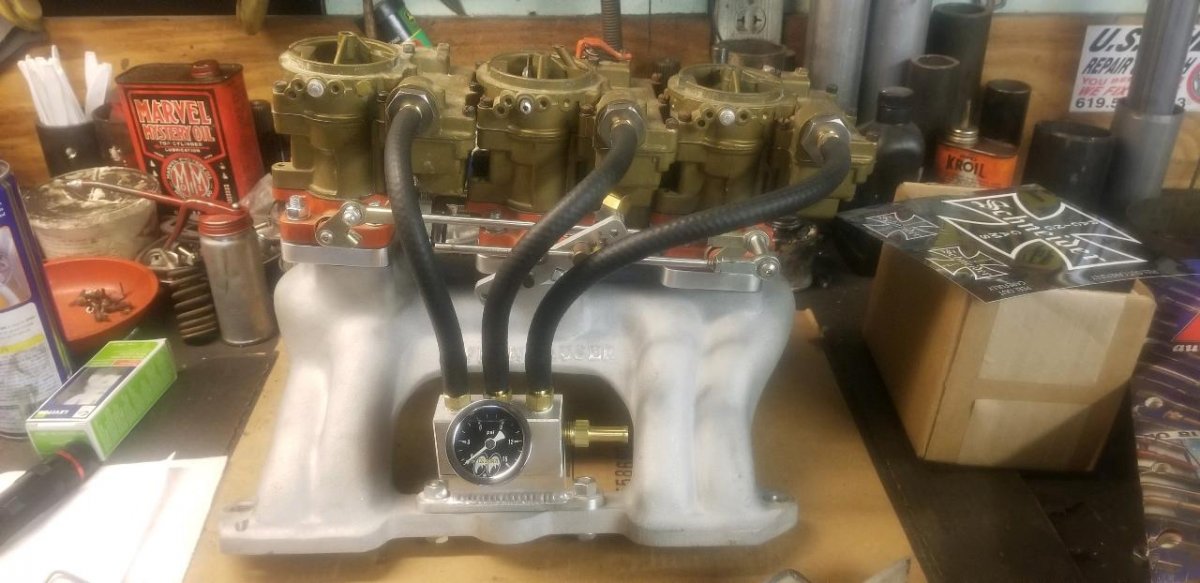

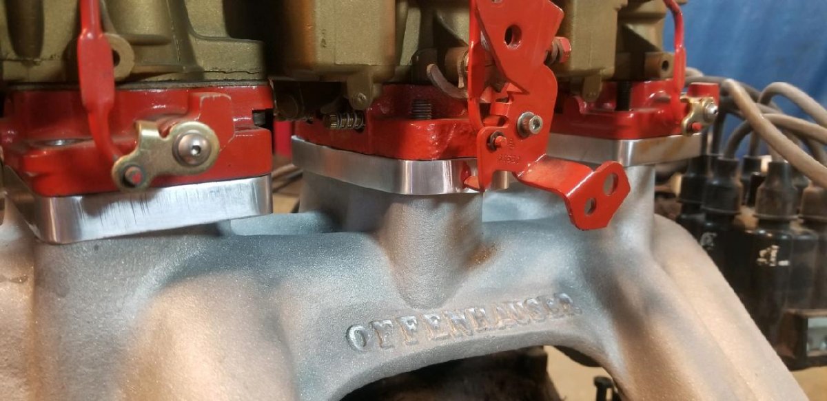

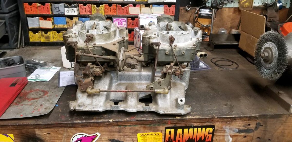

    For my birthday my wife bought me the just released Offenhauser 3 Duece intake and I went to an estate sale and found a complete SBC tri-power intake with Rochester Carbs that the previous owner had rebuilt with vintage speed parts. So I sold the SBC intake for more than I paid for the whole setup and proceeded to make adapters to fit the Rochester Carbs to the intake. 24835.jpeg 24844.jpeg

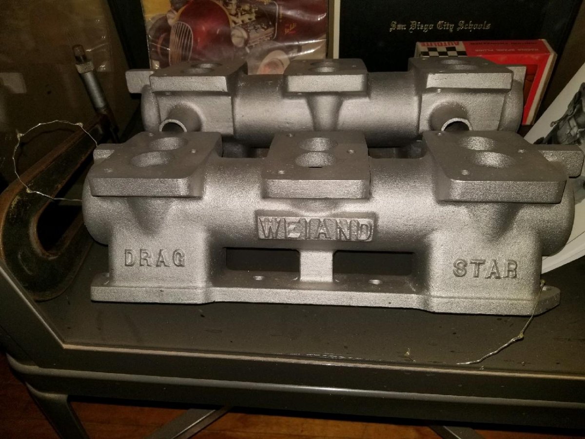

    I also ended up with a couple of other intakes during this journey. 24846.jpeg
    And NOS Weiand Drag Star intake :D

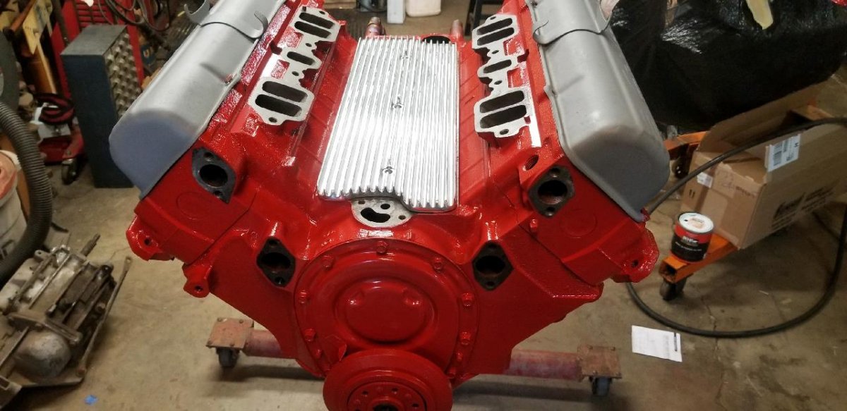

    So I got the whole thing screwed together and built a quicky engine stand. And got it ready to fire up.

  15. I like the fuel block Colin, make that yourself ?
    Finding a later block here with the full flow filtration is the hard part.
    loudbang and kadillackid like this.
  16. lumpy 63
    Joined: Aug 2, 2010
    Posts: 3,441
    lumpy 63
    Yes Chris , I made that . I bought a Moon fuel block but it was too large to place it where I needed it to fit.
