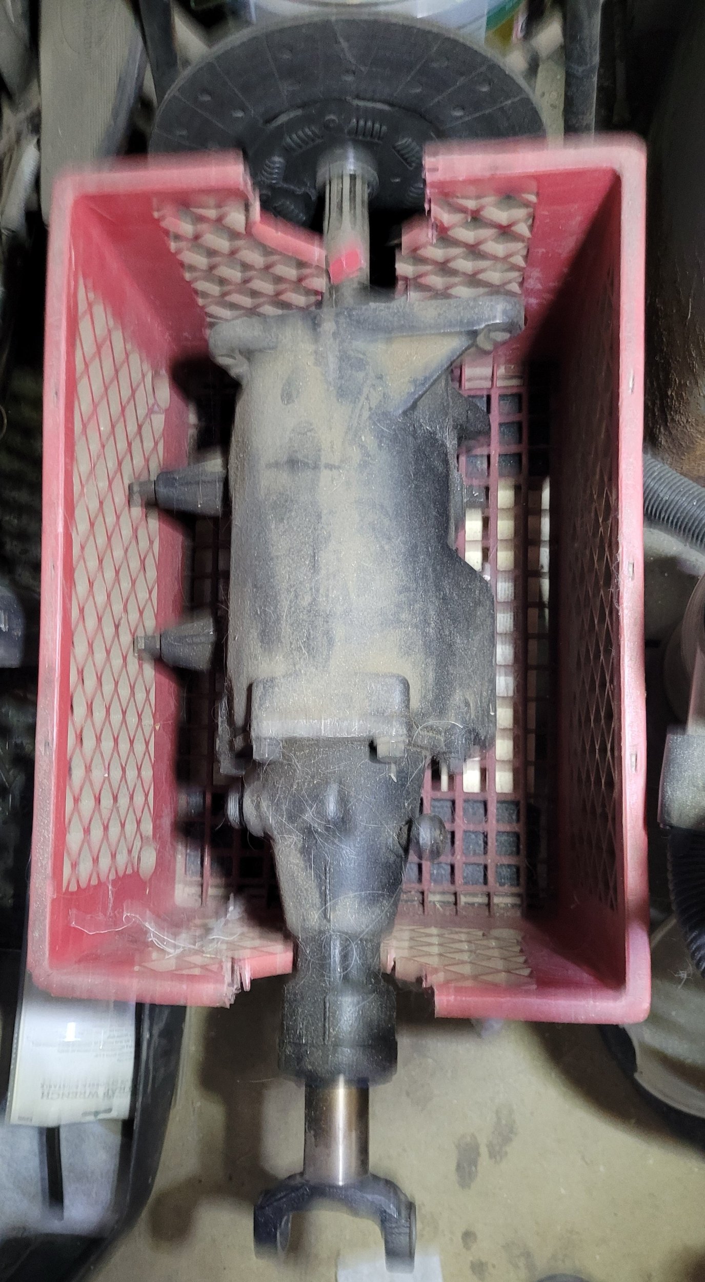

    Ok so the ’tube’ is actually the bell on block on a 331.
    Never seen pictures of the long end on the Lasalle, so this is how it look ( its a short driveshaft )

    We built a duplicate 3W seat and while the shifter was back and to the left as compared to a top shift box; it worked out and cleared the seat OK.

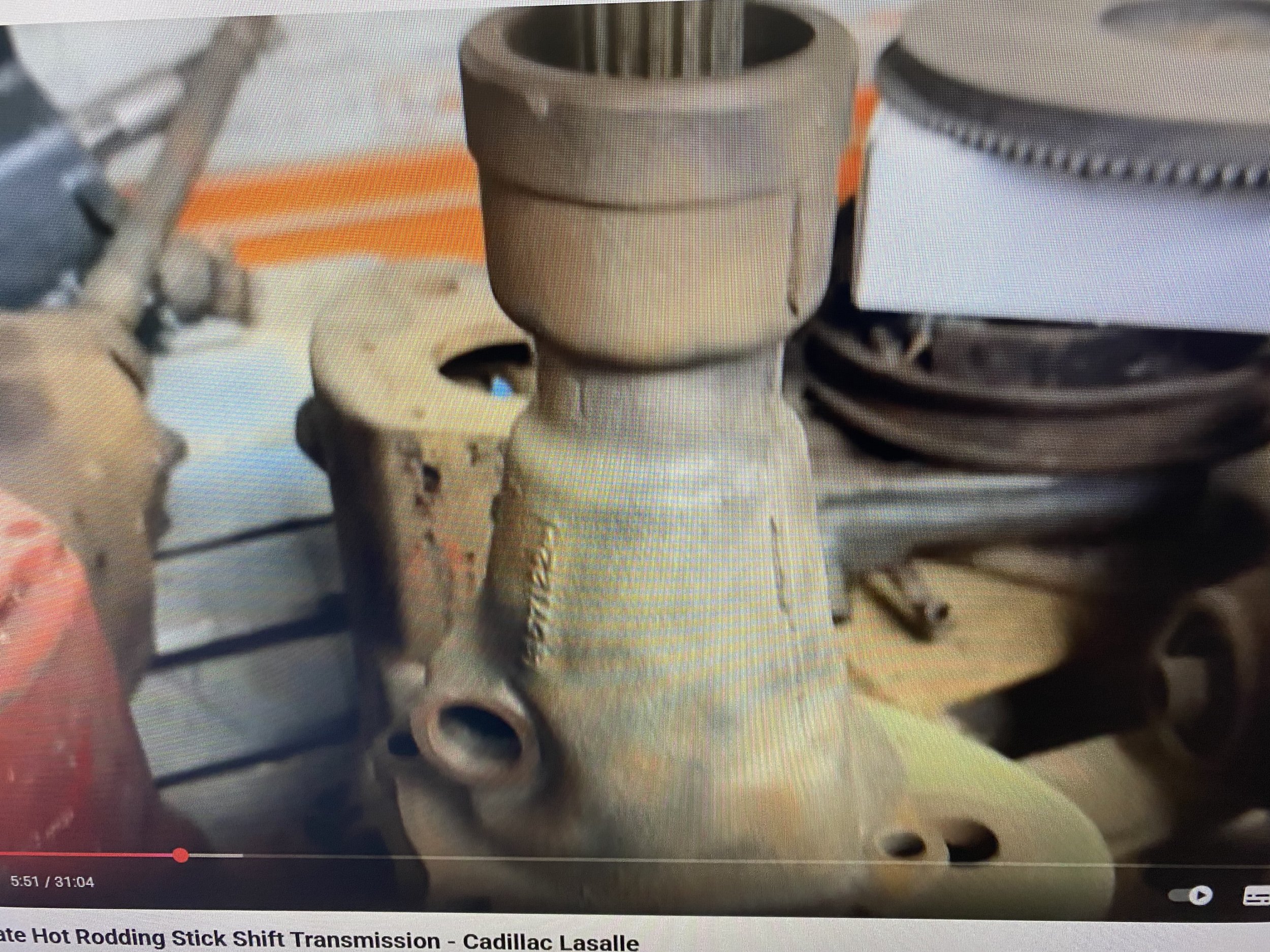

    I notice the 50 Olds has a end that is short, se picture.
    As I not has set-up details for the early Hemi ideas I cant say if I go TQ tube or a open driveshaft.

    If you don't like the length of the Lasalle,you might try and find a 50 Olds trans it's shorter.Its a side shift and it's open drive.There are some floor shifters out there for them.
