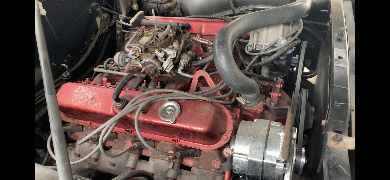

    My buddy has a 65 Caddy with a '76 500 engine. The car was starting and driving great until it say for almost 2 years. We got it to start up with some Starter fluid, and once it was going it fired up easily. But after it sat overnight it wont start again. I haven't been back to his house with the starting fluid, but Im ***uming that will make it fire again.
    I should mention that we had to put a new mechanical fuel pump on after it sat for so long. The old one developed a bad diaphragm when it was sitting.
    Whats the best way to go about figuring out the issue with it not starting when its cold?
    Here is the only pic I have...

    It looks to me like you have an electric choke with no power going to it,( no visible power wire) so it's not going to work. That is the first thing I would correct.
    carbking likes this.

    So we hooked up the electric choke, and would you believe it, the car starts and drives great!
    Thanks for all the help!!
