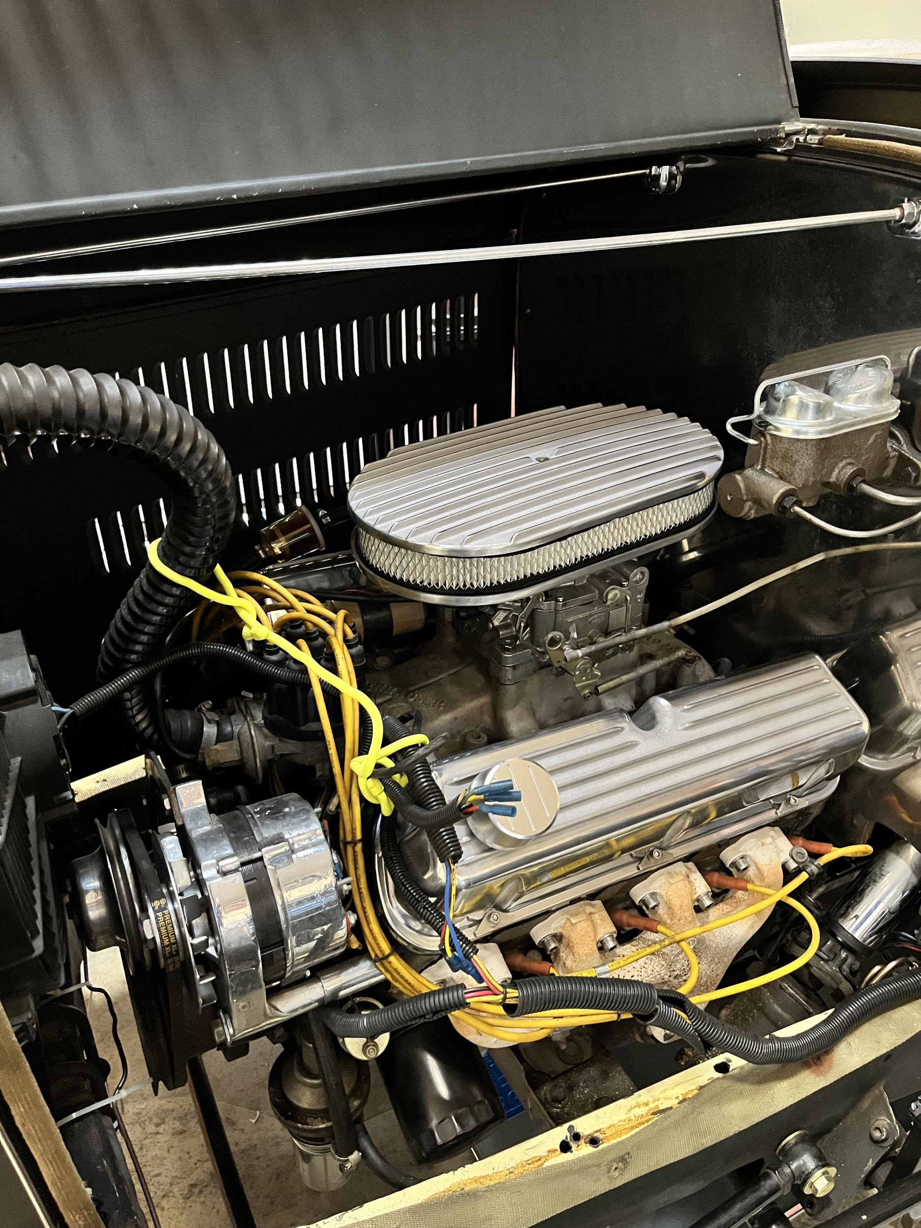

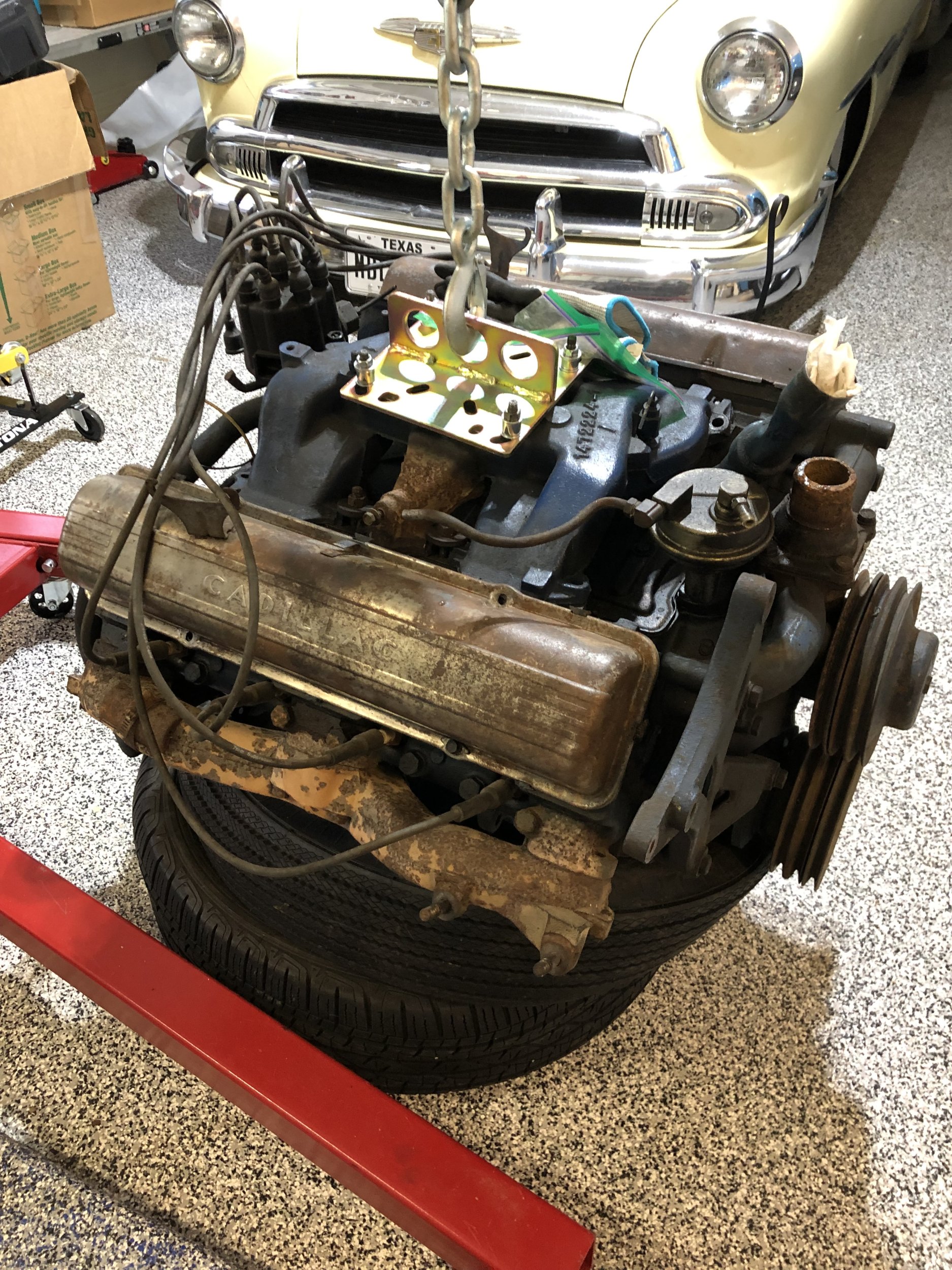

    Hey everybody, I'd like your thoughts on the following scenario.
    I have a 32 3 window I was going to put a Cadillac engine in. It currently is running a 65 289 that came with the car. I originally purchased a 1959 390 engine. It turns freely but I never heard it run so I had plans to have it rebuilt. I also have access to my wife's 1950 Cadillac that has a running 331 (but should probably be rebuilt) we were going to eventually pull and display in the garage
    . It would be awhile till I was able to use the 331. The 390 is out of the car but I'm also fixin to move to another state and don't know if I really want to transport it. I like the cool factor of the 331 but it's a real poochy *******. The 390 would get me more horsepower but as previously stated the condition is unknown and I'm moving.
    As far as the 32 I was going to eventually restore it to be a drylakes racer homage but one that wasn't going to be a strict "only parts prior to 1950s allowed" type build.
    So what say you? 390 or 331 and why? Appreciate any and all opinions!
