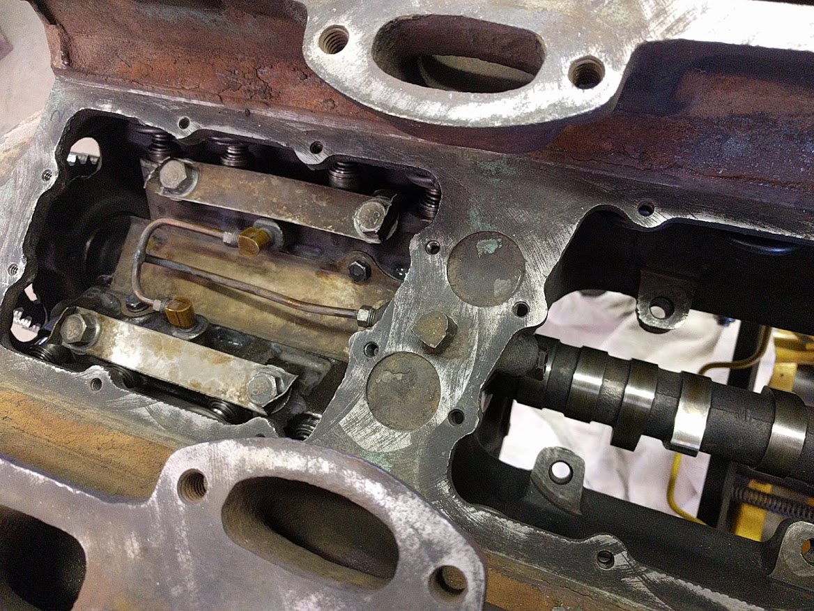

    I did that 7 years ago...but my memory only lasts about two weeks.
    I did not take any pictures of the lifters apart. But I recall that I did take them all apart...
