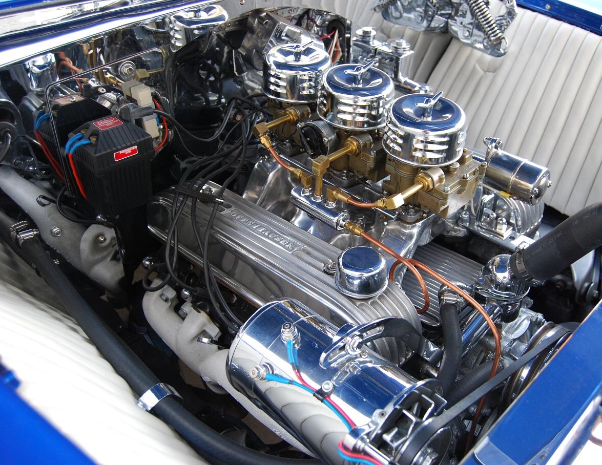

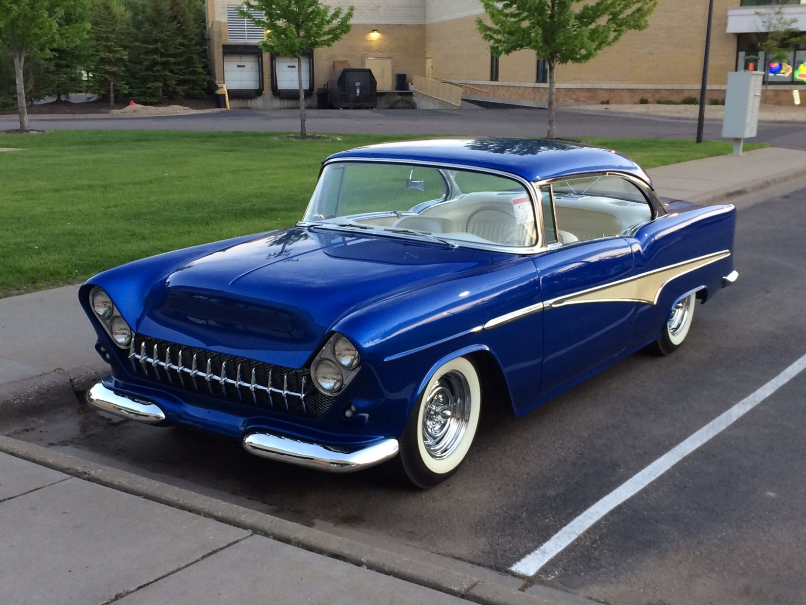

    I have a 55 with a nailhead. It has an Offy adapter to the stock 3 spd OD trans. I wonder if Offy ever made one for a Caddy, Don't they still have all of the old tooling? might be worth a call....

    Offy does have all the old tooling still. After about a year of working with a distributor and Offy directly I was able to buy the first Early olds starter change over they had made in decades. They did a small run of them. They may still have some. It took some time but well worth it.
