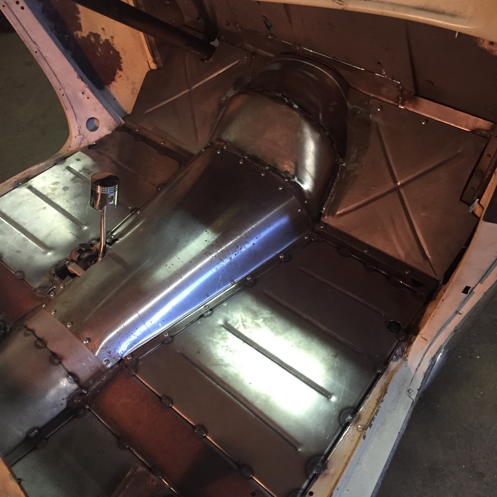

    start of the floors and trans tunel
    floors and tunnel, cool ansen shifter
    last set of my hanging ansen type pedals
    i never liked putting a spacer under the master, 1 more thing to loose, so i just make the firewall flat there, there will be a reinforcment plate made for the back, i dont think people realize how much leverage you have.

    toe boards and bottom of firewall and trans tunnel all done, only had to trim about 3/8 off the front corner of the firewall for the motor to clear, ill have to snap a pic djdj.jpg

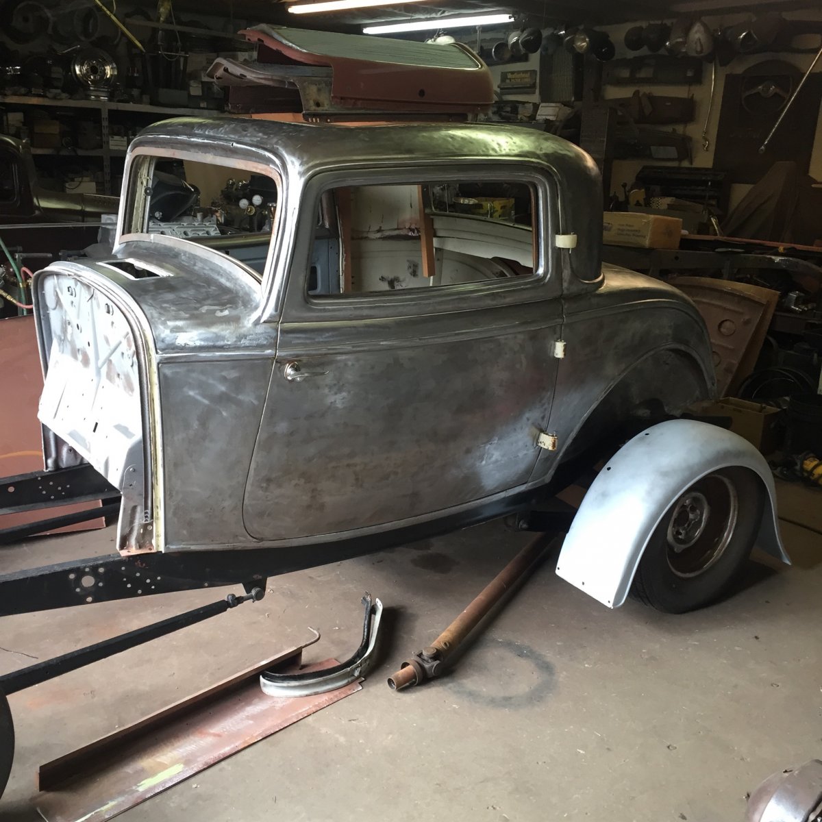

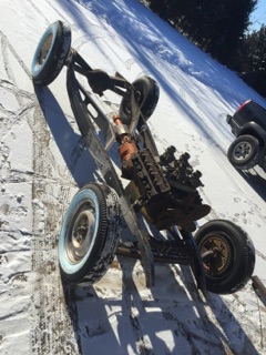

    here is is as a roller
