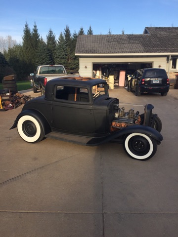

    outside with one side of fenders bolted on
    pitman arm nut shrunken down for clearance
    we built this seat from scratch, used 1x1 square tubing bent on a diacro tubing bender, worked well, all the wood was measured and patterned off an original 32 3 window a buddy has, worked out really nicely, the wife is working on covering it now IMG_7991.jpg IMG_7994.jpg IMG_7992.jpg IMG_7967.jpg

    so thats where were at right now, hoping to have it running in the next week or so, working on the carbs now have to run plug wires and bleed brakes, its about 90% wired too.
