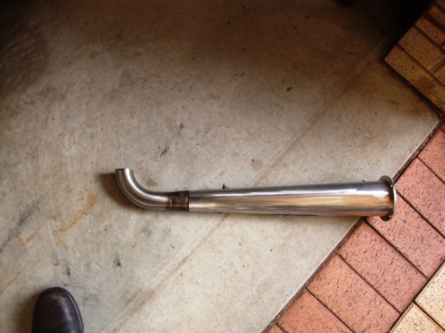

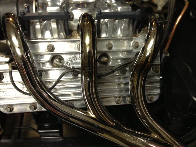

  3. hawkerdriver
    Joined: Feb 26, 2006
    Posts: 382
    hawkerdriver

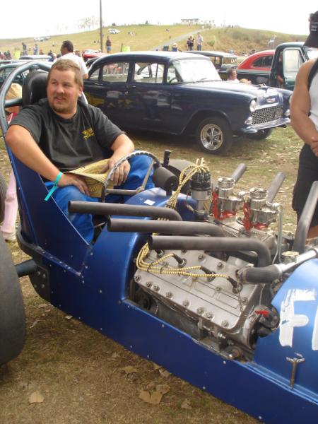

    I can post some pics. Its sitting in my garage so I'll snap a few of it.
  4. hawkerdriver
    Posts: 382
    hawkerdriver
  5. fiftyv8
    Joined: Mar 11, 2007
    Posts: 5,401
    fiftyv8
    from CO & WA
    Hey thanks Hawkerdriver for posting those extra pic's.
    The pipes look good, nice smooth lines.

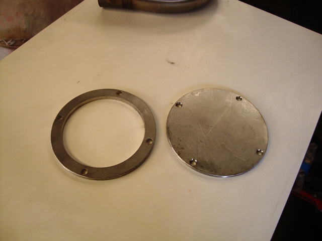

    Its been a while now, but I've finally gotten some stainless steel rings laser cut for the ends of my fluted pipes and had my 1 3/4" to 2" tapers welded onto the front pipes exiting the engine.
    Have acquired a pair of 90 degree 3 1/2" diameter bends to be cut down slightly and used as turn outs at the end of my flutes.
    Things are starting to take shape now.

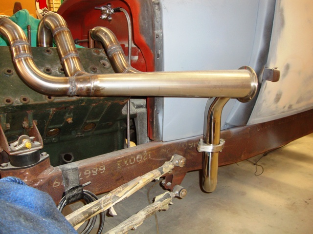

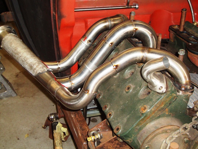

    Well, I've made a little more progress with my exhaust pipework.
    I made a sling style jig to hold the flute in place which provided me with a clear and simple work area around the pipes and flute.
    Worked out well and I plan to re-work it to fit the other side when I start on that side.
    In the mean time I've tacked my pipes in place before finishing the welds and doing a little polishing and cleaning prior to final weld up of all pipes into the flute.
    My main concern for now is the front pipe which from the side looks just OK, but from the front it looks way out of sync with the others, so I plan to re-work that shape and change the bend to help get a little symmetry happening.

    Just an up date on my progress as the second side has now been cut and tacked in place.
    I have gained access to a TIG welder and hope to get a little practice in before completing the final welds on my pipework.
    In the meantime I will continue with my pipework with a discrete drop pipe from the underside of each flute which will become the start of my twin exhaust system under the car.
    I will be using 2 1/4" diameter pipe.

    Any ways, with respect to my exhaust progress, I have basically finished.
    I ended up getting a TIG guy to do all the final welding using my new machine.
    All welds are finished including under the car thru to the mufflers.
    I came out of the exhaust flutes with a 2 1/4" pipe and dropped it down and under the frame.
    There is not a lot of space under there, but it seems I have gotten away with it.
    Next step is to grind my welds to a more presentable state, as my main concern was getting TIG weld penetration on all the welds.
    The welds ended up a little heavy but on an internal inspection where possible penetration appears to be good, so here is hoping there will be no cracks down the road.
    I will grind the welds for a clean effect but will not be polishing any of it.
    The next step once the welds are ground is to finish the pipe work out of the mufflers with a turn out on each side in front of the rear tire.
    More later...

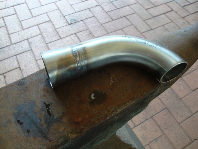

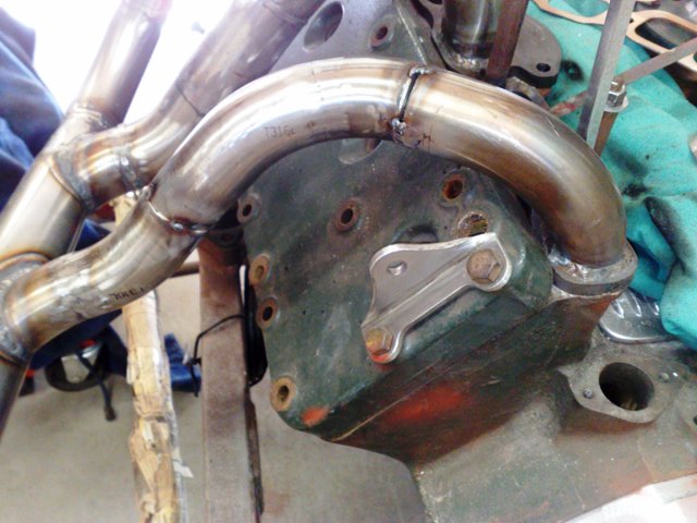

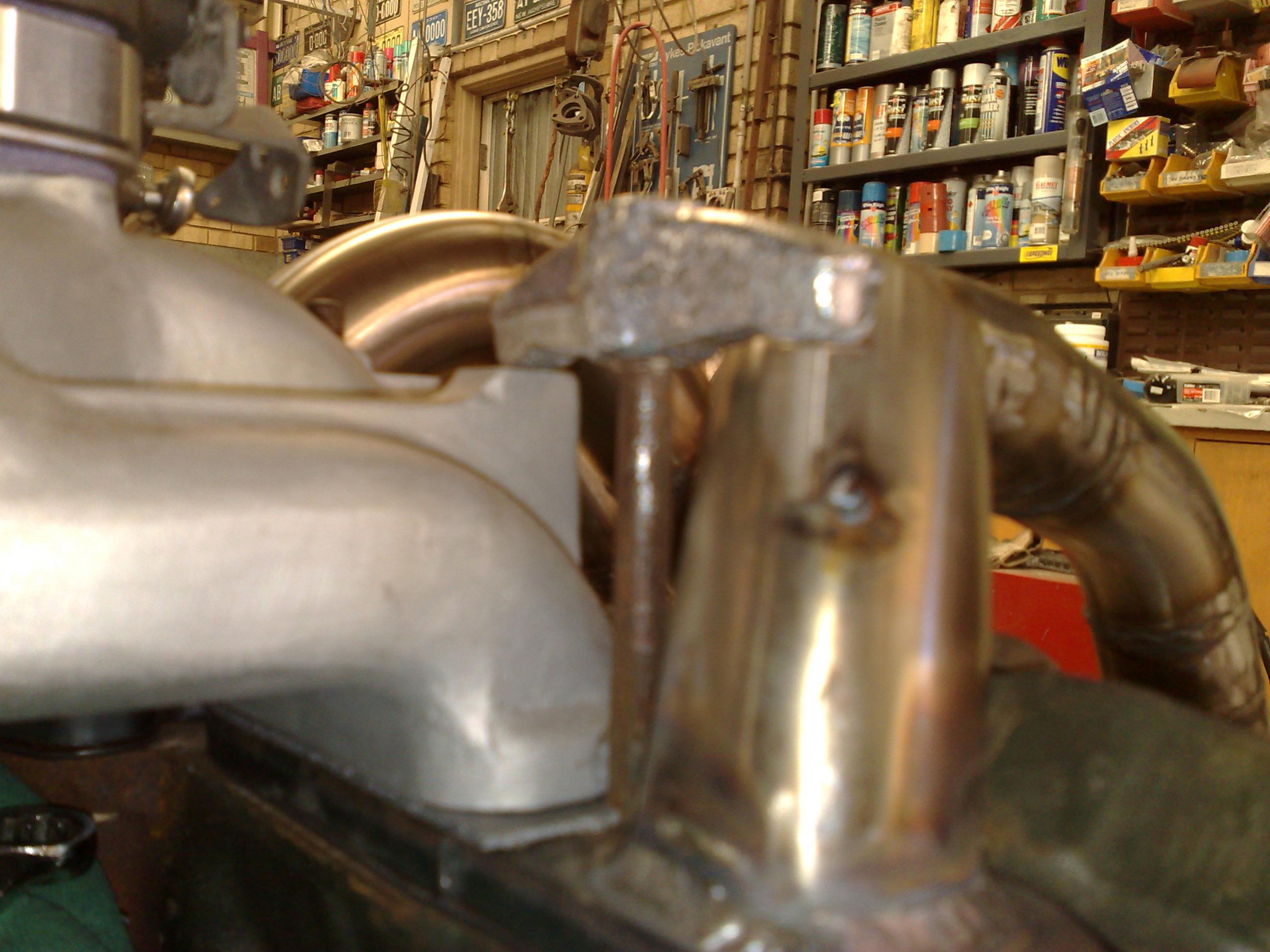

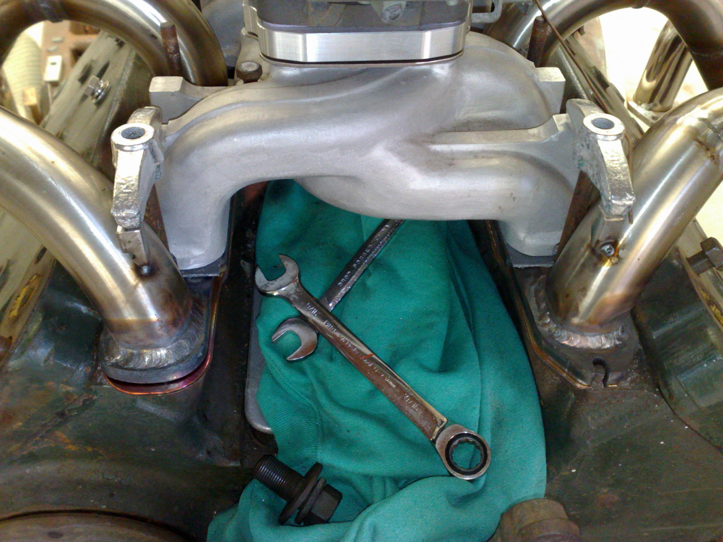

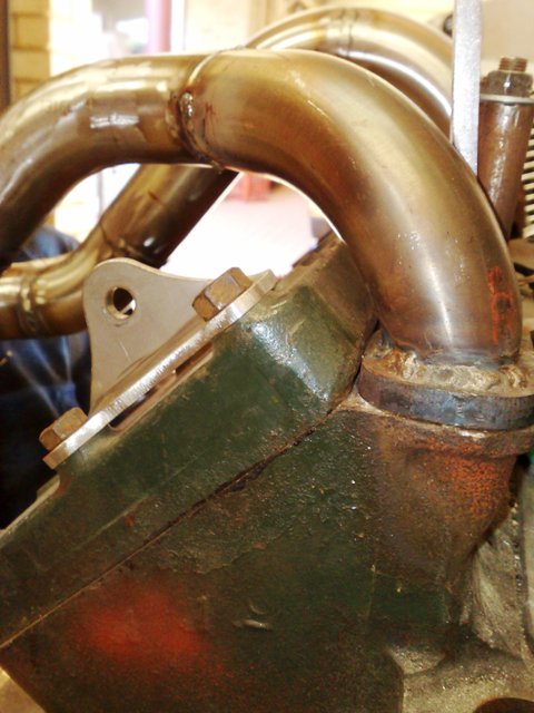

    Just for the record, I discovered that the LH side exhaust flange had moved slightly after welding and it was going to be difficult to ensure a good seal on the rear outlet.
    So I decided to cut out a section of the header pipe to relieve the stress.
    It did move a little but a little heat persausion was also needed to get to come back down flat again.
    Now that is sitting flat, I will keep this side bolted to the block and have the cut section re-welded into position.
    Better to find and fix it now rather than later, especially since the dizzy sit close to that side as well...
  25. fiftyv8
    Posts: 5,401
    fiftyv8
    from CO & WA
    Pic's for the previous post, just welded back yet...
    Looks a good seal now.

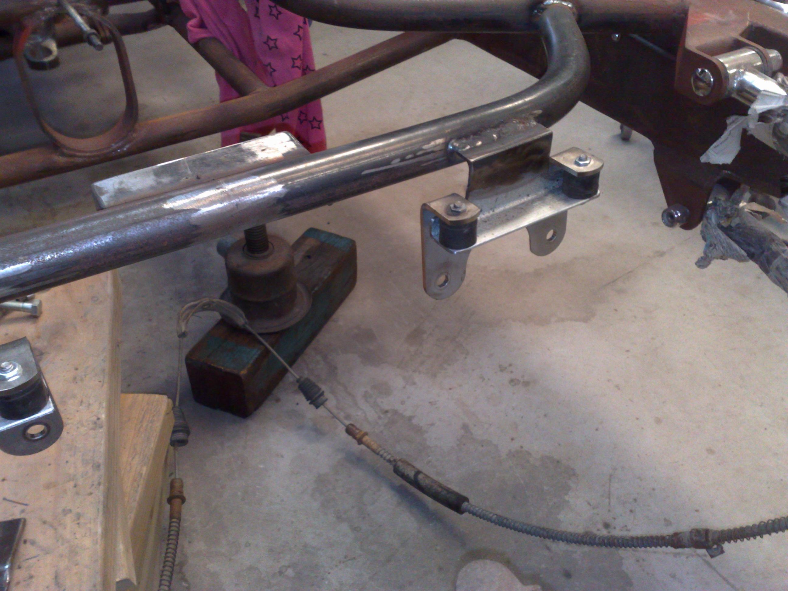

    For those of you who are interested, I got flanges laser cut to fit gaskets I could easily source at my parts store, I used two sizes, front where it was a little tight I used some smaller Japanese car gaskets and further back I used GM items.
    I also made a couple of rubberised hangers and stole from an old pair of pipes the screw in flanges for oxygen sensors.

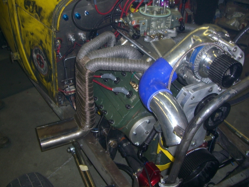

    Looking real good Russ and I am envious of your progress. I know I'm a little late to the party but the more pictures the merrier, right? I know these would all be loud and tough to tune but pictures are always fun.
    Here is a set that have more of a custom look.
    These are to the extreme (remind me of a big rig)
    Some shorties on a drag car (no back pressure)
    Theses headers almost look exactly like the headers I put on my bike.
