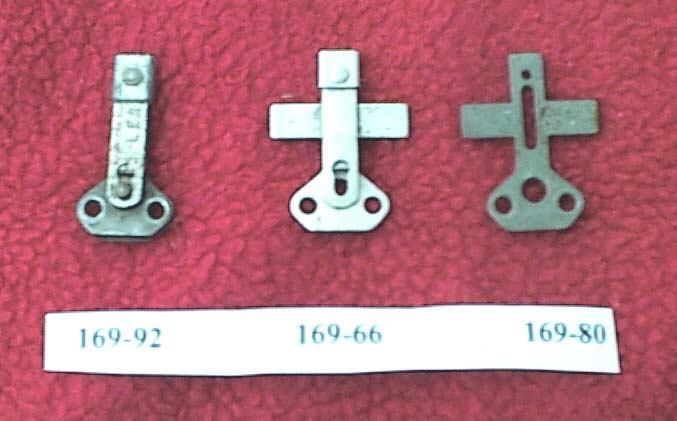

    Do you know how Carter would have sabotaged the AFB for Pontiac?
  14. carbking
    Joined: Dec 20, 2008
    Posts: 3,980
    carbking

    I’m still kind of dumb when it comes to carbs, what am I looking at in the picture of those three pieces?
