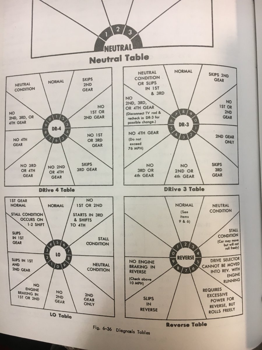

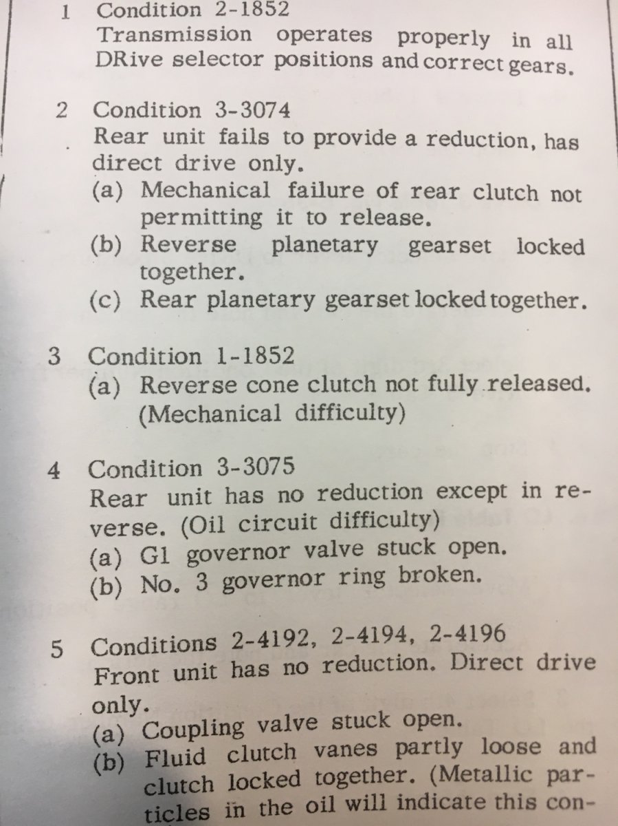

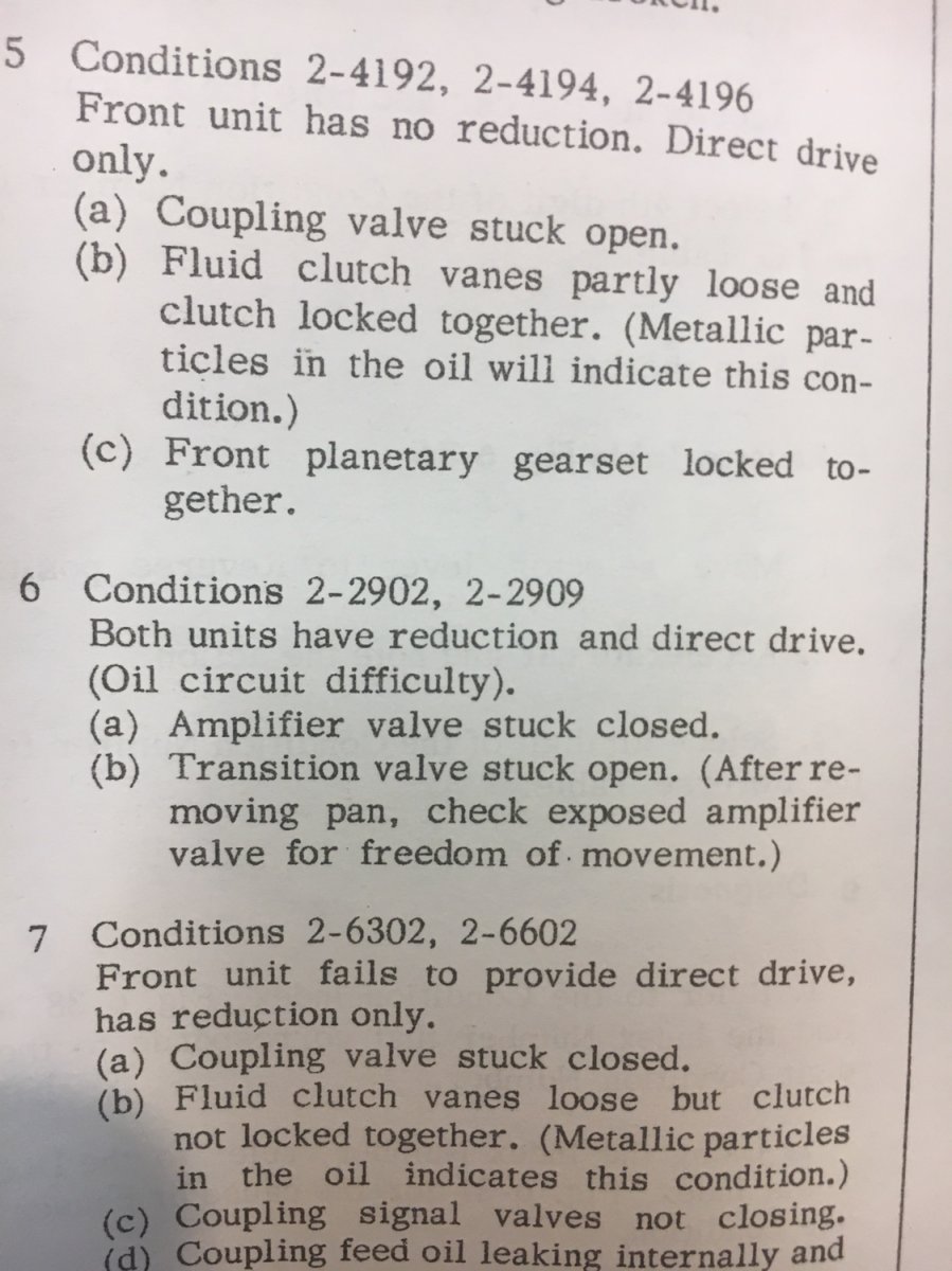

    Hmmm
    I’m sure you already have this manual, but here’s what it suggests might be the issue:
    I’m guessing ****** here. The only two things you can really service without dropping it are the valve body and governor. The TV rod wouldn’t cause this problem.
    According to condition 6, it could be the valve body. It’s worth dropping the pan, cleaning the valve body and making sure nothing is broken.
    Don’t read the others, they involve dropping the ****** for a rebuild (too scary).
    The governor is more of a pia, but I would try that 2nd.
    I am far from a brain surgeon, but I ended up rebuilding the Jetaway on my ‘60 Cad myself. If it comes to that PM me and I’ll give you some pointers.
    Good luck!
