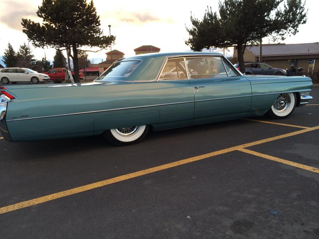

    Looking for some expert opinions here as I prepare to do the exhaust on my 64 CDV. I want it to sound good but not too loud and to fit the car. What dual exhaust set up would you recommend? This is a 98K original miles stock 429 and this is the car......

    Good input so far. I have been looking at Brockmans and Porters and think that is probably the way I will go. I know I dont want the Flowmaster sound, I want it to sound like someone did the exhaust in 1964. It needs to sound good and remain classy!

    I went with some 30" Brockmans and it sounds great. Exits are slash tips tucked under the rear bumper so they are hardly visible. Has a nice rumble at idle but not too loud. Just right. Thanks all for the input.
