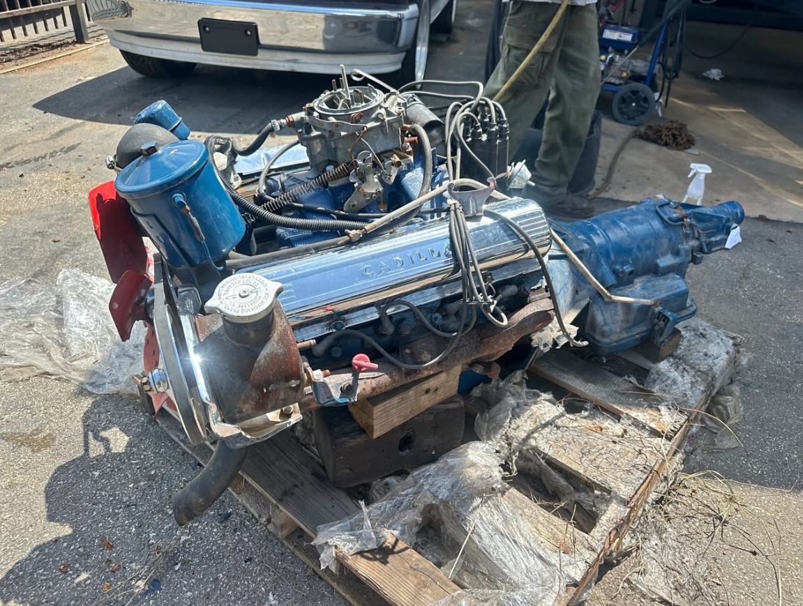

  15. aldixie
    Joined: May 28, 2008
    Posts: 1,676
    aldixie
    I just picked up another 390 and transmission that was taken out of a Barrett Jackson car. I’m looking at dropping it in a 1955 Coupe project I have. IMG_3877.jpeg
