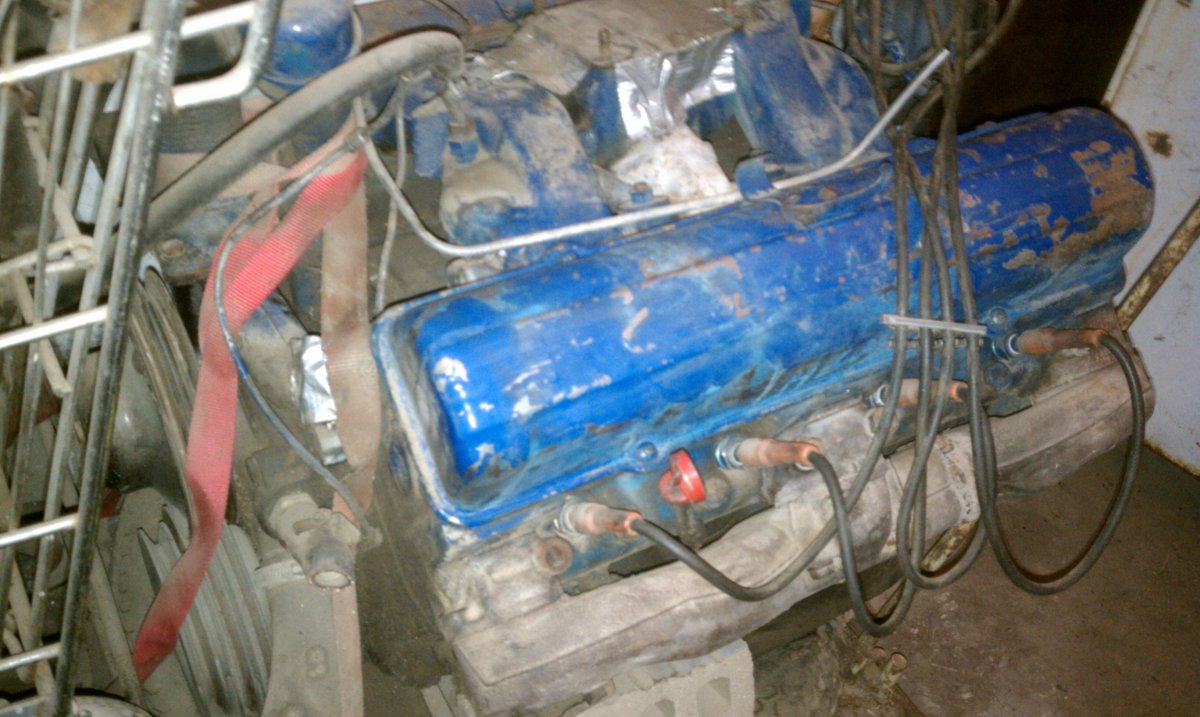

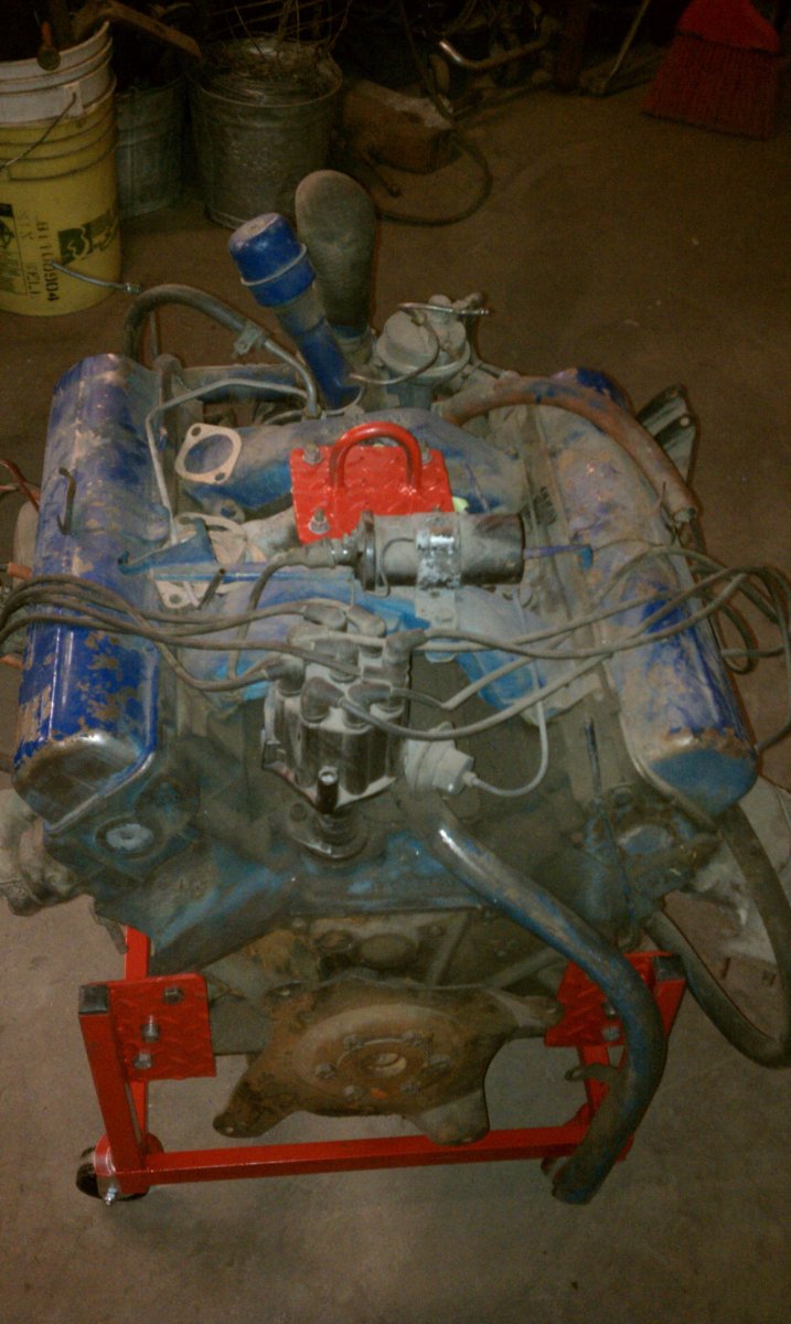

    Still deciding on a future for my 365.
    I just got it mounted in an engine running stand so I hope to hear it run soon.
    They sure are a wide motor across the shoulders...

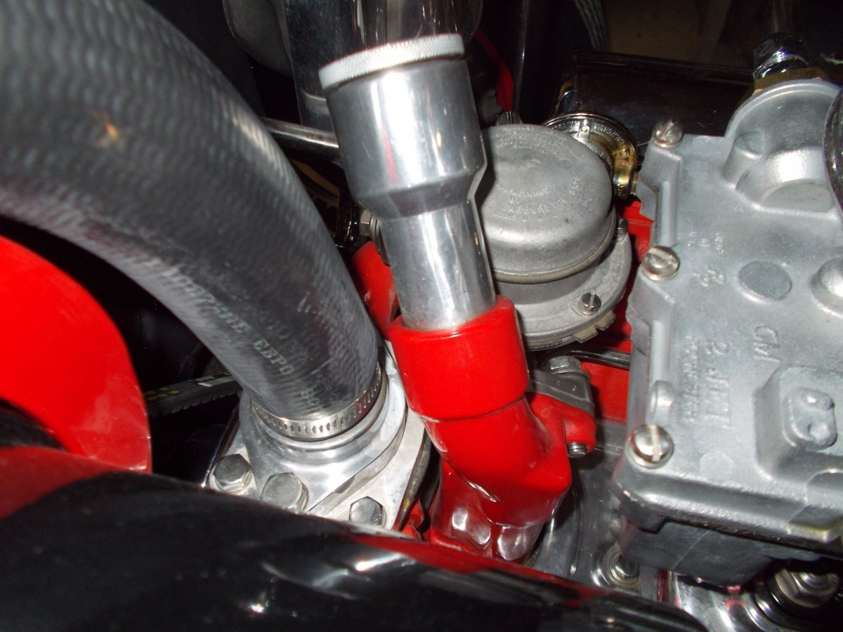

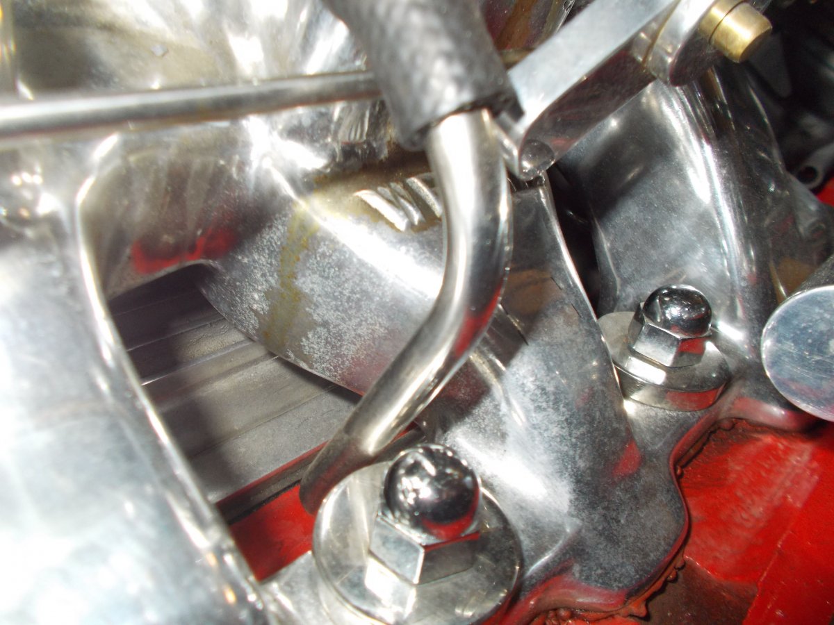

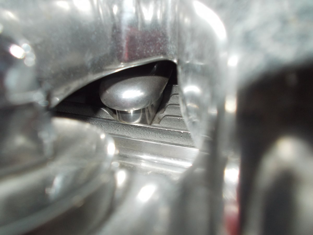

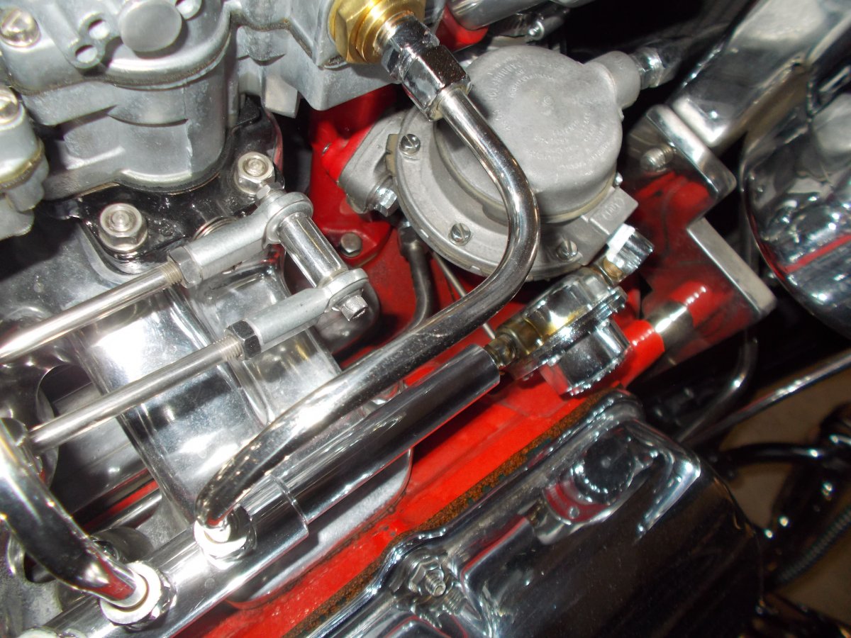

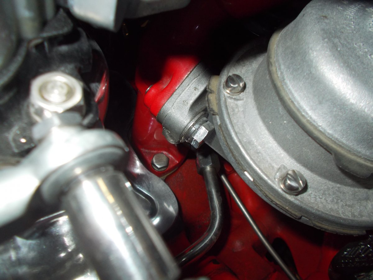

    Nice. Any better pics of your pcv setup?

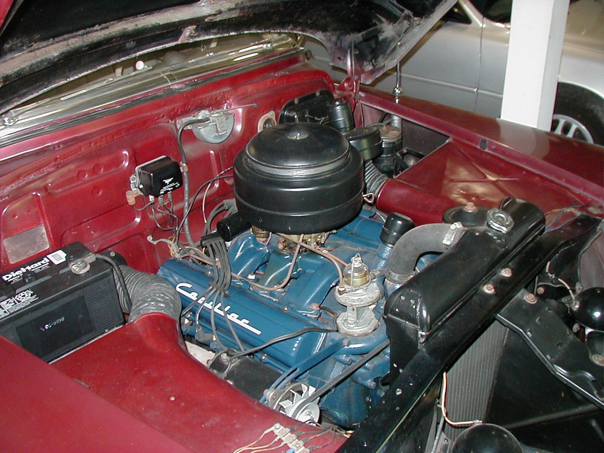

    Here was my original 331 at home in the 51 Cadillac that the factory installed it in.

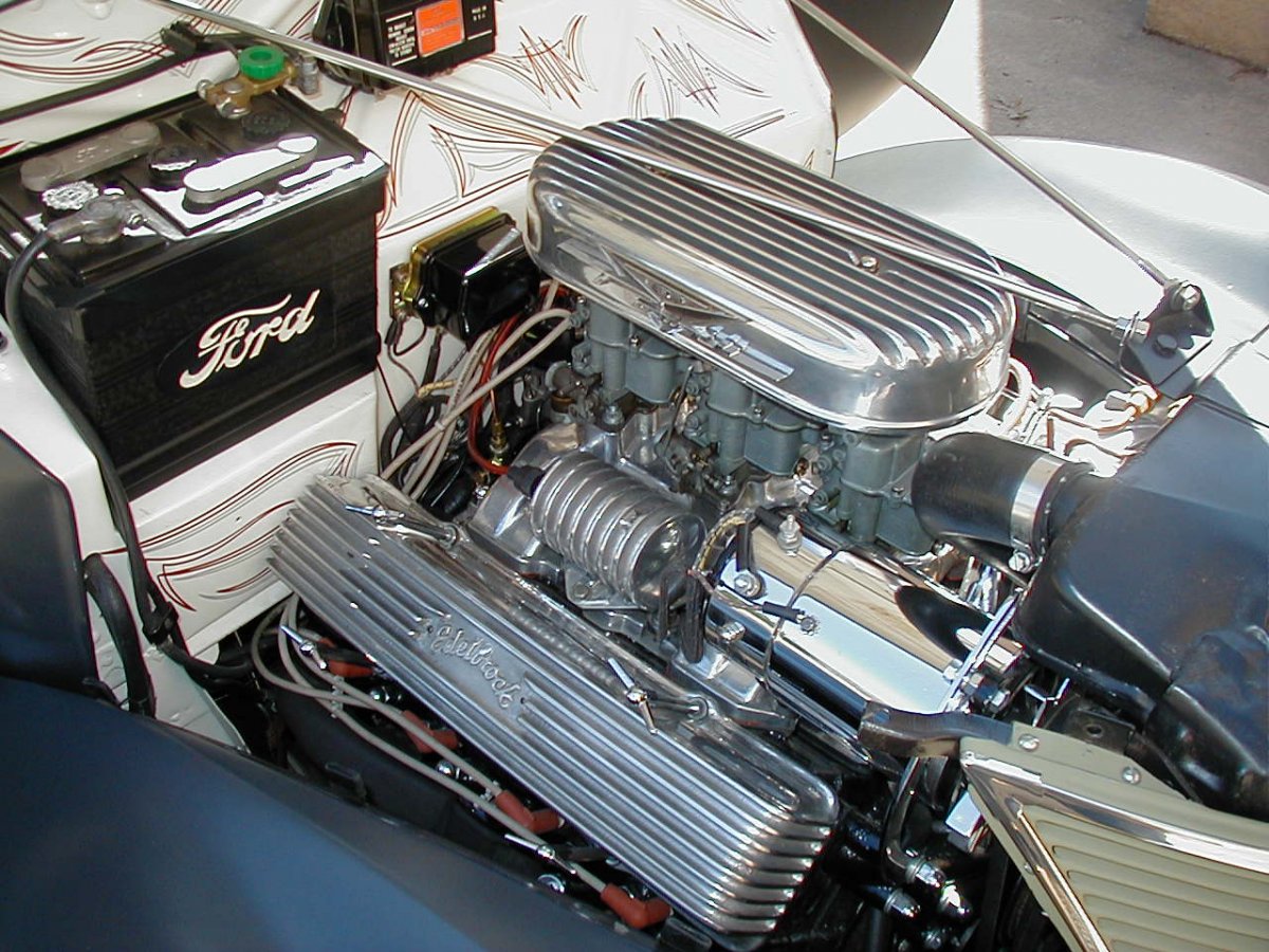

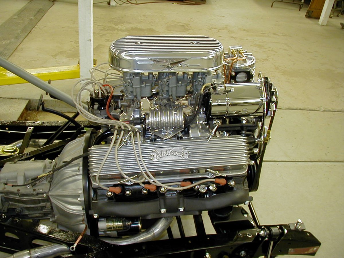

    Mine is a throw back with Isky roller, Jahns, Mallory Magspark, early shinny stuff with the exception of the O'Brian filter cover. T-5 makes long trips fun at 22mpg.[ Caddy in 37.JPG P1010032.JPG Cab at Ty-Rods front.jpg

    Looks like it was made for it.... :)

    Whose ****** adapter did you use?

    To answer Roothaug, I used an adapter from Bentsen Transission Center, Ham Lake, MN 55304. 1-763-767-4480. Comes with hi torque starter. Also used a GM truck bellhousing with the throwout arm on the p***enger side with a hydraulic slave cylinder so I could use the stock 1940 or so brake pedal ***y. Bellhousing 15562385, clutch slave 15616089, fork 12385352, TO bearing 15613306

    This should be enough to figure it out. Ron
